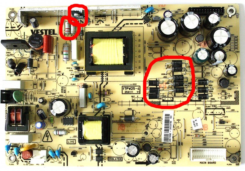

17PW25-4 found in 26" Vestel "Digihome" fixed
    Another free TV from a friend. Fault blown fuse, no power -- same as 42" Vestel I am working on.
    Found one shorted diode plus blown FET and associated driver components.
    The bank of 8x3A through hole diodes were for the 24V. These diodes are all in parallel, a very bad idea. The diodes are not thermally matched, so if one gets hotter than the other, its forward voltage will drop, causing it to take more current, causing it to get hotter, causing it to take more current... This cycle is destructive to the diode. The poorly designed current limiting of the power supply means this damages the FET and other components. Only one was failed, but I elected to replace all 8.
    The power supply is rather bizarre. It does not have a large 400V capacitor. Instead, it uses a transition-mode PFC controller in a flyback configuration. The main 24V output capacitors (3x3300uF) are the bulk for the PFC, plus the 12V. The measured output ripple is in excess of 1Vp-p.
    This PSU is also used in the rebadge Toshiba 32BV501/502/701/702 sets. It is an unworthy pile of rubbish.

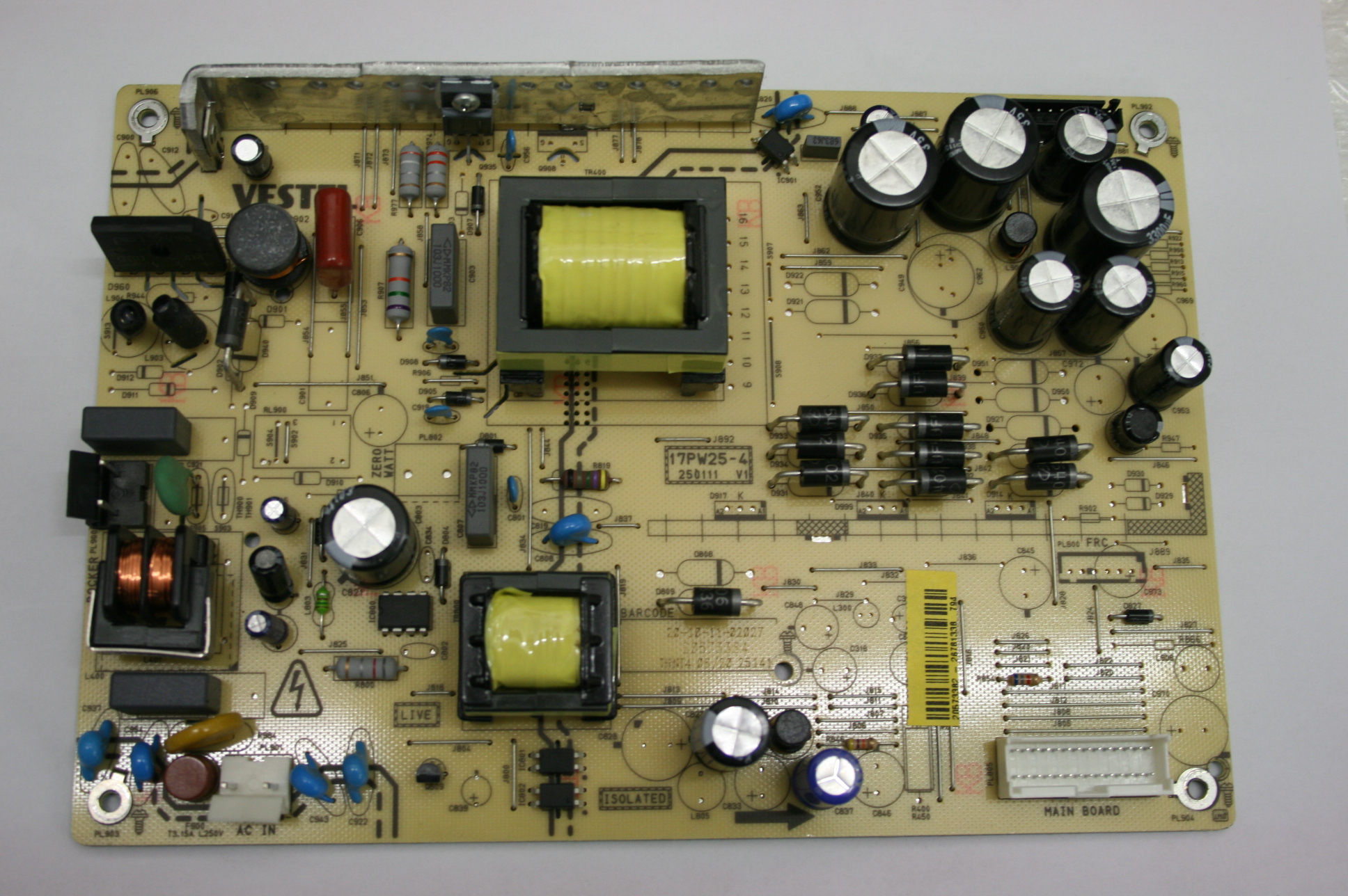

    Hi Tom66. I got Toshiba 32BV501B with 17PW25-4. TV is just blinking orange diode so I think is PSU. Checked Q935 and is fine (not shorted). What else can I check to repair this TV?
    Thank you.

      As Tom said it is rather an unusual power supply. Can you post good clear pictures of your board and also of the main board.
      Perhaps next test with it all connected up would be to work along that big connector to the main board and list the voltages. I dont suppose that the expected results are listed on the board - front or back of either board?
      If you struggle to get probes to metal with the connector in place then get
      a sewing needle and insert alongside the wire and test to that.
      With the power off you could test all those diodes

          Blinking orange is PSU or main, if you have no voltages from PSU then it is PSU, otherwise it is the main board.

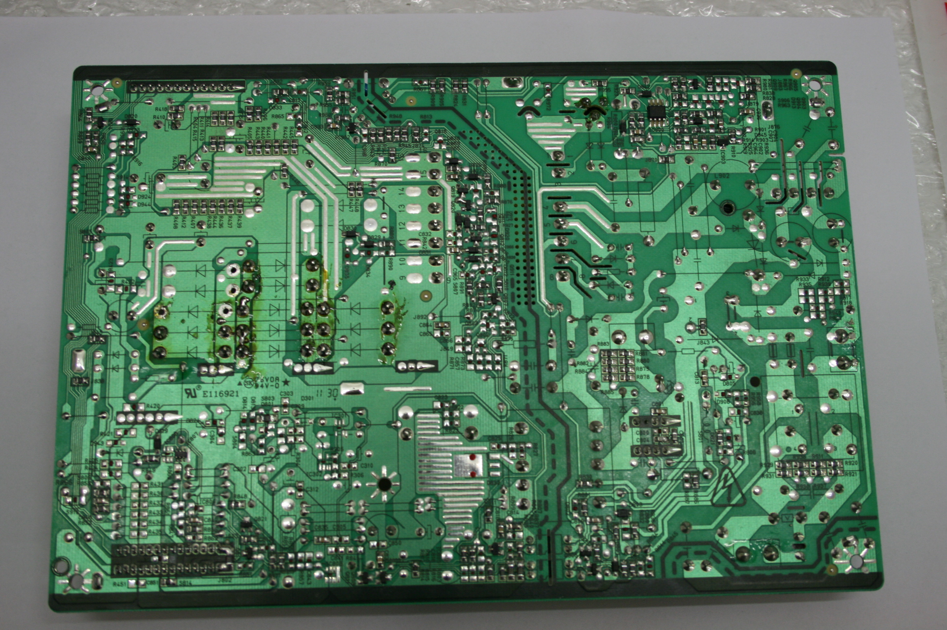

              It's not easy to check voltage because outputs are not marked on pcb. I think I will need schematic for this PSU. Attached pictures. There is one diode D927 missing. I've found this one faulty, it's not shorted just not giving anything while testing.

                    Thank you tom66 for schematic. Weird thing just happened. I put PSU back to TV and is working now Was it diode I've removed? Now there is only 2 instead of 3. Just ordered diodes on ebay so I will put 3rd diode back.
                      Re: 17PW25-4 found in 26" Vestel "Digihome" fixed
                      That could be, if that diode was shorted. You are very lucky it did not blow the FET. Maybe that only happens on 24V. I've found tons of Vestel PSUs with bad diodes... crazy how common this failure is.

                        That diode wasn't shorted. Just won't give any reading from multimeter like others did.

                            Sorry guys. This one was shorted.
