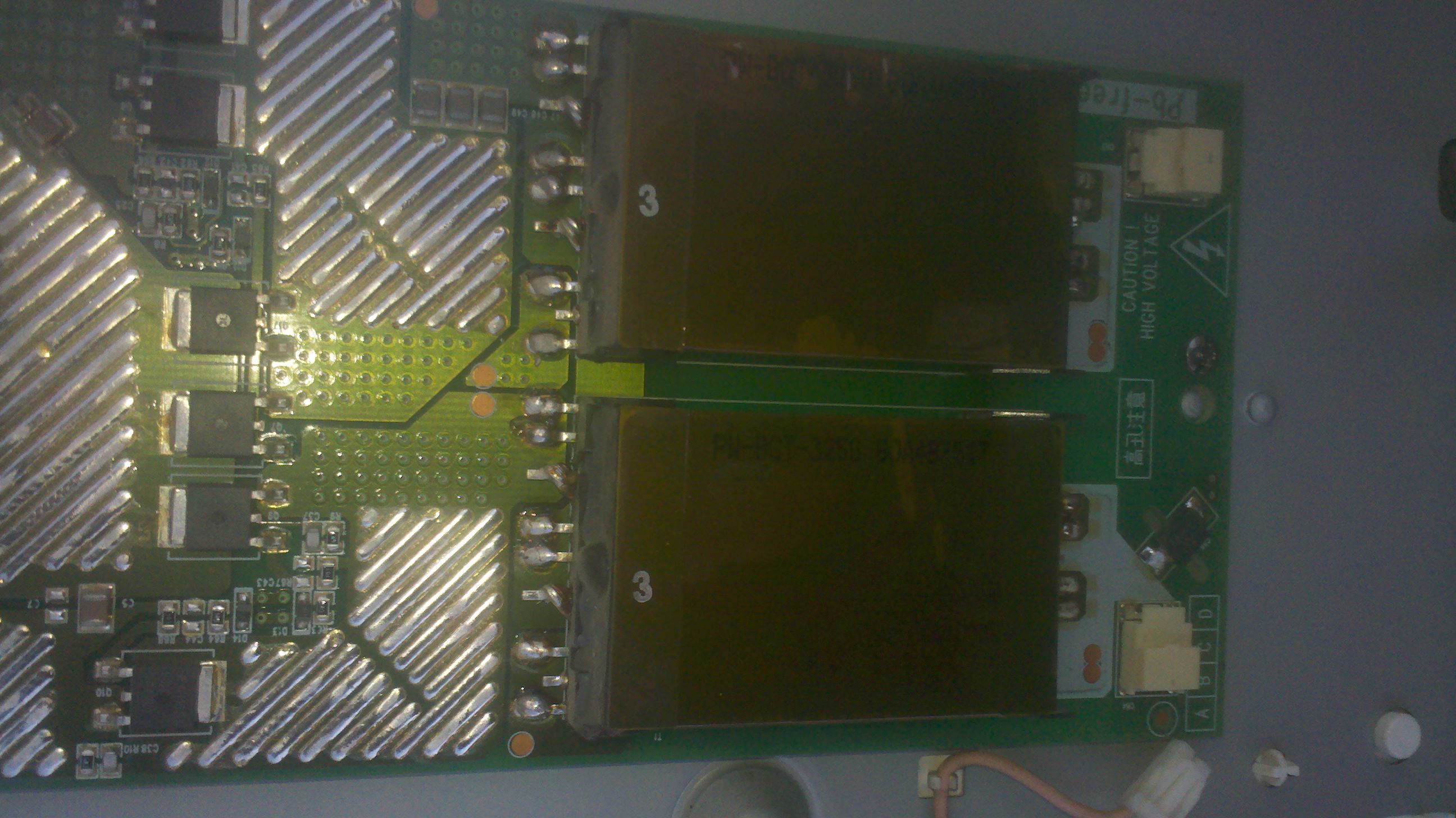

    got this LCD recently from a friend , the TV has sound but no pic and no backlight.

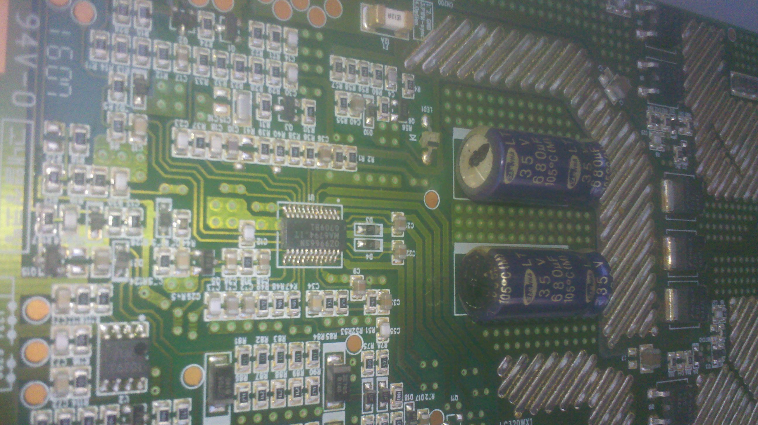

    i dissasmbled the screen and found that there are two blown caps on the inverter board (6632L-0420A )and also it seems like the transformers has been replaced .
    what is your expeirience would replacing the caps solve the problem or a kit i've seen on Ebay :
    http://www.ebay.com/itm/271185516140...9#ht_762wt_932
    or the complete borad should be replaced.
    thank you very much for your time...

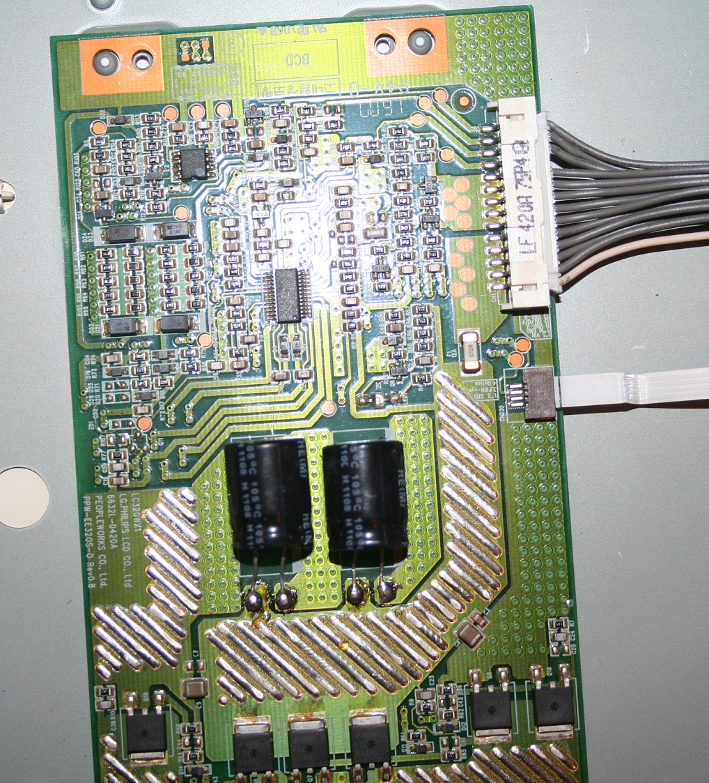

        Blown caps will definitely cause flickering or no backlight. Replace them with Panasonic FC, FM or FR, available from Digi-Key, Farnell/Element14 or eBay (make sure to avoid fakes!) The capacitors in the eBay auction are cheap replacements and will likely fail quickly.

              Re: Toshiba 32A3000P inverter problem!
              UPDATE: hi guys , i got the two caps replaced with new ones - but still no backlight
              could it be one of the light tubes that causes no light (as in pc monitors)?
              what should i do next at your opinion ?
              TNX
                Do you have stable 24V going to the inverters?
                  I would also check all the MOSFETS on the inverter boards to see if they are shorted.
                    thanks for the quick reply
                    i just tested it - seems perfect ...
                    it has 5 VIN and 5 GND tested them all 24.0v
                    stupid questions: is there any fuses on this board? (i only recognize a fuse when i see a standard glass type)
                      The fuse is the white cuboid/rectangle with gold ends, marked on board F1 12A near the power connector.
                        the MOSFETs all have same resault (not shorted - BUT tested onboard is it ok?)
                        the fuse also checks out OK (learned somthing new today
