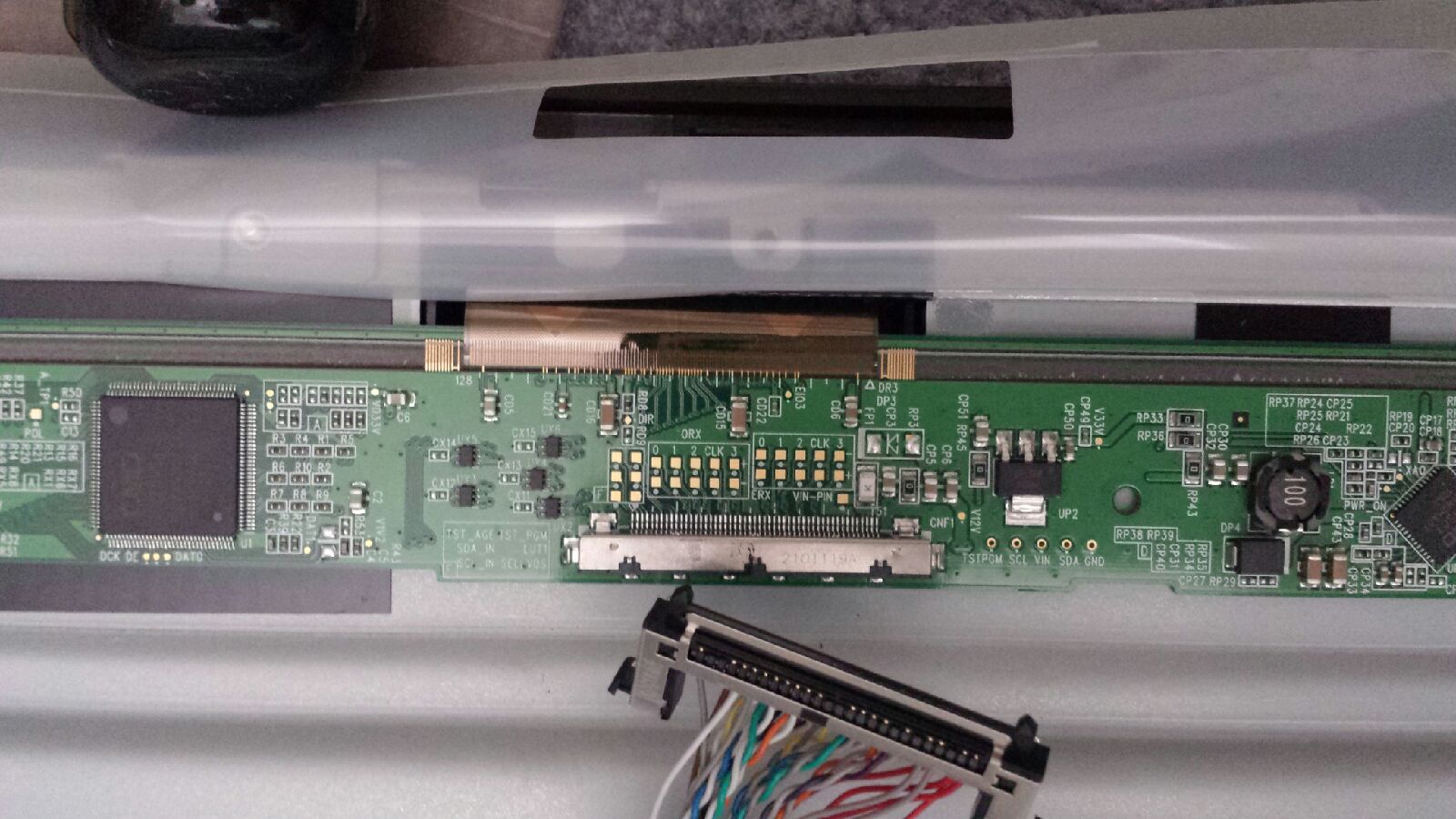

            Re: LD-4655VX - Audio, Backlight, but no Video
            Near the cable going to the screen on main board, multi coloured wires (LVDS) there is a device marked Q13. What is part # on this device and also what voltage do you get on each pin, with the black probe on the chassis and red probe on each pin, DC 20V range.

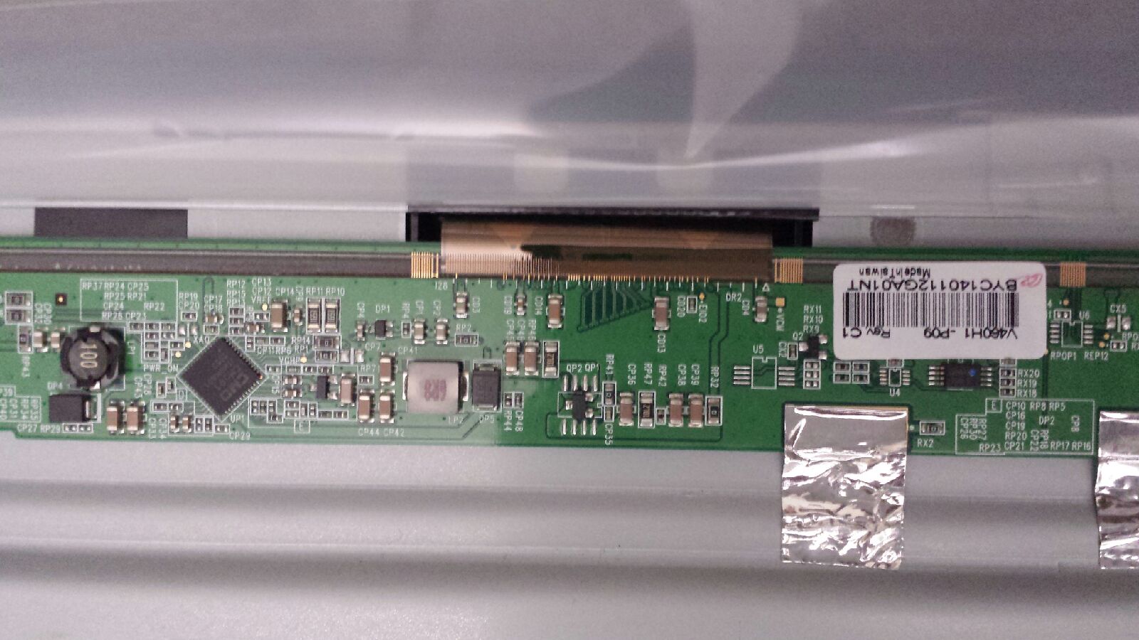

                  If the panel board is the board on the other side of the LVDS cable, I don't see any fuse. It's a strip on one side of LCD, with a couple of ribbon cables connecting it to a strip on the other side (which makes it seem like a panel board to me). Is this a "it has to be there" situation? Maybe I'm missing it, maybe it's a microfuse and not obvious, or maybe I'm looking at the wrong board. It's the one at the top of this image:
                  https://www.badcaps.net/forum/attach...4&d=1349118015
                  which unfortunately is covered with a protective film, but maybe you can tell if I should be looking for another board.
                  Regards,
                  - skew
                    Yes, that's the panel board. Replaces the t-con but not replaceable due to it being bonded to the LCD panel. Can you get a closer shot of the connector from the main board to it, on the panel board end?

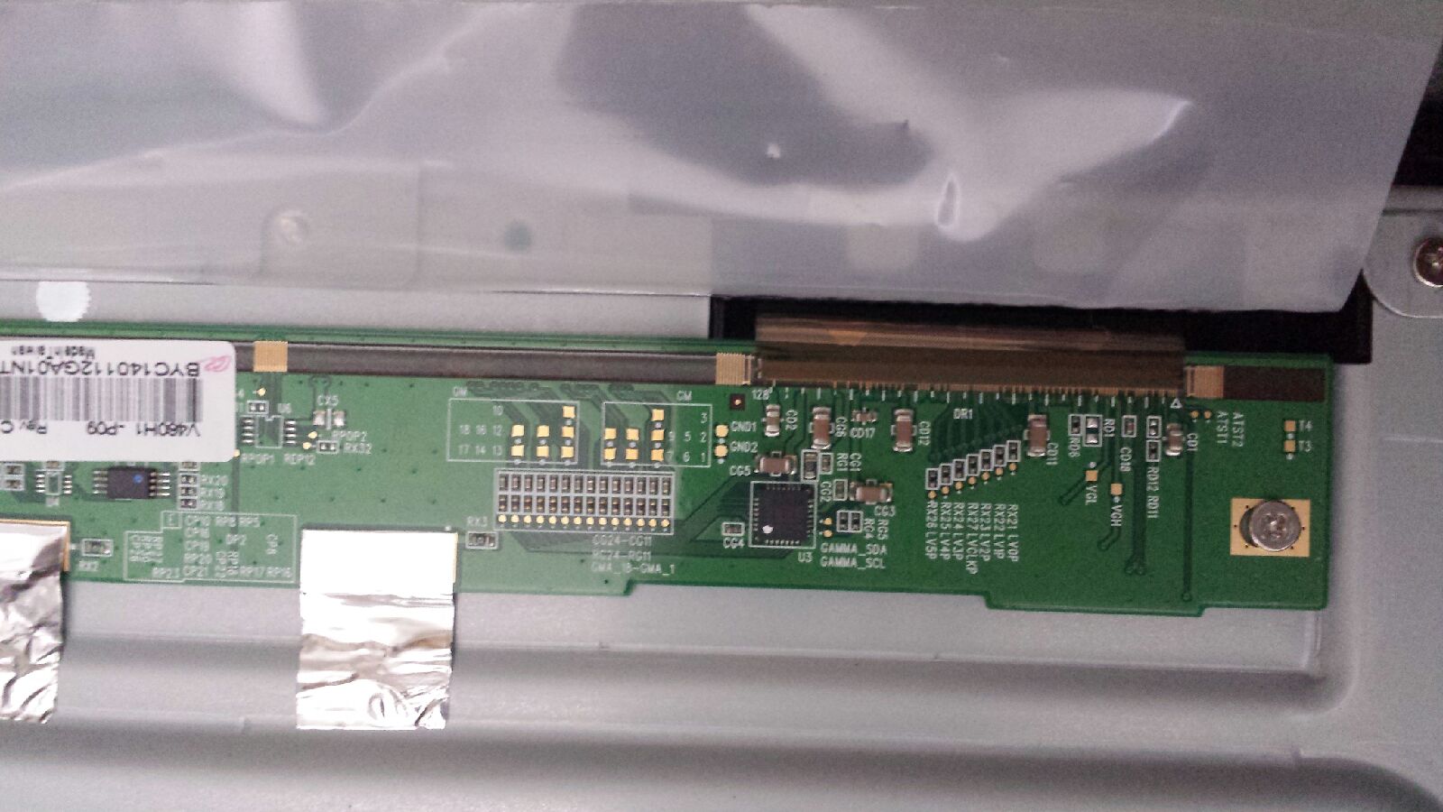

                      Here's the whole strip...
                        Do you see the white device with a "K" mark on it? That is your fuse. With the TV powered on, measure the voltage on both ends, red probe each end black probe on chassis, DC20V.

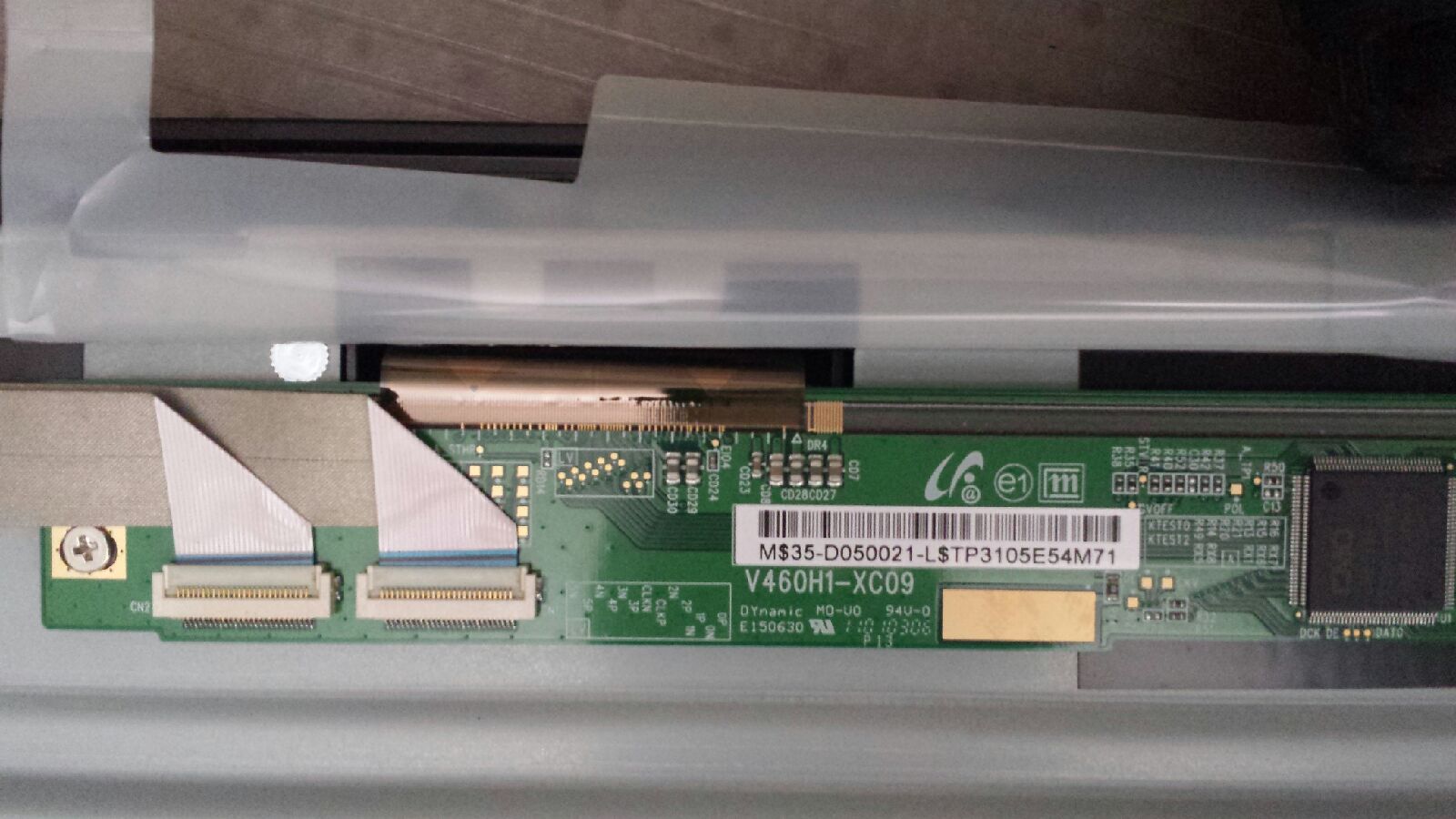

                                BEFORE you give up, looking at picture #1, those two flat cables going to the left and right side of the T-CON board, looking at the black line, are they inserted correctly? Maybe its the camera angle?
                                • skew
                                  • Sep 2013
                                  • 11
                                  • US
                                  Good eye... but that was me, I didn't seat it straight when I checked it the first time. I fixed it just now, no change, and no change to the voltage coming in, so I don't think my slight angle made things worse.

                                    okay I have this TV on my work bench and I had to change the flat ribbon cable going to the LED stripe. have you confirm the two ribbon are connected right, CN1 to CN1, CN2 to CN2. its not a bad TV, I'm watching it now.
