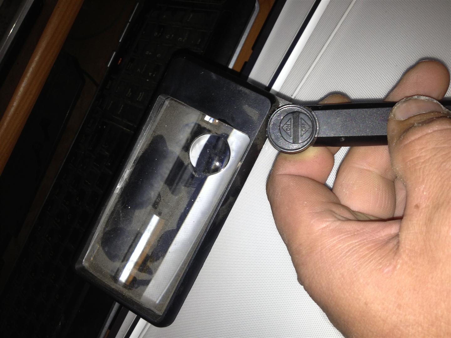

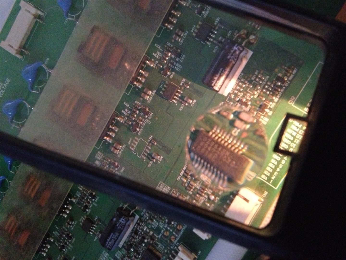

                Originally posted by Zorix
                It's a surface mount 8 pin chip it looks like. However, I cannot seem to read the writing on it.
                Walmart has magnifying glass with a insert that's even more magnified and it has a light in it. For like 5 bucks!! Super handy to read those tiny little letters on those super small components...
                Proud owner of dozens of broken TV's and many,many,many boards.
                Our website and passion:http://hollenhundshepherds.com/
                • Zorix
                  • Sep 2013
                  • 19
                  Re: Samsung LN40D550 Power supply short circuit
                  Thanks Martino, I'm going to have to look for one of those. That's really handy for sure. I was just using the magnifer on my clip thing that I use to hold boards and wires and such. Using a few types of flash lights only produced glare and not much detail. I did make out what looked like FAN on it near the middle but that's about it.
