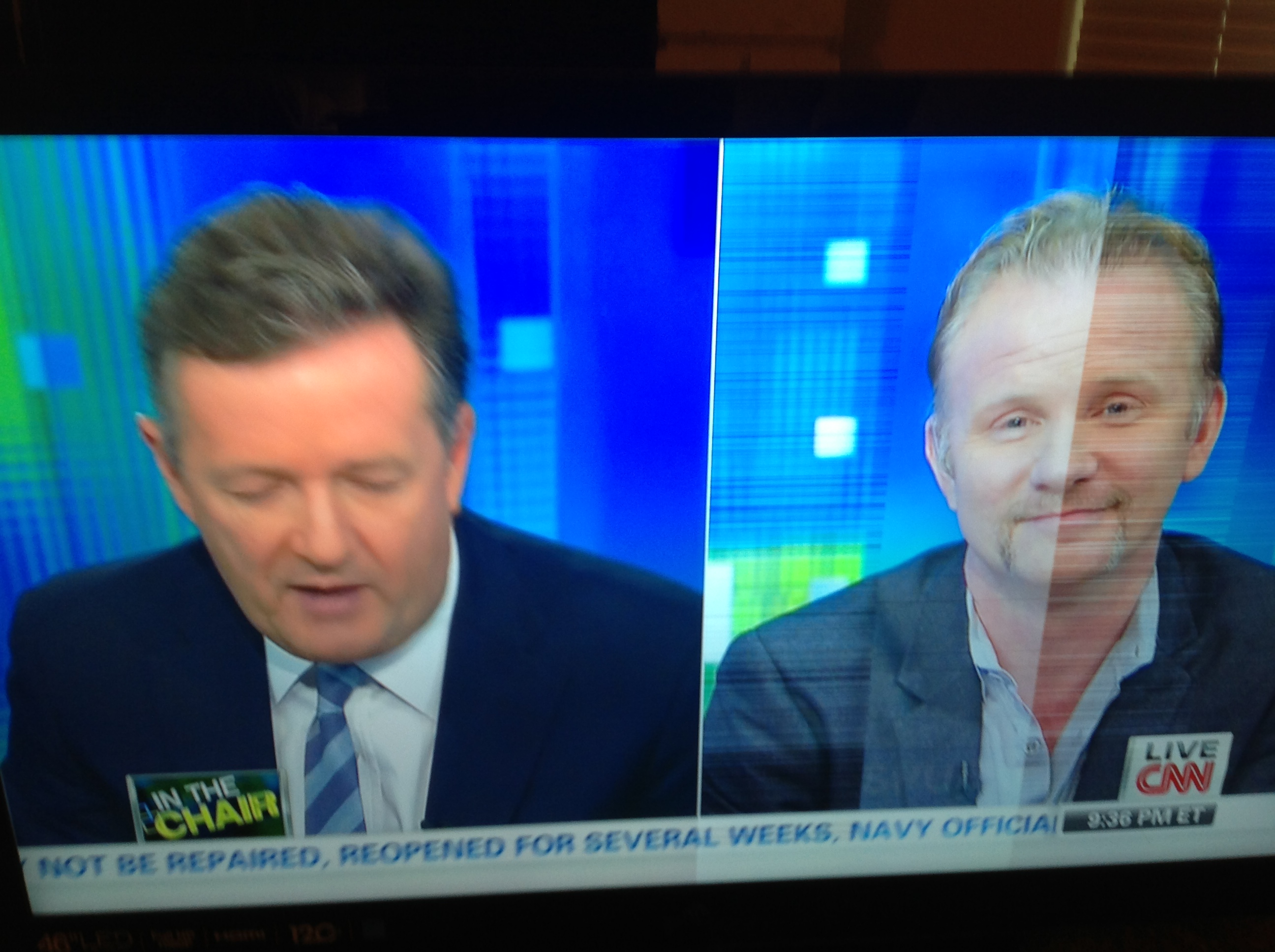

    My Westinghouse LD-4655VX started showing white lines on the right side of the screen a few weeks ago. It appeared like every other trace was missing or just white. Then it became intermittent, the screen would be fine for hours then suddenly the lines would be back. At first it was just the right 1/4 of the screen, then the next quarter started and the first quarter got worst. Now it has a white vertical bar in about the middle of the right half and lines on the remaining portion of the right half. The left half of the screen is fine and has not had a problem. The TV was purchased in Jan 2012.
    I have read in the forums here and elsewhere on the web about problems with the cable that connects to the LED bar. Could my problem be related to this cable or is my motherboard bad?
    Any help would be greatly appreciated.

    Re: Help with Westinghouse LD-4655VX
    that's not the L:ED cable problem. sounds like a tab bond or Tcon. pictures would help here.

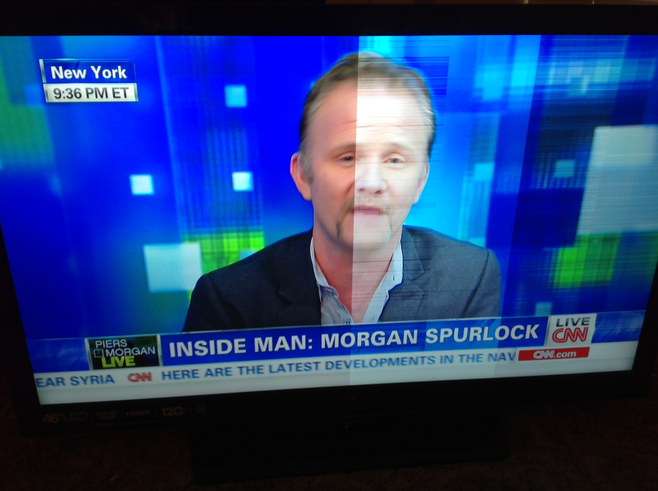

        Here are 2 pictures. I hope they can be seen I don't see them in the preview..
        Thank you.
        Harry
        The pictures aren't here. I tried adding them as file and copying neither worked. How do I add them? I forgot to upload them.
