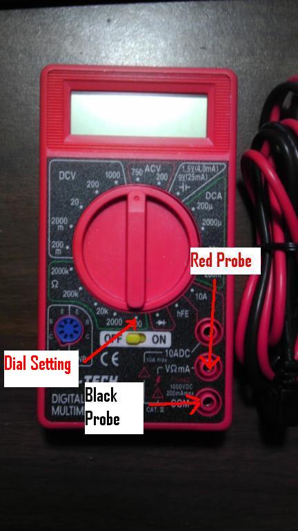

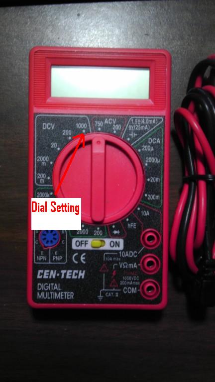

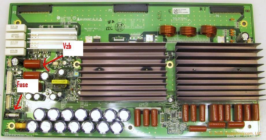

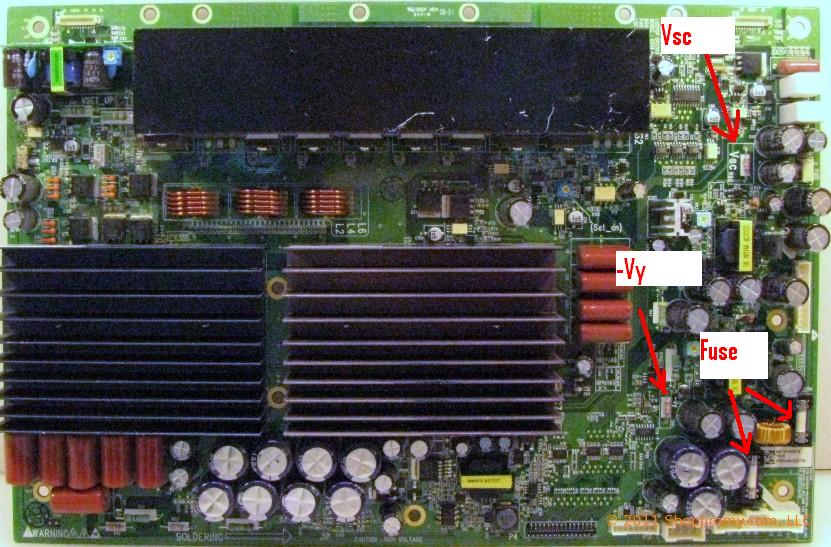

              Ok, I'm going to leave this info here for you:
              I've attached a few pics based on how I think your boards look. Ignore the panel "V" voltage checks I've marked on the pics for now. Also, ignore the second multimeter pic, since it references the "V" voltage checks. First, we'll want to check the fuses with the TV unplugged. The big board with the large black metal fins on the far left and big board with similar fins on the far right are the Y-Sustain and Z-Sustain, respectively. Do the following to test their fuses:
              (1) Plug your probes into the multimeter and set your meter to the continuity setting as shown in the first multimeter pic.
              (2) Place your black probe on one end of a fuse and your red probe on the other end of the fuse. You should see 0.5 ohms or less.
              (3) Repeat this test for the other Y-Sus fuse and the Z-Sus fuse.
              If you encounter a fuse that doesn't meet the 0.5 ohms or less spec, that is your problem board. Let me know where you've found a problem fuse.

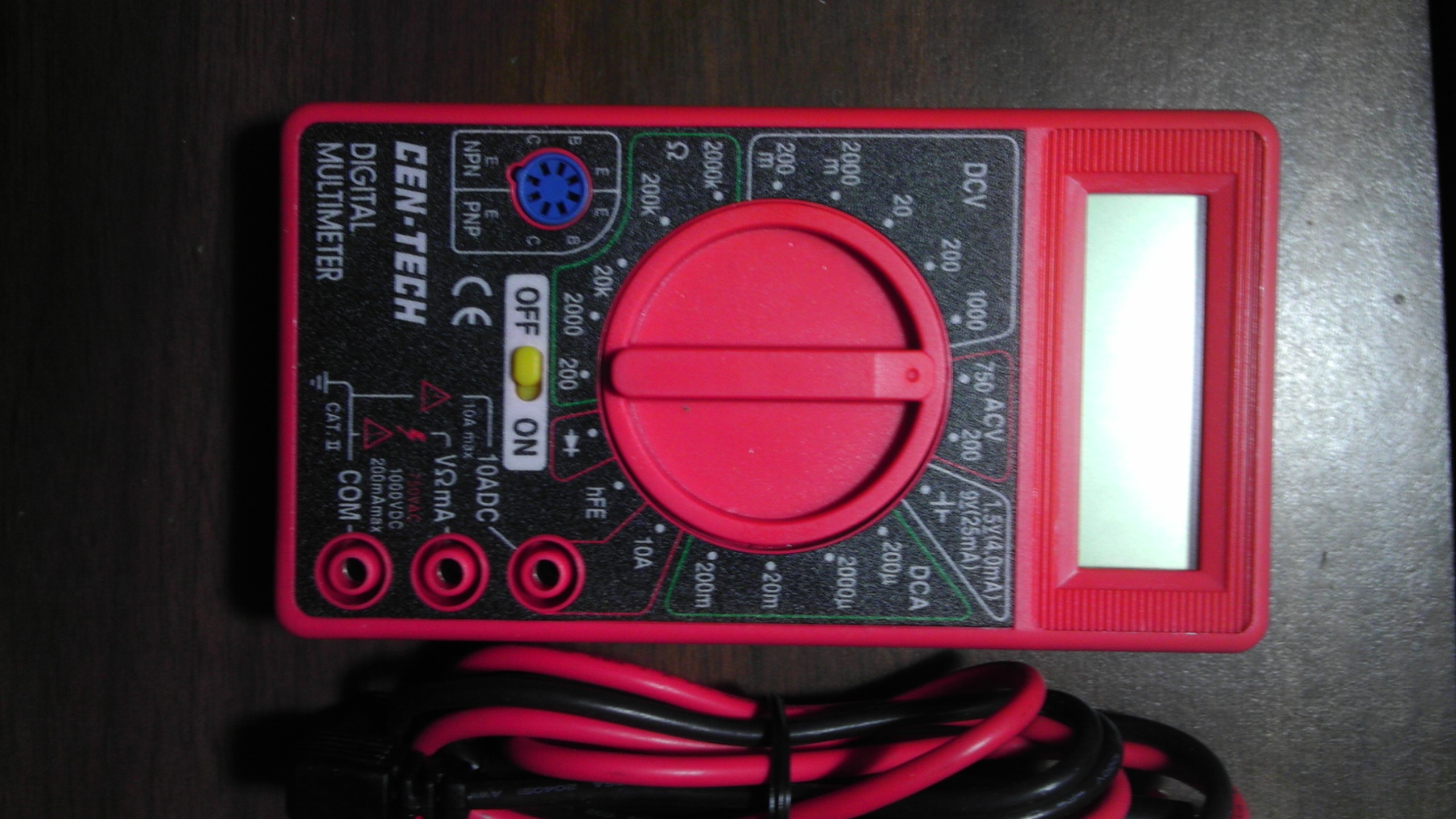

                Ok I tried to do what you said but the only thing that makes me think that I am doing it wrong is because the multimeter is showing the battery is dead and it is showing a -1.

                  I had to update this post, because the info I provided initially was incorrect. Ok, I have the same meter as a spare, and it acts kind of weird, too. It shows "-1" at first then it shows an actual reading if you hold your probes long enough on the fuse; you should see somewhere around 1.0. For some reason, it doesn't drop below 1.0 on my meter. As long as you're not seeing "1" on the meter to the far left of the lcd display, your fuse should be ok.

                      Checked the fuses while the tv is unplugged and it stayed at "1".......

                                  If your readings are indeed accurate then you have a bad Y and a bad Z. I've personally never seen both go bad at the same time, so you may want to remove the fuses and test them out of the TV.
