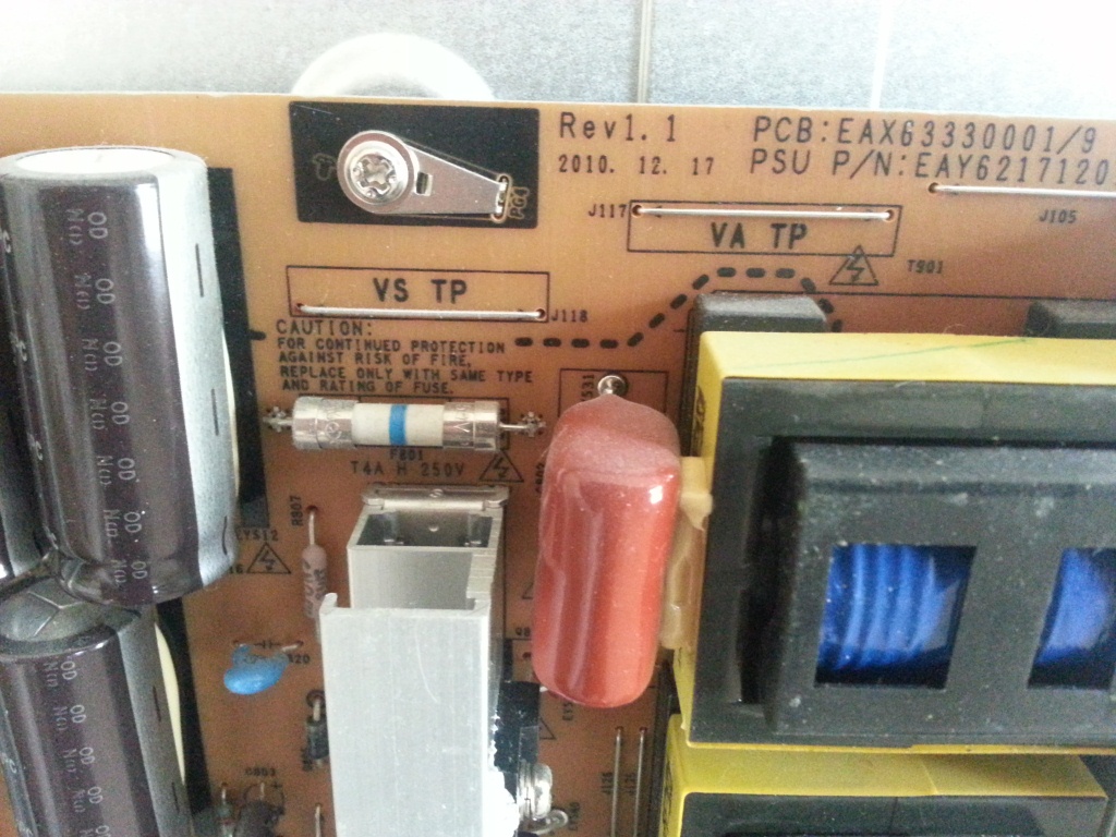

    That being said, I have what is probably a silly question regarding checking the fuses on my boards. I am not familiar with the way these fuses are mounted to the board. How do you remove them? I'll attach a picture showing what I am seeing.
    Thank you.
  • R_J
    • Jun 2012
    • 9624
    Re: LG 60PZ550 Plasma - No Sound, No Picture
    Those fuses are soldered into the board, check them with your meter, should be close to 0 ohms

      I checked all fuses I see and each was good.

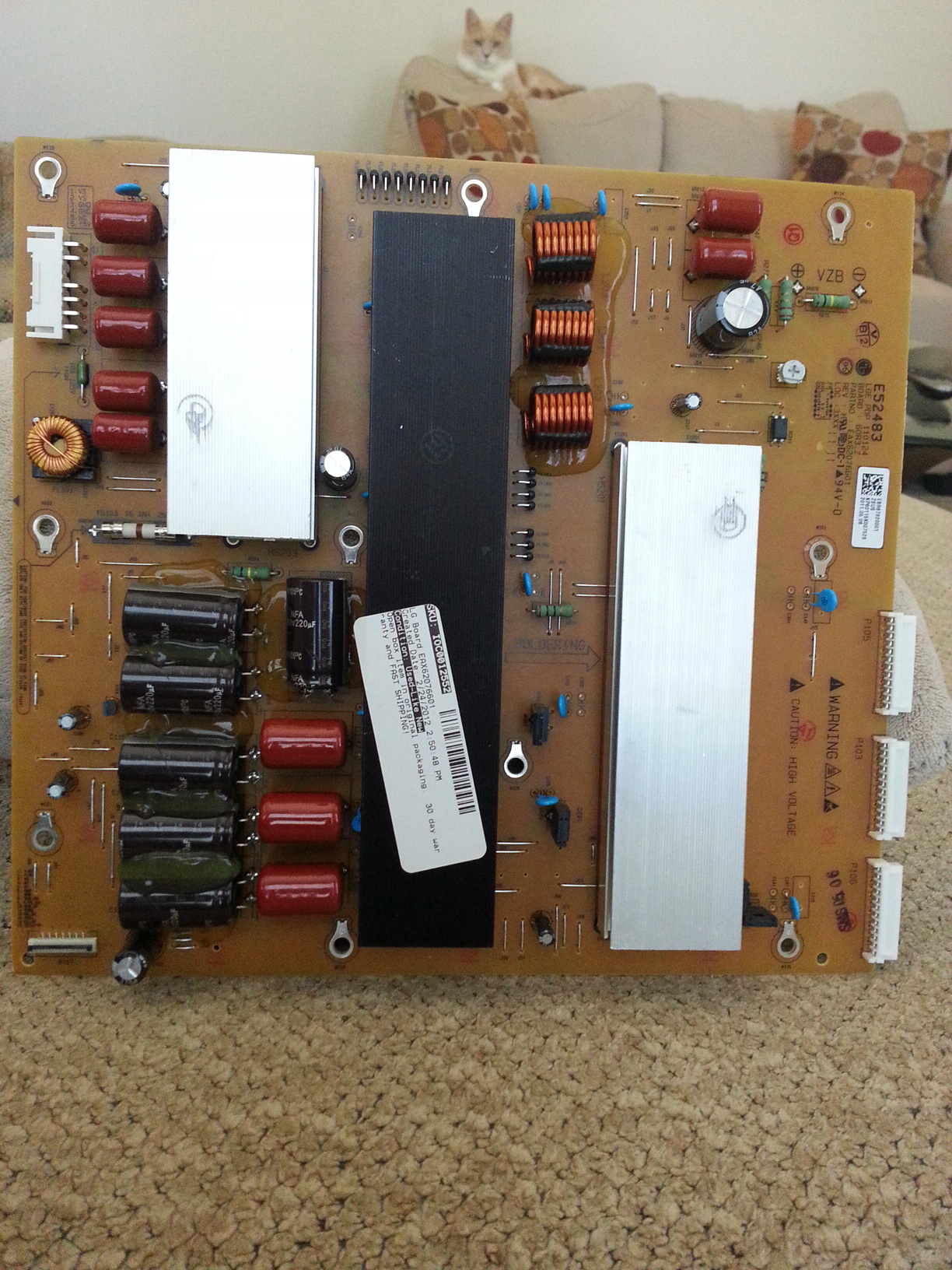

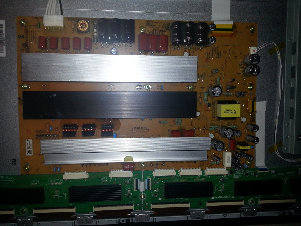

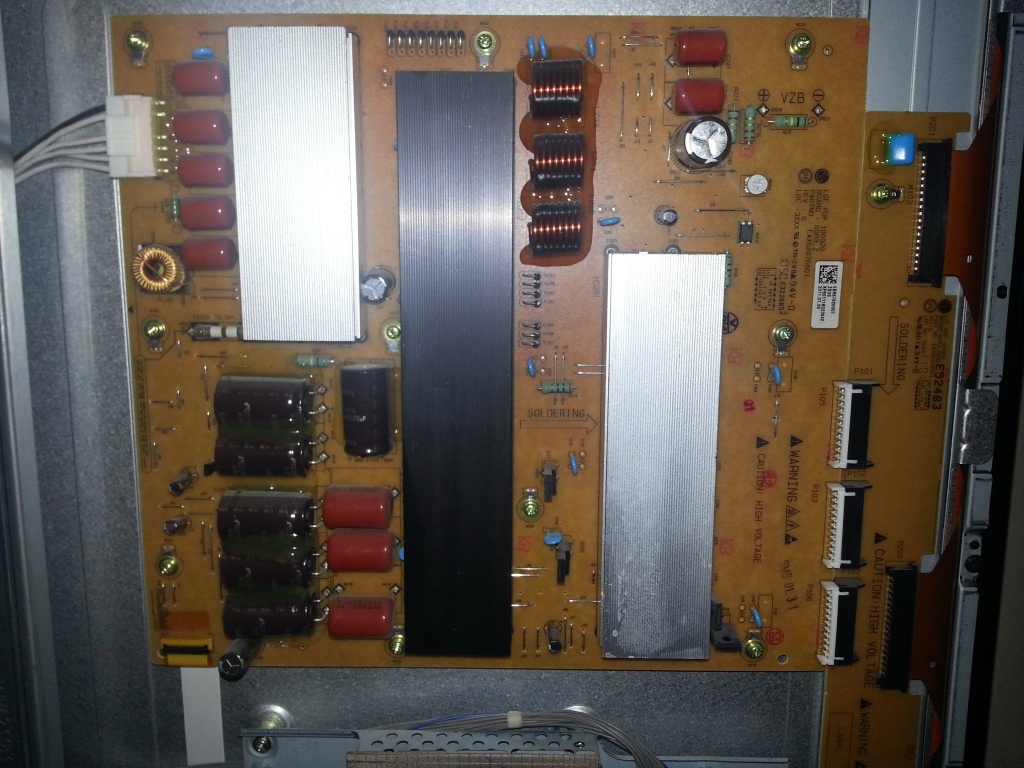

          Can you post a picture of the Y-sustain and Z-sustain boards?
          • southbound
            • Sep 2013
            • 21
            Sure. Here are some cell phone pics. If you want more detail, let me know and I'll post clearer ones. Thanks.

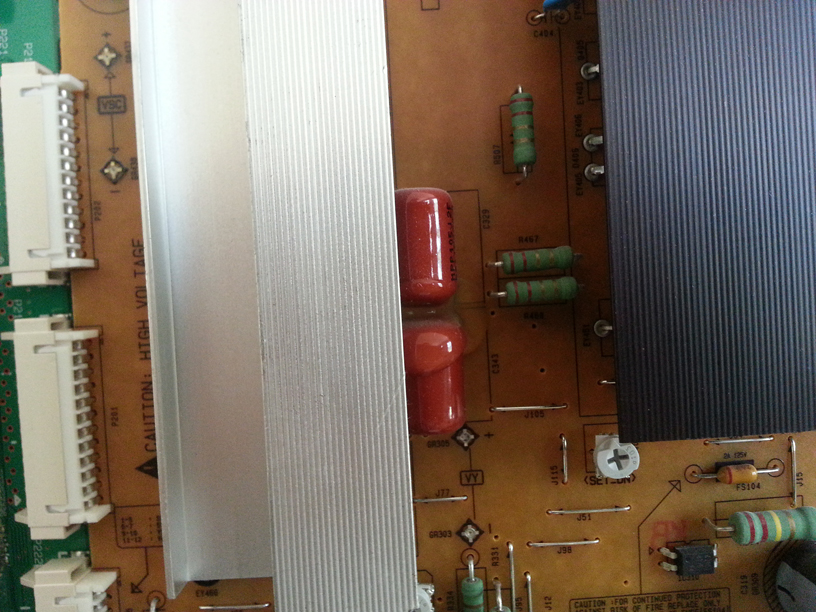

              OK, on the Y-sustain, there should be some points or components marked Vsc and -Vy, do you see these? They may look similar to the "Vzb" marking on the Z-sustain in the top right corner.
              • southbound
                • Sep 2013
                • 21
                I see them.

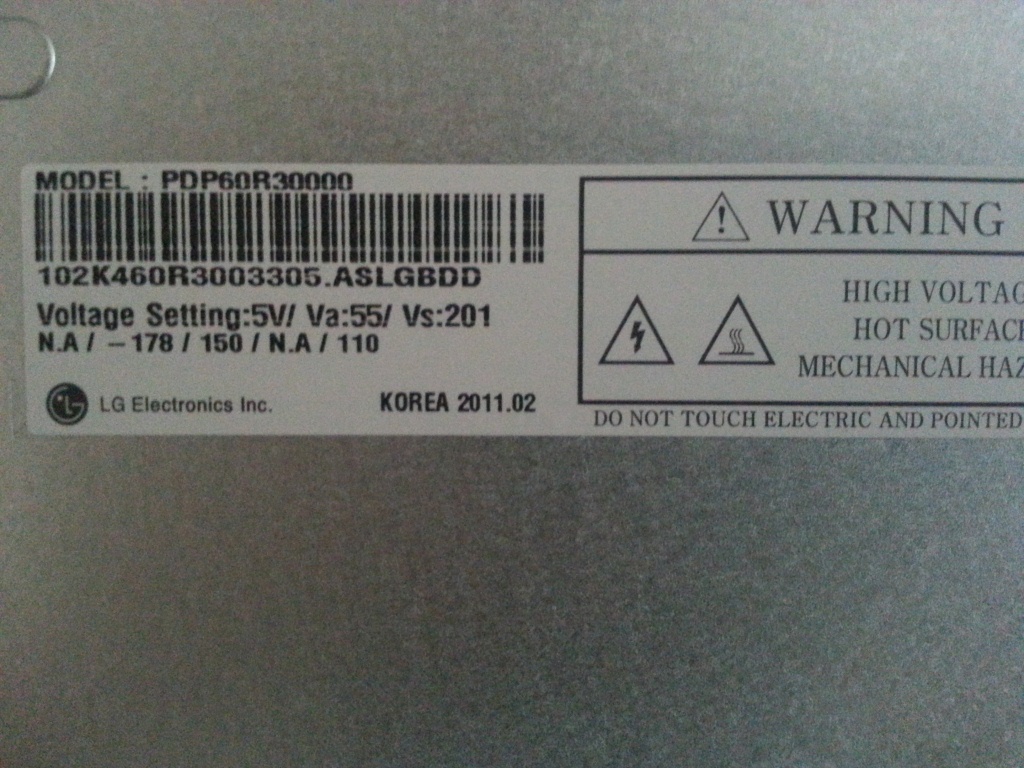

                    The readings on the Y-sustain look good: Vsc = 150.4v , Vy = -178.3v
                    {tag calls for 150v & 178v, respectively}
                    I didn't know if you wanted me to check the Vzb on the Z-sustain board, but I did and when the set powers on it will climb up to ~6v then slowly bleed down.
                      It looks like from your Vzb reading the Z-sustain is failed then.

                            Sorry, I missed your previous post. Hope the swap fixes it. As for causes, I'd be thinking that there's a short on the Z-sustain dragging the Vzb down with it. Possibly the SUS-DN FET/IGBT shorted. Repairable, but will cost at least $20~$30 in parts plus time to diagnose.

                                  I know that when ordering a replacement, I should look to get the same Rev #.

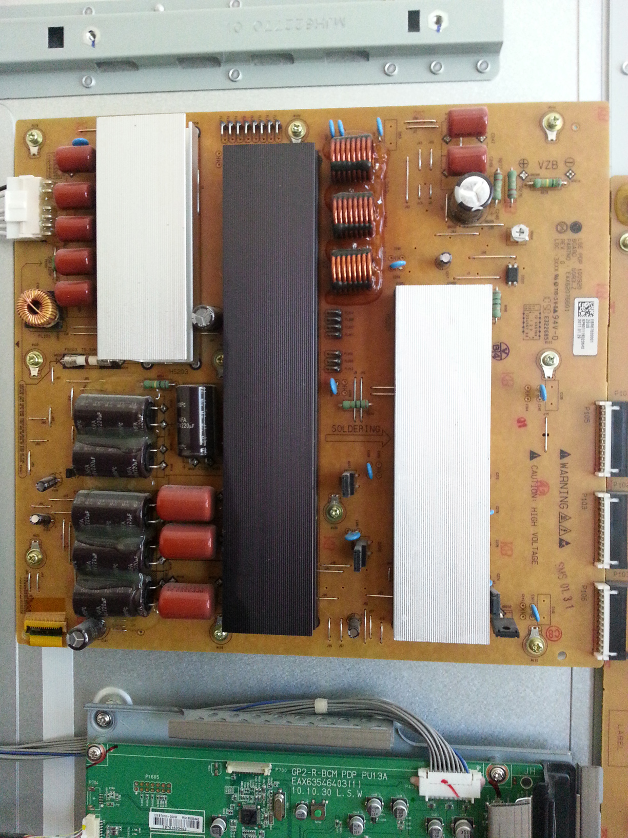

                                  When I was shopping around for a replacement Z-Sustain board, the EAX62076601 rev G boards were going for $50 and up. I came across one at indyoutletcenter.com for only $2, but it didn't show the revision. Since it was less than $10 delivered, I took a chance and ordered it. It just arrived and is Rev H whereas my original is Rev G. Do you think it's safe to try this one or is there a risk of damage and should just order the same rev board?
                                  Thanks.
                                    Do you notice any substantial layout or connector differences? How about a comparison photo?
                                    • southbound
                                      • Sep 2013
                                      • 21
                                      No differences that I have picked up. Here are some comparison pics.
                                        That should work fine. If one of the inductors (copper coils) or large capacitors were missing, it might have been for a 42", for example, which would not work well. But it looks identical to me, so it's probably some minor revision like changing a component supplier to reduce costs.
