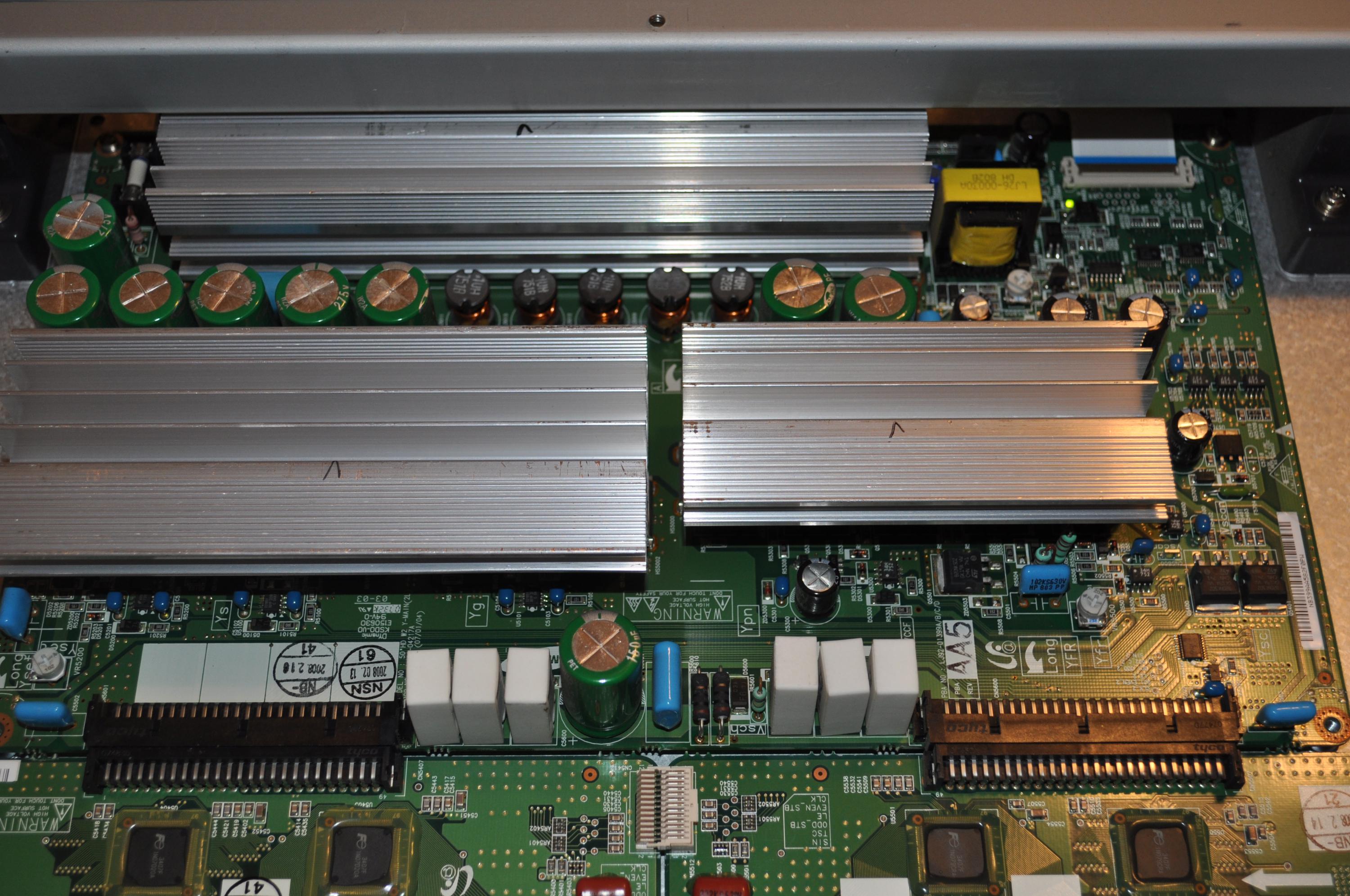

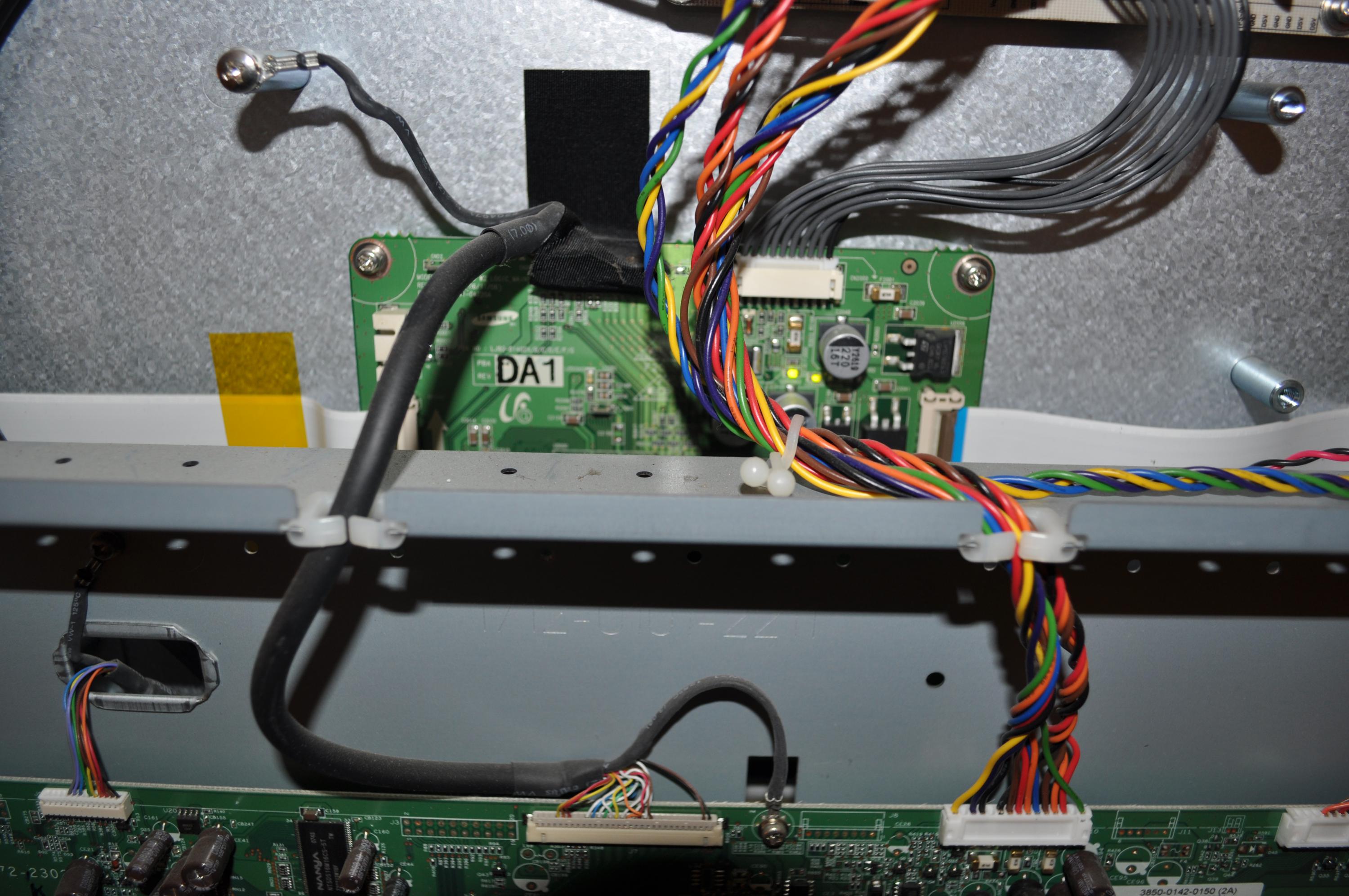

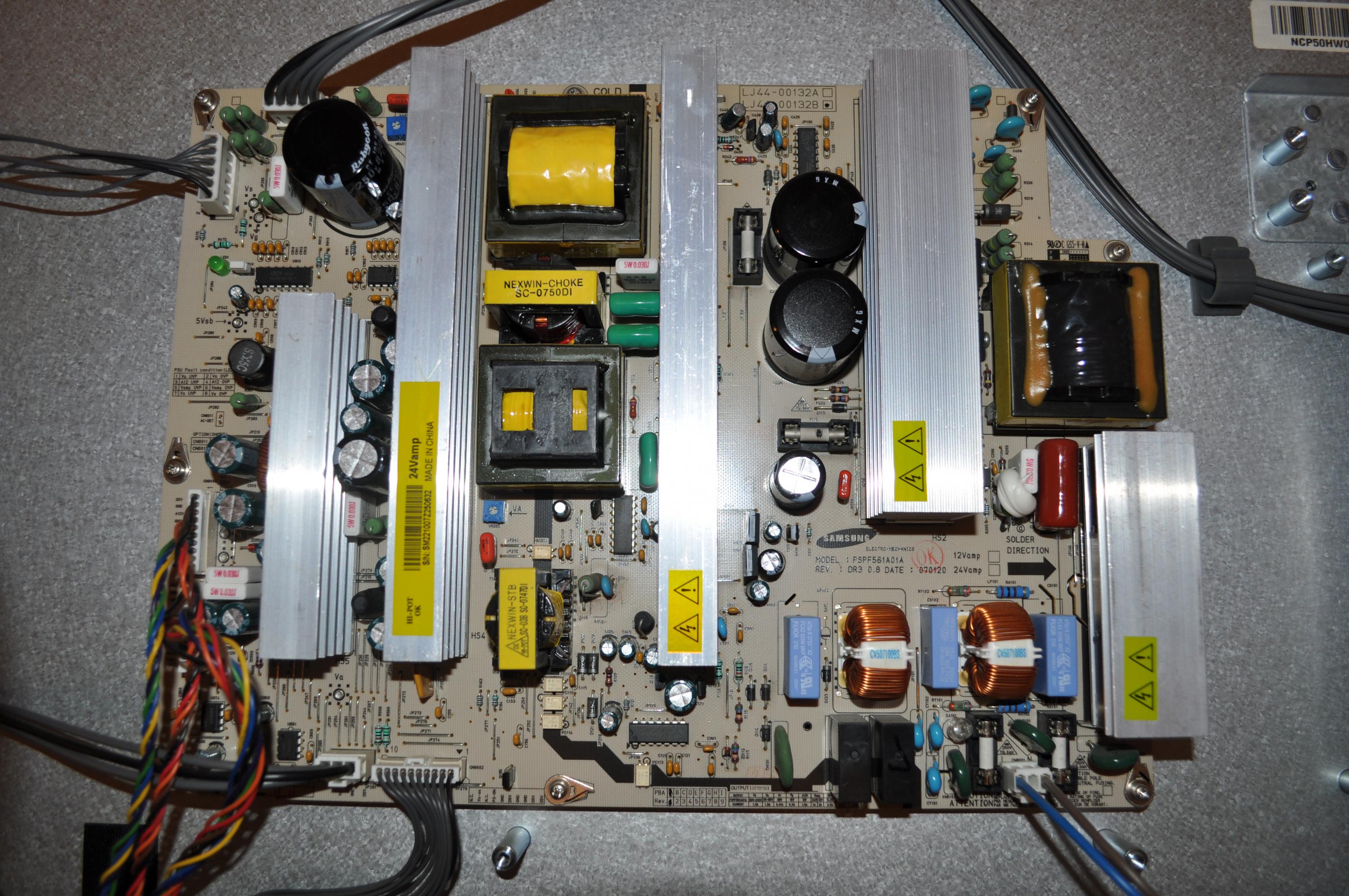

    Re: vp50hdtv20a Picture issues
    Here are some pics. Set does power and doesn't go into shut down just no picture. I did find a swollen cap on the one board and replaced it with no change.

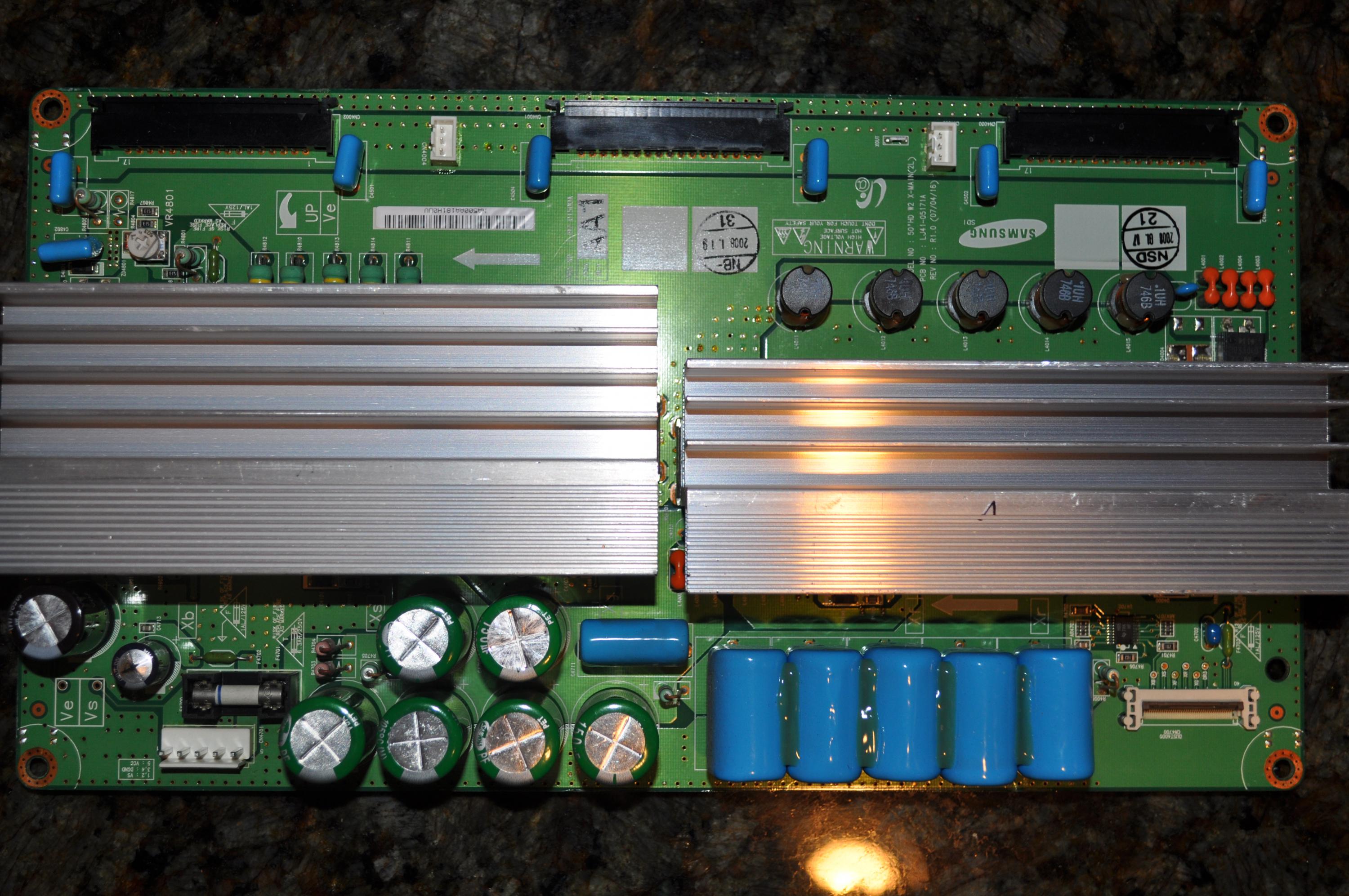

      More

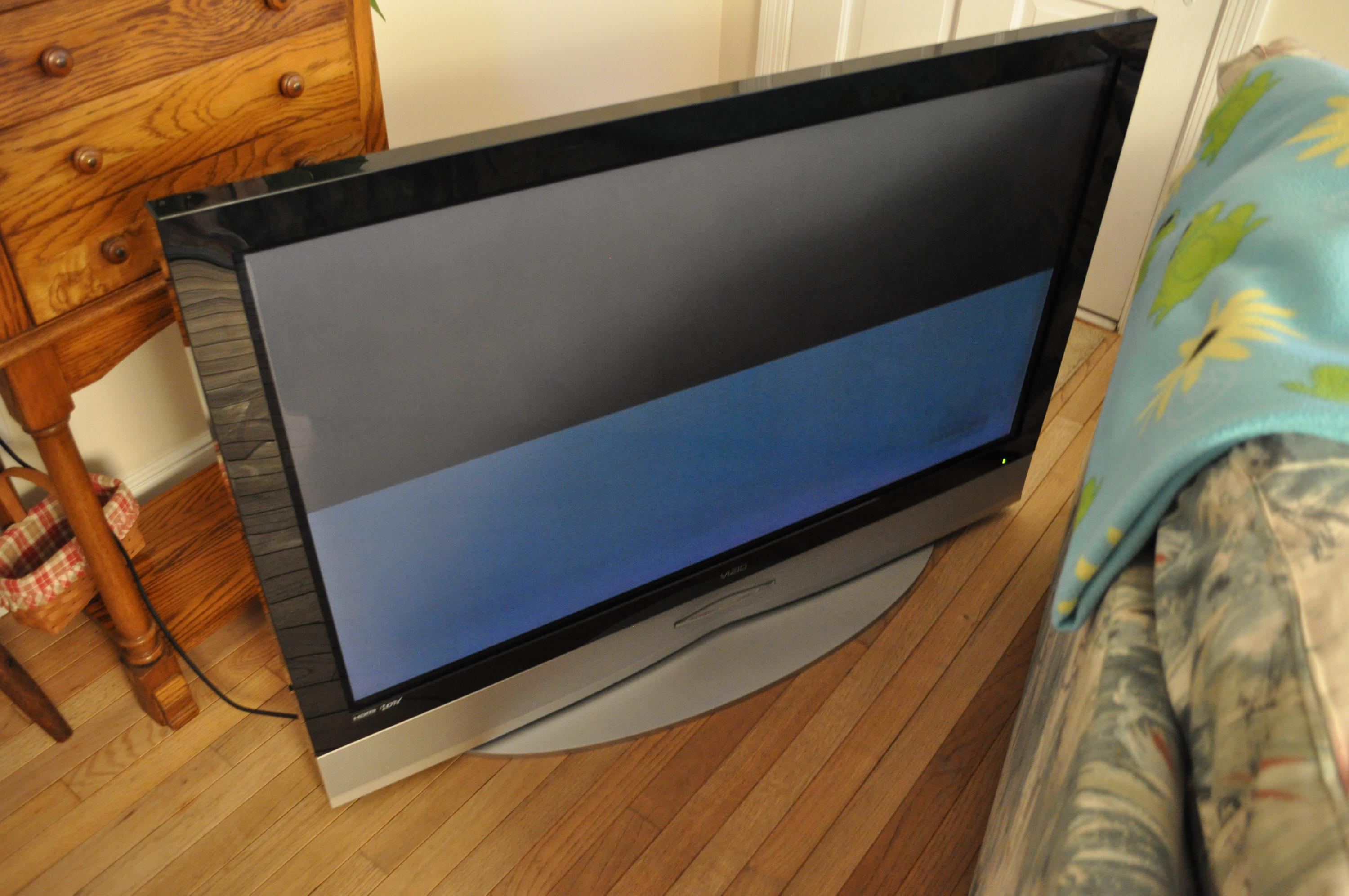

        Ok Found a small defect on the upper buffer chip. Removed the chip and half of the screen is now lit.
        • landyboy
          • Apr 2013
          • 443
          Not very brightly lit but lit.
          • landyboy
            • Apr 2013
            • 443
            Here is a picture of the screen with the upper buffer board removed. I have it connected to a Blue Ray player and can hear sound but thats it. Does it require the upper buffer board to actually show the picture or is there something else wrong?
              Yes upper buffer needs to be connected, its in a series circuit, if no upper buffer present, sustain feed does not address the lower.
