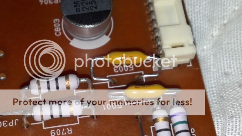

                  Ok did a ohms test on the three fuses.
                  Fuse 1 = 0.000
                  Fuse 2 = 0.000
                  Fuse 3 = Opened.
                  Seems like replacement of fuse #3 on inverter board.
                  Going to take that puppy out and replace it.
                  Only thing is what type and amp is that fuse? Could not tell from schematics, I'm not good at reading those.
                    Re: Sony KDL40S2000
                    Usually written on the device, if not on the board next to it.
                    • Horty24
                      • Oct 2011
                      • 54
                      Re: Sony KDL40S2000
                      Looks like f10? Sound right?
                        Re: Sony KDL40S2000
                        That is PICO/PICOII Fuse made by LittelFuse (LF marking) looks like 10A.
                        http://www.littelfuse.com/Products/F...O%20Fuses.aspx
                        Blowing the 10A fuse, I would check all the MOSFETs that being fed by this fuse.

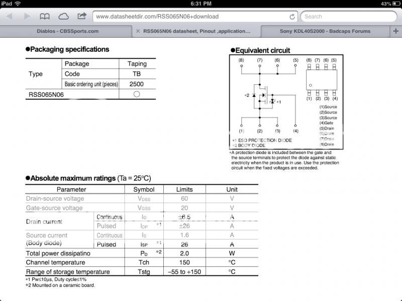

                                You are correct there are 10 per board. They all visually look good. How do I test them?
                                They are MOSFET RSS065 N06 550
                                  Re: Sony KDL40S2000
                                  Look up the spec sheet and then take the RESISTANCE reading between S and D PINS.

                                    Ok on the top inverter board I'm getting .6 on each of the 10 MOSFET.
                                    On the lower board I'm getting 5.3 and just continues to drop. When i go from MOSFET to MOSFET it picks up where I left off on previous MOSFET and continues to drop to lower and lower resistance.
                                    • Horty24
                                      • Oct 2011
                                      • 54
                                      Re: Sony KDL40S2000
                                        Re: Sony KDL40S2000
                                        What scale of the Ohm meter is set to? The reading is 0.6 Ohms? 0.6K Ohms< same for the 5.3 reading, Ohms, K Ohms, MOhms? The bottom line is that it does look like you do have bad MOSFETs on the top board. The hard part is that the circuits for each Inverter transformer drive circuits are in parallel so if one shorted out, it can make it looks like all of them are bad on the top board. You can leave out the blown fuses and see if all the MOSFETs on the top board will still show low resistance.
