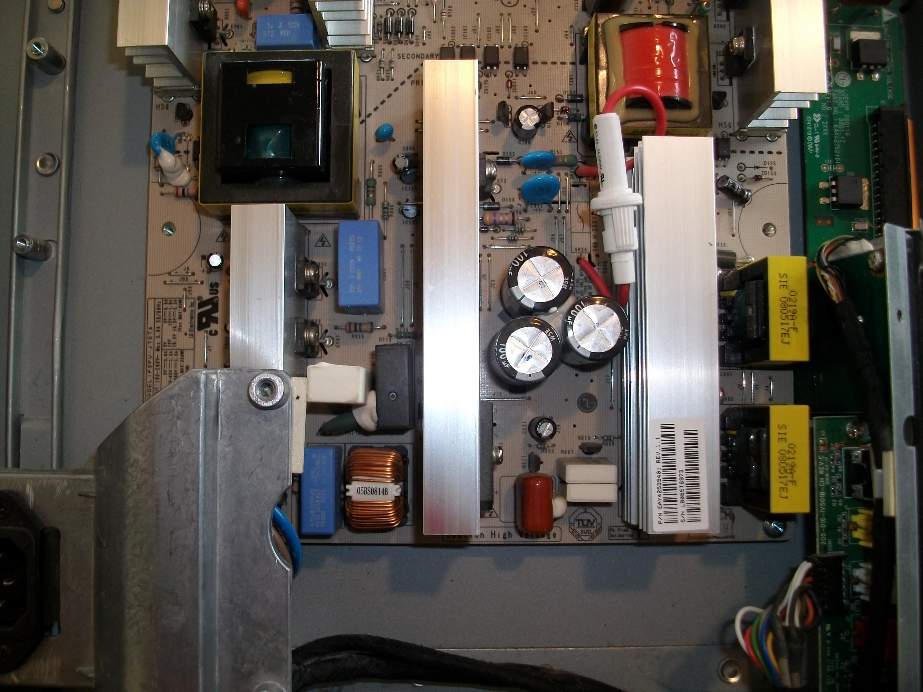

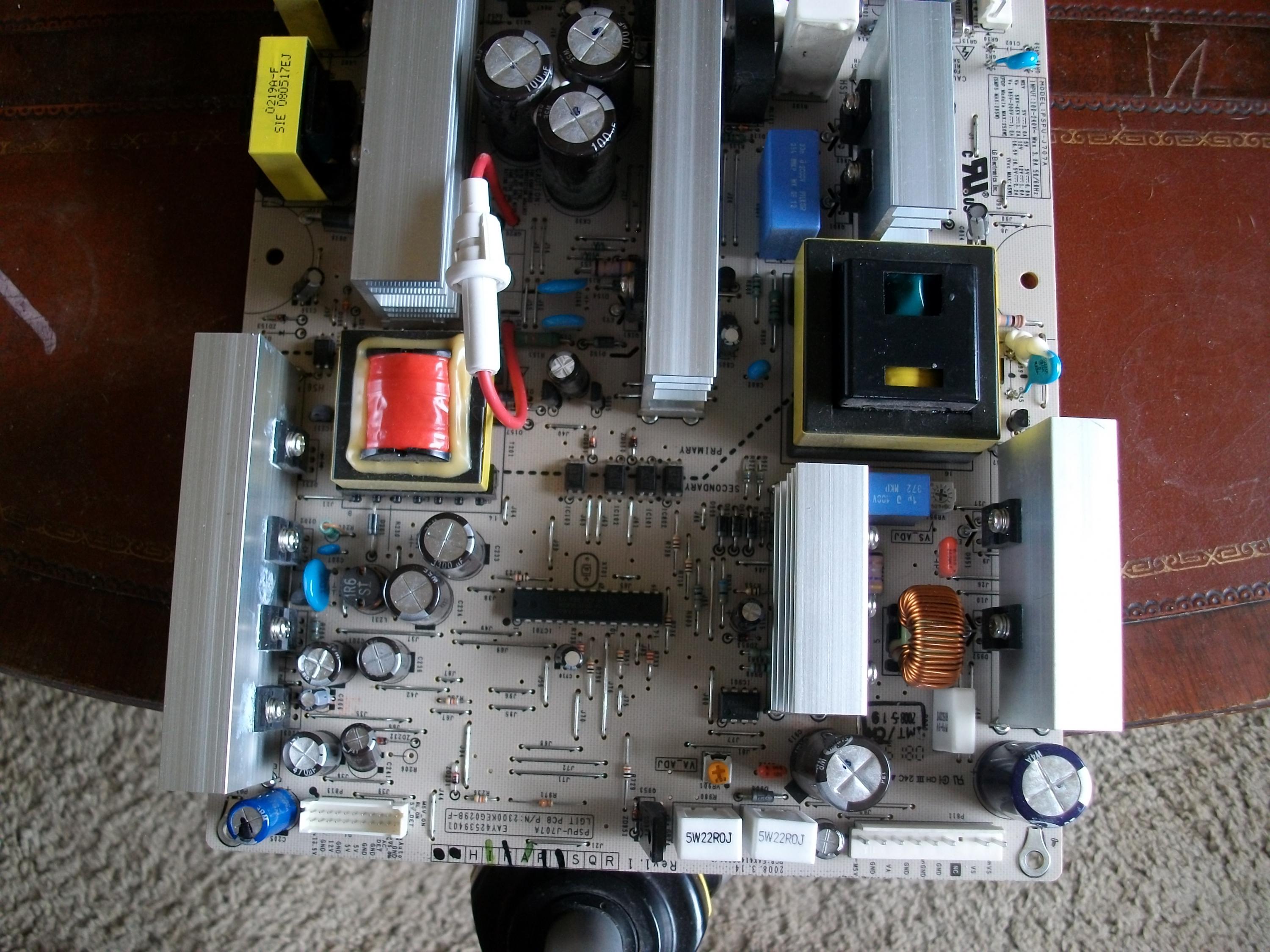

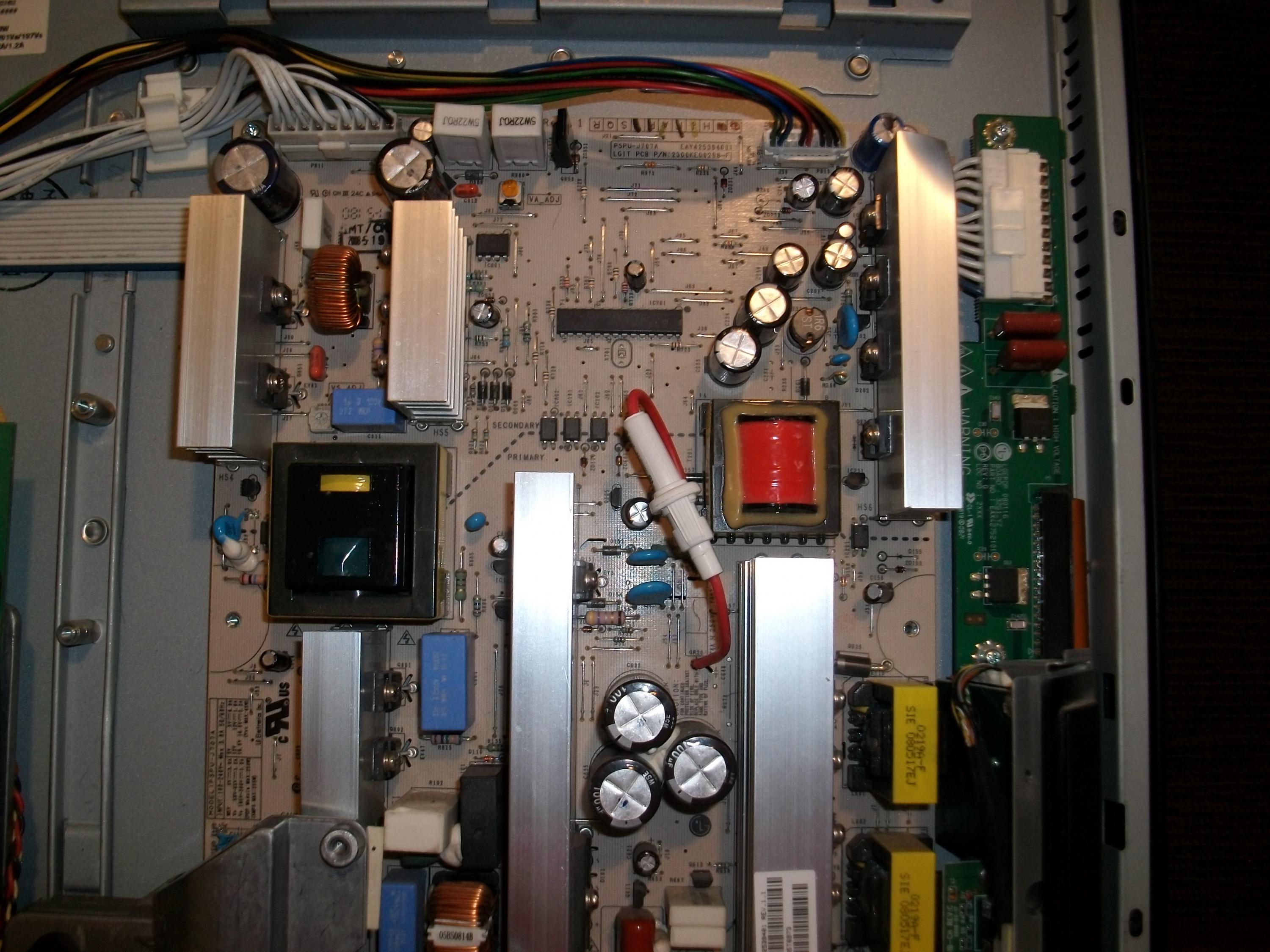

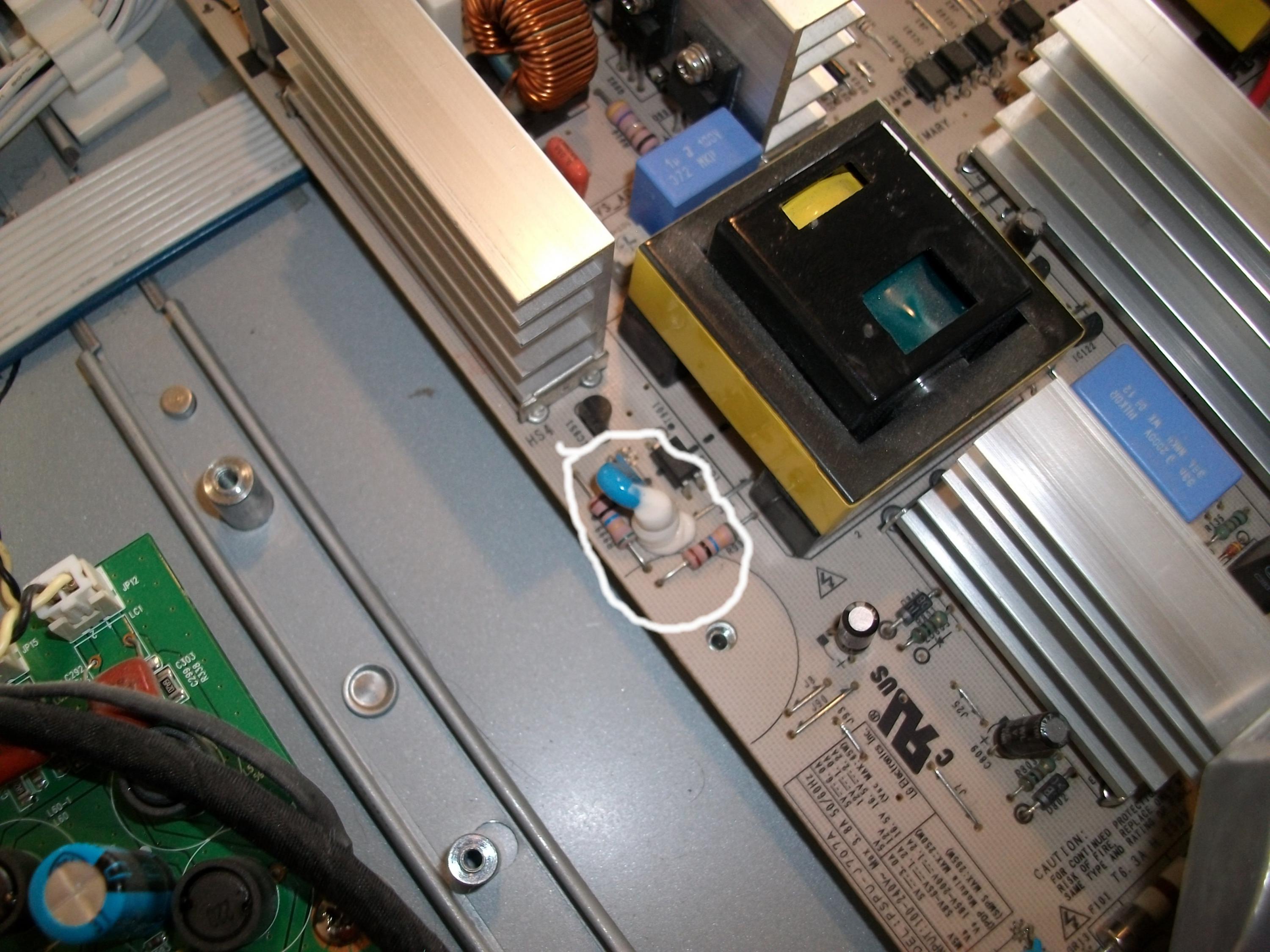

Hello, picked this up a why back. first time working on a plasma, This tv is dead no power . checked voltage on PSU get no readings at all. fuses all check out to be good.unplugged every thing on PSU no voltage.also caps look good. hope you can help.
insignia ns- pdp32-09 no power
Tags: None
Re: insignia ns- pdp32-09 no power
Check standby diode. Check any fusible resistors.Please do not PM me with questions! Questions via PM will not be answered. Post on the forums instead!
It will be near the standby transformer, which is the smallest one on the board.Please do not PM me with questions! Questions via PM will not be answered. Post on the forums instead!
OK, check voltage across the small (<100uF <50V) capacitors on the primary side of the power supply. Something is going to be missing.Please do not PM me with questions! Questions via PM will not be answered. Post on the forums instead!

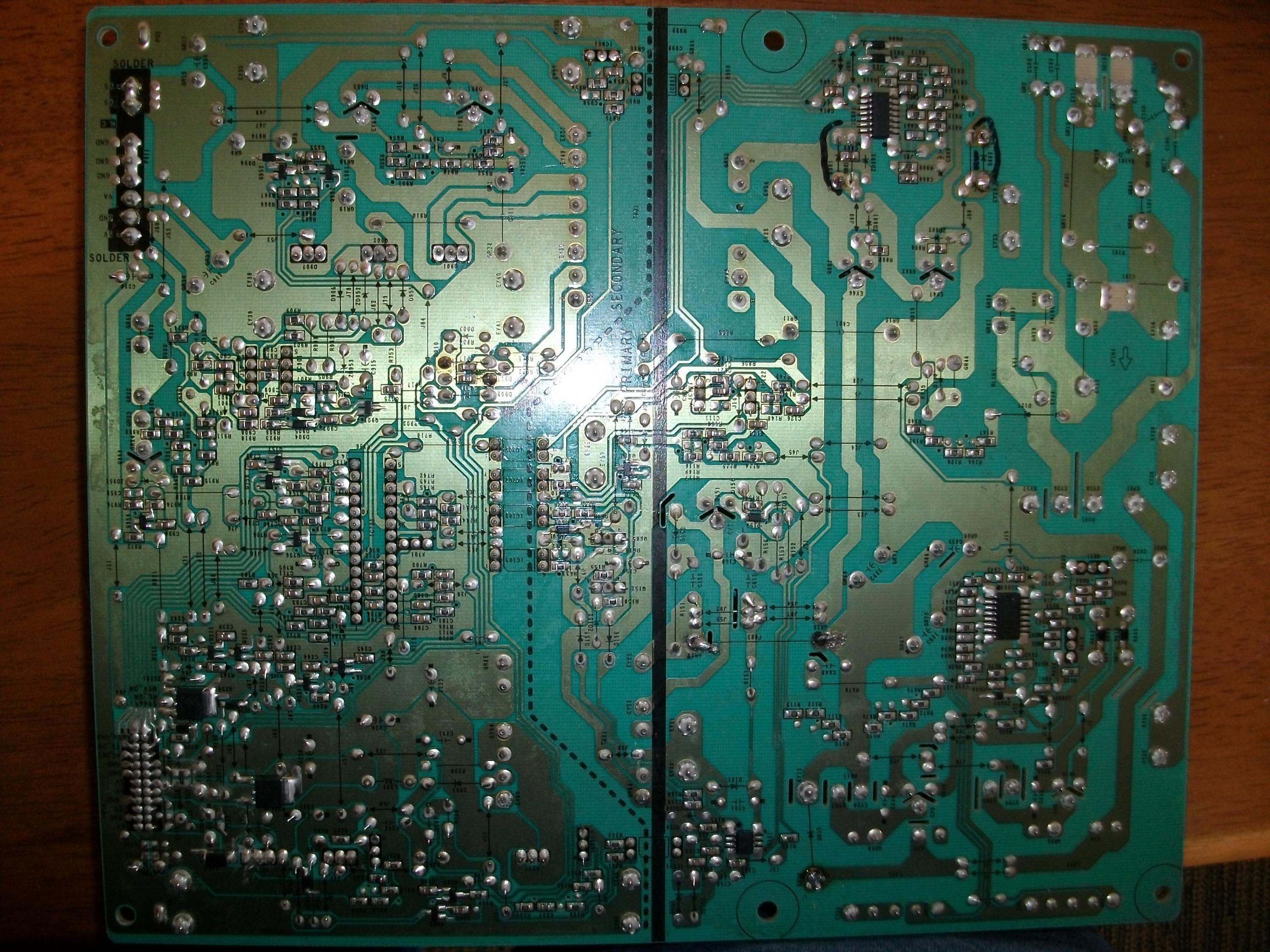

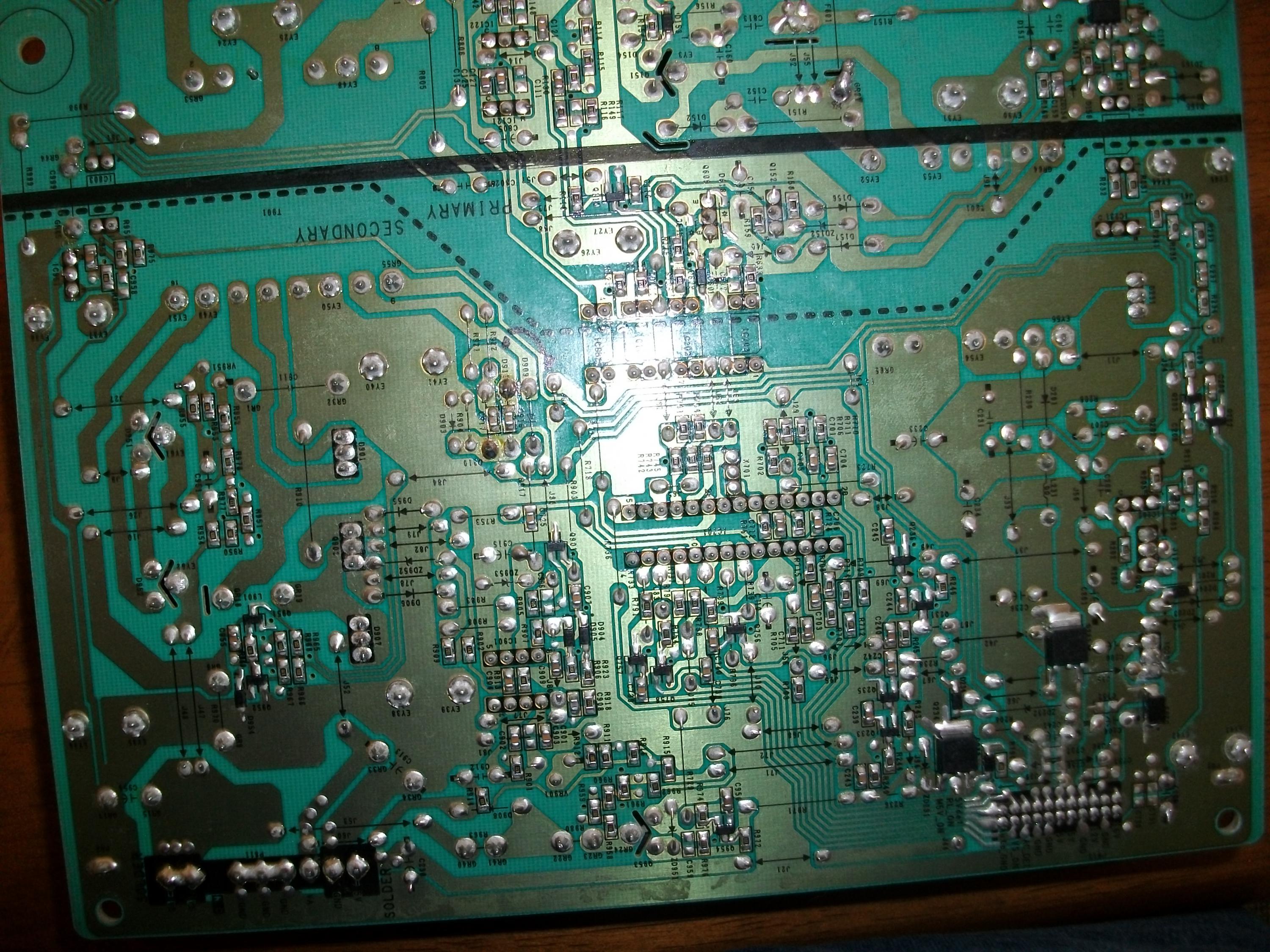

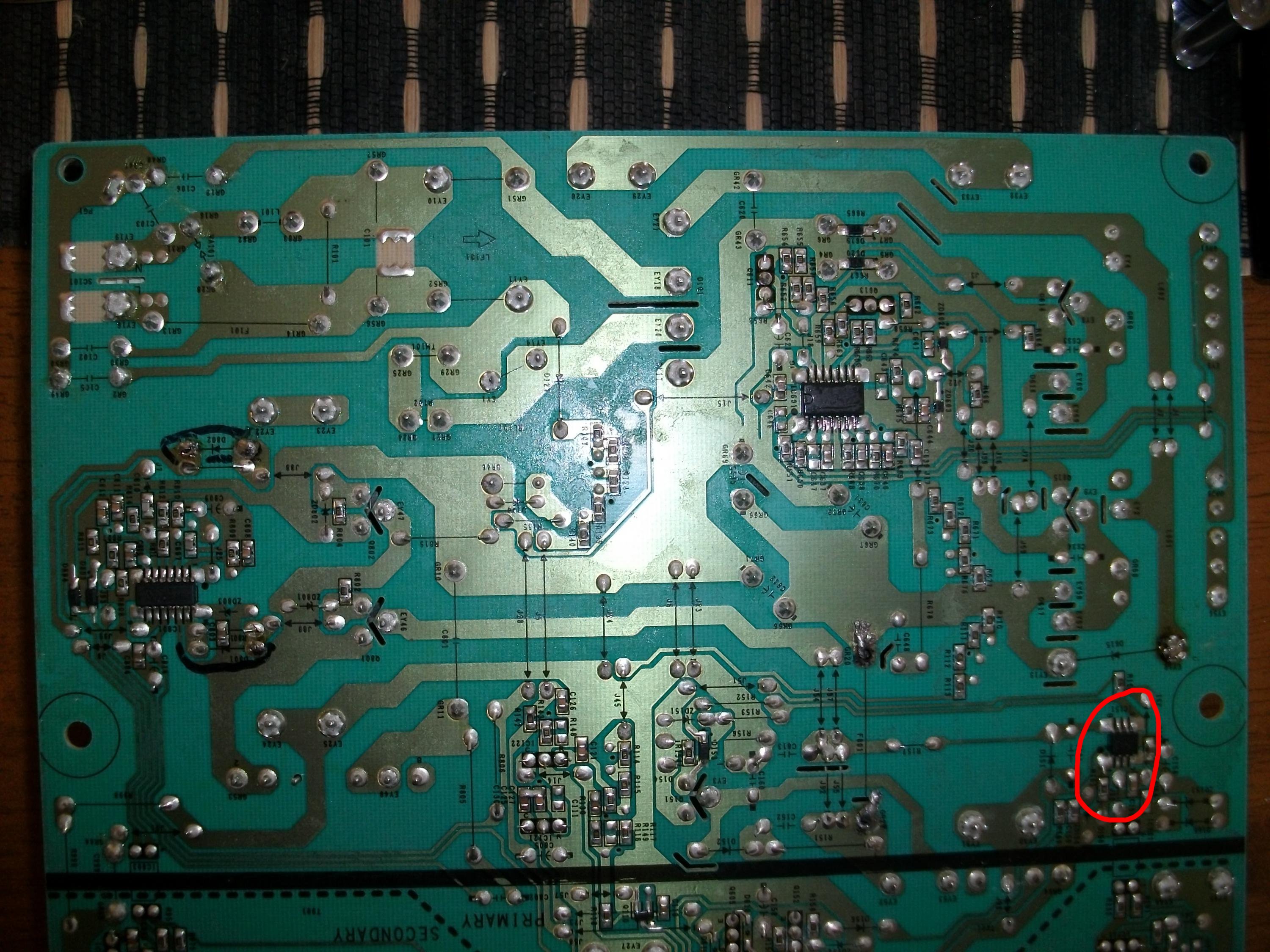

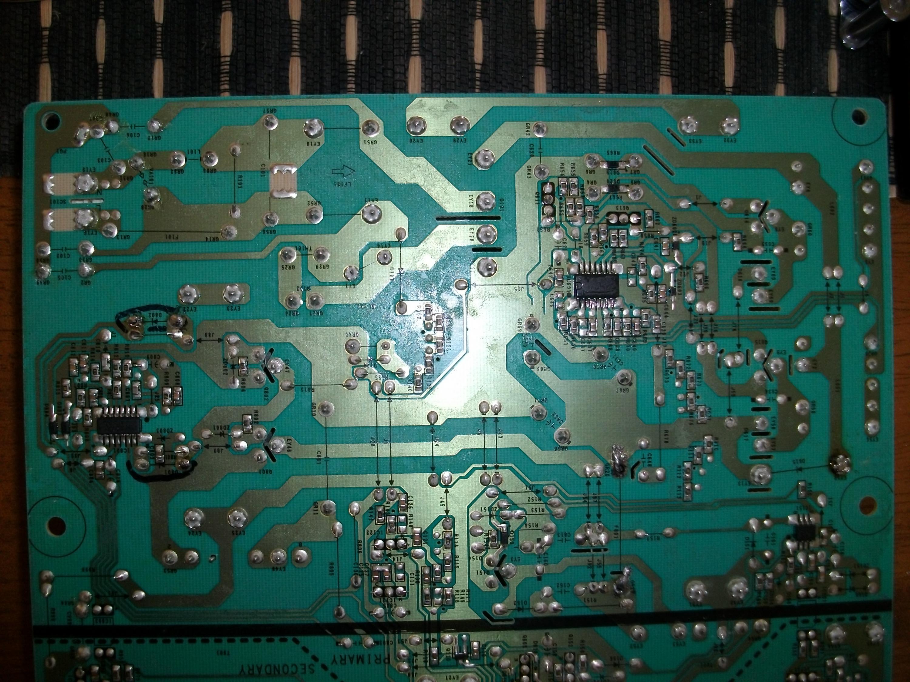

OK, can you get a whole or split pictures of the top and bottom of the power board?Please do not PM me with questions! Questions via PM will not be answered. Post on the forums instead!
For service manual, schematic, boardview (board view), datasheet, cad - use our search.Comment
For future reference, bottom refers to the other side of the PCB. Can you get one of the other side?Please do not PM me with questions! Questions via PM will not be answered. Post on the forums instead!
Here's pictures of bottomAttached Filesif you find these attachements useful please consider making a small donation to the site
Part # of this chip please.Attached Filesif you find these attachements useful please consider making a small donation to the site
OK, check resistance between pins 4 and 6.Please do not PM me with questions! Questions via PM will not be answered. Post on the forums instead!
0.1 ohms, or single "1" meaning infinite/over-range?Please do not PM me with questions! Questions via PM will not be answered. Post on the forums instead!
