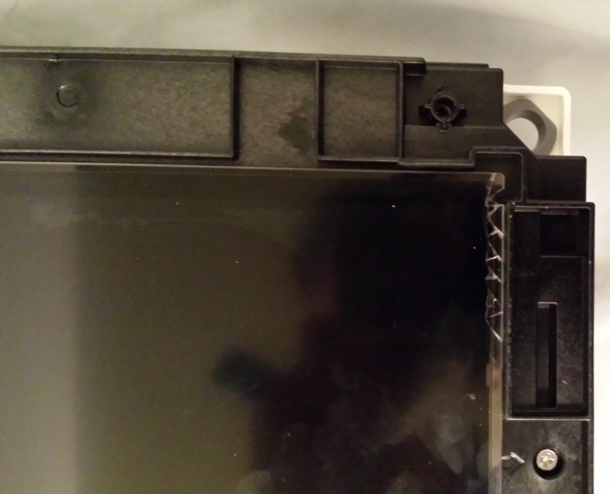

    Talk about bad luck. I bought a Sony Bravia KDL-32L4000 for $50 today. I took it all apart and determined that it probably was the tcon board and not the panel that was causing the vertical lines and flickering. Then I cracked the panel somehow. Its not too bad, lower right corner, about the size of a quarter. Kills any chance of selling it for a profit though.

                      OK, I'm home from work now. I just opened the set again to get the part numbers for the panel and figured out how I cracked it. When I had the frame off, I set the TV upright so I could inspect the tabs and the panel board. Then I did something stupid. Rather than lay the TV back down, I put the frame back on while it was upright. This caused the panel to not be seated properly and it cracked when I put the screws in because it got pinched. Its a tough lesson to learn but it could have been worse, like if it was a more valuable TV. In a way it makes me feel better knowing exactly what I did wrong because I can avoid making this mistake in the future. I hope someone will read this and avoid making the same mistake I did. Pic attached.

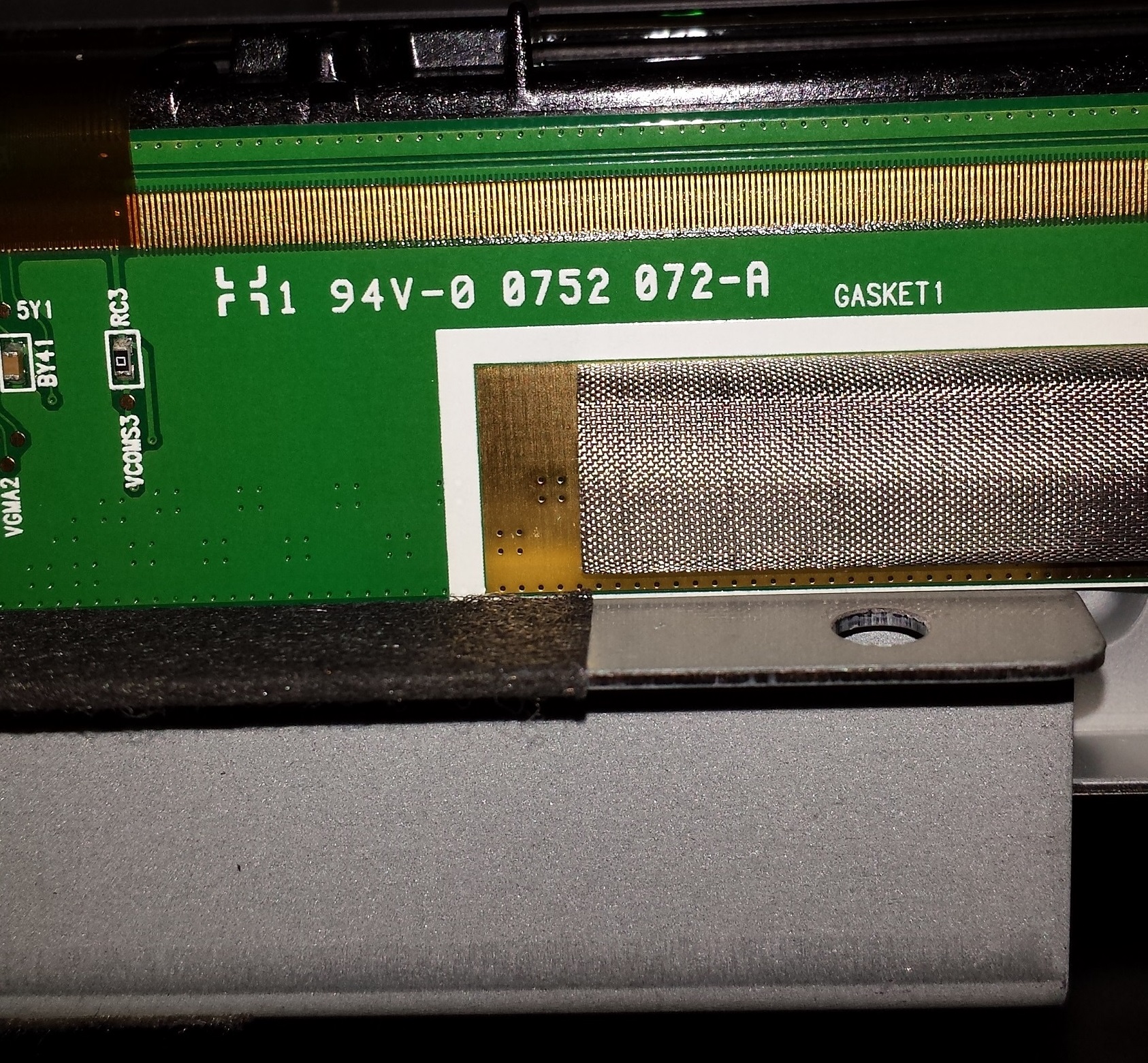

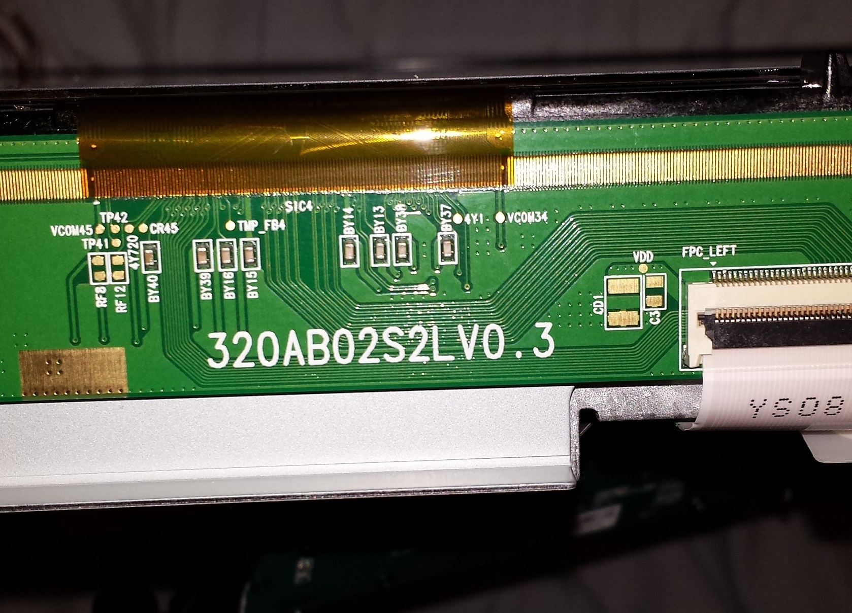

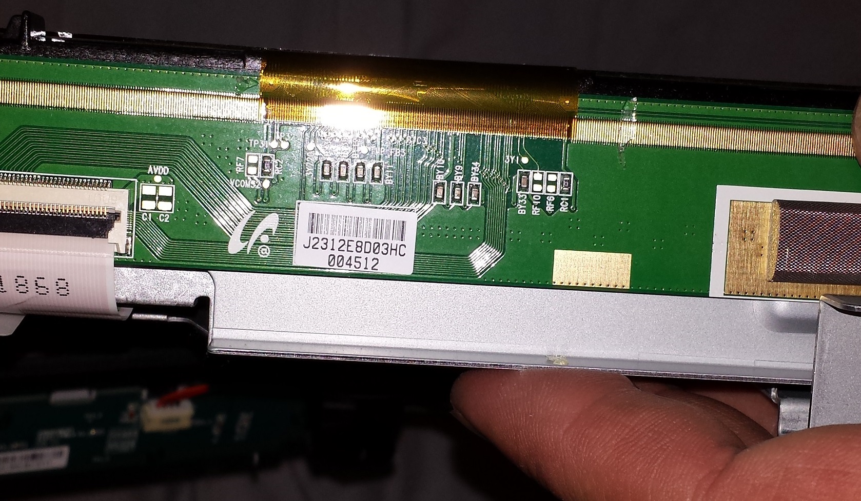

                      Now, as for the part numbers, I found 3 sets of numbers on the panel board. The numbers are:
                      1) 94V-0 0752 072-A
                      2) J2312E8D03HC 004512 (on sticker)
                      3) 320AB02S2LV0.3 (This would be my guess as the part number.
                      I've attached pics of all the numbers too.
