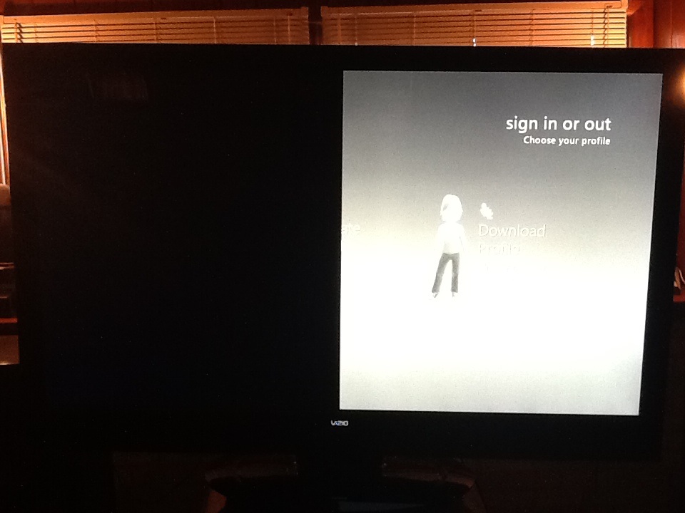

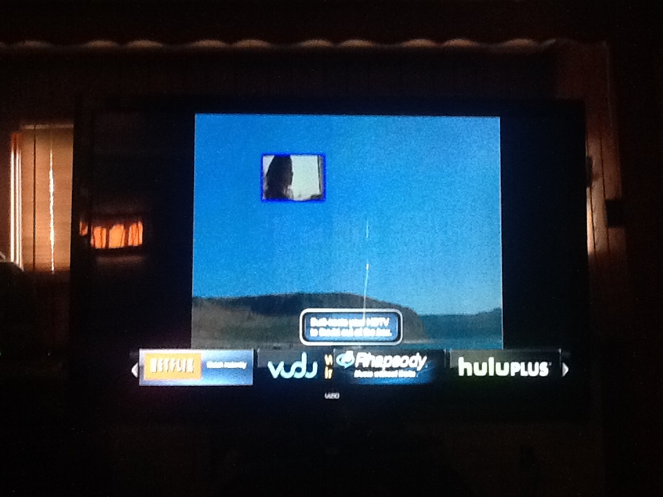

    A friend gave me this TV. They reimbursed him for it under extended warranty and told him to dispose of it.
    It works fine except....... I only get the right half of the screen. Sometimes a quarter of the left side will play. All input modes seem to work. Removed and re-seated the ribbon cables on the t-con and inverter boards with no change. It did something funny last night. I was playing a DVD through it and the left side was still out, but then it started like "advertising" banners on the left side sorta like it was on display and telling all the features the set has.
    I have did the restore defaults from the menu and all I get now is half screen. Nothing on the left. flexing the screen does not seem to bother it. I am thinking the T-Con board is bad.
    Any suggestions for a newbie to LCD/LED TV??
    Thanks and great forum,
    Dusty

    I'm not sure if you've solved your issue. If not, can you post a pic of the screen with the TV turned on?

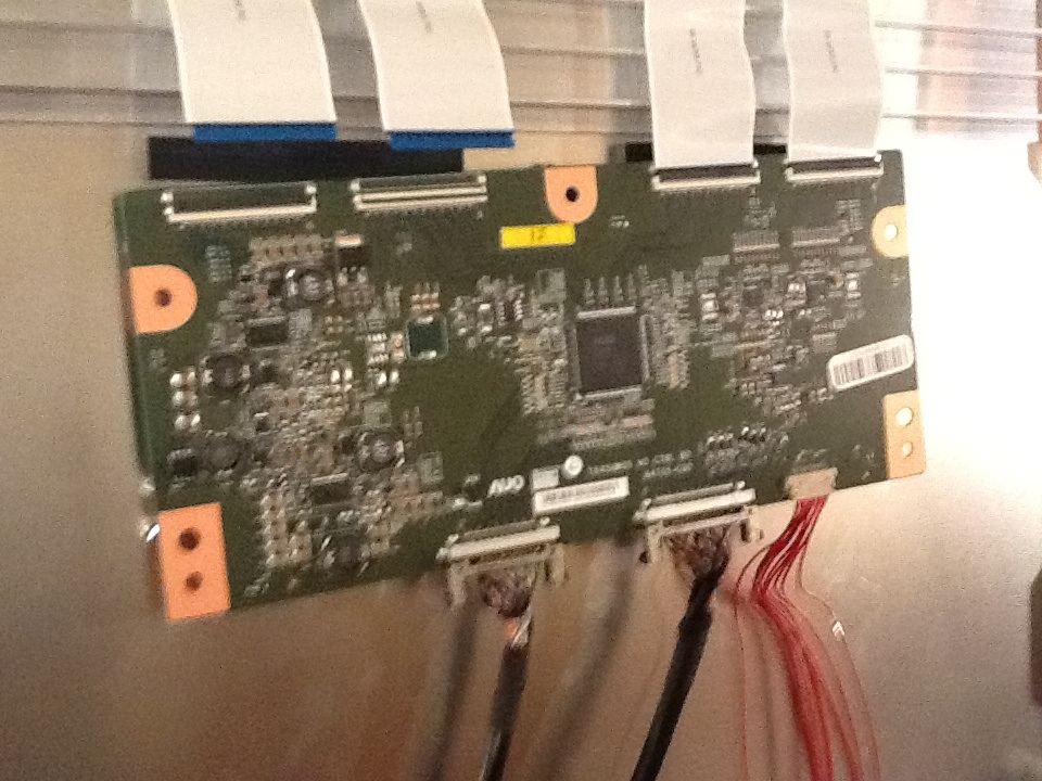

      Re: Vizio Problem M3D650SV
      Tried new T-Con board. Same picture. Any ideas appreciated.
        Probably a defective panel if the t-con didn't fix it.
          Any possibility that the LED DRIVER BD could be bad? The entire screen seems to light up when I turn it on. Just only shows the right half of the input signal though. I have a DMM if there any voltage/continuity checks that might be helpful.
            It wouldn't be such a sharp cut off if it were an LED strip problem, and you'd have no backlight on that side. LCD panel failure is becoming a very frequent occurrence nowadays, and it's very expensive to repair (whole panel swap), kinda makes me think it's deliberate.

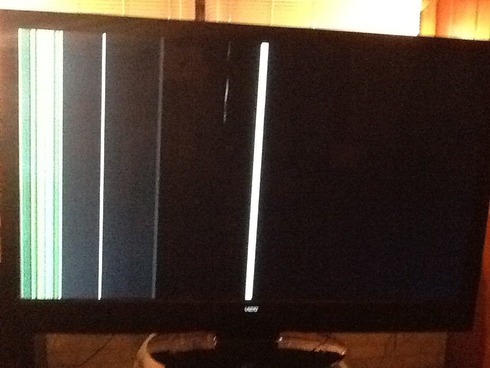

              Just got this on the screen. Don't know if it helps or not.
                I'd have a play with the tab bonds, but wouldn't expect any kind of permanent fix.

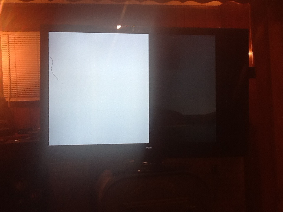

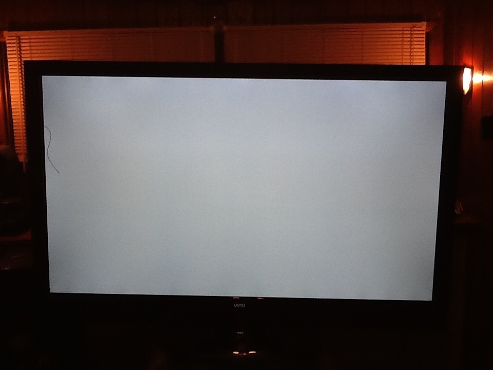

                  Checked the tabs and could not even get a flicker pressing on them. Unhooked the right side T-Con cables and it came on with a white screen all the way across. Does this info help?
                  Thanks,
                  Dusty
                      Another photo of the other side left loose. Hopefully this will help somebody.

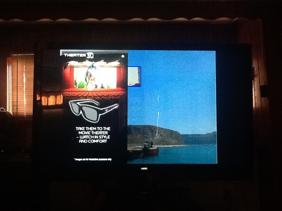

                        Update. Finally got the TV back in "retail" mode after a system reset. The built in advertisements seem to have no trouble displaying on the left side of the screen. I also have an HDMI signal going in. Could the panel still be bad even though the panel will display the ads? I am starting to think the main board has something wrong with it ?
                            If there is a constant picture on whole screen with advertisements on, it cannot be a panel defect. You would be wise to try a main board. However if it only intermittently shows on the whole screen, it could be a bad panel. I have seen panels that have defects on the power traces on the glass itself that are intermittent failures and almost impossible to replicate. Twisting, pressing on tabs. Nothing seems to help in that case.
                              I'm going with main board simply because its a Vizio and when you are getting a picture on the whole screen it looks good. I haven't seen one with this particular problem but nearly every Vizio I've had my hands on has needed a new control board.
