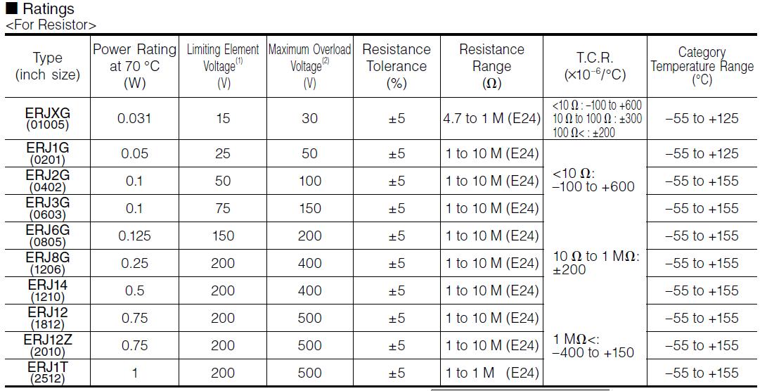

            Don't know anything about these TVs but I'm going to suggest what we are looking at is a fusible link or 0 ohm resistor which has departed this world not an inductor.
              Re: Sanyo DP42647, No Sound, No Picture, Can Switch ON/OFF by Keypad, Remote not avai
              here's some panasonic data as a guide for metal film. basically dimensions determines the package code. package code determines the wattage.
              I'd expect either a shorted board or maybe surge but someone with LCD experience will best guide you.

                im with tw on this one. you are looking at a 0 ohm resistor.
