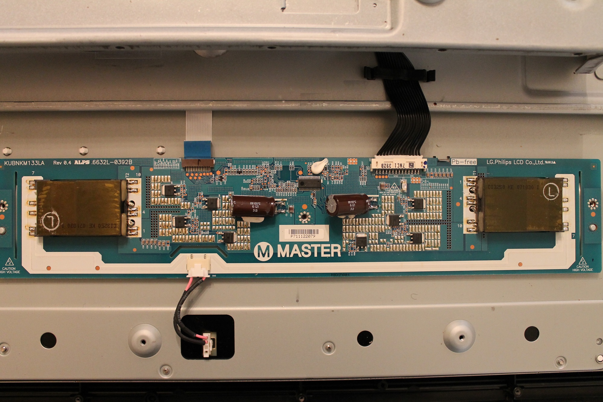

    Model - Phillips 47PFL432D/37

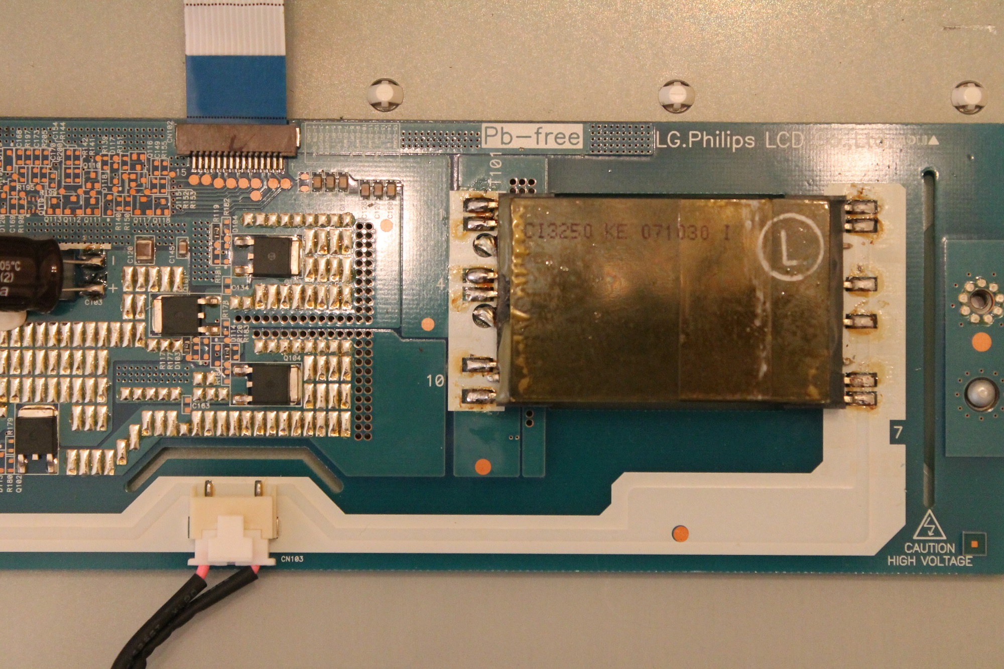

    Someone gave me this TV the right side backlight flickers rapidly, the left side didn't come on at all. I popped it open and there is 2 seperate inverter boards. A slave(left side, when facing screen) and Master(right). Immediately I see 2 35v 680uF caps on either board. All 4 are horrendously blown. I replaced all 4 with new ones and the problem persisted. So I thought surely it was the CCFLs.
    I decided just for the fun of it to swap the master and slave boards to the opposite sides. The problem followed the boards. The previously flickering light was dead, and vice versa. I tested the transformers with an ohm meter and everything checked out fine there. I checked the MOSFet to the best of my knowledge as well as a few other semiconductors around the board.
    I really don't know where to go from here...Is the slave board bad? Is the master? Could it still be the CCFLs? All caps looked good on Power Supply and tv stays on and works, just backlight flashing nonstop.

    Can you post pics of your board layout? Also, what are the inverters' part numbers?

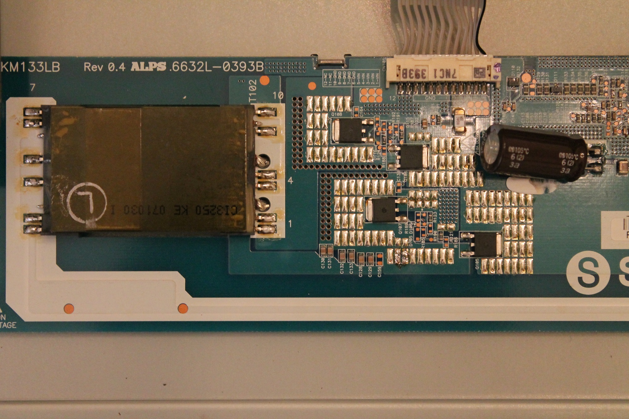

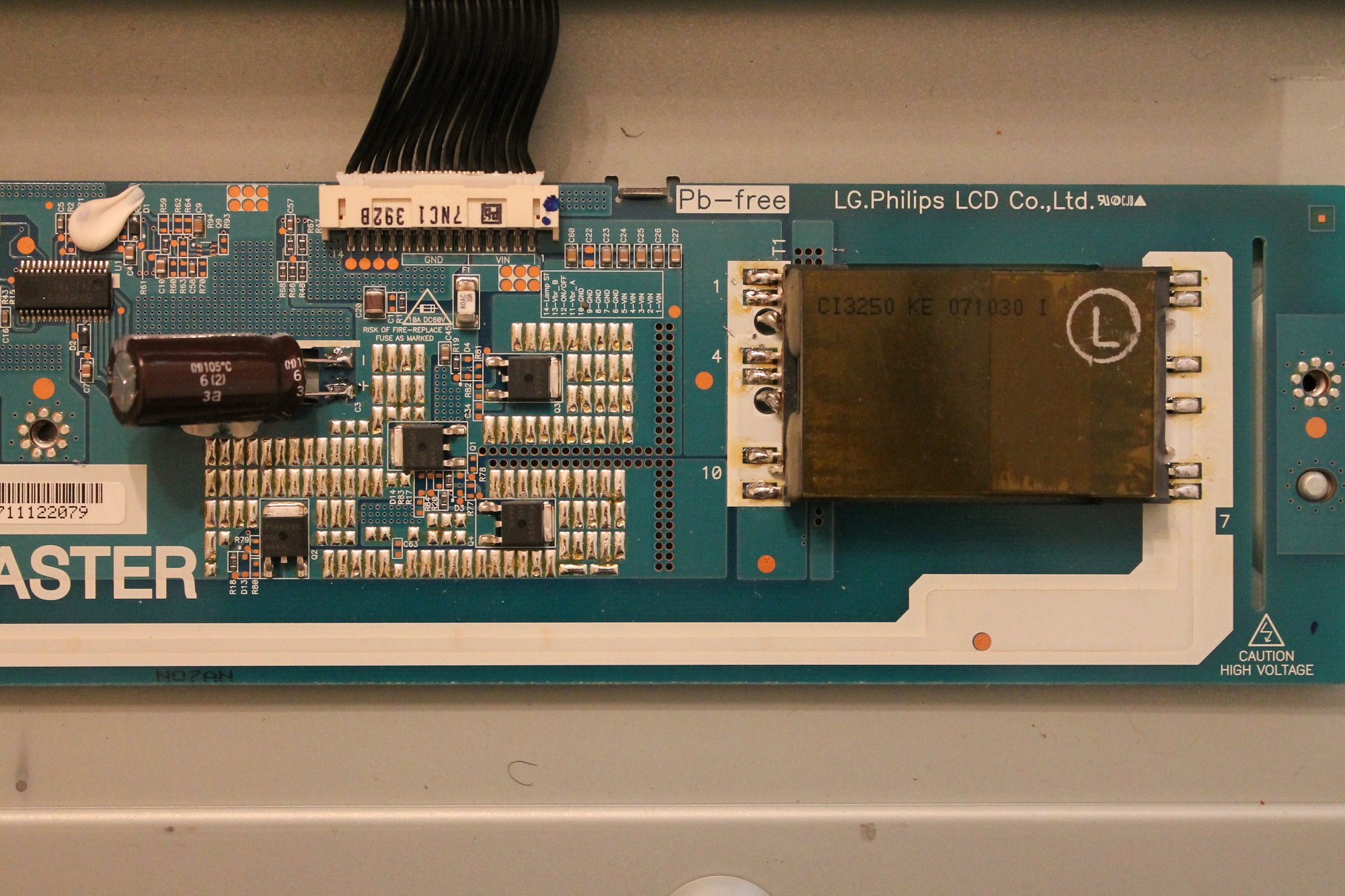

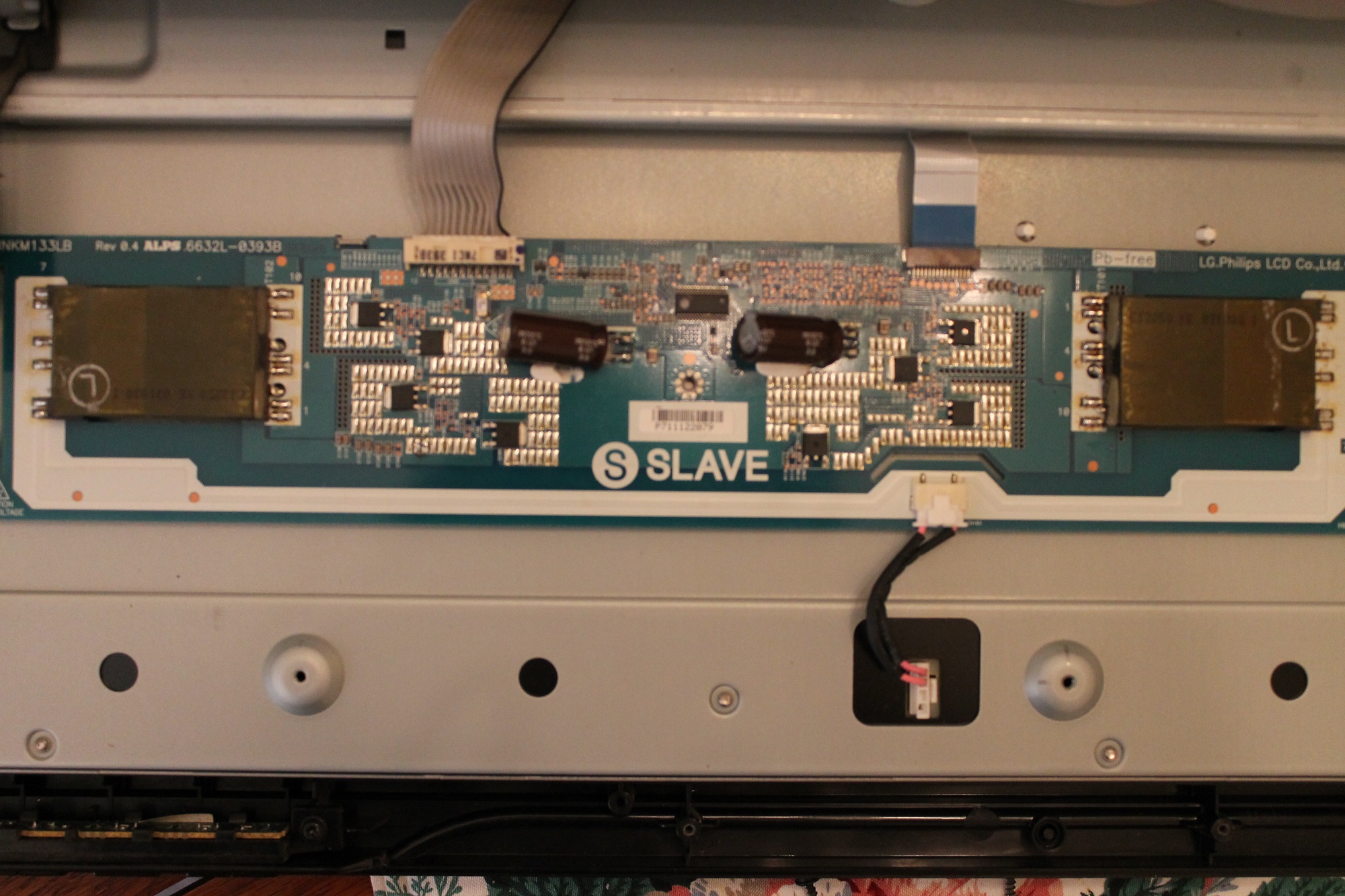

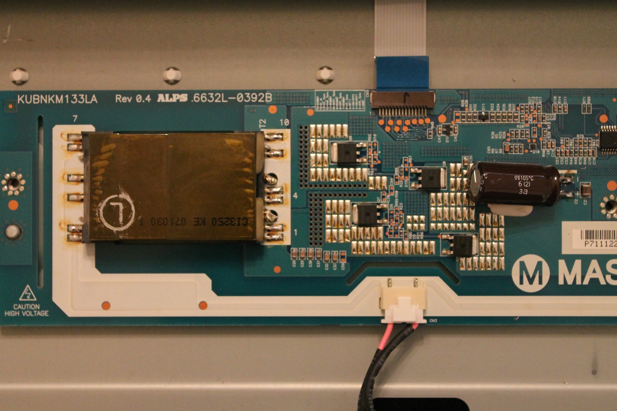

      I'm not a photographer by any means, hopefully these are clear enough. If not I can try and take more, or zoom in more if need be. The solder doesn't looks so great on transformers, but that's how it was when I got it. They seem to do the job however. I do take responsibility for the not so great cap soldering though =P
      Board Model#
      KUBNKM133LA (Master)
      KUBNKM133LB (Slave)

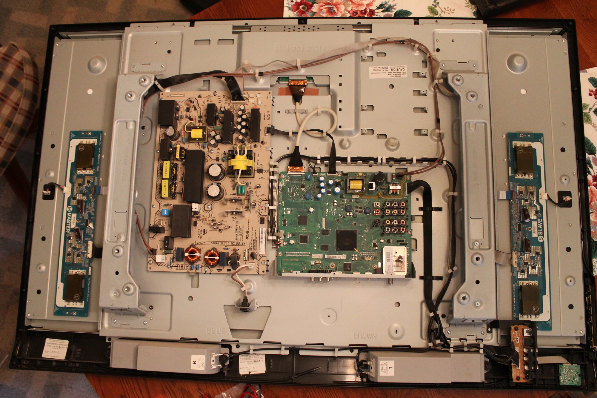

        I guess I should have been more clear: Can you post pics of the whole back of the TV to include all the boards? This does appear to be a simple inverter issue, though. I know some of these Philips inverters also require that the IC (location U1) be changed. You may want to pull one or more of the mosfets from the board to check them.

          Sorry about that, Here it is and thanks in advance for any help.

            Yep, just as I suspected. There's a repair kit that calls for replacing the eight mosfets, IC, and caps. Maybe budm will chime in soon - he's pretty good a diagnosing LCD TV issues and working on these Philips inverters: http://www.coppelltvrepair.com/p/69/...-other-lcd-tvs
