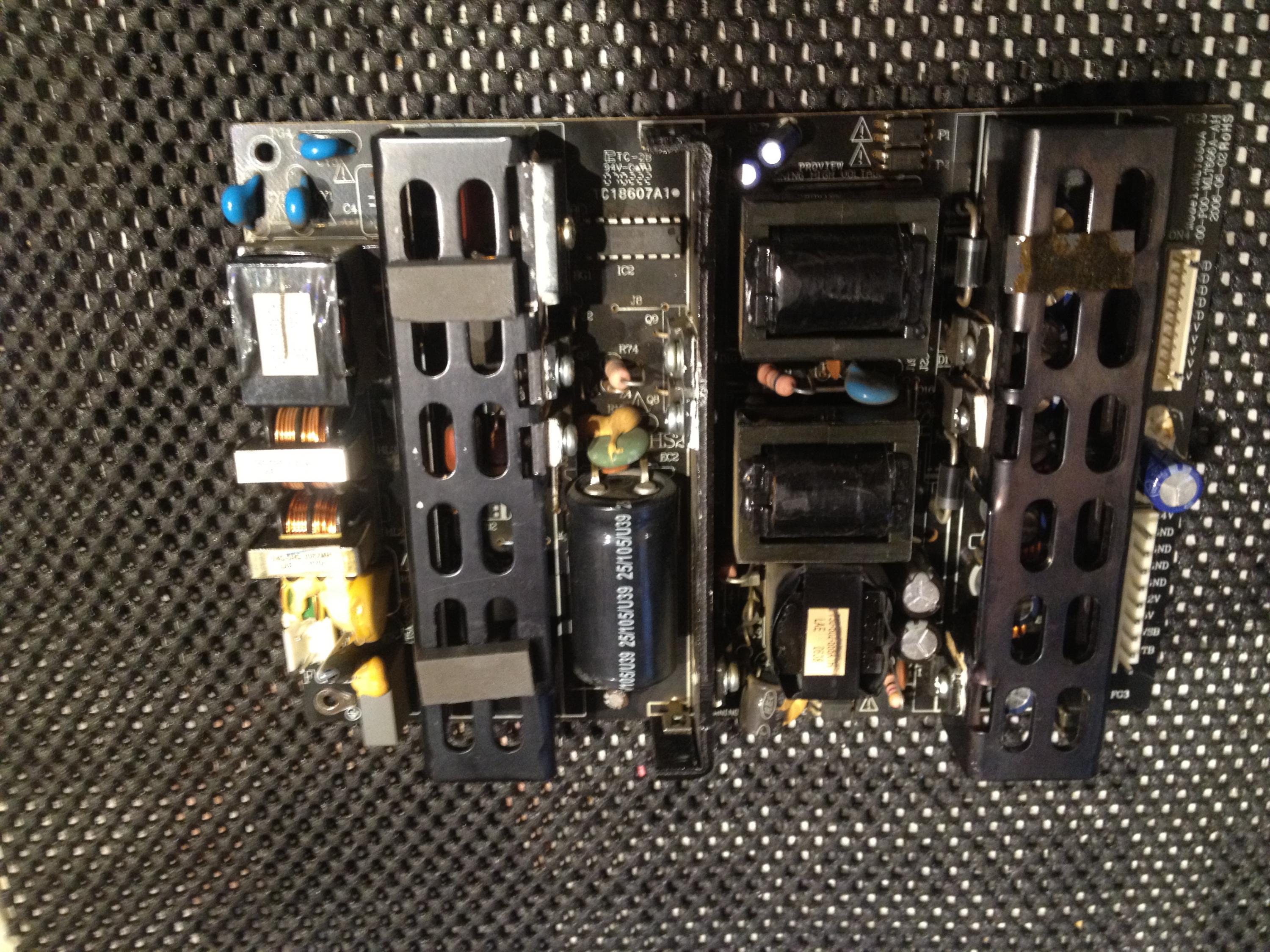

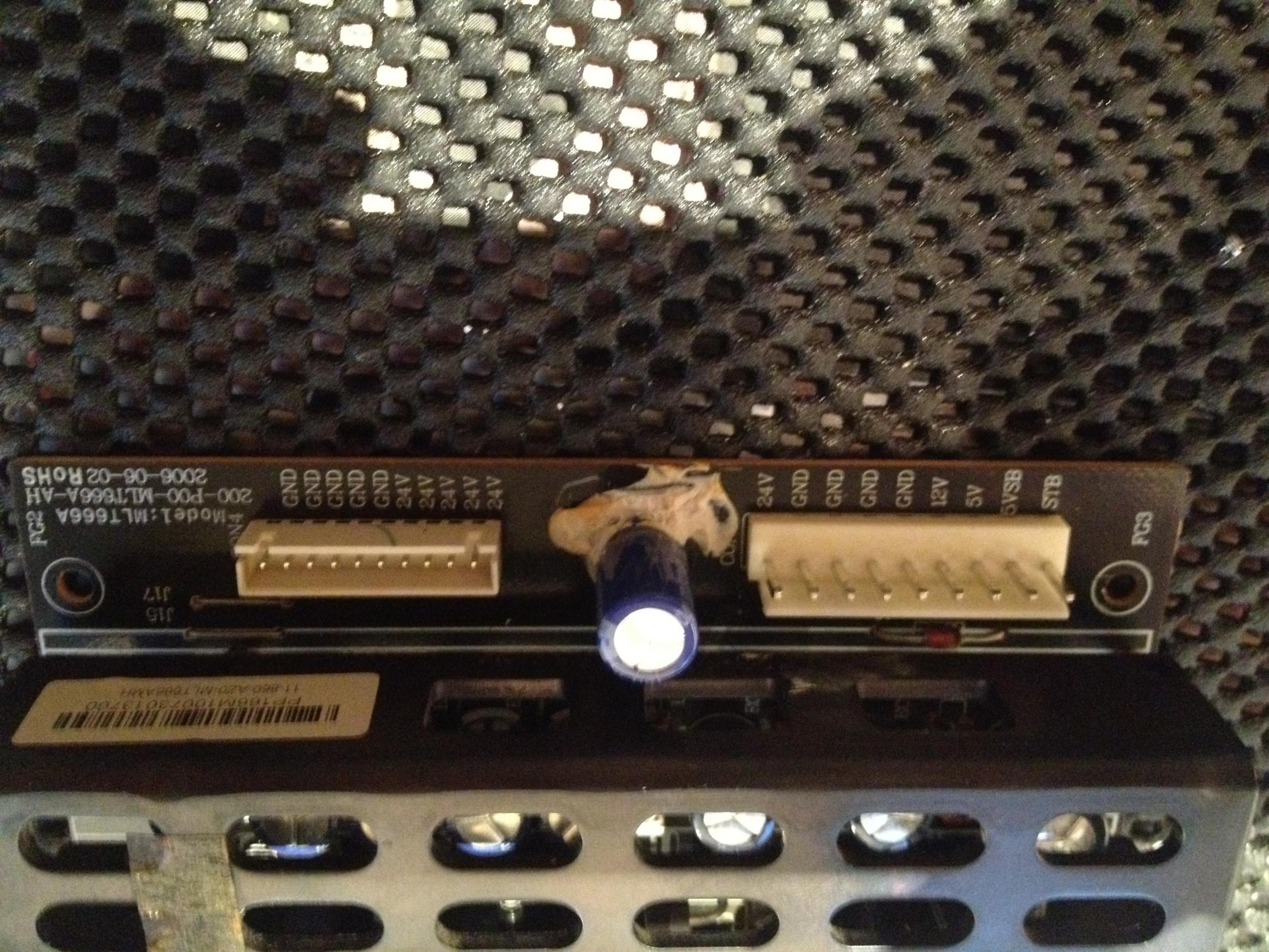

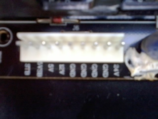

    This is the other connector on the power supply board

          You probably need to install Adobe Acrobat Reader to view PDF files. I uploaded those files a few days ago to troubleshoot my MLT666B 2.8. In my case I have isolated my issue to Q9 a 6N60C mosfet that is shorted and blows F1. I also have to replace R43 & R44 on the solder side. I have replaced all caps on the board Primary & Secondary with Panasonic FC series, and am waiting for my mosfets to come from element14 (I will be replacing all three on the primary side)

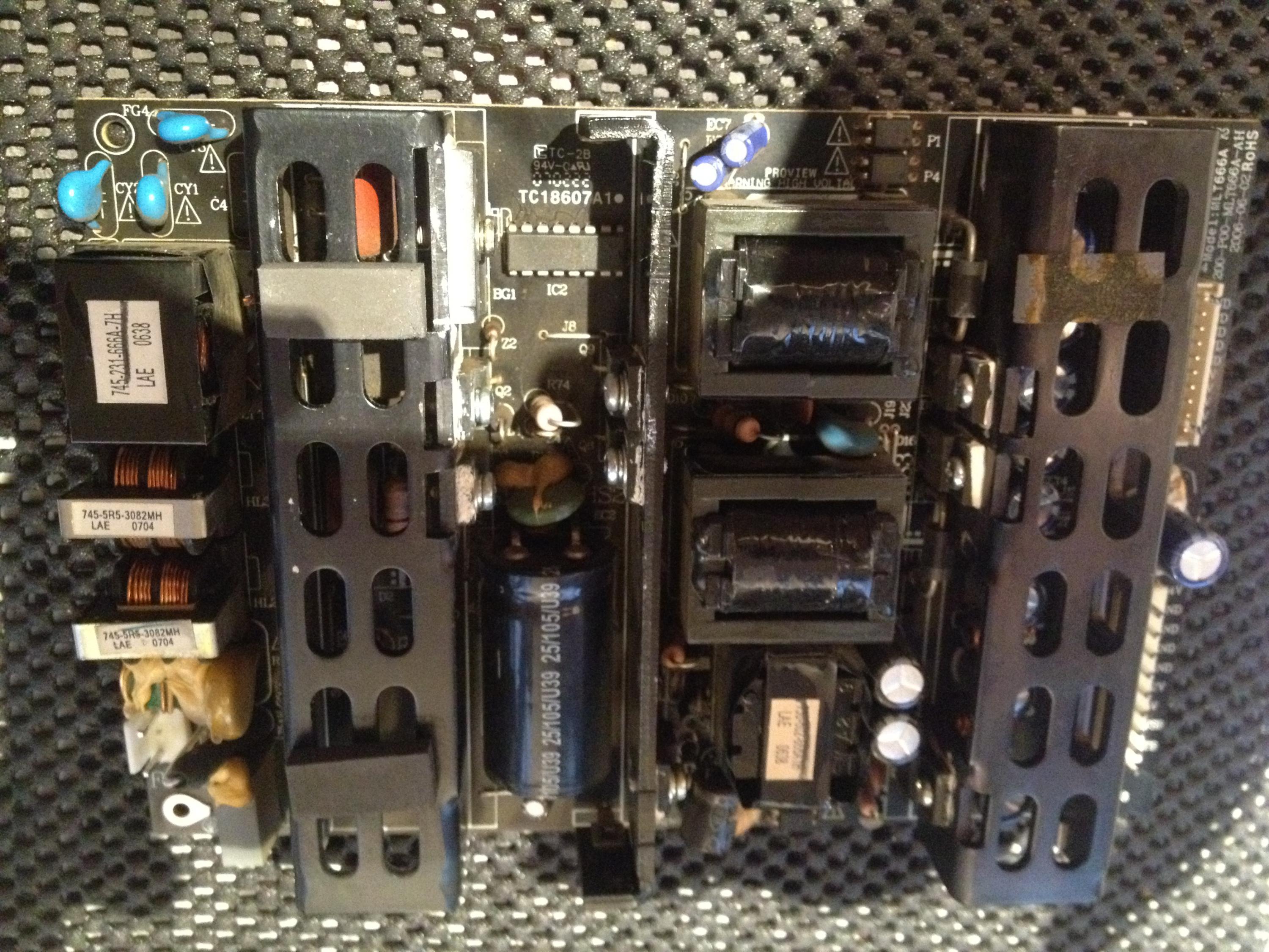

            I hope these pictures are better

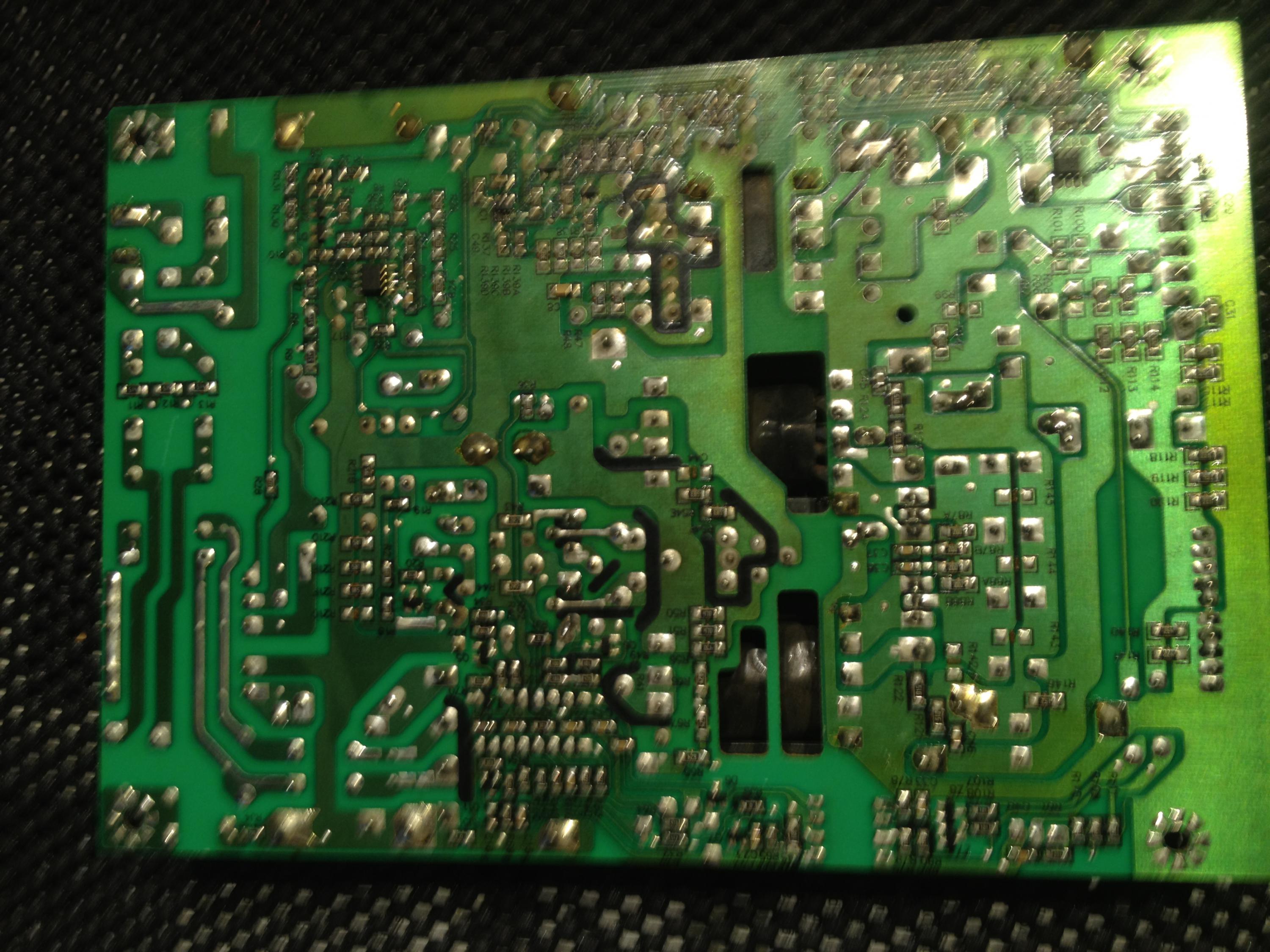

              another picture

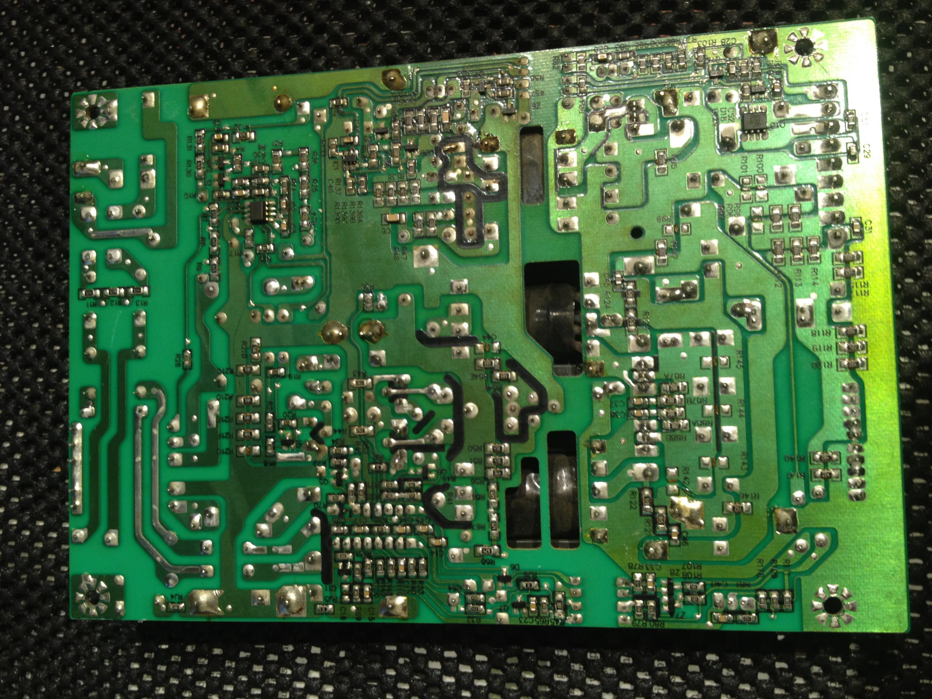

                Thats all the picts

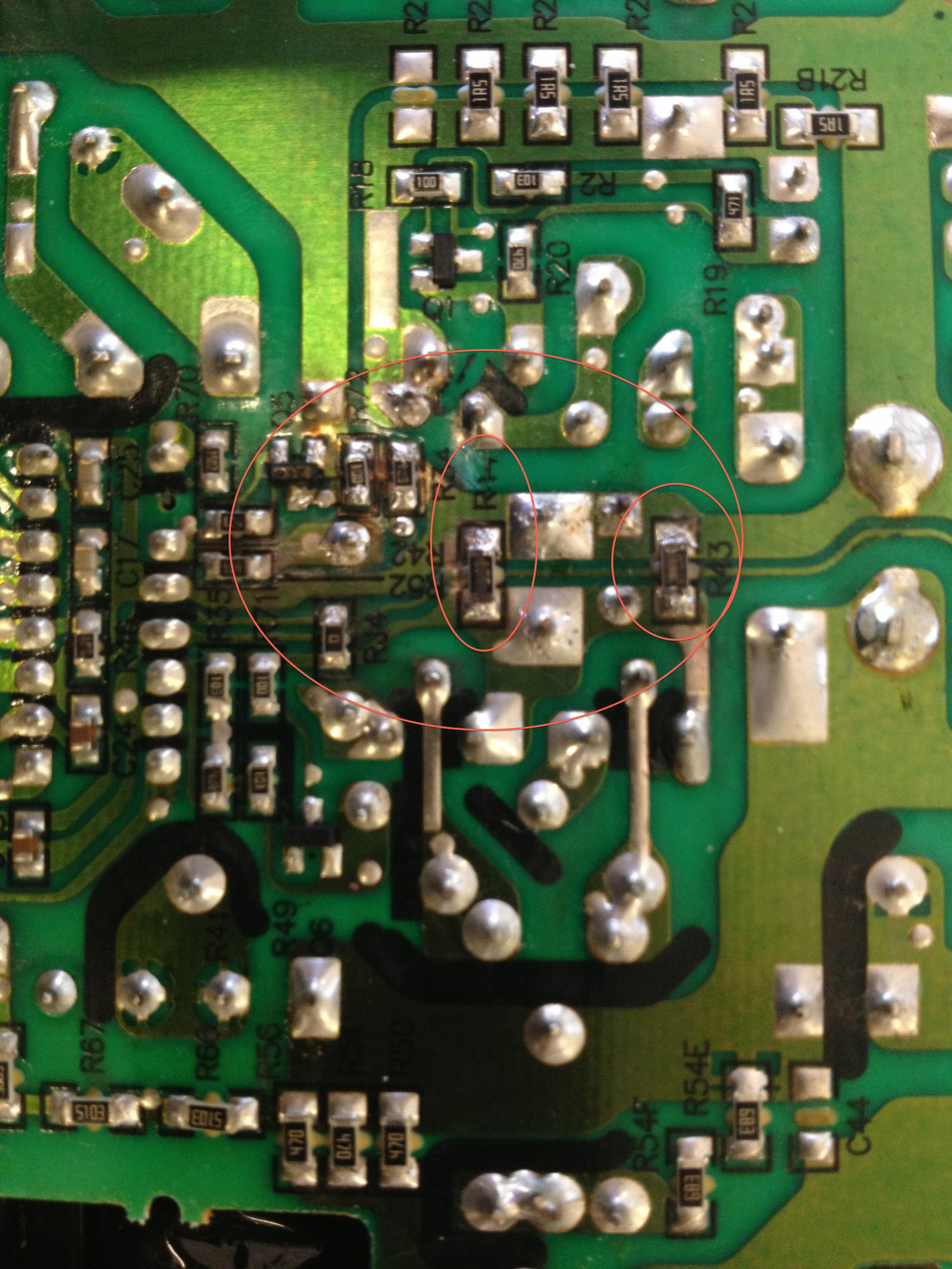

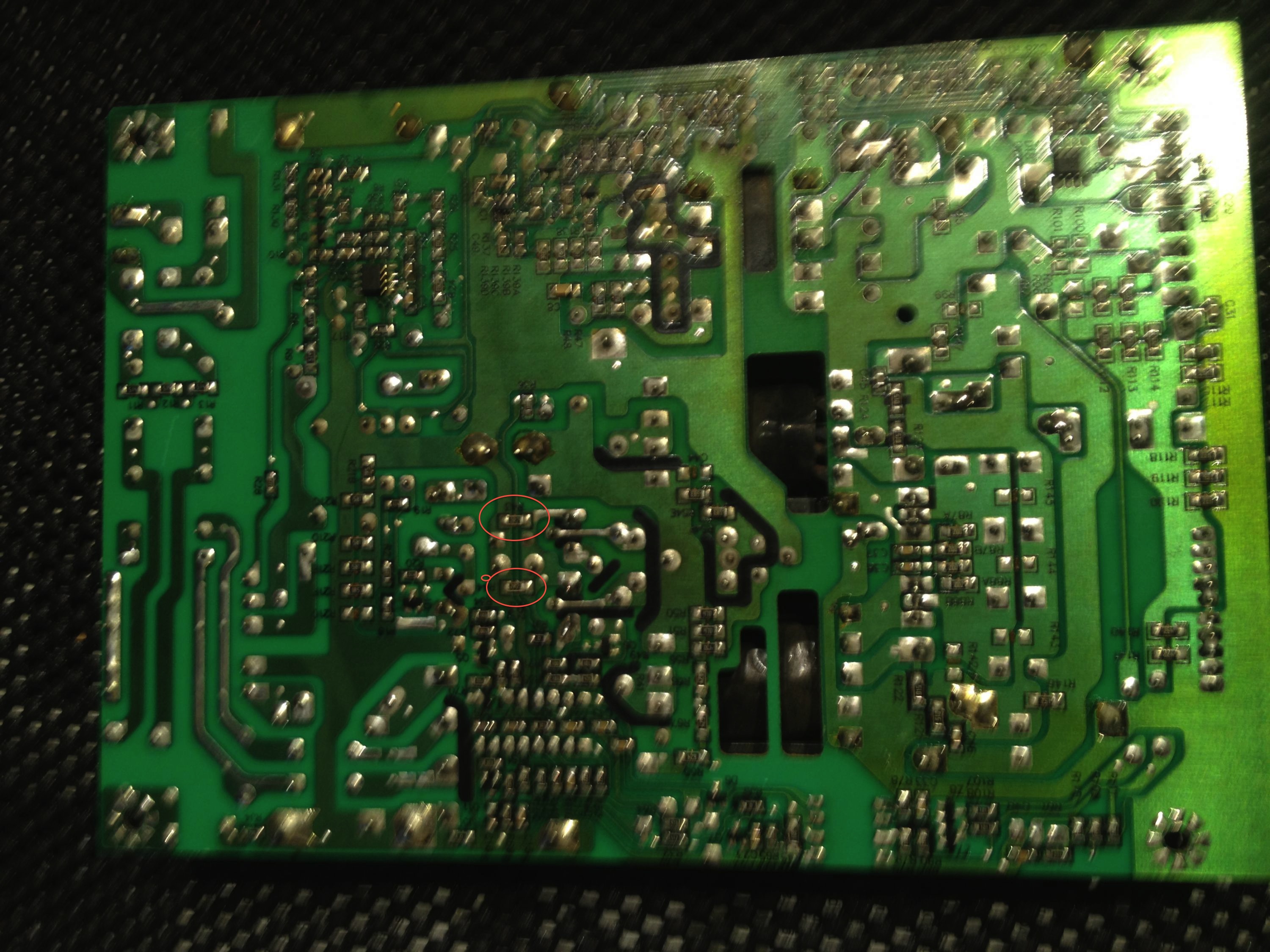

                  Hi keithf2,
                  Could I ask a favor of you to verify the codes on your photo of the two smd's I have circled? I think I have ordered the wrong parts? Ive ordered 2R20 going by the schematic, but in your image it appears to only have 3 digits?
                    #29
                    Re: Bush 32TV016HD issues
                    Both the items are 2R2
