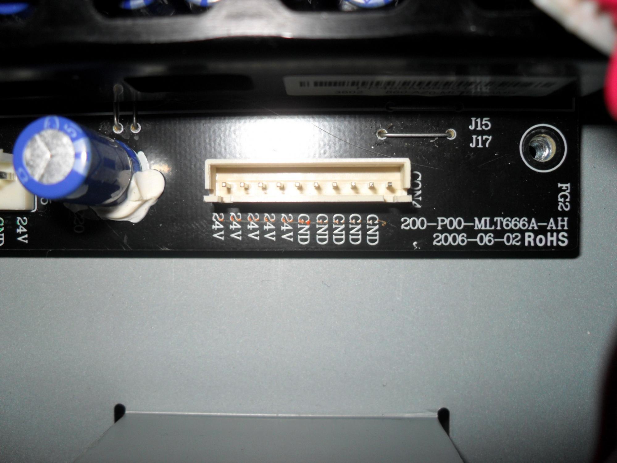

                          Re: Bush 32TV016HD issues
                          So, can you see any voltages on the power connector going to the main board, or is it completely dead?
                          • ben7
                            Capaholic
                            • Jan 2011
                            • 4059
                            To add to that: is there any 5v standby? I know you said you had no voltages, but do you get 0v on the 5v standby, or say 2 or 3 volts?
                            That pic of the connector is very good! BUT, there are more than one of them on the PSU. Can you get us a picture for each of those other connectors?
                            Muh-soggy-knee
                            • keithf2
                              • Aug 2010
                              • 131
                              Is compltely dead
                                0V on all connectors then??
                                • keithf2
                                  • Aug 2010
                                  • 131
                                  yes

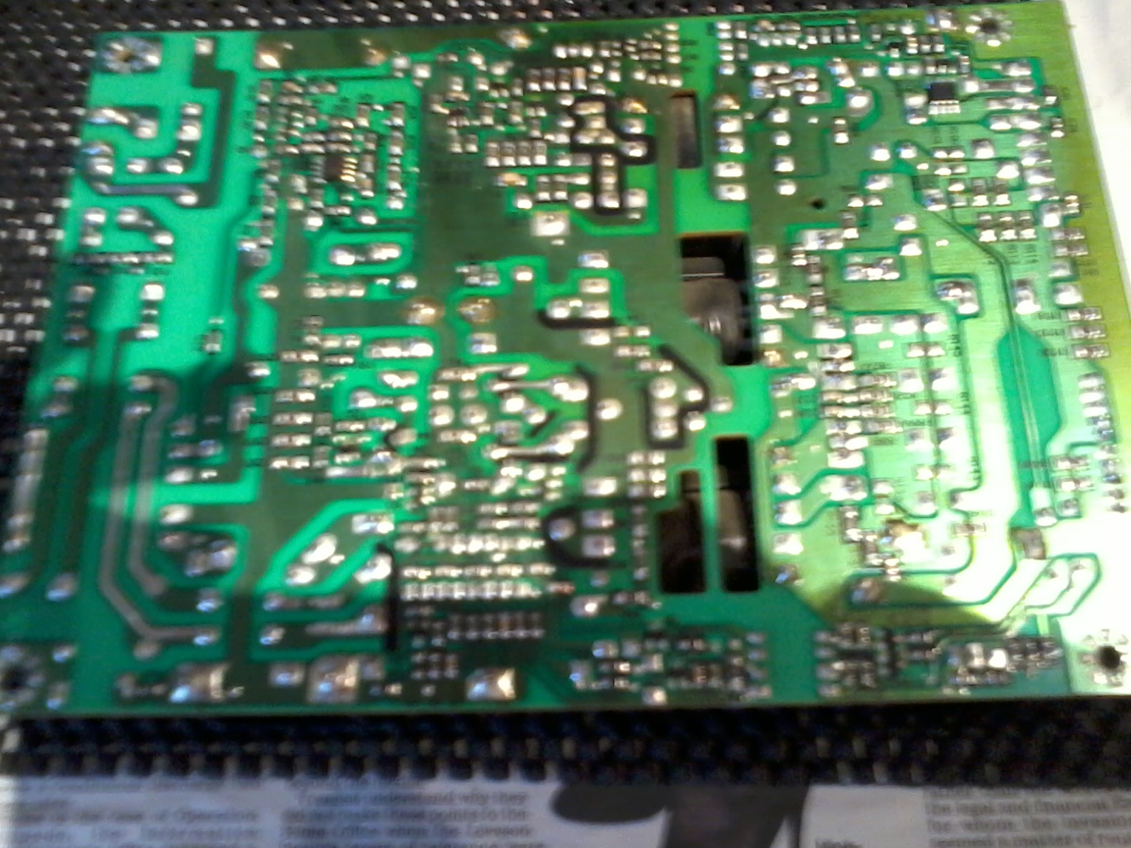

                                    have you still got voltage across the main capacitor? can you post pictures of the underside of the board as maybe some blown smds.
                                    • keithf2
                                      • Aug 2010
                                      • 131
                                      yes voltage across the main capacitor is still there, will post a picture of the underside after tea.
                                      • keithf2
                                        • Aug 2010
                                        • 131
                                        This is the bottom of the power board, but not that good.
