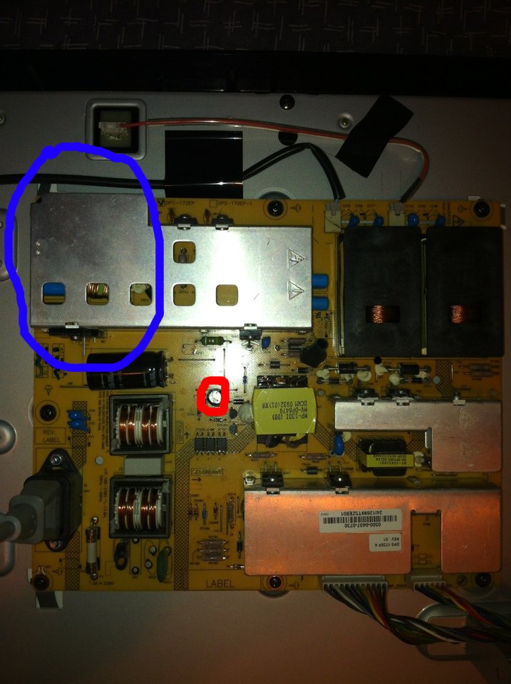

                      Re: Vizio VO320E Bad Power Supply Board?
                      OK, this indicates a PFC fault.
                      Across the red ringed capacitor please measure the voltage across it. Expecting 10V to 25V.

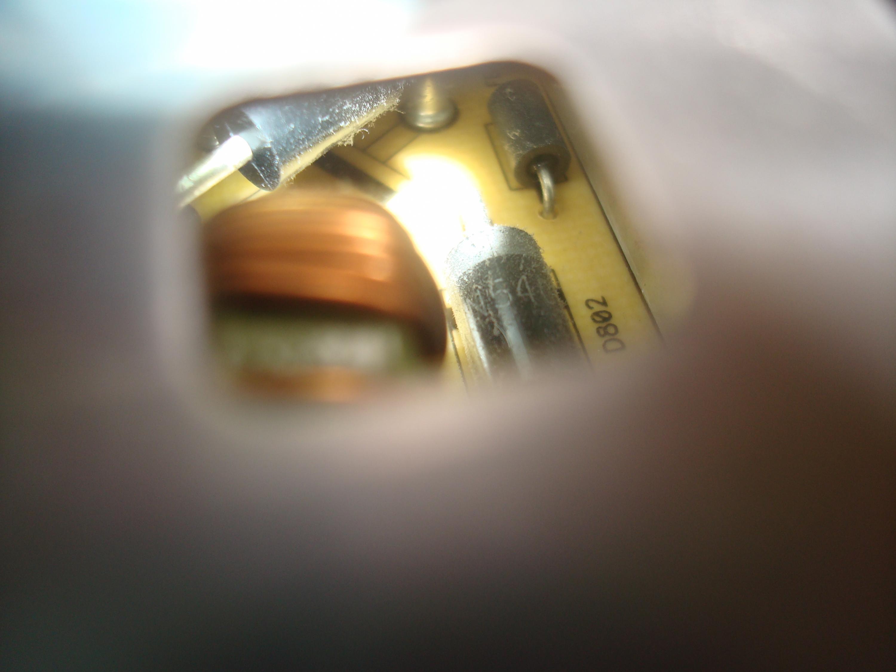

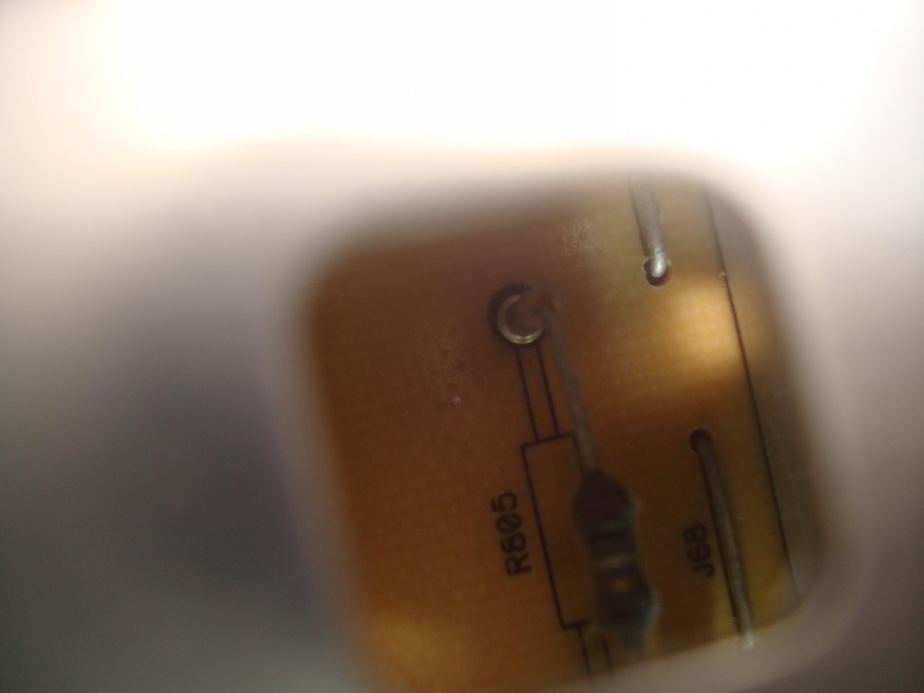

                      For the blue area, please post a picture of under the heatsink the best you can.
                        #31
                        ok, the measure was 20v standby and 22 ON. About the picture, do I need to remove the heatsink? or the best I can without removing it
                          #32
                          Is it closed off on both sides? Can you see anything under it?
                            #33
                            well here the pics I could take, I think they cover pretty much everything under it but let me know if you need a specific area.
                              #34
                              OK, all I need to see was the PFC coil, which is there. So it confirms this board does use PFC.

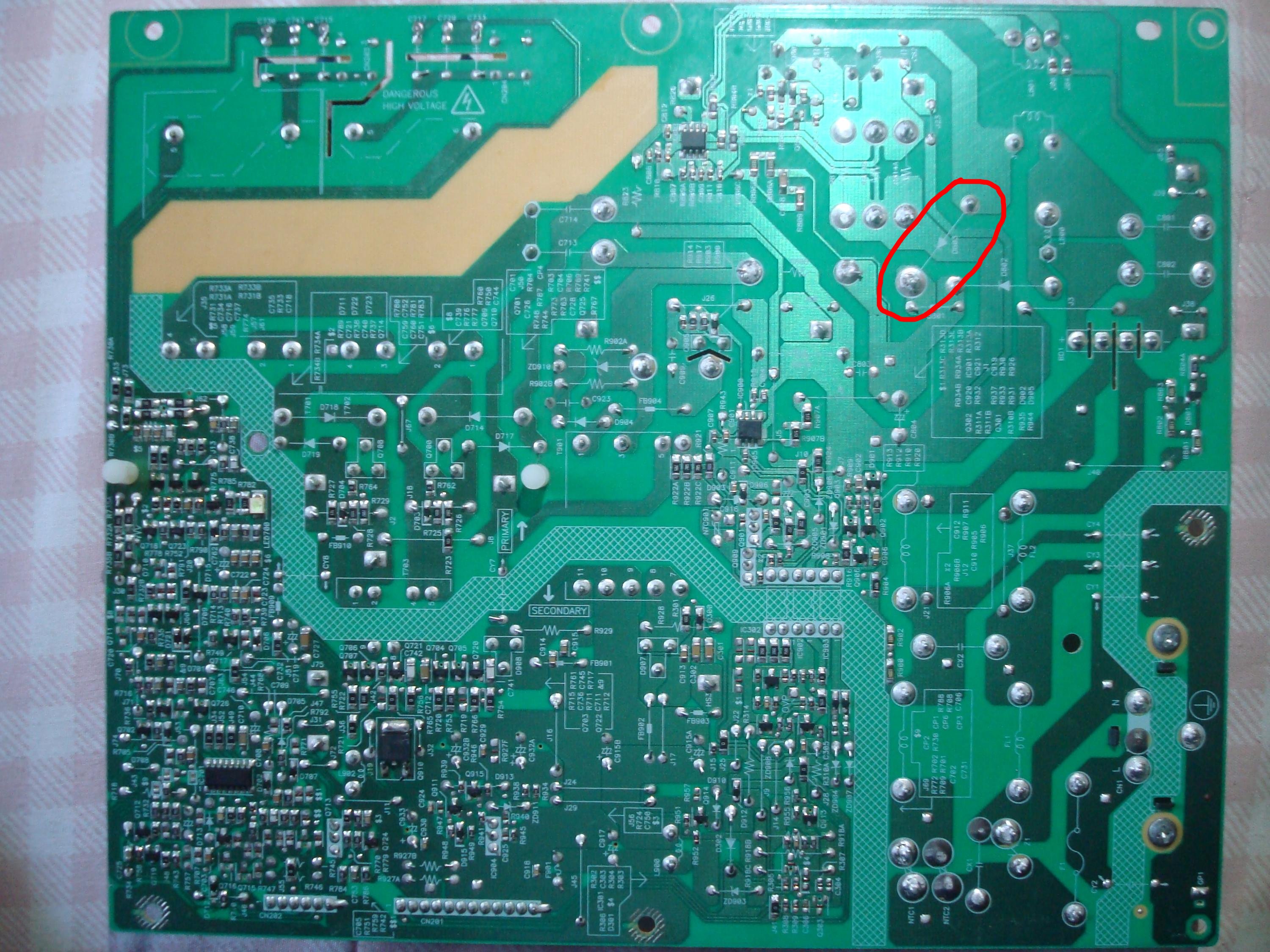

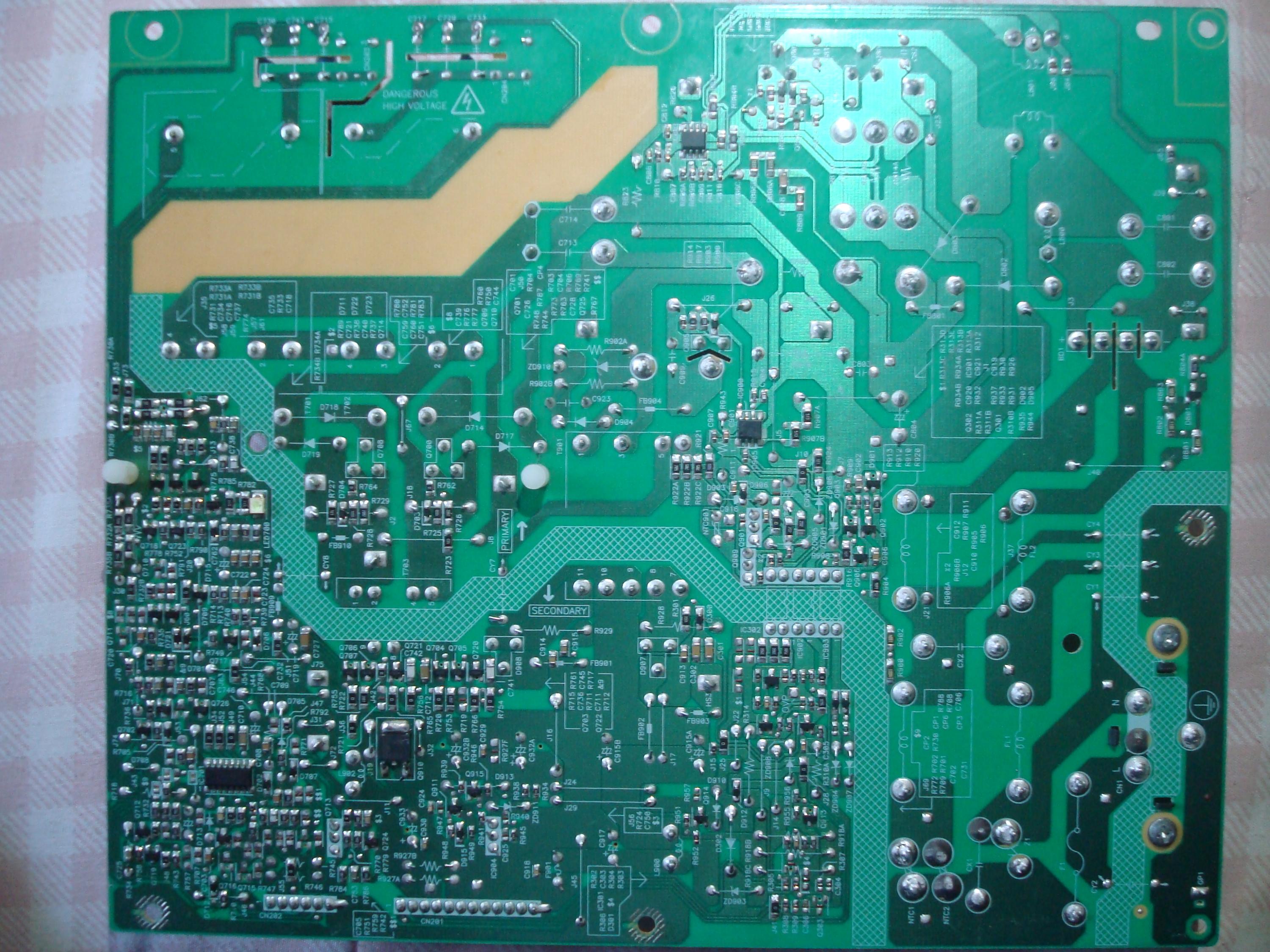

                              At this point, can you remove the power board and take a picture of the bottom of it? The green side of the circuit board.
                                #35
                                Here the best I could, I hope is clear enough, if not I could split it to give you more sharpeness
                                  #36
                                  Please test this diode.
                                  To test: Power supply UNPLUGGED. Multimeter must be set to diode test mode. Red probe goes on one end, black on the other. Record reading. Then reverse probes, and record the reading.
                                  Expecting: 400~800 one way, open circuit (usually shown as "1") the other way.
                                    #37
                                    The reading is the same in both ways 0.01. board unplugged from the outlet and other boards
                                      #38
                                      Nice! First check and it's a dud. Pull it and test it out of circuit to be sure, but you've probably found the fault. Replace that diode with a new part... read the part # off it and go to digikey.com to find a replacement. (Do not just use one that looks the same size... )
