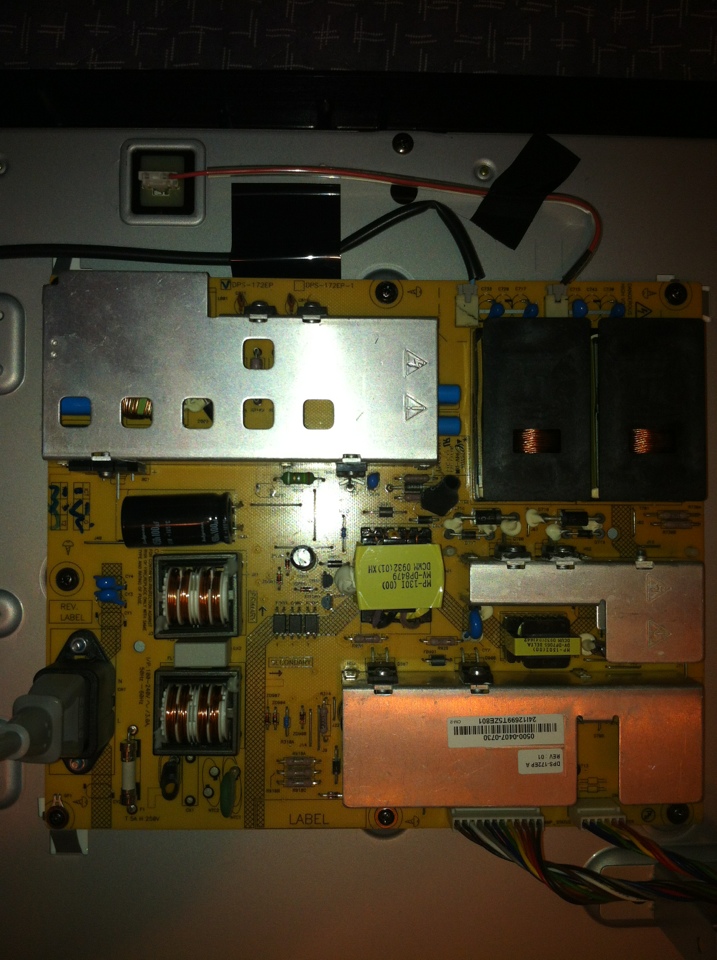

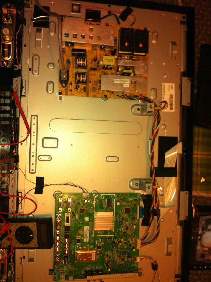

    Hi, I have a Vizio VO320E that I'm trying to fix. It turns on, the logo comes white and when off the logo is amber. I've been reading all the posts in the forum about the issue and did the readings hoping that anyone could help me to find out what's wrong.
    I started for the fuses in the main board
    Off
    F1 > 5.18
    F2 > 0.00
    On
    F1 > 5.38 - 5.35
    F2 > 1.87
    Before I read the Regulators I went to the power supply board and Check the fuse and read
    Off
    F1 > 0.00
    On
    F1 > 0.00
    From what I have read the fuse is bad but I don't know really how to interpret this info.

    Re: Vizio VO320E Bad Power Supply Board?
    When you specify a voltage measurement, are you measuring ACROSS the fuse (red one end / black the other) or from one end of the fuse to ground? If the second one, you need to measure the voltage on both ends of the fuse to see if it is bad.
      Thanks Tom, I did the measurements both ways
      when I measure each fuse using both ends (red in one end and black in the other end) I only get 0.00 in all the fuses with the TV ON and OFF.

        Those indicate good fuses.
        On the 12V output of the power supply, what voltage do you see?
                  OK, this indicates either a problem with the power supply, or the load attached to it -- more likely power supply than not.
                  Do you have any resistors (through hole type) available in the range of 100 to 470 ohms? The main board and other circuits can be disconnected from the power supply, and the power supply can be tested separately. A car brake light can be used as a load on the 12V rail to test that more reliably.
                          On the connectors on the power supply board, do you see a pin marked PS_ON, STBY or REMOTE?
                          • alja
                            DIY Junky
                            • Aug 2013
                            • 47
                            yes PS_ON
                              OK, locate (any) pin which is 5V in standby mode.
                              You need to unplug the connector from the main board, and run the resistor between the 5V and the PS_ON. (Leave this connector disconnected from the main board, leave it connected to the power supply.)
                              Then plug the power supply into AC. Check the 12V, is it good or bad? Significantly higher, or barely changed?
                              One other thing, because we have had the odd weird measurement before on this forum, can you make a check of, for example a charged car battery, to see if your meter can display 12V? (Nominally 13V for a car battery, if the car is to start properly. There's a small chance the "1" digit has stopped working... unlikely but we would be chasing a wild goose if your meter reads incorrectly.)
                                    alright, I have put one 470 ohms resistor between the ps_on and 5v pins and the reading on the 12v pins is still the same 2.02. I guess ...... the power board is bad?
