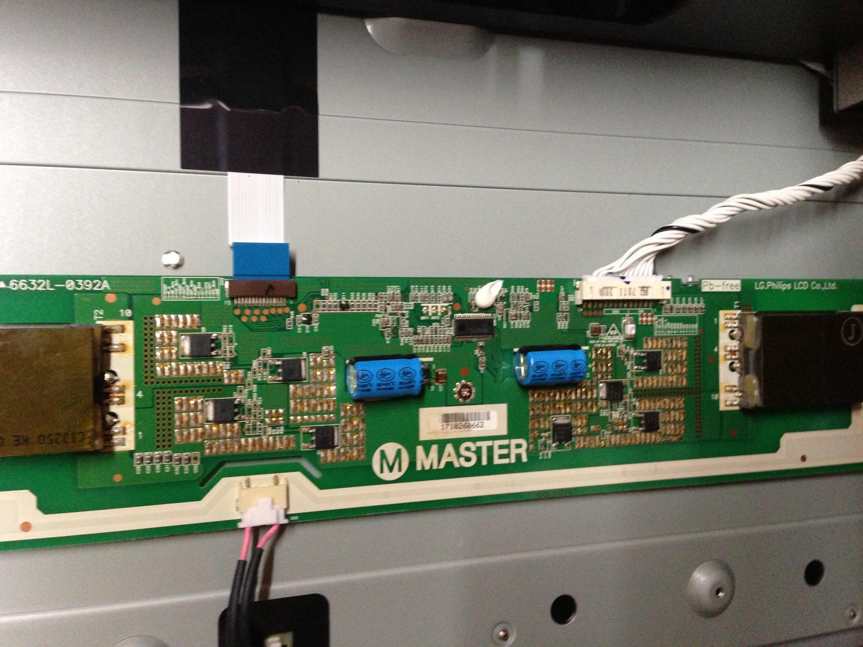

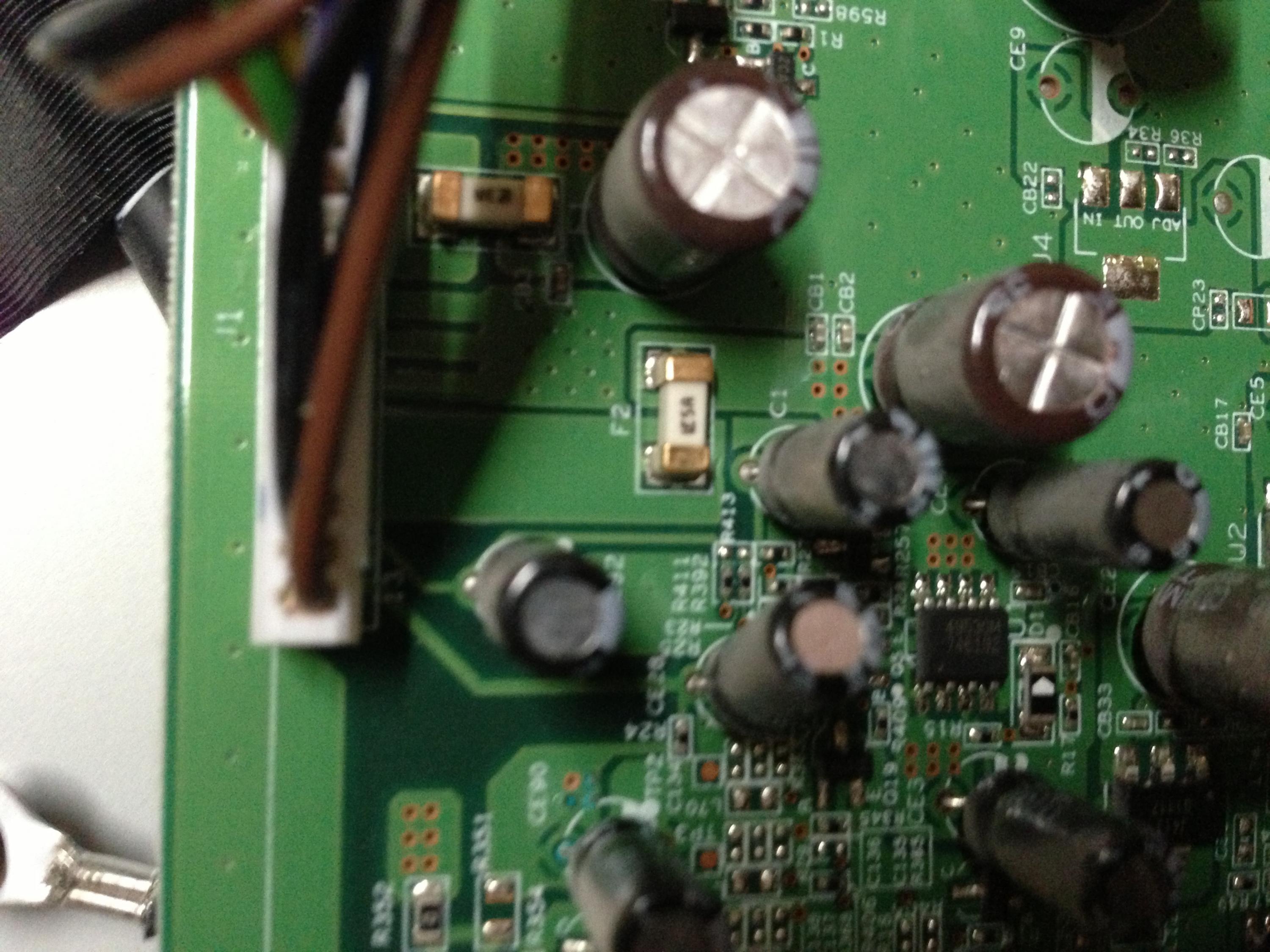

    Hello, I am in need of some assistance. My best friends LCD tv wouldn't turn on after turning it off one day. Since I have has luck on fixing tv's and other electronics in the past he brought it to me. It powers on. Logo goes from amber to white like it suppose to.
    First, thing I did was open it up and found some bulging caps.( as expected). One on the PSU of the 24v supply and the two caps on both of the master and slave inverter. I replaced all 5 caps. Now when I was just about to unsolder the first cap on the master inverter I noticed that there was a solder ball on the 32pin IC chip. It was between around pin26 or pin27. I removed it and proceeded with the caps. Still no backlight.
    So then I decided to test the voltage at the PSU. I found there was no 24v output from the PSU. After I while of probing the PSU secondary that seems to have good caps resistors and caps, I then unplugged everything from the PSU and tested again for voltage. Bam, 24v was present. One by one plugging in each plug back int the PSU. I discovered that with the slave inverter pluged in I don't get 24v. With it out I do. However there is still no backlight from the master. I then tested the pins of of the masters and found that I'm not getting 5v for the inverter power on. It's only 3v. I then went straight to the main board tested pin 13 on the connector and it was at 3v also. Following the trace from pin 13 I come to a smd resistor r24 and a electrolytic cap ce28. I have not tested the cap yet but it does have voltage to ground. That and I only have a cheap extech with no capacitance. I'm getting 5v on the resistor leg not connected to the cap and 3v at the leg that is connected at the cap. What shouild the resistance be on this resistor? Should I gust replace the cap and see what happens? I think the resistor is bad since it has a very low resistance of under 1k. Could I just jumper this resistor to test if the backlight comes? How to test the ic chip since there was a solder ball on the legs and it might be bad?
    Thanks in advance. I will post some pictures when I get home

          Re: Visio VO47LFHDTV10A has power, no backlight
          Here are the boards in this tv.
          Main:3467-0072-0150
          Master:6632L-0392a
          Slave:6632L-0393a
          Pay:0500-0510-0340
          I figured out that if I unplug the ribbon cable from the slave the voltage for BL_ON goes to 5v. Not sure if that matters or indicates a short. I tested the FETs and there is only 24volts on the input pin. There is no output voltage coming from IC. Also the input voltage to pin27(UVLO) is 2.7v. Is 2.7v here ok or should it be 5v?
          I'm assuming that I need to replace the IC's on both the master and the slave at this point but I'm not quite sure
          Thanks for the help guys
            Are these the LG Master-Slave inverter design?
            • Kylum
              • Aug 2013
              • 18
              • Us
              Yes sir they are.
                  No i didn't get them from radio shack. I actually have a bin full of pulled caps and resistors. Just so happened to have the same size ones in the bin. I plan on getting ESR type caps if and when i figure out what else i will need for this TV. Mouser is local for me but not close enough to make trips back and forth every time i need something. However if i need to order the inverter IC's i will have to order them form digikey or ebay as mouser does not have them in stock. Just trying to order the least amount of times as possible.
                  I really appreciate the fast response. thanks
                    Typically the light blue lelon are not suitable replacements.
                    You can order caps from Digikey, no minimum order and $3 shipping. Or other suppliers.
                      I am only using those for testing before placing an actual order where i will order the correct low esr caps. Im trying to find out what else is wrong with the inverter first

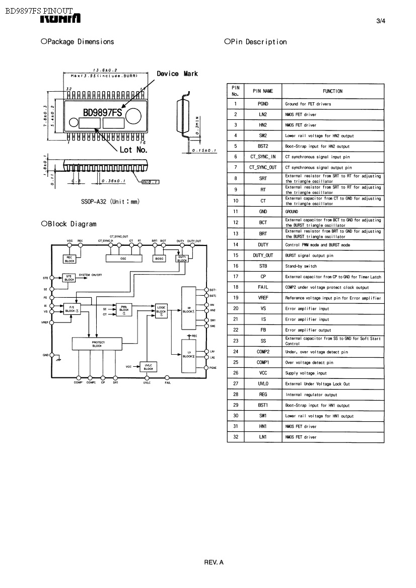

                        So is there a way for me to test the IC# BD9897FS to see if it is working properly?
                          Well it looks to be that pin 27 of the Inverter IC is shorted to ground internally. This is on the master. I tested it on the slave and it is not. So I decided that one if not both IC chips are bad. I found a full kit on eBay and they just happen to be a local shop that is around the corner from the house for only 15 buck. Actually a few buck cheaper than going through digikey + shipping. I will post back once I get around doing the job plus I can't find the correct nozzle for my hot air rework station so I will have to wait to get that in the mail as well.
                            Update:
                            IC replaced on the master and still the same issue. I can't seem to find the problem. I would really appreciate some guidance on what to do from here .
                                      What voltage do you get at DIM pin?
                                      • Kylum
                                        • Aug 2013
                                        • 18
                                        • Us
                                        I will have to get home to test that. This might be a dumb question but which is the DIM pin? The pinout doesn't say DIM so I'm a little lost. I would assume its less than 1v since I'm only getting voltage @ UVlO pin 27 and VCC pin 26. All other readings are in mV. I will have to retest to verify that though. Go easy on me I'm still a noob.
