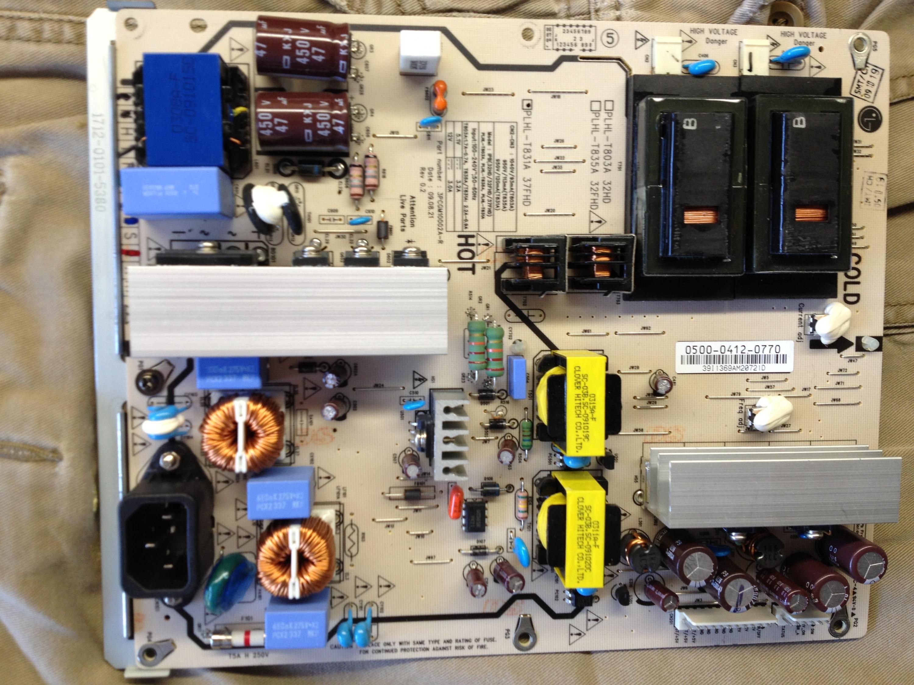

Ok everyone. I've got two of these identical power supplies here with the same issue. Tired of replacing boards on most of these sets and ready to try more component repairs. Both of these boards have 5V-STBY but will do nothing else. I can apply power to the PS on and inverter on and get no 12V or Backlight. Where should I start on it?
I replaced one on another set months ago and have the other set here waiting on this repair.
Oh and the filter caps show 170V in either state. Standby or with power applied to one or both pins.
