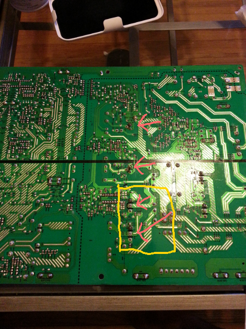

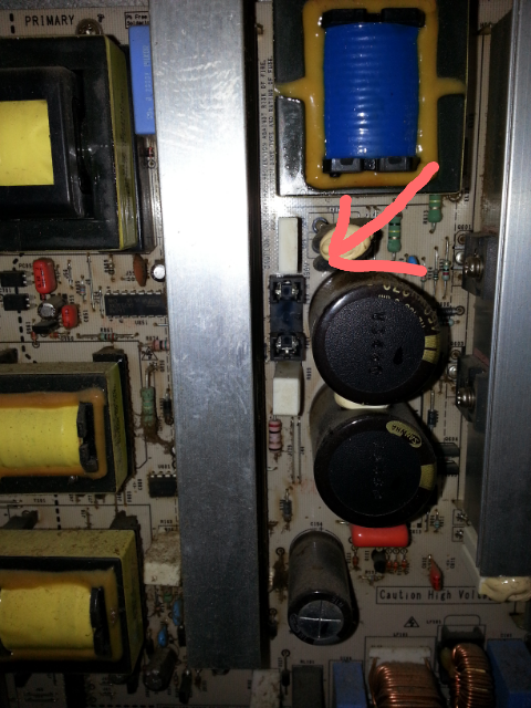

    There are 2 fuses on the ps board which I found 1 blown 4A fuse on the ps board (see pic with arrow)
    There are no visible blown/bulging caps
    I did replace the blown fuse with a 3.15A fuse that I took from a spare ps board
    Hoping this would fix the problem it did not it only blew the fuse when I pressed the power button
    This fuse that keeps blowing is located in between the heat sink and the 2 big caps to the right of the center of the ps board (see pic with arrow). The other fuse that did not blow is located by the connector for line voltage

    You most likely have a failed component on the primary side of the PSU. I'd pull the PSU and look for obviously blown or burned components with a flashlight first.

      Checked the MOSFETs on the heatsink next to the fuse that keeps blowing. See if any of them are shorted.

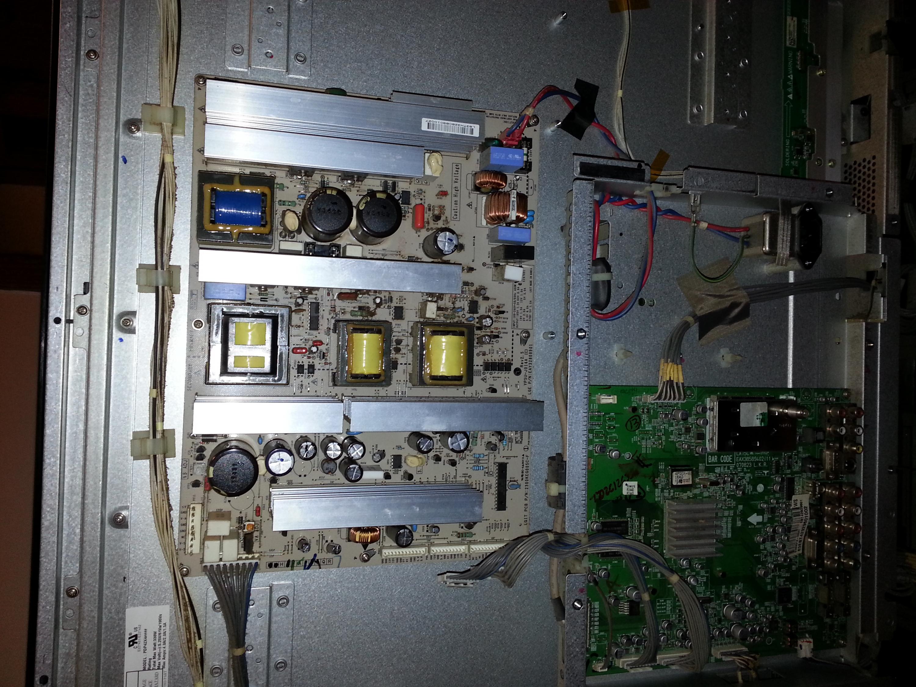

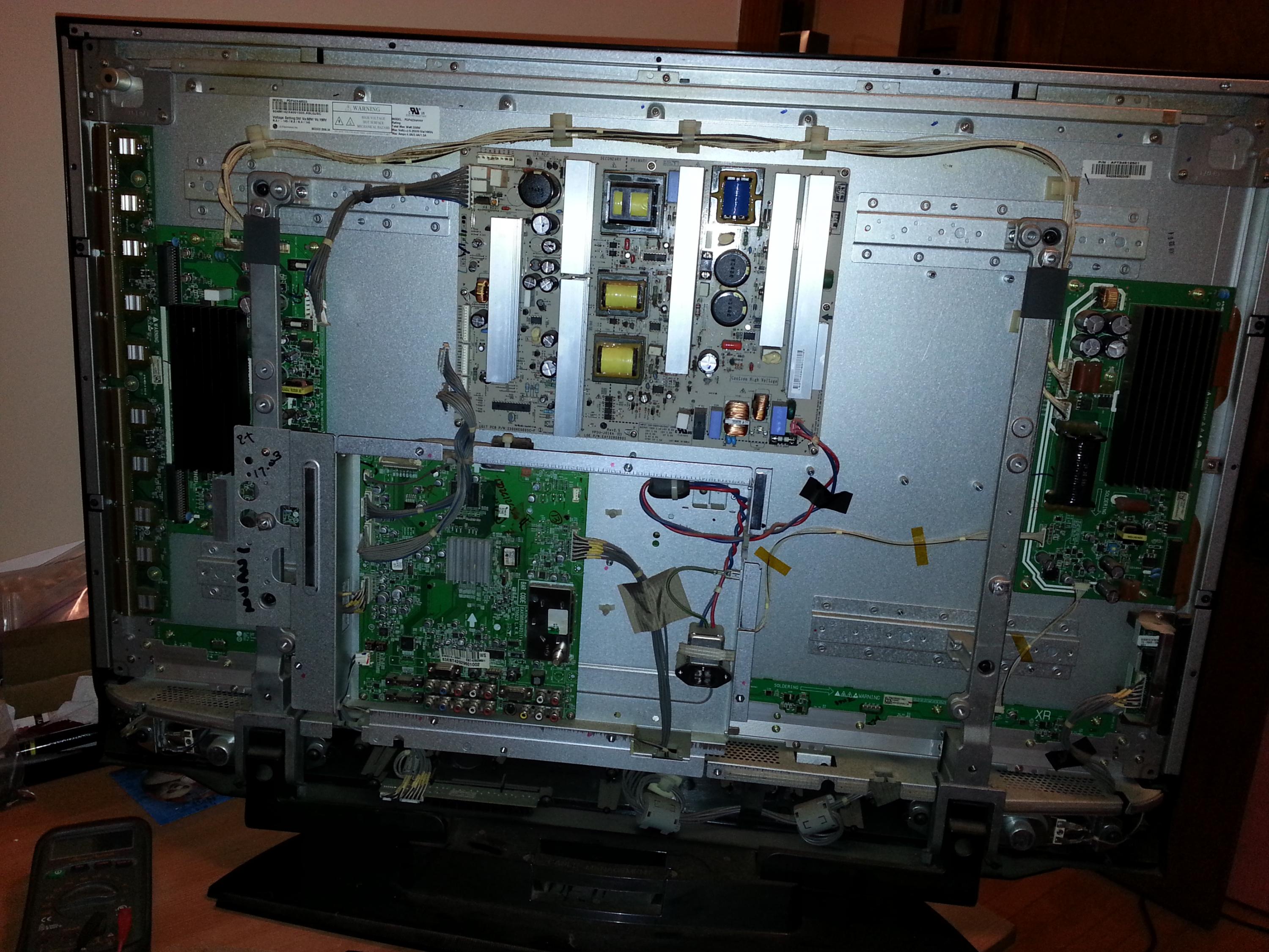

                Ok so I put in a good fuse, disconnected the cables going to the other boards
                I plugged in the power cord and turned on the power to the surge protector then the relay on the psu started clicking and you can hear one of the transformers powering on and of in sequence with the relay and about 5-8 seconds the ceramic fuse blew
                So im guessing the problem is isolated to the psu?
                I checked the board and I couldnt find any visible burns or defective components
                Now I need help checking the mosfets on the heat sinks
                How do I do this?
                What kind of readings am I looking for

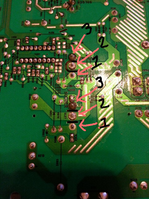

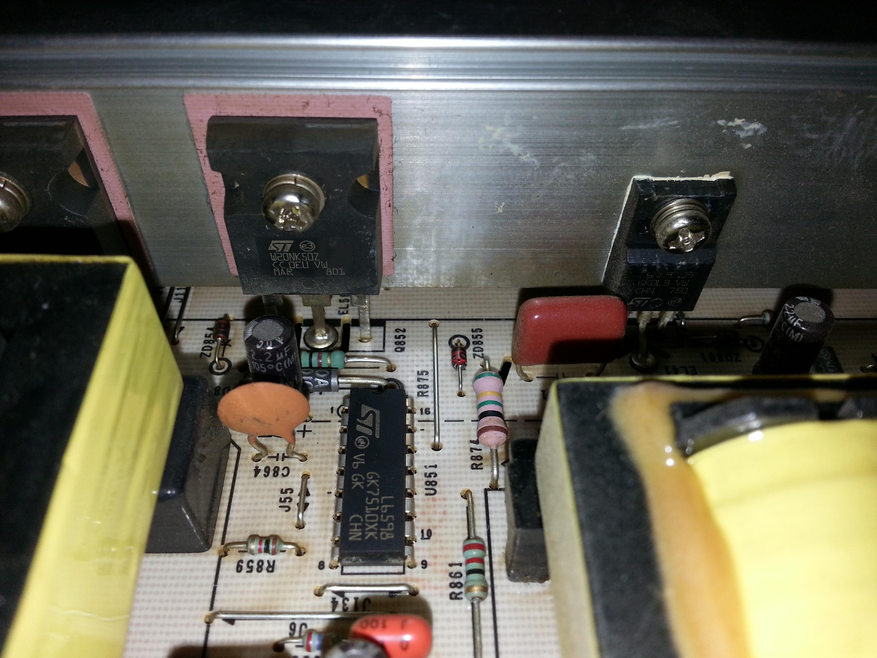

                    I think I figured it out
                    I put the dial on diode mode and I tested the first 2 mosfets closest to the fuse that keeps blowing
                    These are the readings
                    1-2 : 0.002
                    2-3: 0.000
                    1-3: 0.002
                    1-2: 0.000
                    2-3: 0.000
                    1-3: 0.000
                    Did I test these correct?
                    Please see pics
                    The 2 mosfets in the yellow box are the closest to the fuse that keeps blowing
                    The number on the mosfets I tested is W20NK50Z
                    Not sure who the maker is but the logo is St
                      Re: LG 42PC5DC plasma tv clicking on off
                      It looks like you have shorted mosfet(s). I'd try testing them off the board.

                        i will test the other 2 mosfets on the same heatsink furthest form the fuse blowing.
                          Depending on the design you -may- also need to replace the L6598 chip too.
