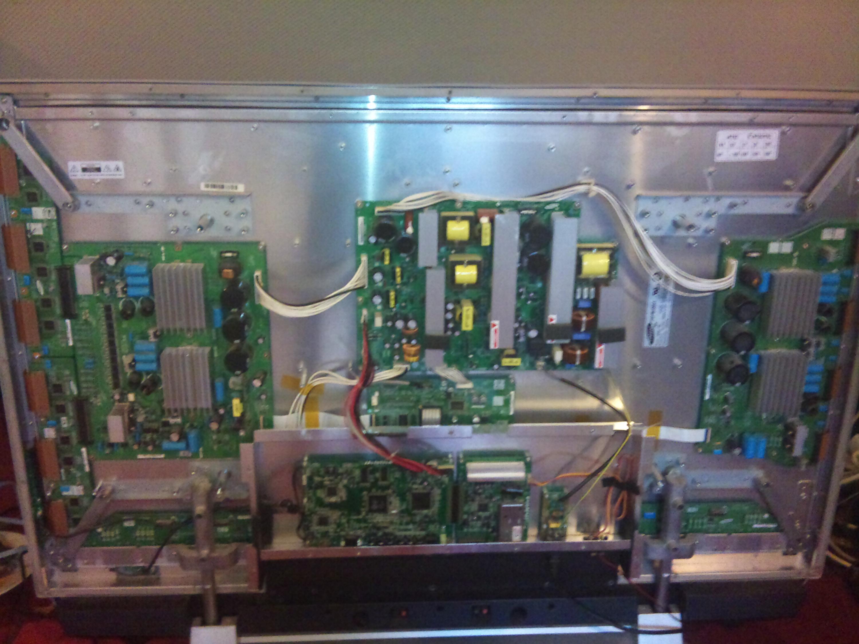

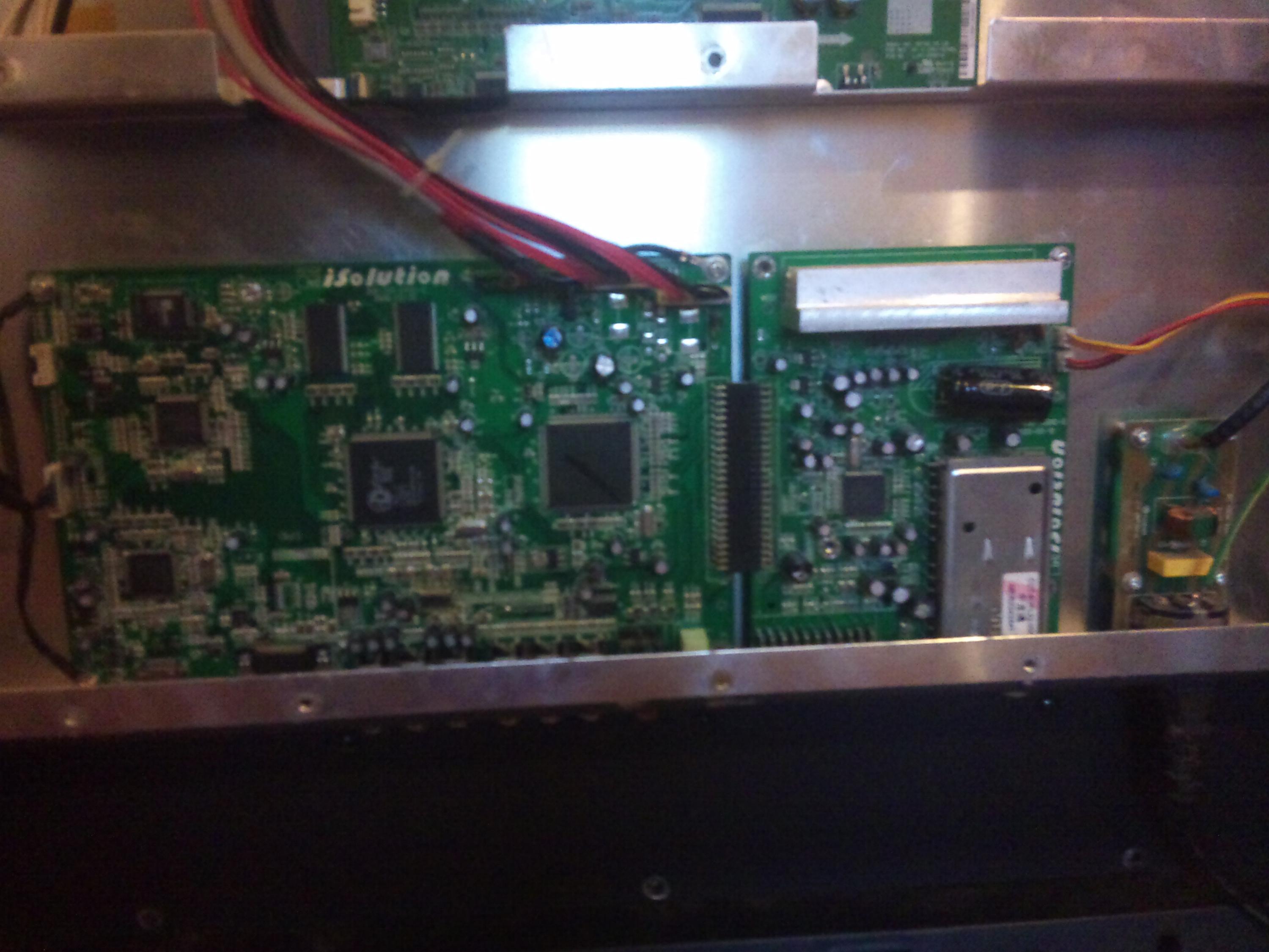

    I've got the following problem: Some weeks ago I got an old 50" Plasma TV from 2006. Though the company's name on the front says "Maqma", the panel and all electronic parts inside are from Samsung. Except for the AV-Board, on which the name iSolution is printed.
    I had to open up the TV before because the Power-Button was not working. Back then I noticed that the AV-Board was bended quite a lot, because of some (too many) thermal pads below it. Because of this the HDMI-Port wasn't working in the first place, but it did when I reduced the physical stress on that board.
    Now two days ago when I hooked up my PS3 via component, the picture was disturbed as if some waves were going through it. Hard to discribe. It was a very hot day, so I thought it's a thermal problem. I noticed such disortions on my monitor before. But before I could turn of the TV, the picture went black, but the TV stayed on.
    I pulled out the power-plug and let it cool down. Then I turned it on again, the Power-LED goes green and the starting sound comes up but no picture at all.

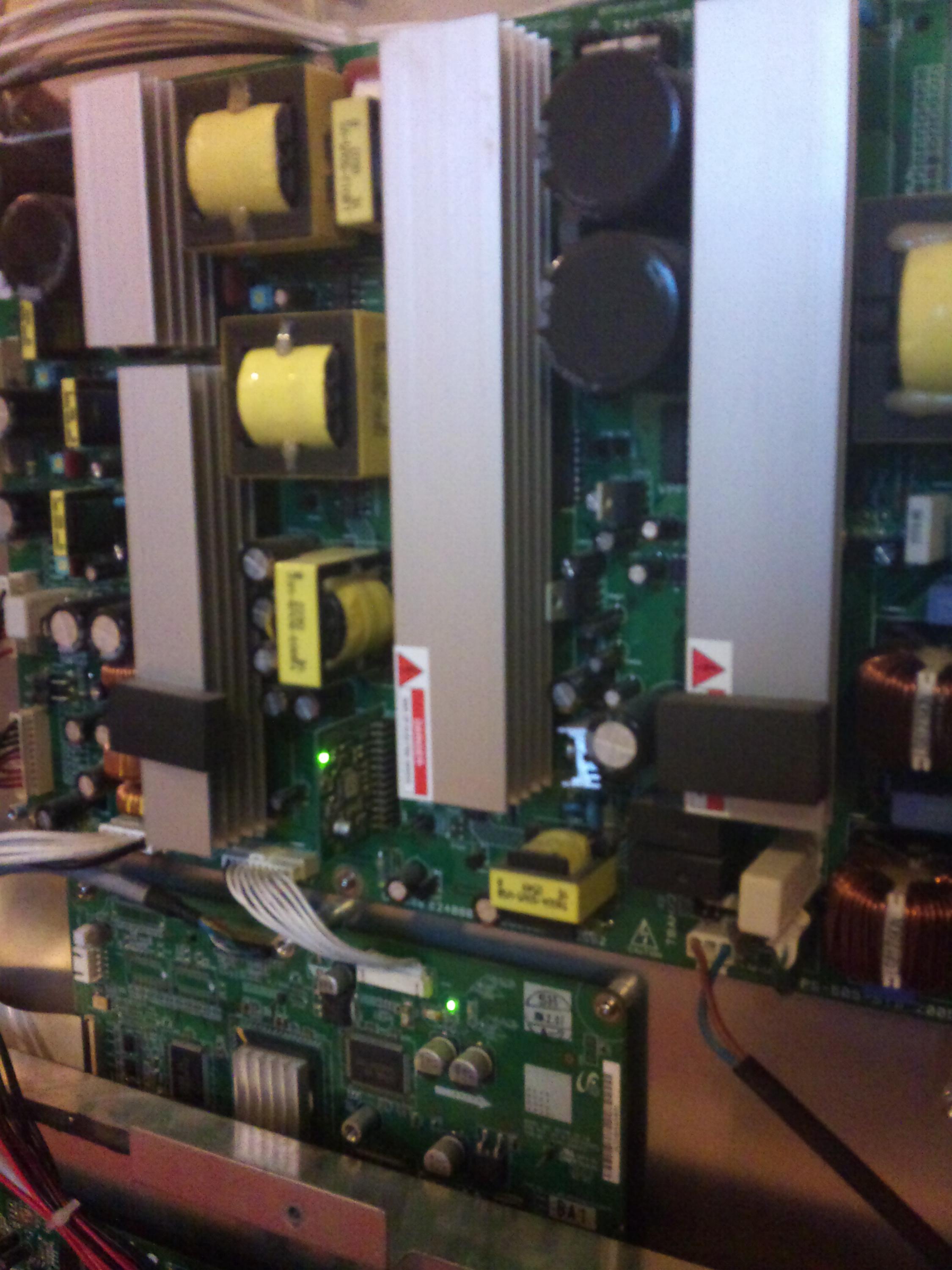

    I measured all voltages from the power supply and they match the ones on the sticker on the panel. There are no blown capacitors and the IC's on the y-Buffers look alright too.

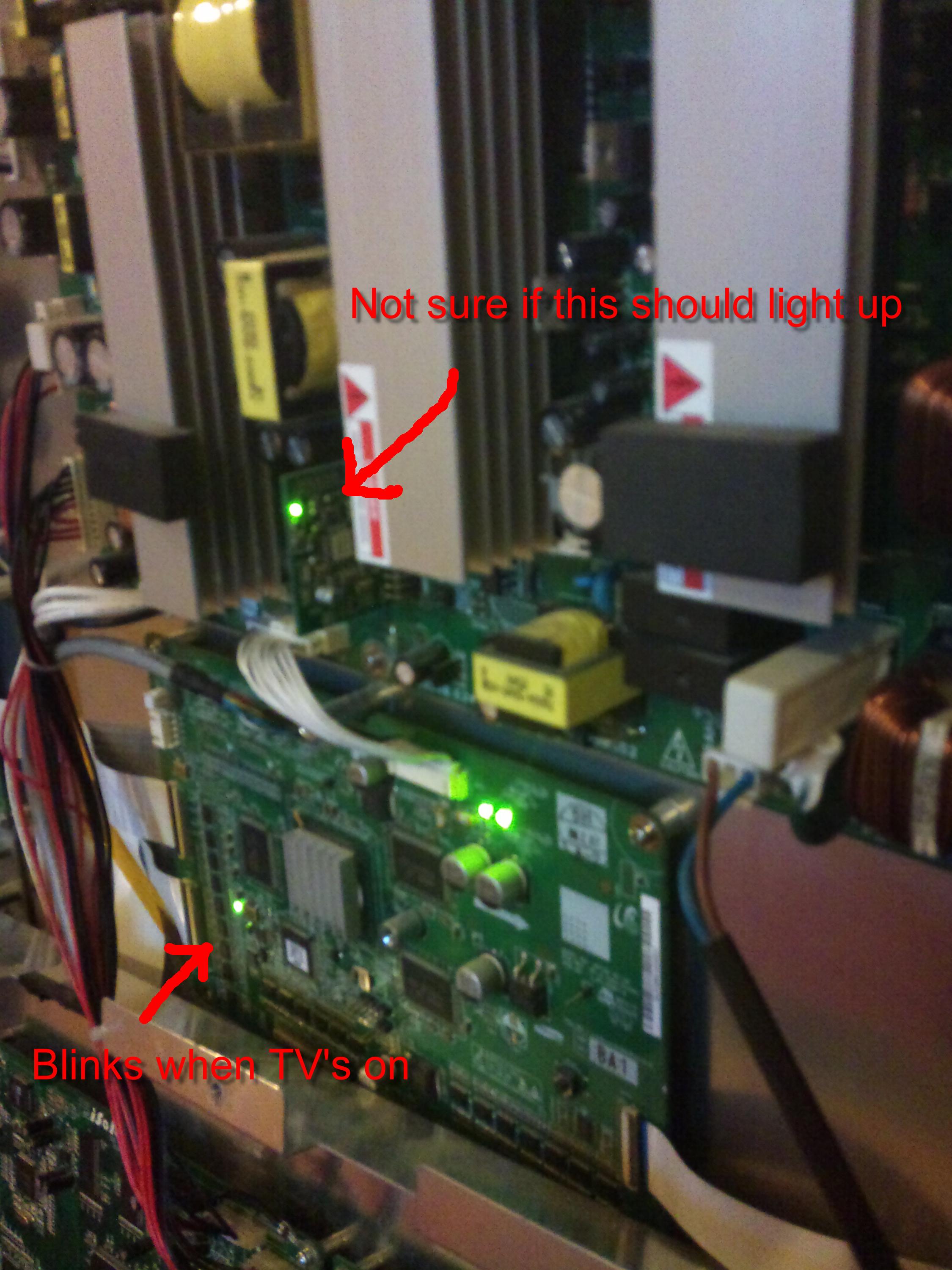

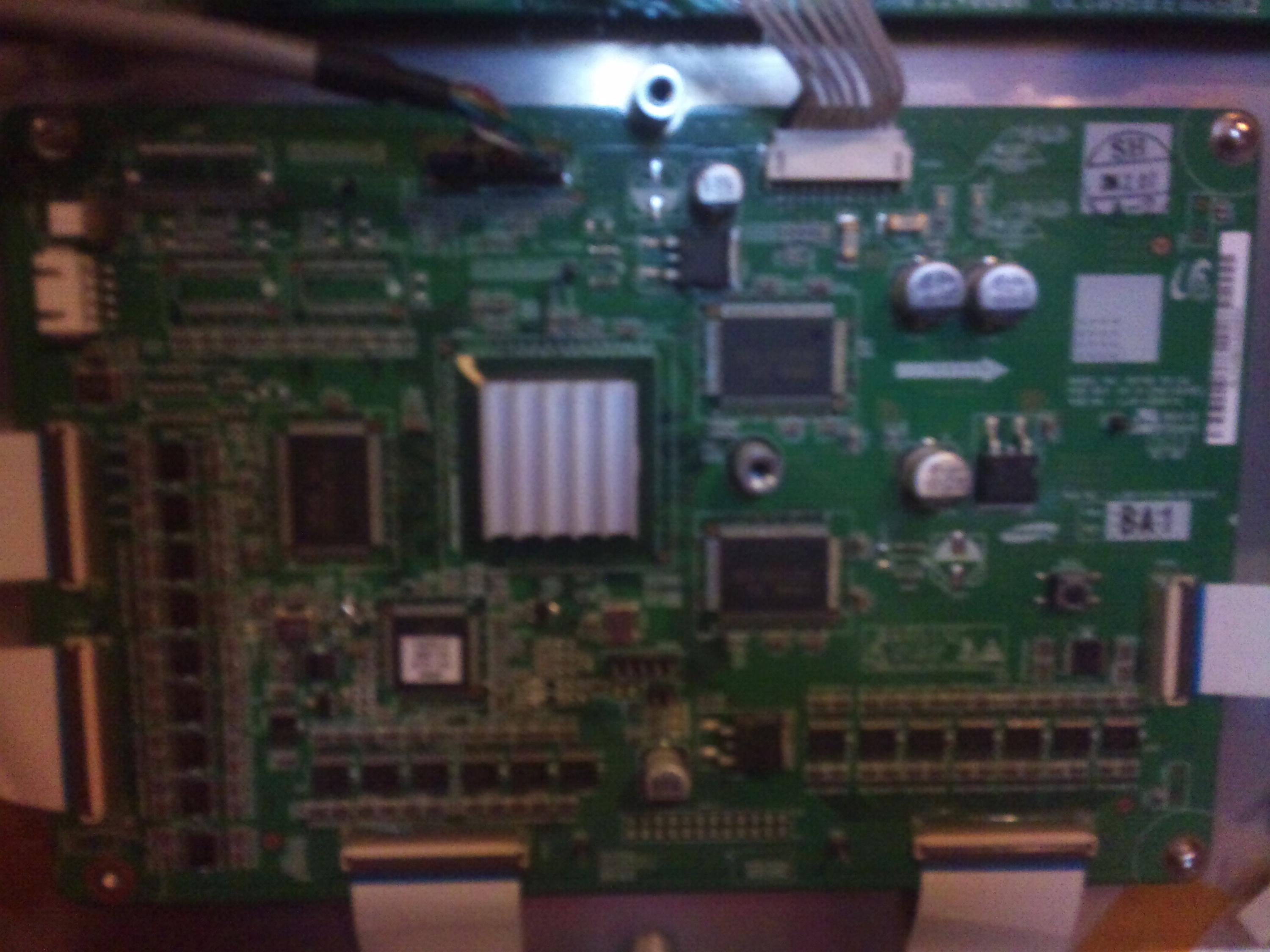

    There's a blinking LED on the Logic Main (think that's alright 'cause it was like that when it still worked I think) but since I have no documentation it's hard to figure out what's wrong. There is also another LED on the power supply board (on some small extra-board on it), which I actually can't remember having seen lighting up before.
    As you see, I have really no idea in which region I should look for the failure. Plus, dispite good soldering skills and some experience with most common parts, I haven't dealed with plasma-components so far.I'm still not sure how correctly check the mosfet's or the IC's for shorts.
    So if anybody has an idea what the problem causes, I'd be glad to hear it.

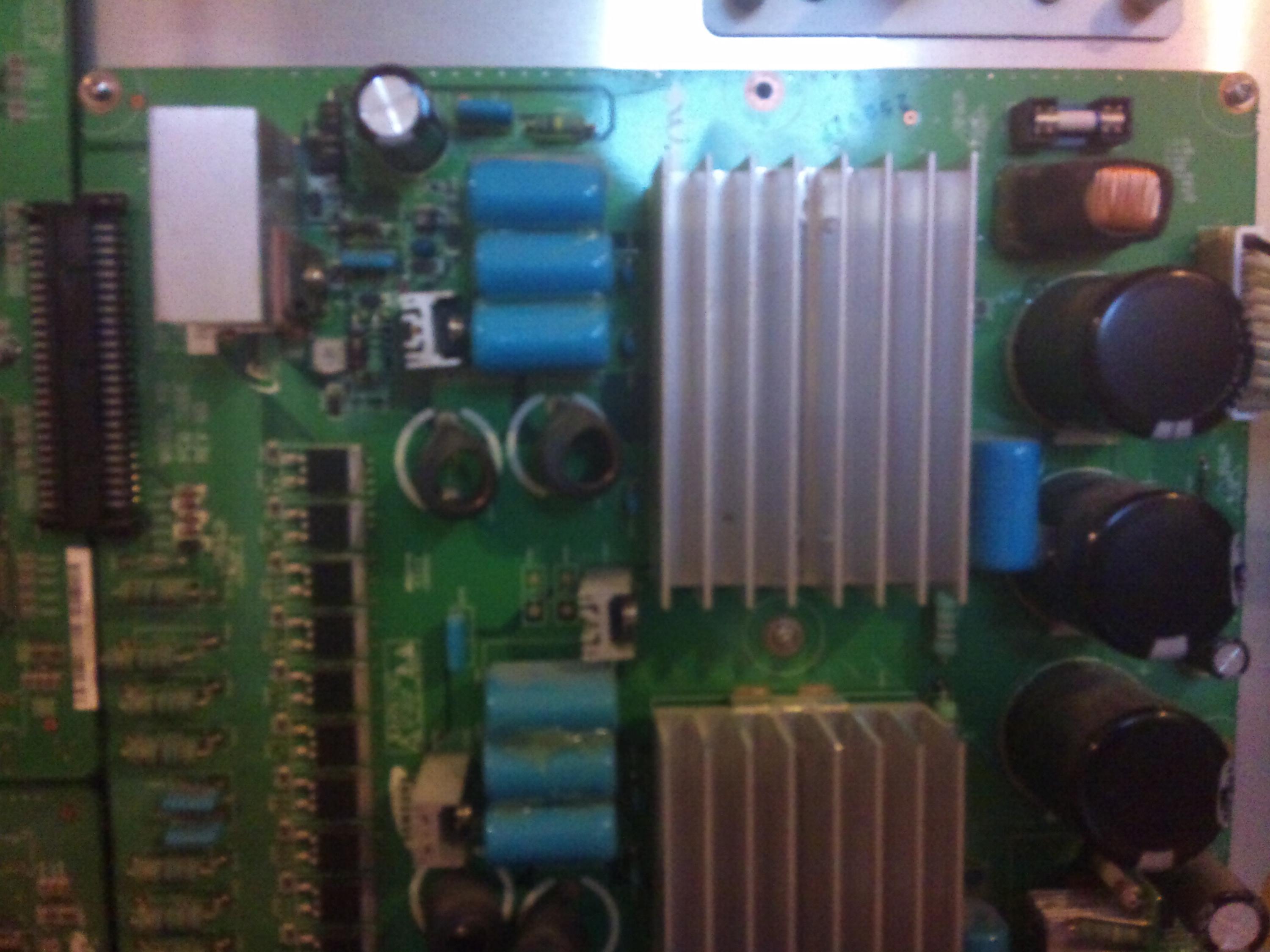

    Post pictures of the layout and boards. familar fault with Samsung, sound no picture, generally bad Ysustain and shorted buffer boards. yours may be an earlier version than the one I'm thinking of but you don't always visually see a blown buffer IC.
    have to resistance check.
    At the start of this forum there's some stickys for tips, guides, manuals, and Tom has a video of buffer checks etc on a Samsung.

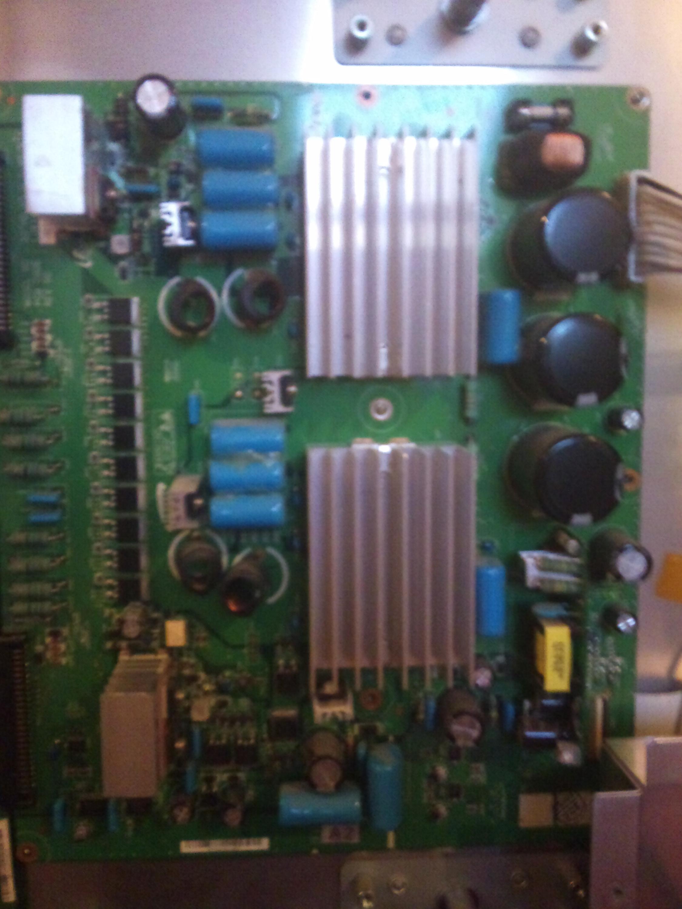

        The part numbers are as follows:
        Panel: S50HW-YD01
        Y-Main: V5.0 LJ41-3078A / R1.7
        X-Main: LJ41-03335A / R1.3
        Logic Main: 50"HD V5 LM / R1.0 LJ4103971A
        Power-Supply: PS-505-STD LJ4400113A
        AV-Board: iSolution 200-100-Ex52-D
        From what I've read Ysus = Y-Main?

              I also read about selftest for the control-board, but I'm unable to find the right jumper pins on my board...

                The Dell W5001CHD comes up when I search using the Y-main and X-main part numbers you listed:
                http://www.shopjimmy.com/samsung-lj9...main-board.htm
                Are you sure about your 5 ohm fuse readings? Yes, the fuses don't usually read that high.

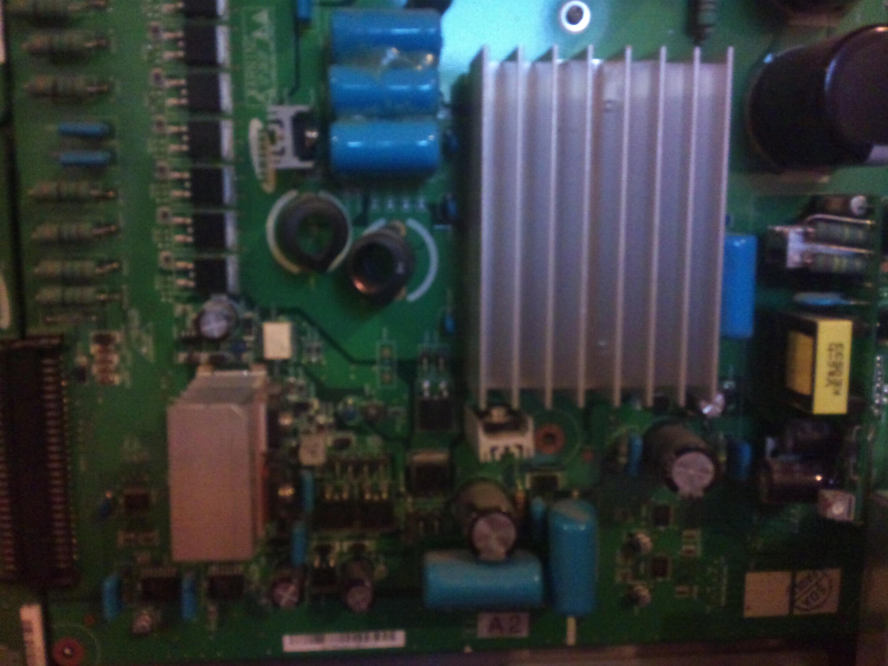

                  Well this could actually be the hint I was looking for. Searching for Dell W5001CHD on youtube brought up this video:
                  https://www.youtube.com/watch?v=xcIuAhSCBjM
                  I already noticed that something might be wrong with those zener diodes, but wasn't entirely sure about it. I'll replace them and post then back!
                    Re: Plasma turns on, but shows no picture
                    I saw a second video earlier that mentioned replacing zener diodes on the Y-Sus for the Dell, also. I'm not sure if that's your issue:
                    https://www.youtube.com/watch?v=kRzk9MzzzdA
                    LG Plasma Mal-Discharge Correction Service
                      Jepp, this seems to be the same issue. I just measured the zdiodes on the lower side and they all seem to be faulty, the ones on the upper side should be okay. Gonna buy some replacement zdiodes by tomorrow. Hopefully it works
