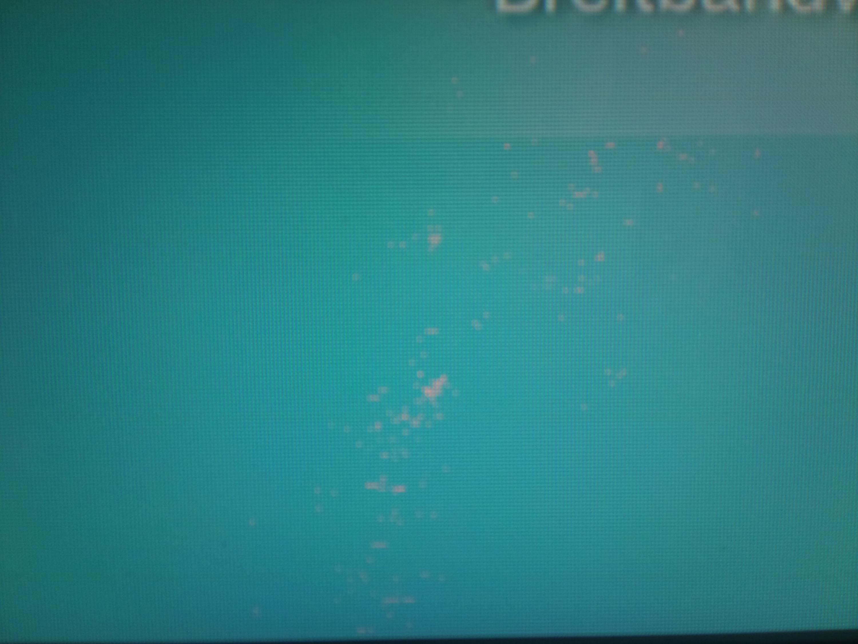

          Changed the battery of my multimeter. Now it gives me the correct values. The flicker is almost gone.
          Unfortunately the two small areas of noisy (yellow) pixels remain. Though they are only visable on light blue background. When the background color changes, they're completely gone.

            Would you describe the noise as POSITIVE (that is pixels are lighting up when they should not) or NEGATIVE (the pixels are going dark when they should be lit up?)
            • Daysleeper
              • Aug 2013
              • 23
              Re: Plasma turns on, but shows no picture
              Well, positive then I guess then. They just jave the wrong color, yellow instead of light blue. On dark blue background or black for example they're not visible at all.
              They seem to go on and off very quickly but basically staying in the same place.
                OK, in which case, you will need to tweak, in order:
                Vset (decrease by up to 10V)
                Yfr (rotate)
                -Vsc (increase [make more positive] by up to 10V)
                Do each in turn, and play around with combinations until the picture improves.

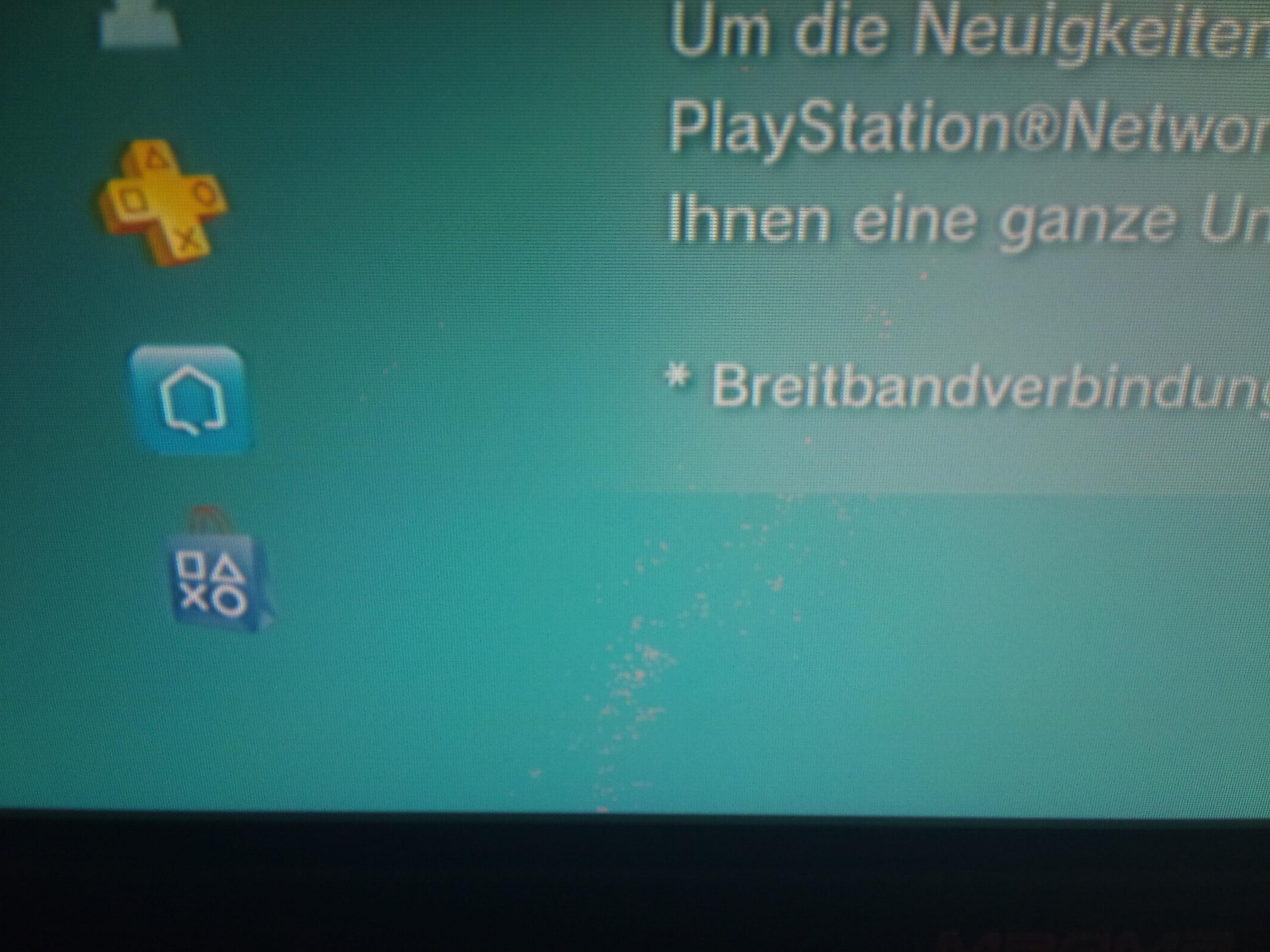

                          First I lowered Vset from 190 to 180 and watched if anything changed. Then I turned YFR. Then I set Vscan from -190 to -180, watched, turned YFR. Nothing. Then Vset back to 190, once more YFR, nothing.
                          I suppose it's YFR cause it's not labeled. Turning it up very high produces lot's of noise. Still think it's the right one. The only other screw on the board is labeled YRR.

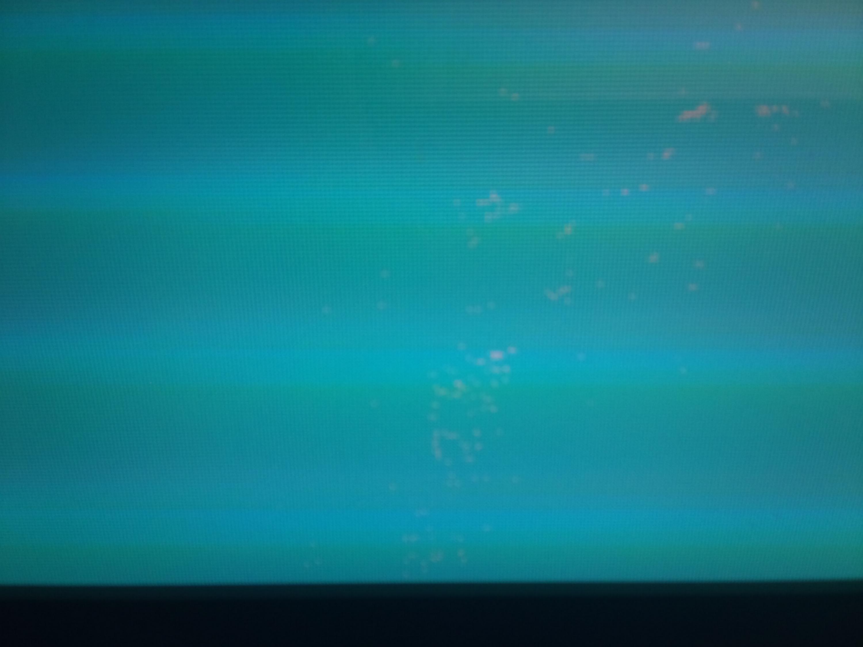

                              There is not much, that I could lower, since most screws are already very close to the left. Turning Yrr and Yfr doesn't let even one of those pixels vanish. No effect on them.
                              Playing a game I noticed them in the upper area around faces when there's movement on screen. Not very annoying but noticeable...

                                  I did try both directions but most screws can basically only be turned right, turning left they physically hit their "limit" and can't be turned any further.
                                  So all I can do is increasing (turning right). In the case of Vfr the picture goes very noisy at some point.
                                  Changing the menu-options for contrast, brightness, saturation, etc. causes those pixel areas to change their position on screen, but I can't make them go

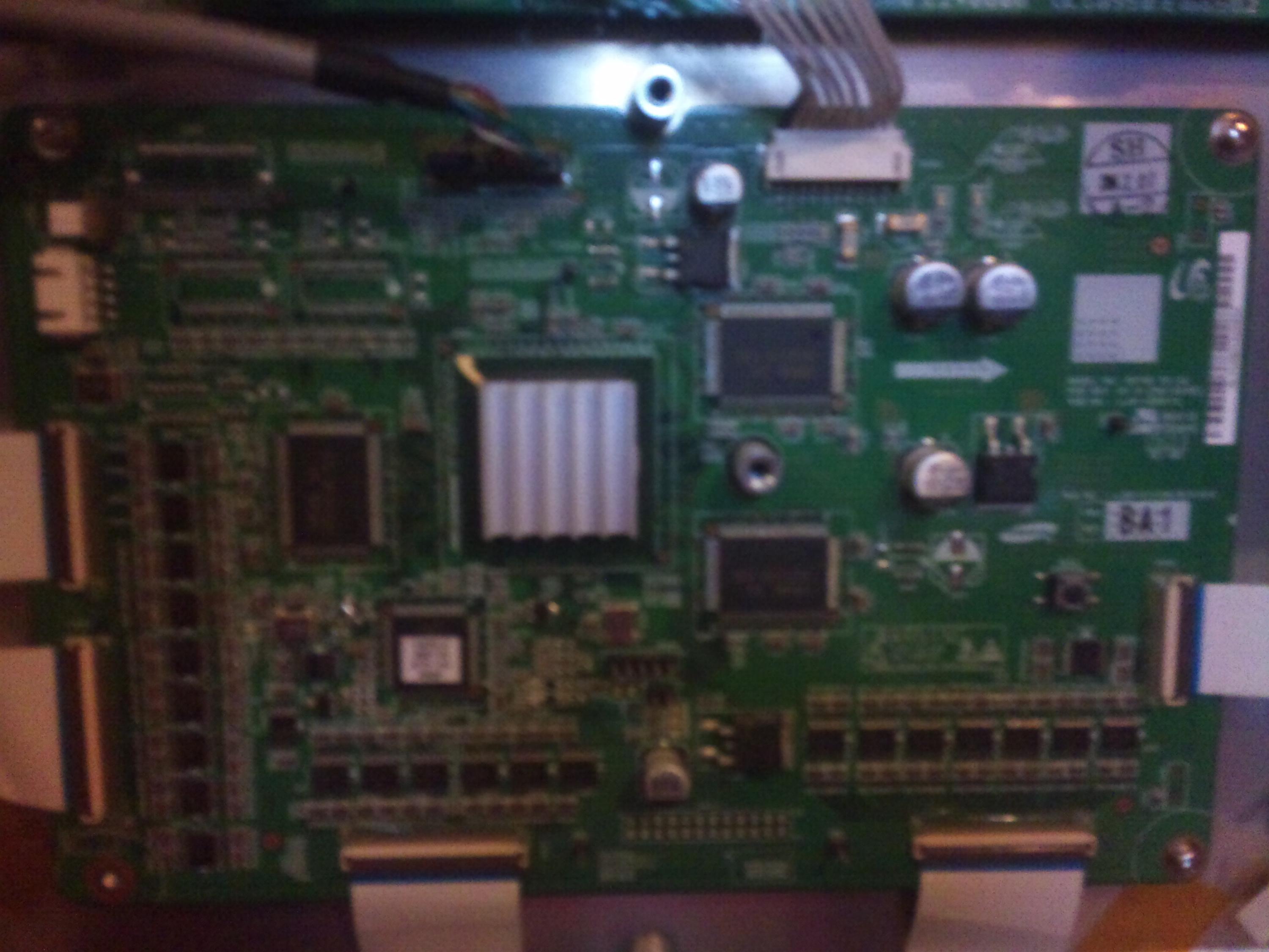

                                        So, I better leave it alone.
                                        Since the menu-options have an effect on the "pixel-swarms" I came to thinking that the mainboard might be the reason.
                                        I read an article by you bout some selftest for the controle board, but I don't know the jumper points for my board. Would you have a look?
                                        I know it's a very bad photo, but maybe something looks familiar...
                                          #40
                                          The problem isn't likely to be on the main board. The plasma panel on these older Samsung & LG based TVs is prone to getting maldischarge due to ageing of the panel. This can often be corrected by increasing or decreasing various voltages, or by adjusting the timings (Yrr & Yfr.)
                                          Self test see here: https://www.badcaps.net/forum/showthread.php?t=26790
