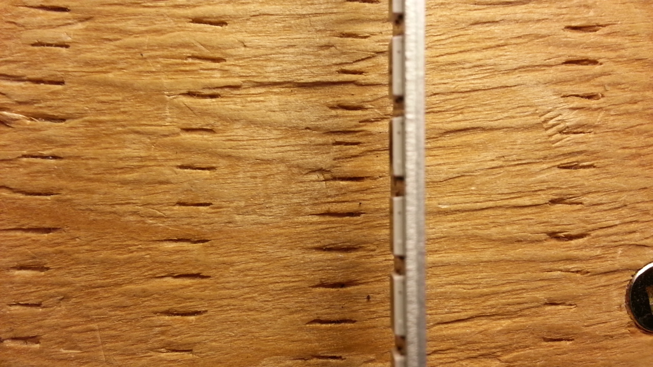

    I cannot. I can't tell if the heat is being wicked away but I do damage to the led long before anything comes loose. In fact nothing comes loose at all. I will try again later. But if that doesn't work I'll probably look at sawing into smaller working strips and replacing them that way.
    Here's an edge on look
      #82
      Re: Samsung UN55D6450 turns itself off and on endlessly, no blinks
      Looks like ceramic substrate with metal core, and yet they still overheat. I'd use hot air, if available. Cover the LEDs you don't want to remove with foil to avoid damage. You usually don't care about preserving the dead LED.
      • mmartell
        • Oct 2013
        • 3189
        #83
        I've tried hot air already. Seems to make the material covering the led itself come off easily once touched.

                            #93
                            OK, here's how it look like. tried to take pictures in the dark to see the backlight, but the camera doesn't do quite well . But it-s clear that the top 1/4 is not lit. Here's a video too maybe it's better.
                            https://www.youtube.com/watch?v=OLWP328jrgM
                            According to this video ( ~ 14min ) , the tv has micro dimming technology meaning that each led can be independently turned on/off. I don't understand then why is such a long surface not lit, about 1/4 of the side edge, I can't believe so many leds burned out.
                            some questions ...
                            did you manage to replace the leds?
                            where did you find the replacements?
                            can be replaced on individual basis?
                            are these normal usual leds?
                            thanks.
                                    I've checked the closest fast-track guide to my model, from Tom's site a UN46D8000, the only thing it mentions is :
                                    Forced Backlight-On Mode:
                                    1. Disconnect Power Cord
                                    2. Disconnect wire harness from CN201
                                    3. Re-Connect Power Cord
                                    4. LED Backlight should immediately turn on
                                    That's what I did when I took the pic and video from my last post. Noticed that the power cycling is the same even without the main connected, so the PSU has some kind of backlight check and restarts the PSU.
                                    I saw the fast track for 55D6900 mentioned in this thread earlier, which is a bit more in details regarding the backlight activation. I guess it's not necessary to apply the jumper wire to those pins, although I do have the same PWM pins on my board.
                                    Now we know the leds are gone. What's next?
                                    how can I replace them?
                                    can be replaced on individual basis ? or the 1/4 length or the full led stripe?

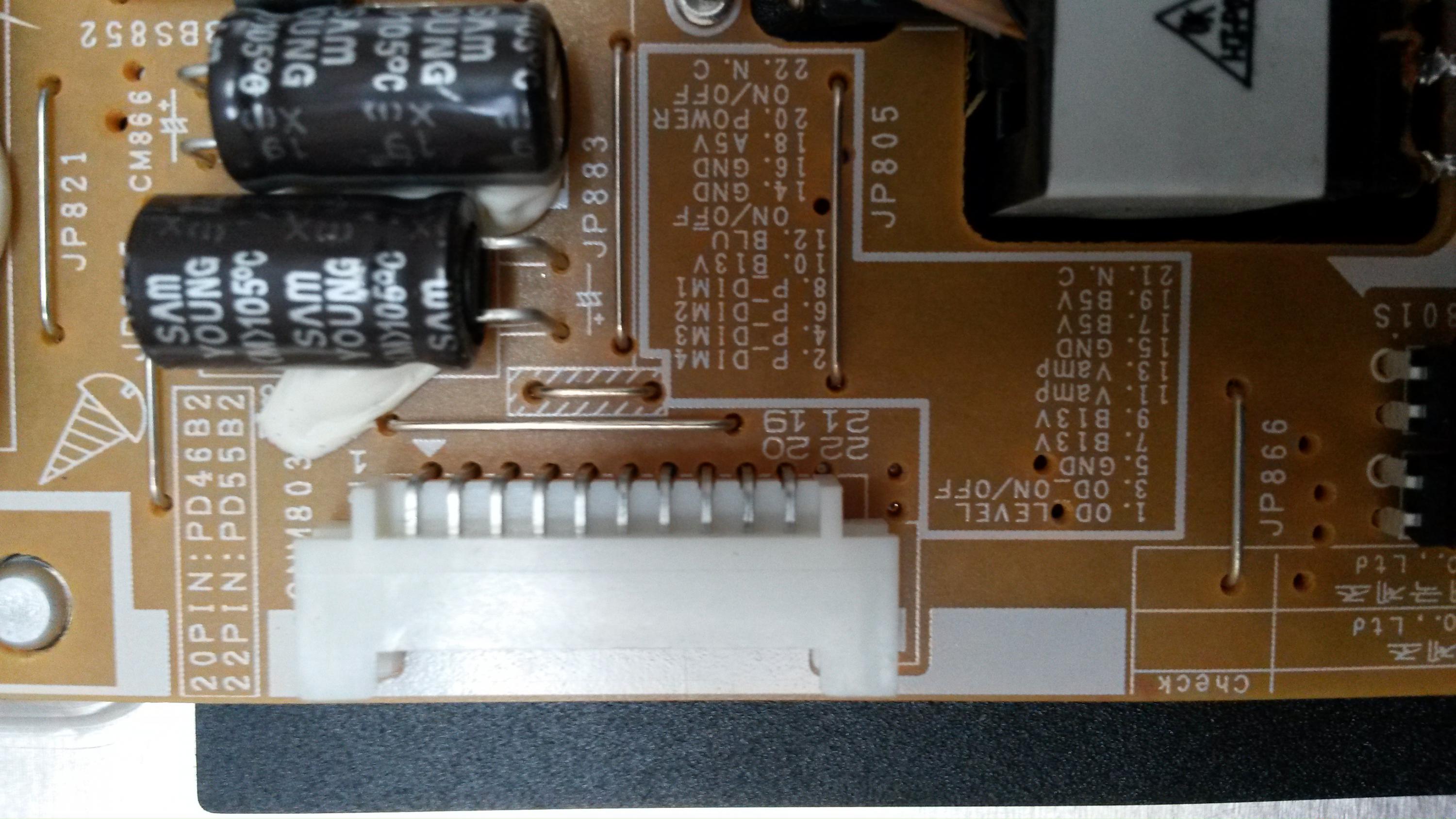

                                            Samsung UE55F8000SZ Turns on and off immediately
                                            by Egidio85
                                            good morning, I have a samsung UE55F8000SZ tv that turns on, shows the logo and turns off after 1-2 seconds.
                                            This defect happens continuously, hearing the classic click of the relay every time.
                                            Power supply board BN44-00636B
                                            disconnecting the mains and lamps from the power board always causes the same problem.
                                            Is it normal that without anything connected this power supply turns on and off cyclically?
                                            any suggestions on what to check?
                                            thanks in advance
