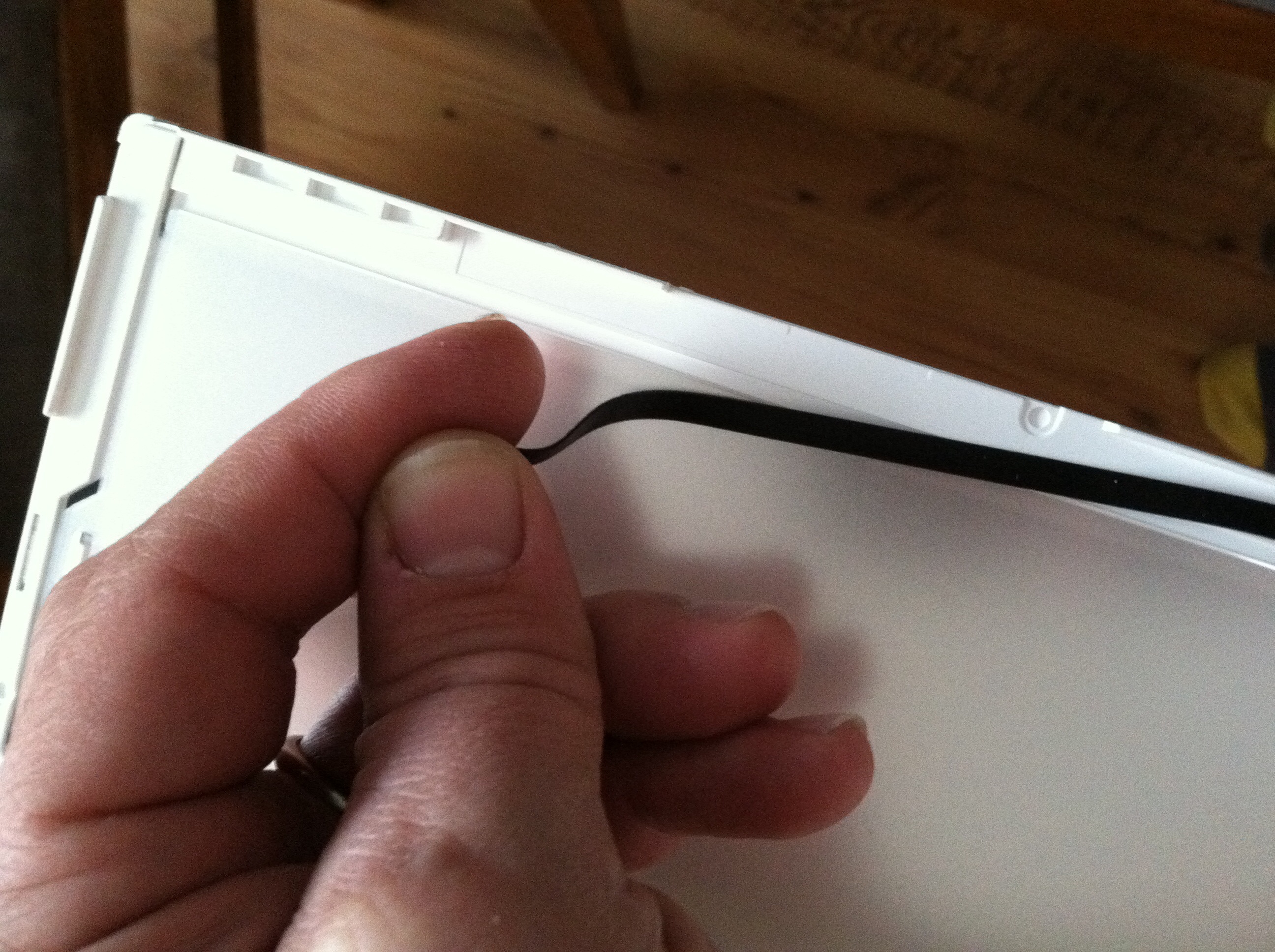

      Re: Samsung UN55D6450 turns itself off and on endlessly, no blinks
      There are some slightly sticky rubber strips between the LCD and the casing. Be careful. It's not very sticky. But it could cause damage if you're not careful.

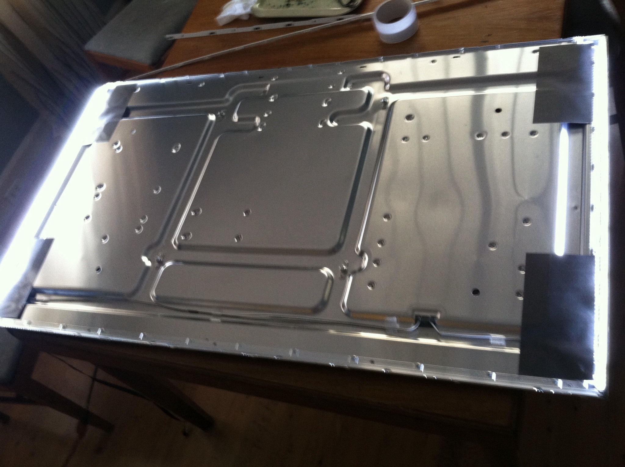

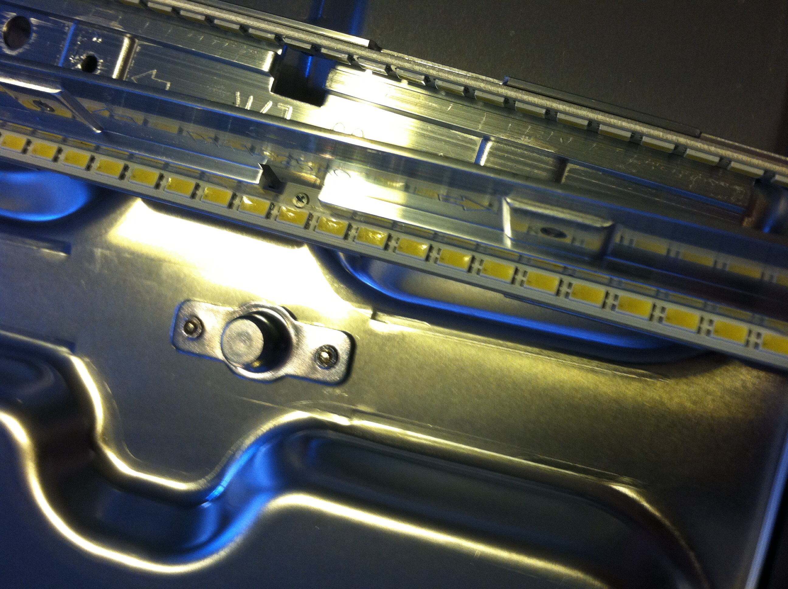

        Money shot. The LED strips are on the left and right sides. No LEDs on the top or bottom.

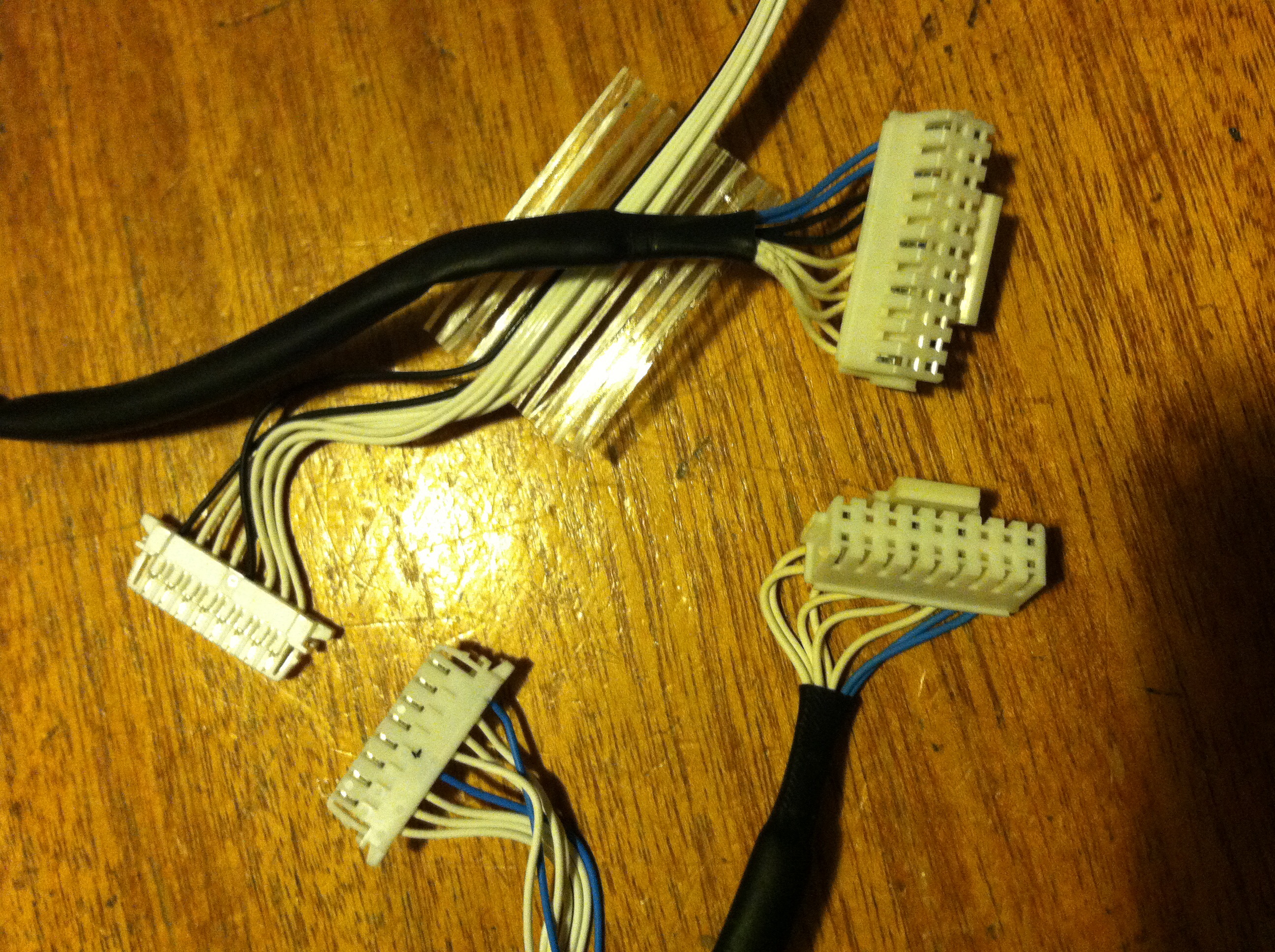

            How many wires going to each led strip ?
                Eight
                  Eight ?? Jesus, I only have four wires total going in, assuming I have two strips that's only two wires a piece. Quite a difference.
                    There are two harnesses running into the panel from the PSU. The harness for the left strip has ten wire at the PSU but only eight at the strip. The right has right at both ends.

                          Ok, John's LED strips arrived and I tore the panel apart and inspected the LED strips. Sure enough, the left side (facing the rear) had a burnt out LED just a little up from the bottom. I swapped out that side and powered it up. Both sides lit (HOORAY!). I put it back together and now have a working set. All you folks who suspected a faulty LED strip should take a bow, you were right and I would have saved a lot of trouble had I just listened from the start.

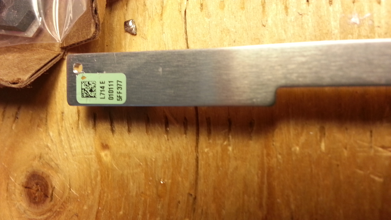

                                    #77
                                    Wow has anyone taken one of these off ? I am butcheting my board and they won't budge.
                                    Here is a pic of the underside of the strip when you take it off the rail/heatsink it is screwed to. Maybe these numbers mean something to somebody (or google lol)
