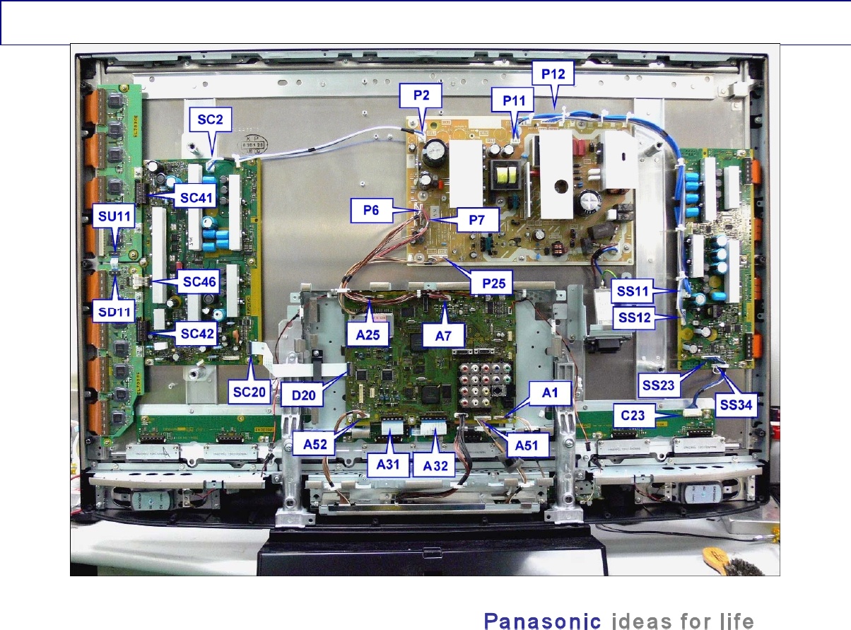

    i got an Panasonic TH-42PX8E TV from a friend because its not working anymore, he told me that it already had a failure before, and he has given that device to an techican who only has replaced a fuse which worked for 2 months. (i could get no more specific information)
    the TV has the following symptoms:
    - i hear only one a triple relay click directly after power connection or powering off and on again via button
    - the standby LED in the front lights red while on and does not blinking
    - there is also no blinking LED on any Board
    - the display does not power on and keeps dark
    - no visibile Parts are burned
    - based on my information about the blown fuse, i've replaced Q406, F401 and F402 but the problem still remains the same
    - disconnecting the SC and/or SS Board does not change anything
    can anybody help me with that?
    Thank You

      Hi Tom, thank your for your response. i could not find D5 or A5, but P6, P7 and P25 (see attachment)
        Re: Panasonic TH-42PX8E only relay click, no blinking
        It looks like they've combined the A and D board into one board. Since the unit makes no attempt to power up, the A/D board is almost certainly the fault, but you can check some other things to rule them out.
        You will need a digital multimeter, do you have one?

            Check the VSUS line, do you know where to test that?

              i found vsus on the power board but im not sure on which point i could get it.
                There should be a two-pin blue/white connector, one going to SC and one to SS... VSUS is measured on one of these pins (the other probe goes on the chassis as ground.)

                  i get only 0,8 - 0,9 Volt on both connectors (P2 and P11)
                  it looks like that the value slowly increases.
                    OK, when you plug the set in, do you hear just one click, or two rapid clicks from the relay?

                              Hi, I know Tom is running with this one but in post 2 I believe he was trying to get panel on without the a-board.
                              Also with Q406, F401 and F402 , did you replace these because they were all faulty/blown?
                              If so, check R411, 10ohm 5W ceramic resistor, tall large white one nears those fuses, maybe open cct.
                              I found this for 11th gen plasma.
                              "The result obtained on previous generations when D3 was disconnected, can now be obtained by disconnecting A6/P6 and A7/P7.
                              When these connectors are removed, the A, K, GH, and S boards are disabled.
                              Normally Pin 2 of connector A3 is grounded by Q4014-Q4015. When A6 and A7 are disconnected pin 2 is no longer grounded. This allows for the 3.3V regulator on the D board to output 3.3V to the Panel CPU (IC9003).
                              The Panel CPU (IC9003) outputs a command that is provided to 2 different circuits.
                              The “Panel Main On” command (3.2V) is connected to pin 11 of connector P25 on the power supply turning on the circuit that generates Vsus, Vda, P15V, and P5V.
                              The “Power On/Off” command (3.2) is connected to the Video/Panel Control and Discharge circuit to output the panel drive control pulses.
                              This method of isolation is useful when troubleshooting problems where the A, GH, K, or S board are suspected to be defective."
