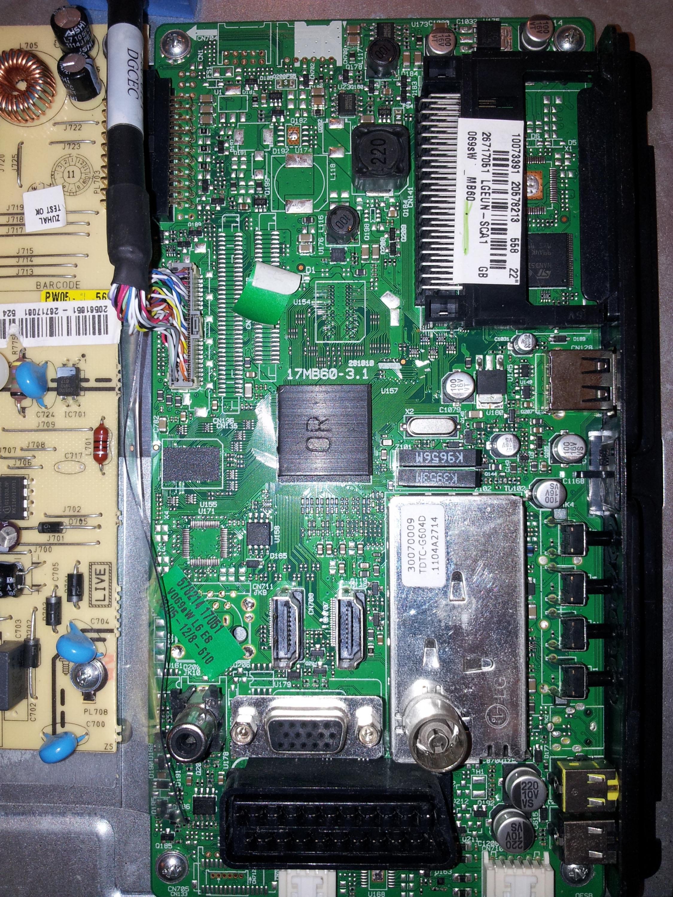

      Re: Technika 22-880 startup issues
      Main A/V: 17MB60-3.1
      S/C across D202 - Pin2 VIN on U23 (RTA8283A)
      Needs further investigation but trouble tracing layered pcb.
        #43
        Erm, perhaps its not a diode afterall, but what is it? It reads S.C in-circuit so perhaps just a zero ohm jumper resistor??? But usually they have a '0' printed on them, but not this one.
        Its the 3rd SMD down on the immediate left (the black one)to U23 located near the top of the board.

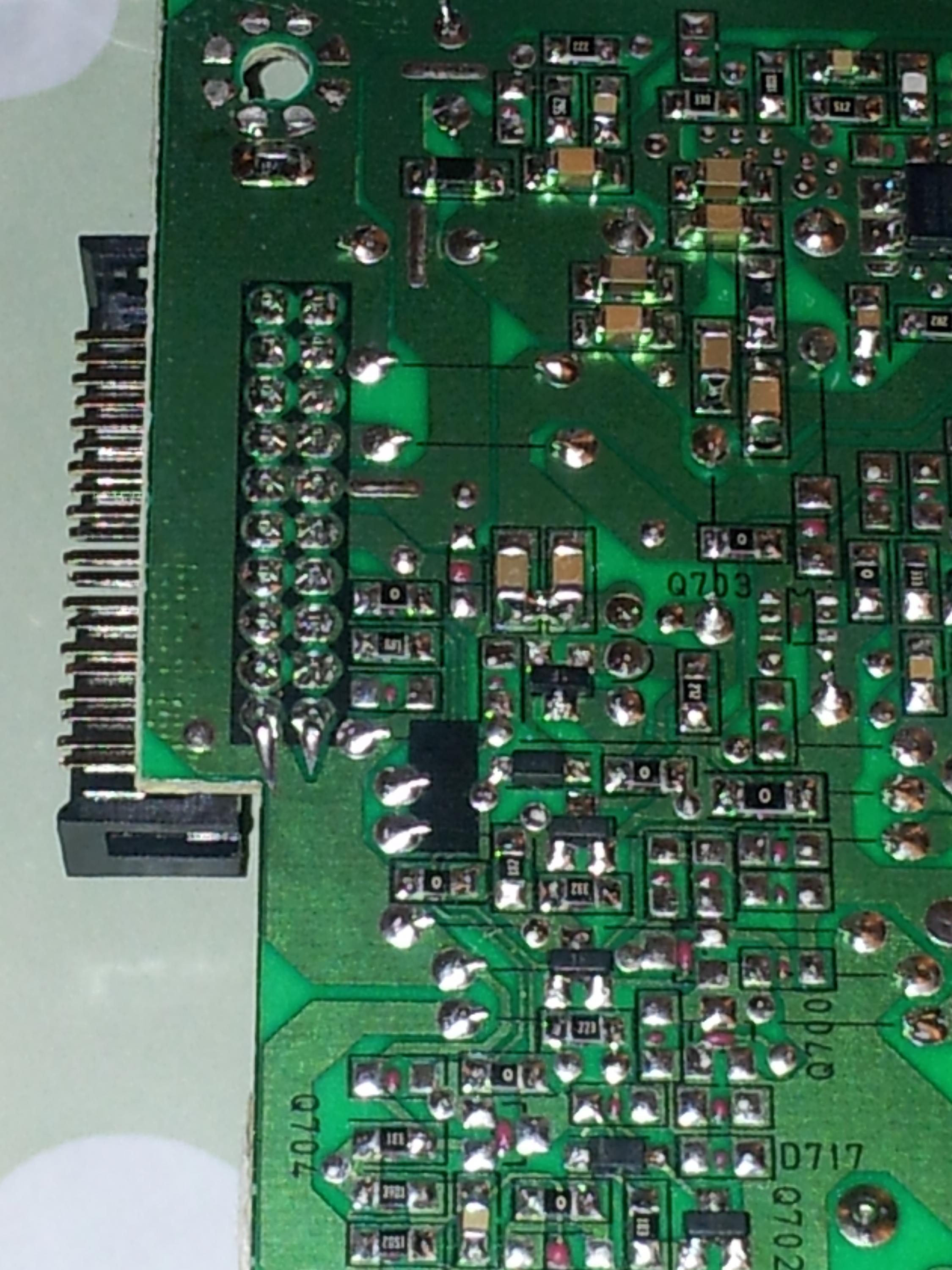

              Tracing back PL703 Pin 11 Stby_5v it goes back to a 3 leg, I think transistor, Q713, it has 1F printed on it. In the photo its located in the middle just below the 2 smd light brown caps.
              Top left leg - reads a dropping voltage to below 0.5v
              Top right leg - reads a steady 5.49v
              Bottom leg - reads a steady 11.07v
              Is this the transistor itself at fault as there is not anything else connected to this leg and the voltage is dropping at a rapid and steady rate. Internal leakage?
                #47
                  Testing in-circuit with a DMM in diode setting it gives different results to other '1F' trans on the board and not what would be expected.
                  So guess I'll have to source a replacement and go from there. The only concern I have is removing the existing and re-soldering the new without causing any damage to the board.
                          By the looks of it I can remove the SMD transistor and use a T0-92 package transistor (on component side of the board) utilising the board holes that exist for a transistor Q714 that connects to all the same tracks.
                            #53
                            That should be fine, I have done that before with Vestel which used SMD diode but had through hole pads, I just used the through hole pads as they were available.
                                    Using a BC547 TO-92 has brought the 5V_Stby back but still no go.
                                      Found Q200 on main A/V, its either a FDC642 or a FDC604P, can't determine which one from the SM but its a PowerTrench MOSFET either way.
                                      Between Pins 3(Gate) and 4(Source) reads 32kOhms, on diode test no reading with probes both ways.
                                      However, Pins 4 to 1,2,5 and 6 (Drain) shows S.C, 0 ohms.
                                      And Pins 4,1,2,5,6 show S.C to CN706 Pins 12v_stby and 12v_vcc.
                                      The main a/v board is disconnected from the PS b/d and other boards.
                                      With boards connected and powered
                                      5.4v on Gate
                                      11v on Source and Drain
                                      On checking the Mosfet again there does not appear to be continuity between Pins 4 to 1,2,5 and 6.
                                      I would expect continuity when its powered, isn't that what it does? As the name 'Gate' suggests, allows Source voltage across to Drain. But would think it would be O.C, well have high resistance, when powered off.
