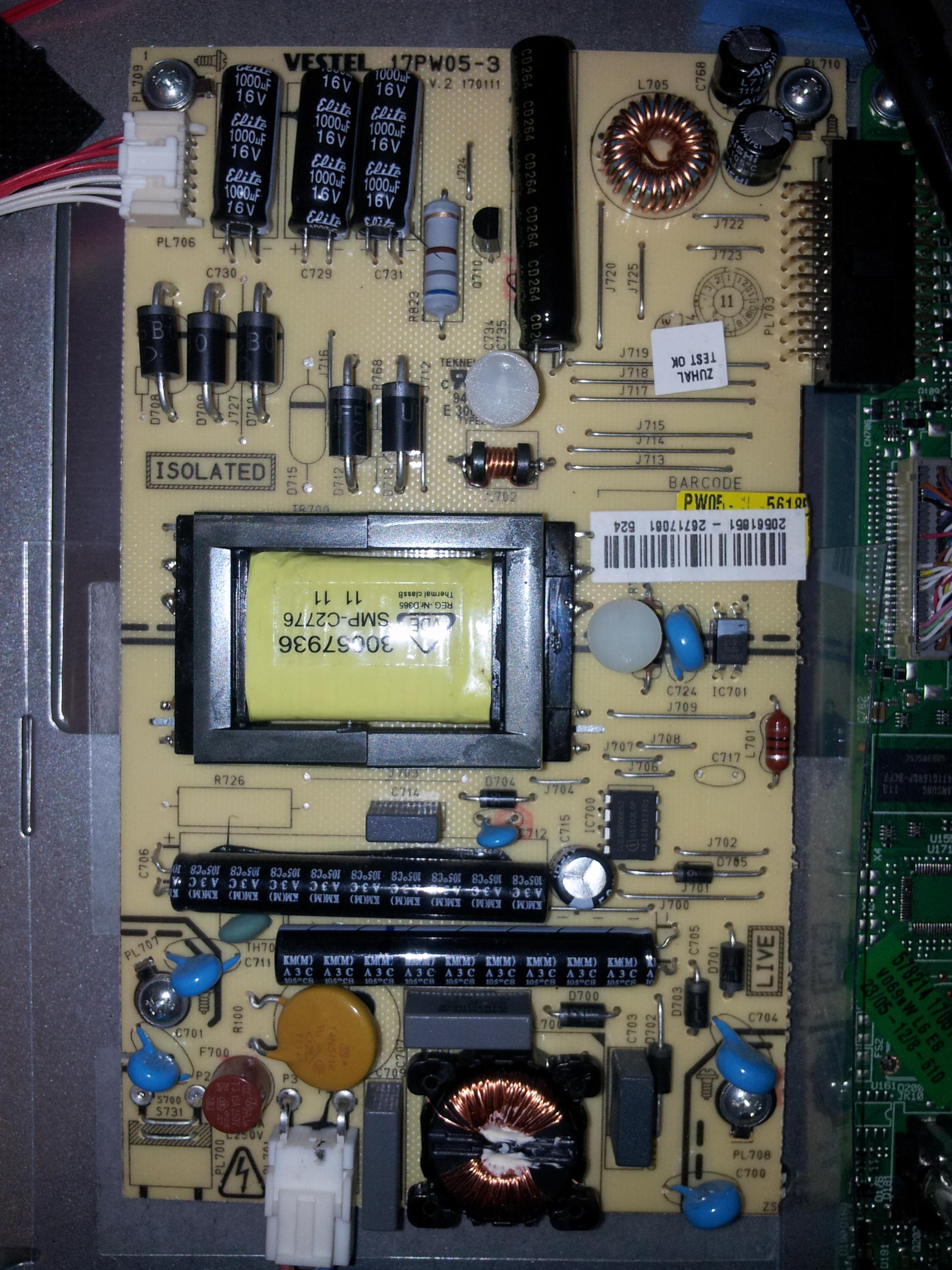

    Technika 22-880 startup issues
    The tv sometimes turns on but always with 15 front panel flashes and when switched to standby with 7, sometimes 10 flashes.
    When the tv is on it works perfectly well.
    PS b/d : 17PW05-3 V.2 170111
    Main A/V b/d : 17MB60-3.1
    On the PS b/d on the connector next to PL706 when the tv is on and 'working' (numbered from top to bottom):
    1 - 22.3V
    2 - 22.3V
    3 - 3.06V
    4 - 2.18V
    5 - 0
    6 - 0
    Looks like this is for the inverter, must be 1) & 2) for 24v rails for backlights, 3) BLOn, 4) Dim, 5) & 6) Gnd
    On the PS b/d on the connector next to PL703 when the tv is on and 'working' (numbered from top to bottom):
    1 - 3.3v (tv in stby reads 5v)
    2 - 3.3v
    3 - 3.3v
    4 - 11.12v
    5 - 5v
    6 - 4.97v
    7 - 2.23v
    8 - 3.12v (tv in stby reads 0v)
    9 - 0.02v (tv in stby reads 3v)
    10 - 0v
    Can't access the other pins currently to take measurements.
    This tv does not have a keypad so only operates from a remote which luckily I do have for this one!
    Are there known issues with this Vestel based PS or main A/V b/d? I am aware that these Vestels are known to have issues.

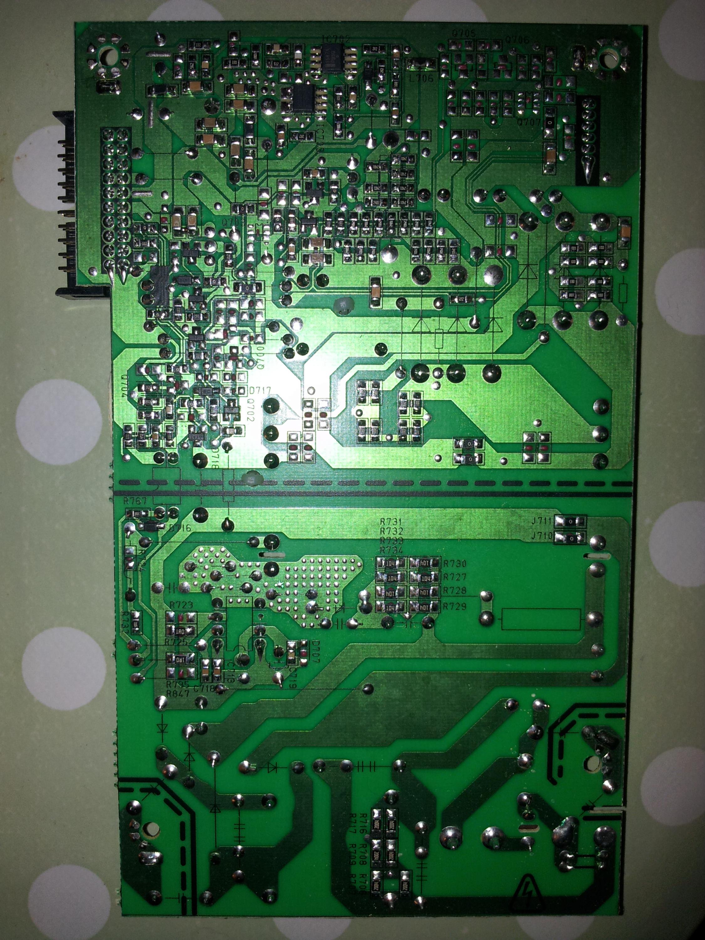

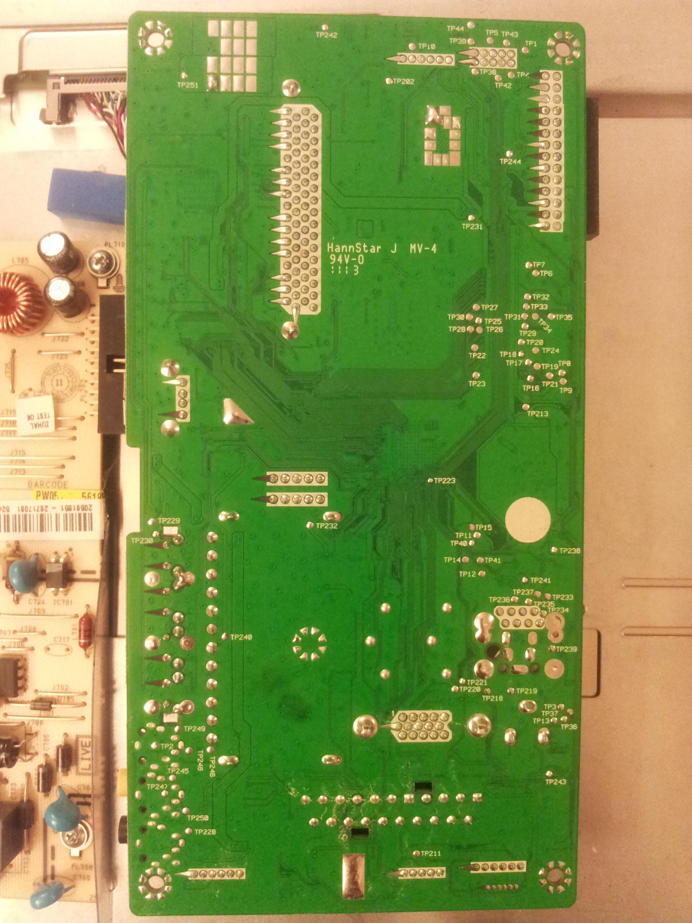

      Re: Technika 22-880 startup issues
      Board photos

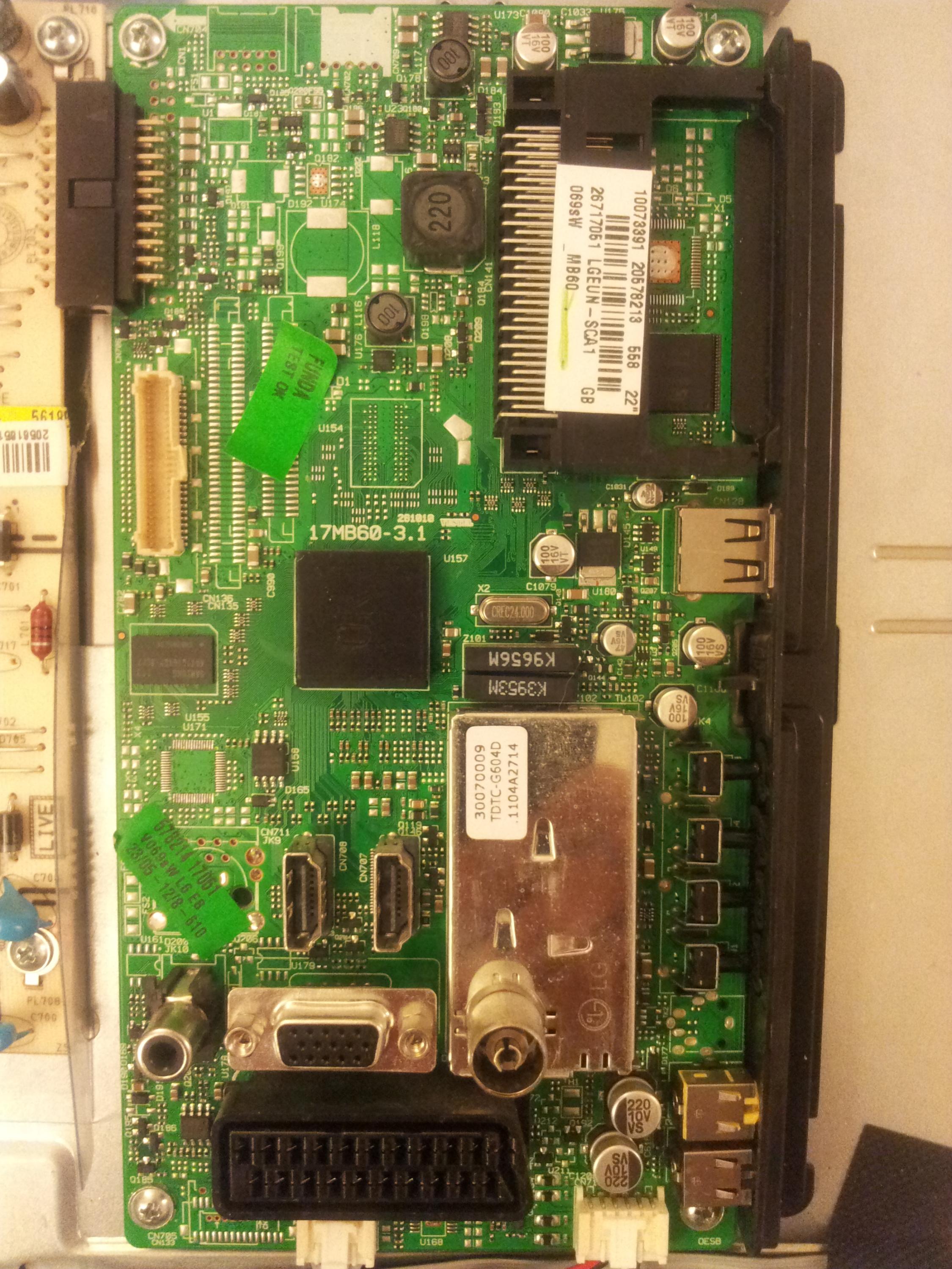

        Hi Guys back with this one!
        Seems that everything works fine, USB port, HDMI ports, Scart, Vga In, DVB Tuner, volume etc.. etc......
        PS b/d voltages seem to be alright so decided to look at the Service Menu and found a Diagnostic page though most options are locked(Read-Only),
        HDMI I2C says NOK
        Ethernet says NOK
        CL+ Credidentals says NOK
        After doing a Factory Reset the following item was added to the above list, before it said OK.
        IF I2C says NOK
        I don't think Ethernet and CL+ are of concern as the Tv has no Ethernet port and the CL+ has no purpose here in the UK, not as far as I know.
        Strange that everything seems to be working including the HDMI and Tuner yet the I2C's are showing errors.
        When the tv is powered up into Stby the front LED flashes 14 times then flashes again when brought out of standby 13 times, this does change.
        The fault almost certainly is on the A/V b/d, but not sure what to look for here.
        Another strange thing is Hotel Mode is set to Yes and yet it can't be as all functions(keypad and remote) and inputs are working, odd!
        I guess I could update the FW currently V.0.6.9s but don't think that will be of any benefit here.

            Reading another thread working on a similar Vestel board I looked at the regulators and found 8v (Pin 3, tab up pin on the right)on the one near that C1083 which was found to be the fault but is 8v to be expected?
            Tab up, Pin 1 and 2 (left and middle) reads 1.21v across them, slightly lower than to be expected but would think that is within tolerance, or not???
                        In standby theres a buzzing diode D704 next to the transformer, could this be the fault? Or the 2kv cap or the ICE perhaps?
                        What is this part of the circuit, rectification?
                        How can I test for voltages here, where to probe and what readings should I expect? Thanks
