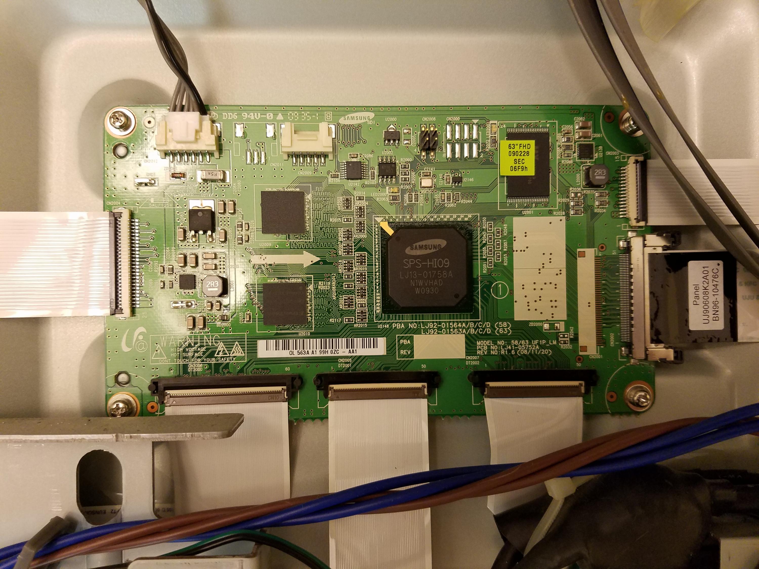

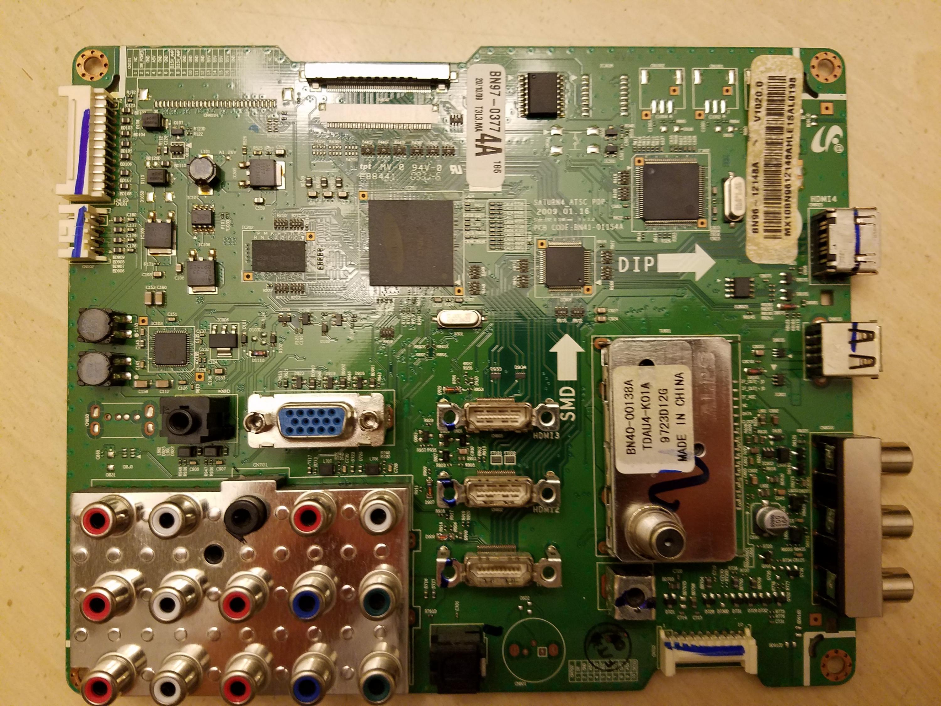

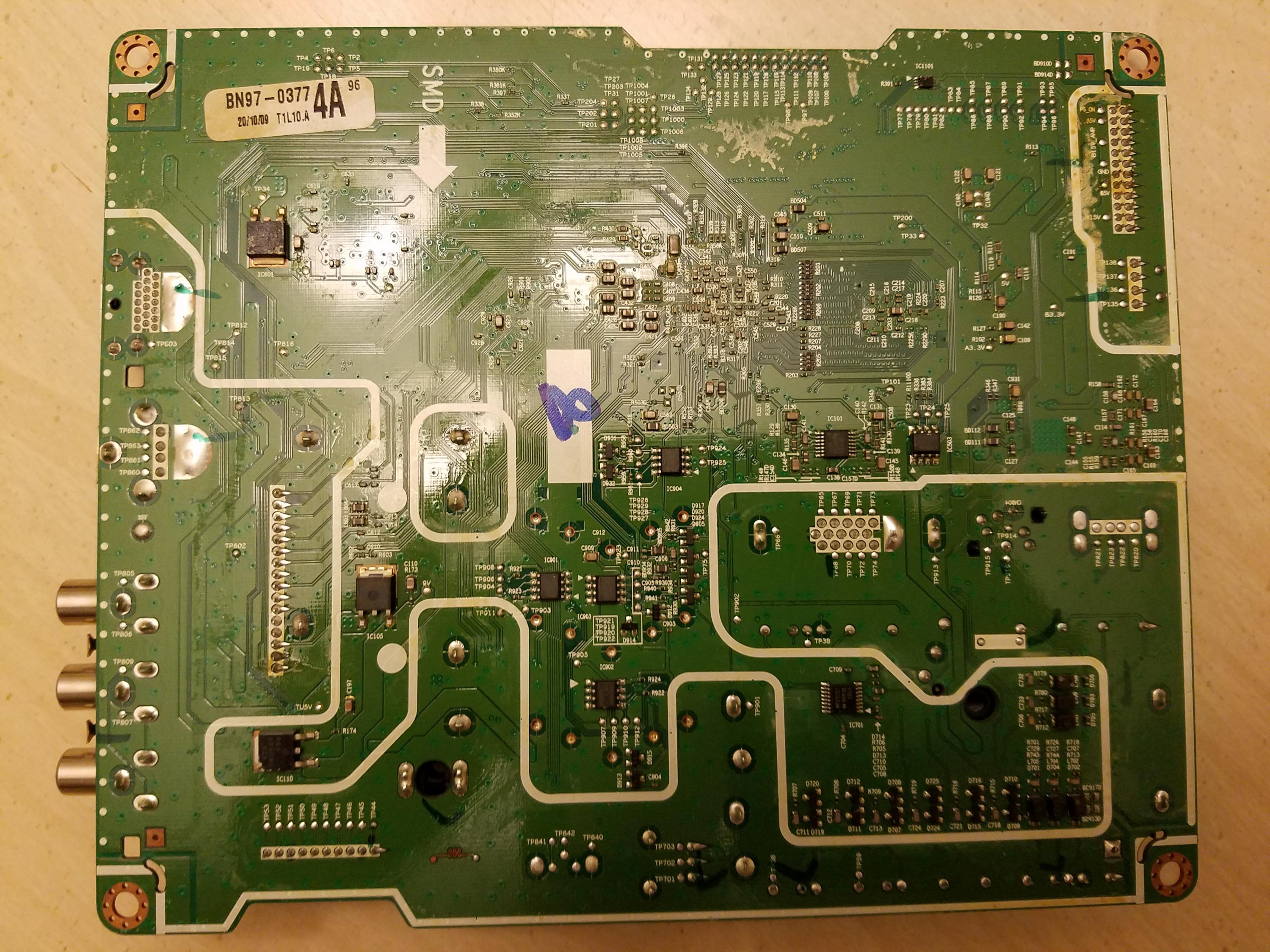

                    Trying to fix the same 63" model PN63B590T5FXZA with similar symptoms
                    Any idea what could be wrong with the main board?
                    I'm aware of the common failure of tantalum caps on other Samsung TVs from that era (around 2009) but this Mainboard does not seem to have any tantalum caps on in.
                    Pics attached
                    Main P/N BN96-12148A
                    Any ideas appreciated

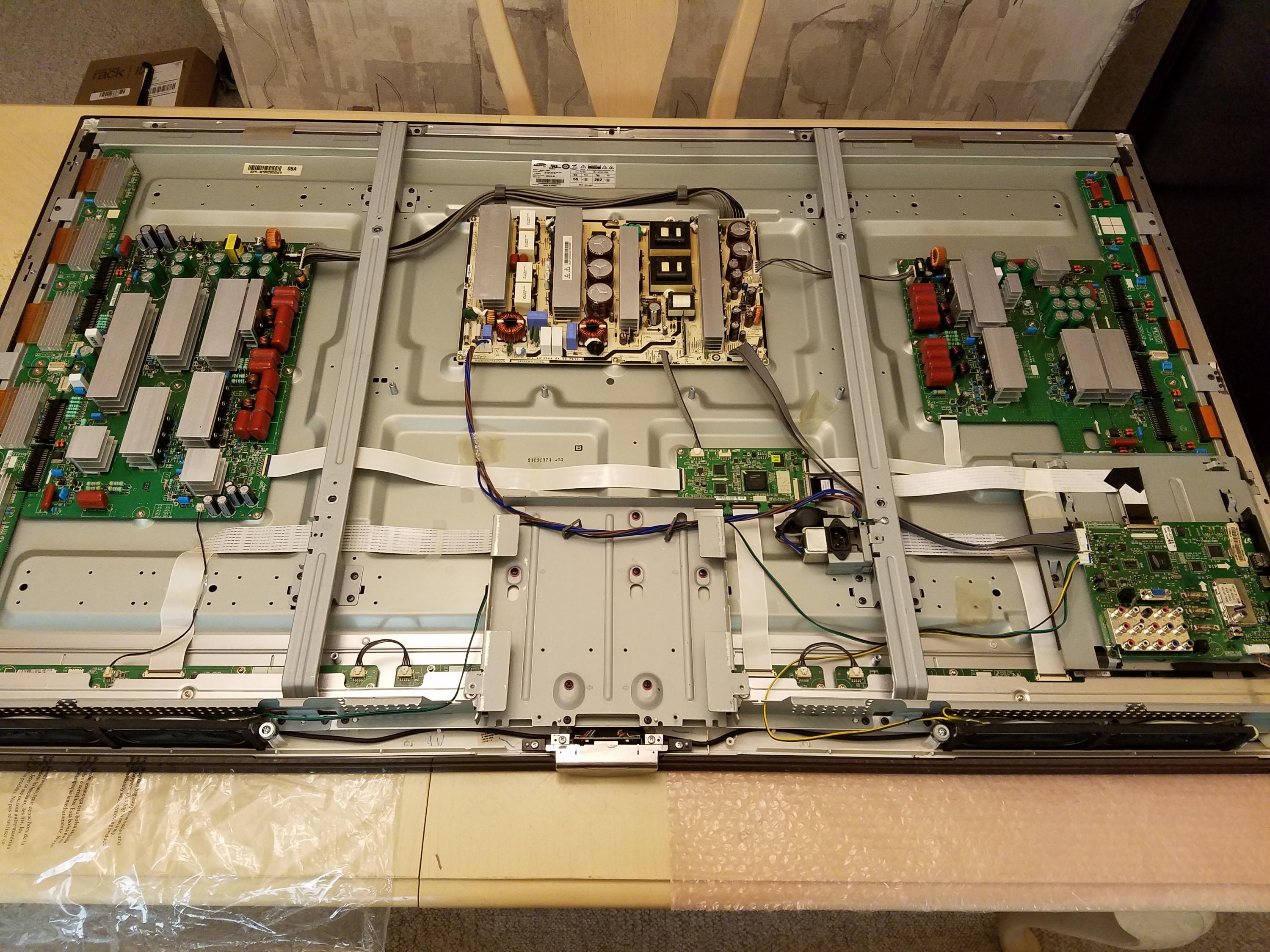

                          Normally you can bypass the main if faulty and make the set show test patterns. Now if power supply faulty the bypass won't work. However it should be fairly straight forward to figure this out by disconnecting and isolating which is at fault.
                          You should be able to disconnect y and x mains and use resistor to force power supply on and get voltage readings. Even try with main connected to see if you're getting proper voltages from power supply. If power supply is working then connect 1 board at a time till it stops working. That should reveal which board is at fault. If the main is at fault then the bypass test pattern will work if done properly, unless in rare cases you have multi board failures which is very possible with lighting surges.

                            It would be very helpful to take clear straight shot pics of entire back of set and your control board so we can better assist you.

                              OK I did another test now:
                              I shorted the 3-4 pins on the control board with jumper.
                              Instead of powering on with remote I just shorted the PS-ON to Ground
                              No test patterns appeared on the screen.
                              Attached pics

                                  Lets try this test again short pins 3 and 4 on ctrl board. The ribbon cable from main to ctrl board must be disconnected or it won't work.
                                  leave power supply harness connected to main connected see if it turns on NO? Then try forcing power supply on if you do this route the main has to completely disconnected from anything if you use resistor to force ps on.
                                      I disconnected it from the Main board side and not from the Control board side. Does it make any difference?
                                      • heavymachines
                                        • Mar 2011
                                        • 1028
                                        Re: samsung plasmas & lightning
                                        just needs to be disconnected should work.
