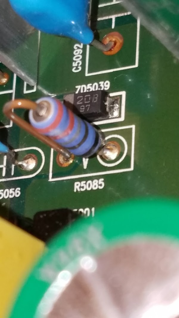

                  #48
                  Re: samsung plasmas & lightning
                  Found suspected zener diode on the board but it is in a parallel with this resistor.
                  Can't figure out what should be the Ohm value.
                  • heavymachines
                    • Mar 2011
                    • 1028
                    #49
                    Resister most likely fine.

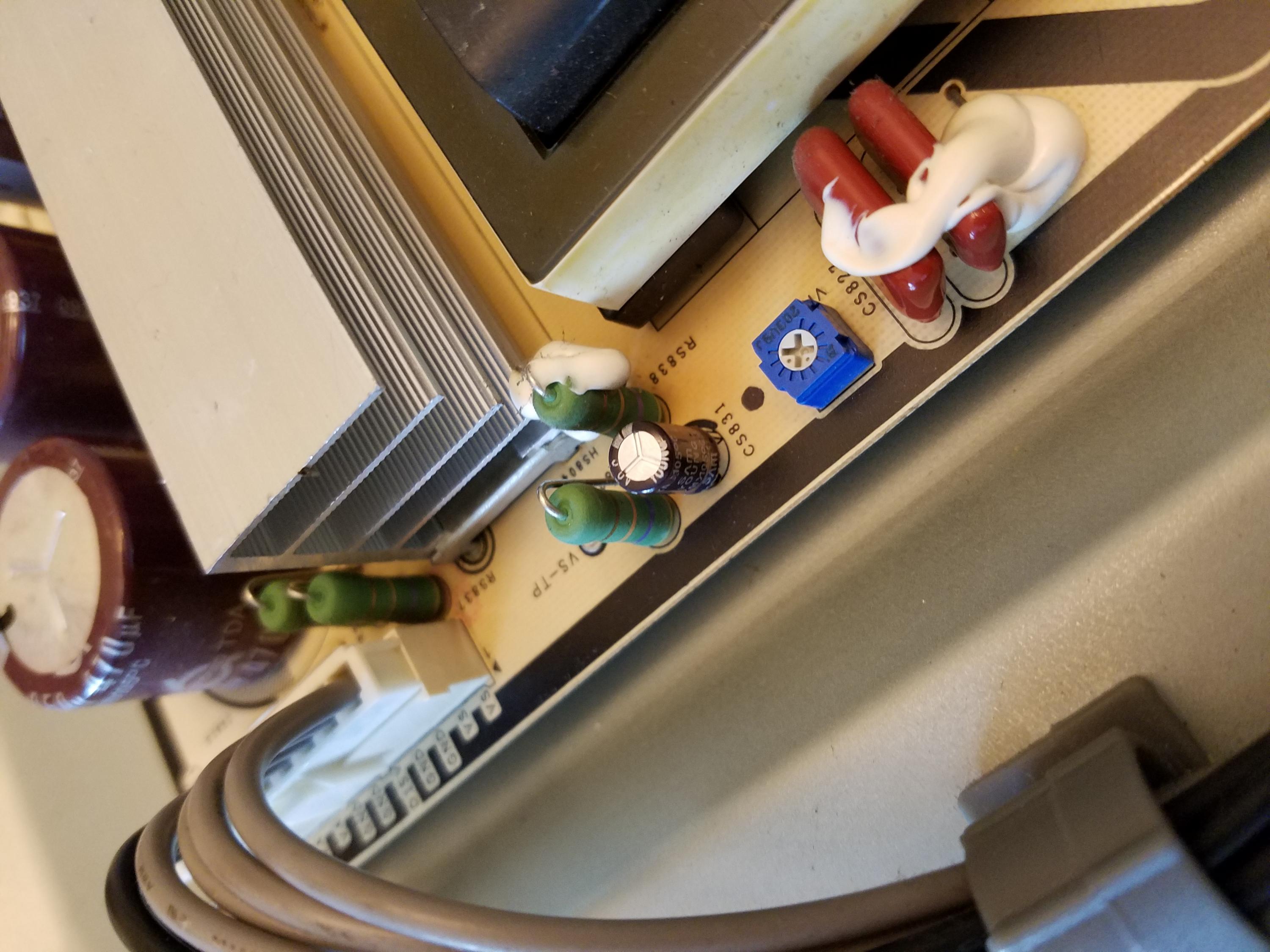

                            I got the TV working. Kind of.
                            In order to start the power supply I have to load it additionally with two 40w bulbs. After the TV is on I can disconnect the additional load and it continues to work fine. All panel voltages are OK.
                            So it seems that the power supply is faulty, probably feedback/protection path is not working correctly (at least in the very beginning). This power supply is quite complex though, it has TI MSP430 microprocessor doing something...
                            • zape
                              • Jul 2017
                              • 176
                              #54
                              Finally fixed the power supply.
                              It was bad capacitor CS831 (47u 50v)
                              The cap looks good (see photo) but I figured out it was bad by soldering a new cap in a parallel.
                              There are four of these on the board close to the heatsinks so I will replace them all.
