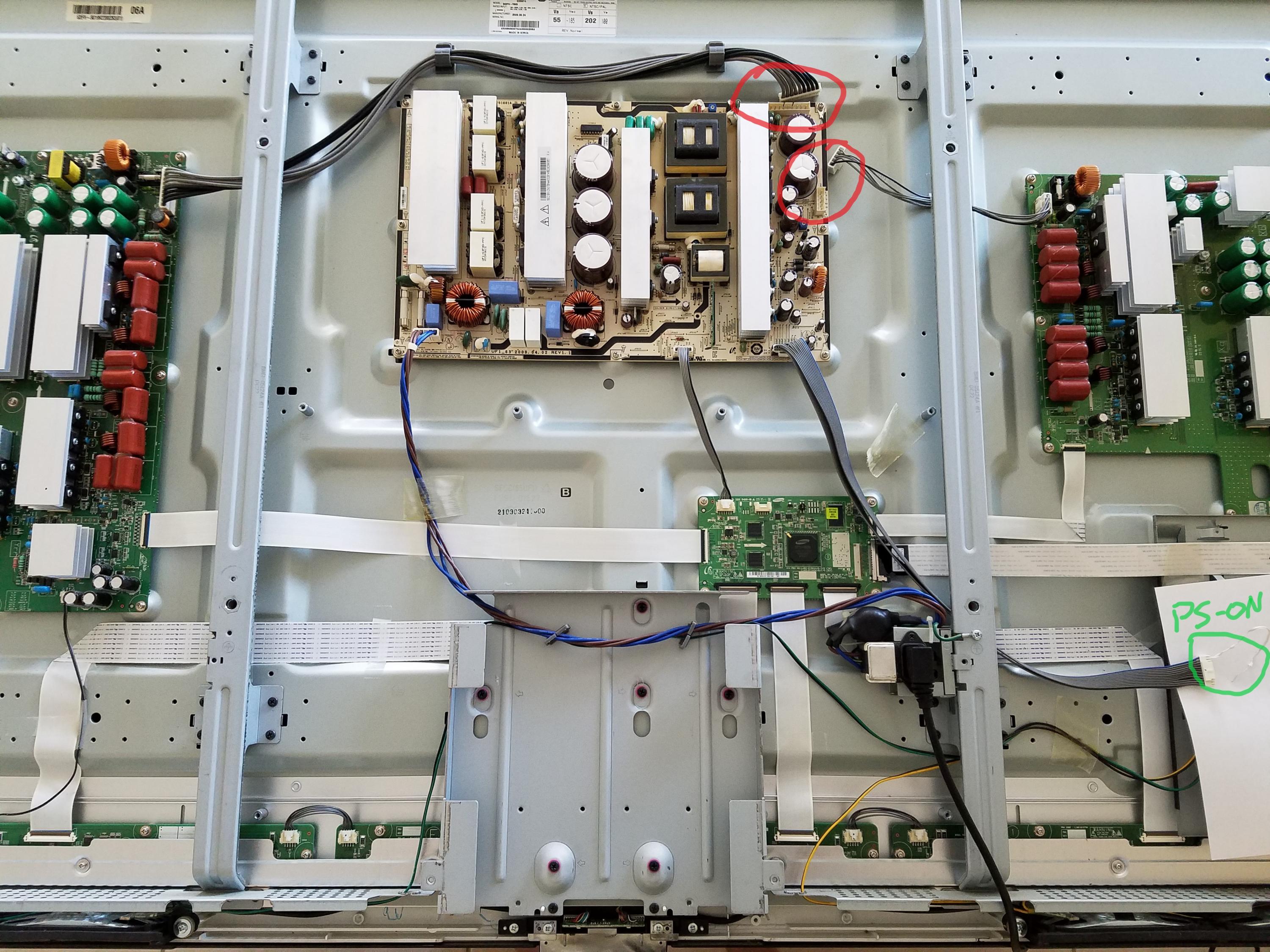

        I disconnected the two boards as shown on the photo (highlighted in red).
        No change. The PSU turns on and immediately shuts off.
          Re: samsung plasmas & lightning
          Congrats you narrowed down to fault. If ps still shuts down even forcibly and still no VS or VA voltages or just briefly.

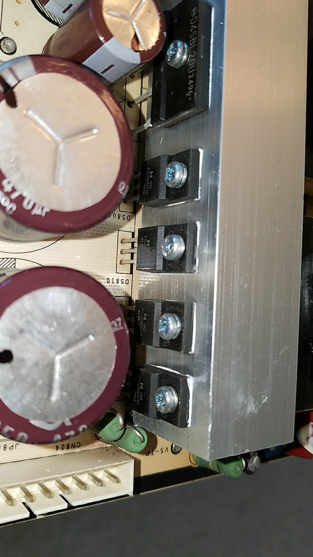

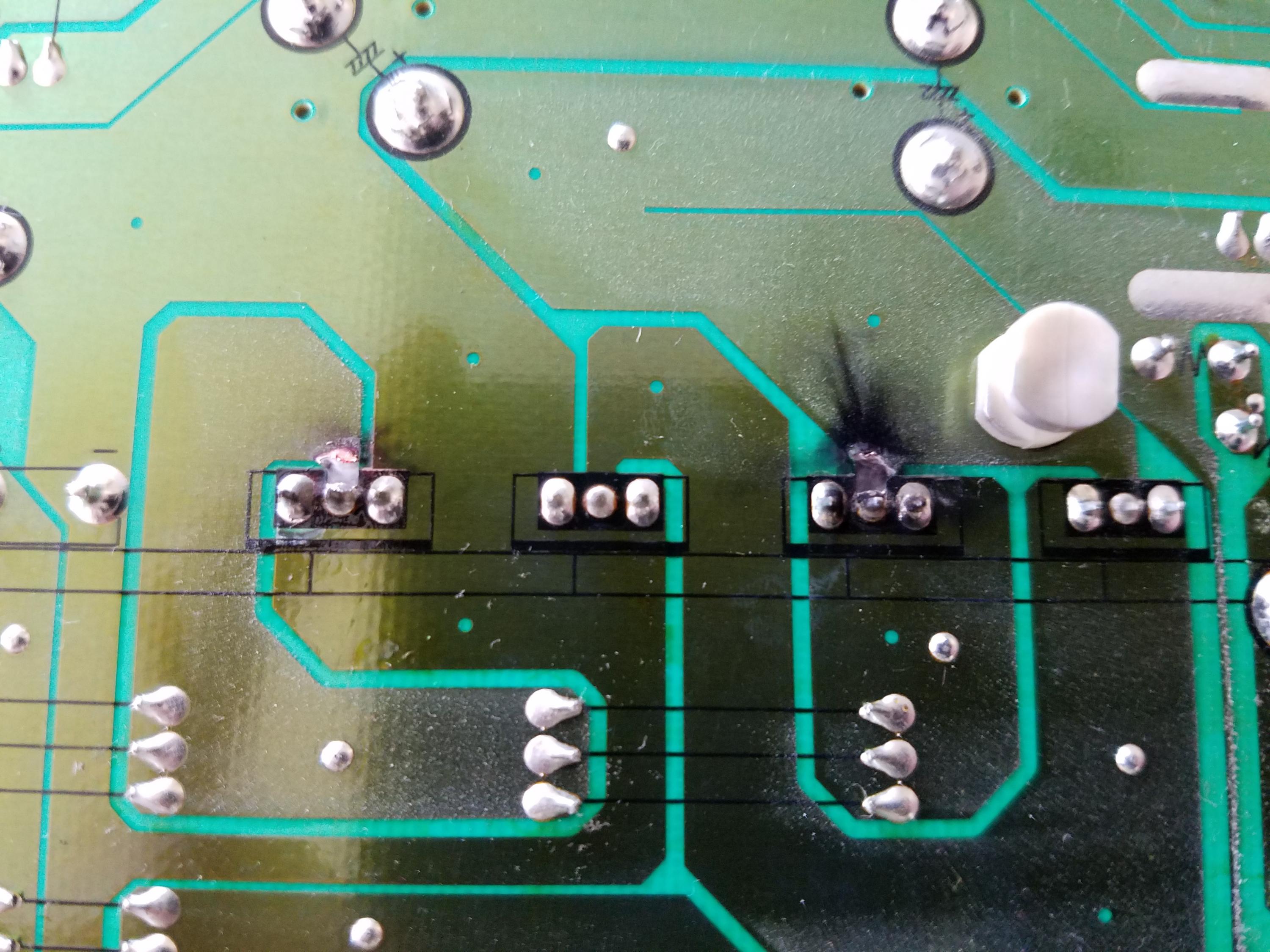

                                  Traces to diodes blown on the Vs rail. Diodes are shorted. See photos
                                  PS fuses are OK.
                                  I believe regulators on the mainboard are ok too because it still turns on and off fine like it did before.
                                  I did not check the voltage though.
                                  SO I guess the diodes was bad from the beginning but overload protection turned the PS off.
                                  After I forced the VS_ON the traces just blown.
                                    #37
                                    What the numbers off those , you test diodes with probes one way than the other way. but i bet they're certainly blown, it is possible you just found its weakness after turning it on and not overload the 3.3v line. it is up to you if you want to fix this at component level or replace the ps outright.
                                      fcu10uc30
                                      3 out of 4 are shorted.
                                      Will try to source the replacement and restore the traces.
                                        Originally posted by zape View Post
                                        fcu10uc30
                                        I would remove them and see if you're reading shorts on those pads, quite possible it took other things out further down line. but make sure you record which ones went where, i'm assuming they're all the same part numbers.
                                          #40
                                          They are simply a bridge rectifier made of pairs connected in a parallel.
                                          Two big caps are connected down the line to the Y-Main connector.
                                          Caps look good and the connector was unplugged. I also checked Y-Main board connector for short and it looks good.
