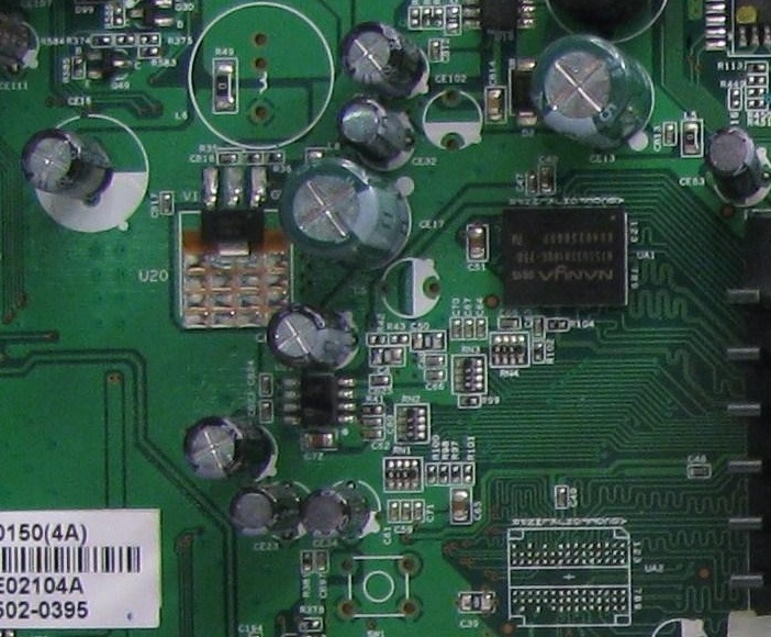

    I'm working on a VO32L HDTV10A
    Tested all the the voltage regulators (1117s) and u20 is bad, there is less then 1.25v difference between V Out and ADJ.
    So I replaced it but I foolishly knocked off tiny SMD resistor R35 (the resistor between ADJ and V Out). I used too much hot air.
    I also knocked off CB18 (cap on V IN)
    Is there any way to determine the resistance of R35?
    All the other 1117s have 1.8k Ohm resistor between ADJ and V Out, and 1.1k between ADJ and GND.
    By comparision, the resistor R36, which is fortunately still intact, and is between ADJ and GND measure about 500 Ohms, just under half of the others.
    So would it be very wrong of me to assume R36 is around half of 1.8k Ohms?

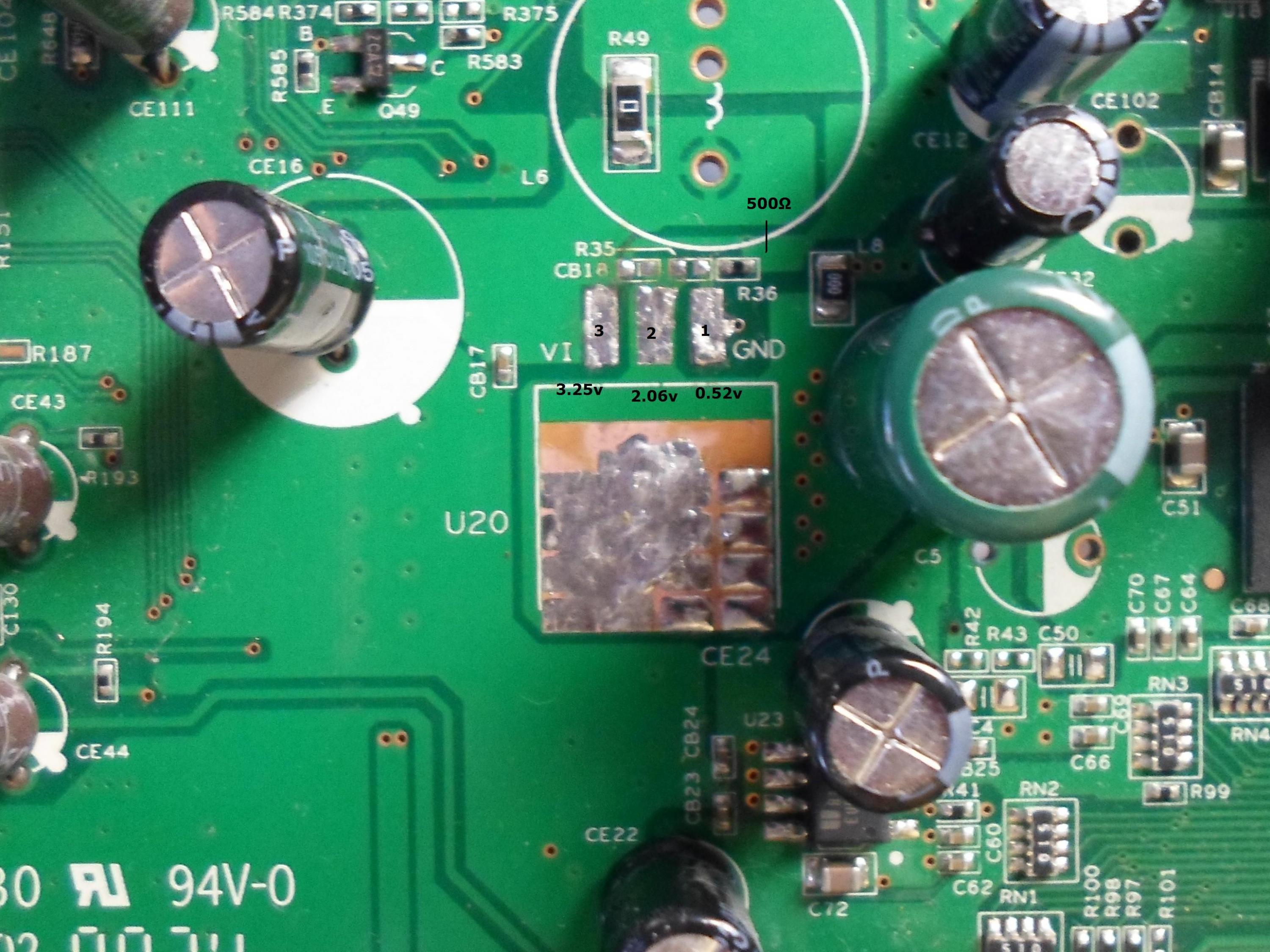

        Hi budm,
        I'm posting a photo so you and anyone else who'd like to help guess the value of the resistor can take a stab at it.
        I've edited the photo to include the voltages of u20 that I took before removing the 3-pin voltage regulator and losing the resistor (r35) and cap (cb18).
        I'll also write them here:
        1 - 0.52v (GND is what the pin is labeled, but this is ADJ, right?)
        2 - 2.06v (Output)
        3 - 3.25v (Input)
        And R36 is 500Ohms
        Does this help narrow it down?

          The confusing thing is that, the PCB show pin 1 as 'GND' which is typical for fixed LDO Regulator IC. But the board does have two reisistors for setting the output voltage, also you were reding 2.06V at the output but you have indicated that the reading was less than 1.25v, how much exactly? it should be within 3% of 1.25V RATING.
          What is the exact numbers as printed on the body of the U20?
          Can you check the resistance between pin 1 and Ground plain?
            I'm sure we're dealing with an adjustable volt regulator here. The are no dashes after the number. It's K218 and below that it reads G1117.
            I agree that it's strange they labeled the board wrong, but all the VRs I've tested so far have been adjustable, and are labeled the same way (GND label on pin 1)
            Yes, but resistance is out of range (infinity).
            I made a mistake in my opening post, I wrote that it was bad because there was less than 1.25 difference between ADJ and VOUT. I'm sorry for the confusion what I meant is there was more than 1.25 difference between ADJ and VOUT. The exact differential is 1.58v
            2.06 (Vout) - 0.52 (ADJ) = 1.58v
            If it were good it should be reading 1.77v right? (ADJ + 1.25)

                  Re: Vizio VO32L, another one with bad VRs? Need help figuring out the resistors too
                  There are two versions of the main board in this model number, U20 on this OP board is SOT223, the other version of main board uses TO-252.
                  If we know the output voltage of this U20 then we can choose the correct size resistors, the cap is morelikely to be 0.1uF MLC CAP.

                          The value for R36 on my board measures 50 ohms (not 500) and R35 is 110 ohms.
                          If I did my math correctly then the output should be 1.81 volts.
                          Vout=1.25 x (1+R36/R35) or Vout=1.25 x (1+50/110).
                          It really isn't practical to measure the cap you mentioned but my guess is that it is just a decoupling capacitor with the value of .1 mf as previously mentioned.

                                Ok, I replaced the resistor with a 110 ohm, and placed a ceramic disk cap.
                                I replaced u20.
                                The output voltage I'm getting is 2.25v and the TV still does not power on all I get is an orange Vizio led. The power supply is new, from ShopJimmy, all the voltages check good, I'm getting 5.16 stby.
                                The service manual once fails to contain any useful information, I've found more useful info in old threads right here on Badcaps
                                It does seem odd that the output of u20 is slightly higher than what mu2 calculated. However, almost all the other VRs show 2.52v, except for u21 shows 1.25v.
                                So 2.25 is odd even when compared to the others, that doesn't necesarily mean its incorrect though.

                                        I just went back and re-read your posts. You said the other regulators used a 1.1k.
                                        If your other resistor is 500 ohms then 1.1k in the formula should give you 1.8 volts.
