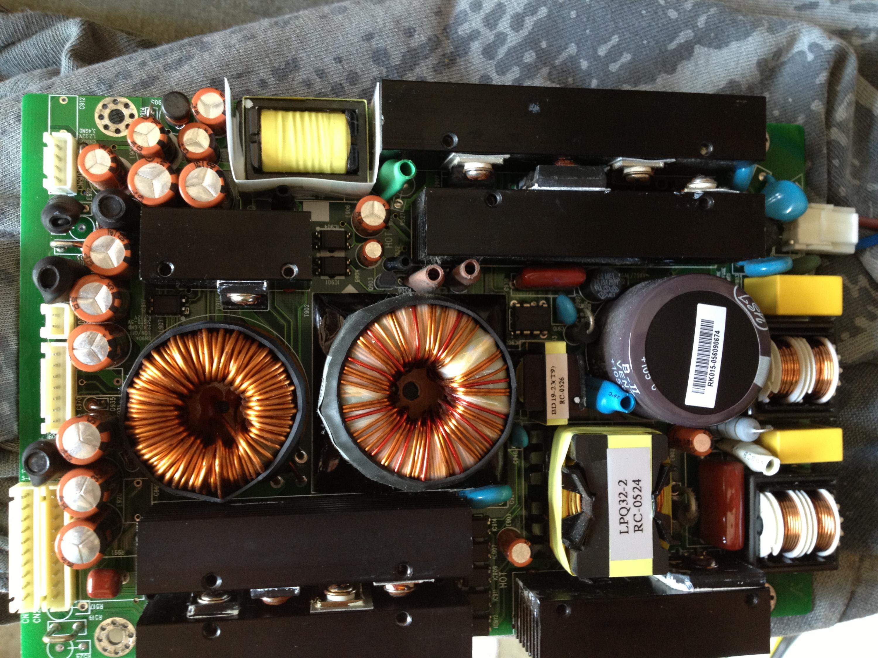

    Got a Polaroid TV with a PS issue here. Main fuse right by the AC input was blown. Figured something caused it but I gave it a shot. Blew instantly again as good as I put power back to it. Any advice on where to start?
    Repairing this for someone and the board is waaaaay to expensive. Cheapest I see is $75.

    It's probably not the main fault, but there are a few bad capacitors on the output too.
    Is this a KAS200 supply?

      Yes, I see the caps and realize they need replacing but was trying to figure out what's blowing the fuse first.
        Re: Polaroid FLM-3201 Power Supply Issue
        If I can get it to power up then I'll move on to the caps. Looks like at least 3 that need to be done.

          You can check the FETs and bridge for shorts.

            I'd replace all the caps on the output side, since they're most likely terrible low-voltage HEC caps; HECs fail sometimes without visible signs of failure. An ESR meter would come in handy. I'm not sure that will keep the fuse from blowing, though (doubt it).

              Yes sir. KAS200

                I'm probably going to have to mess with this after my vacation. Leaving tomorrow. I'm going to get in trouble with the wife if I don't help pack. My meter is showing shorts all over the place and I haven't done enough reading on the testing to jump into it.

                    I've got a -very- broken PSU like this that's had a lot of work done on it by someone else, I can compare some measurements if necessary but I have also provided a schematic so it's just a matter of isolating the fault.

                        On the FETs Tom. I believe these are just Q905, Q906, and Q907? One is a heck of a lot bigger. Can't read numbers on them without removing.

                          Part #s in schematic, use those if you have problems reading the numbers.

                            My meter shows short between all 3 legs on Q905. Looks like I have to pull D902 also to remove the heat sink that it's on.

                              I'm pretty sure that one is bad. 600v 20a. I'm also pretty sure I have one in another supply that I could steal. An ST micro w20nm60.

                                Pulled that one. Definitely shorted. I'll order and have it here when I get home next week. Spec not quite the same on the one in the other board.

                                  Q905 was the culprit. TV is up and running and you're a life saver as always Tom. I'm learning here......slowly.
