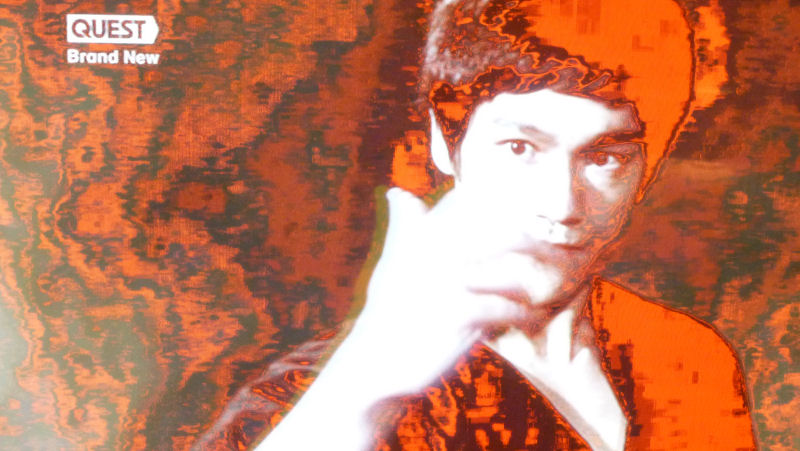

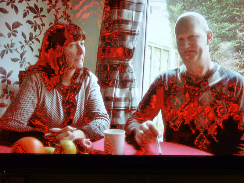

    my Panasonic TH-50PZ70B plasma seems to have developed a case of the sparklies. TV is fine when first switched on, problem seems to develop after roughly an hour and pretty quickly spreads over the whole screen. Can you give me any ideas what to check please? I'm a novice at this so go easy on the jargon - thanks.

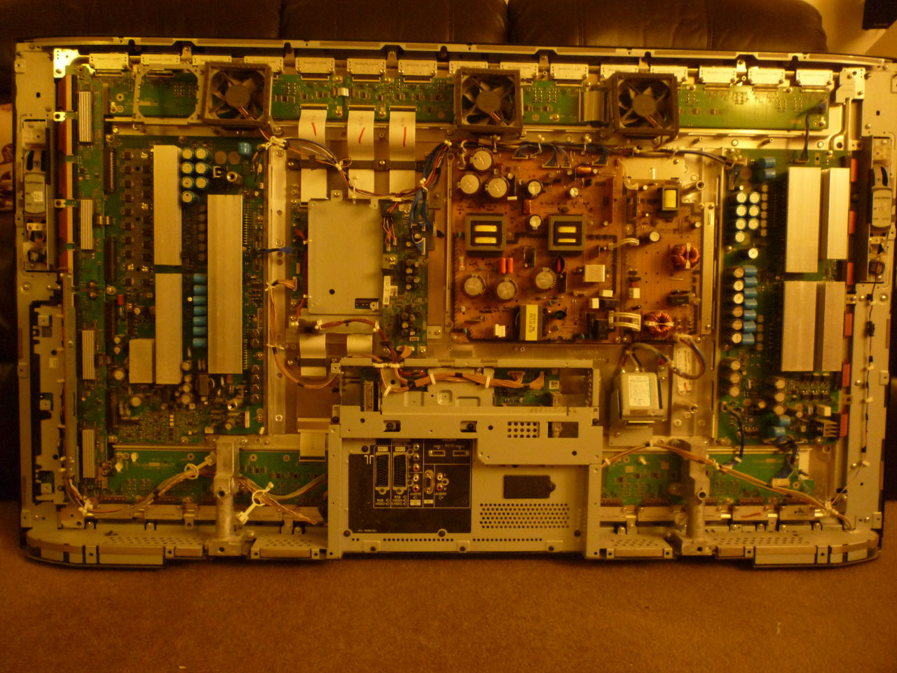

        OK, i've looked at the back of the set and basically, I don't know what I'm looking for! So I've attached a picture in the hope that someone can point out the A & D boards. Thanks.

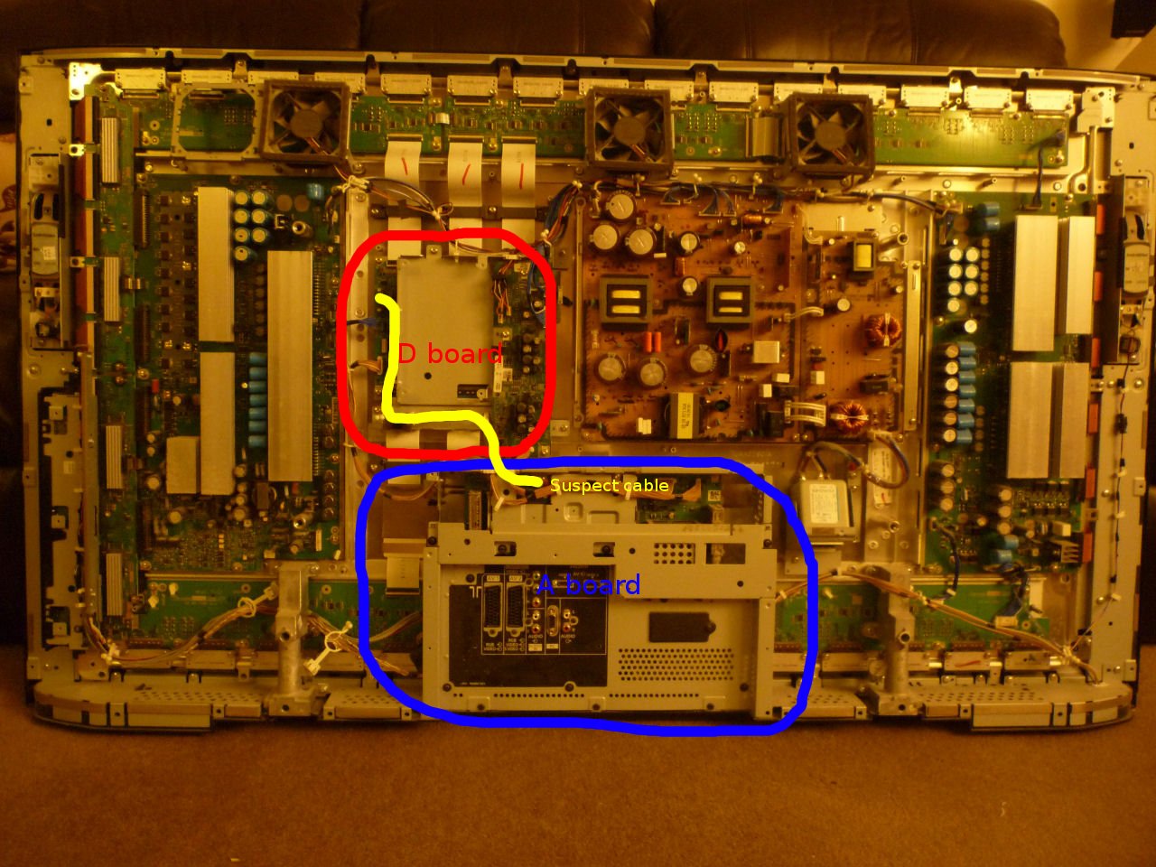

          See attached. Reseat the highlighted cable.

            Hey, you guys are really on the ball :-) really appreciate the fast response. Found the cable and re-seated as requested - I'll see how things go from here. Thank you.

              After re-seating the cable between the A & D boards and powering up, the sparklies returned big time straight away - no warm up period required (previously the display appeared ok for about an hour).
              What's the next step?

                This problem is usually caused by this cable. Try pressing on each connecting end while in operation (do not touch anything else), does the picture change?
                  Re: Panasonic TH-50PZ70B Sparklies
                  OK, I've re-seated one end of the cable (the D board end as it's the easiest to get to) and the display is currently working ok. I've left the TV on and I'll see whether the sparklies re-appear. Thanks for your reply Tom.
                    Just like to say thanks guys for your assistance in sorting the display problem out on my TV. I've had it running over a number of days and the sparklies have not re-manifested themselves. Thank you so much for helping me sort the problem.
