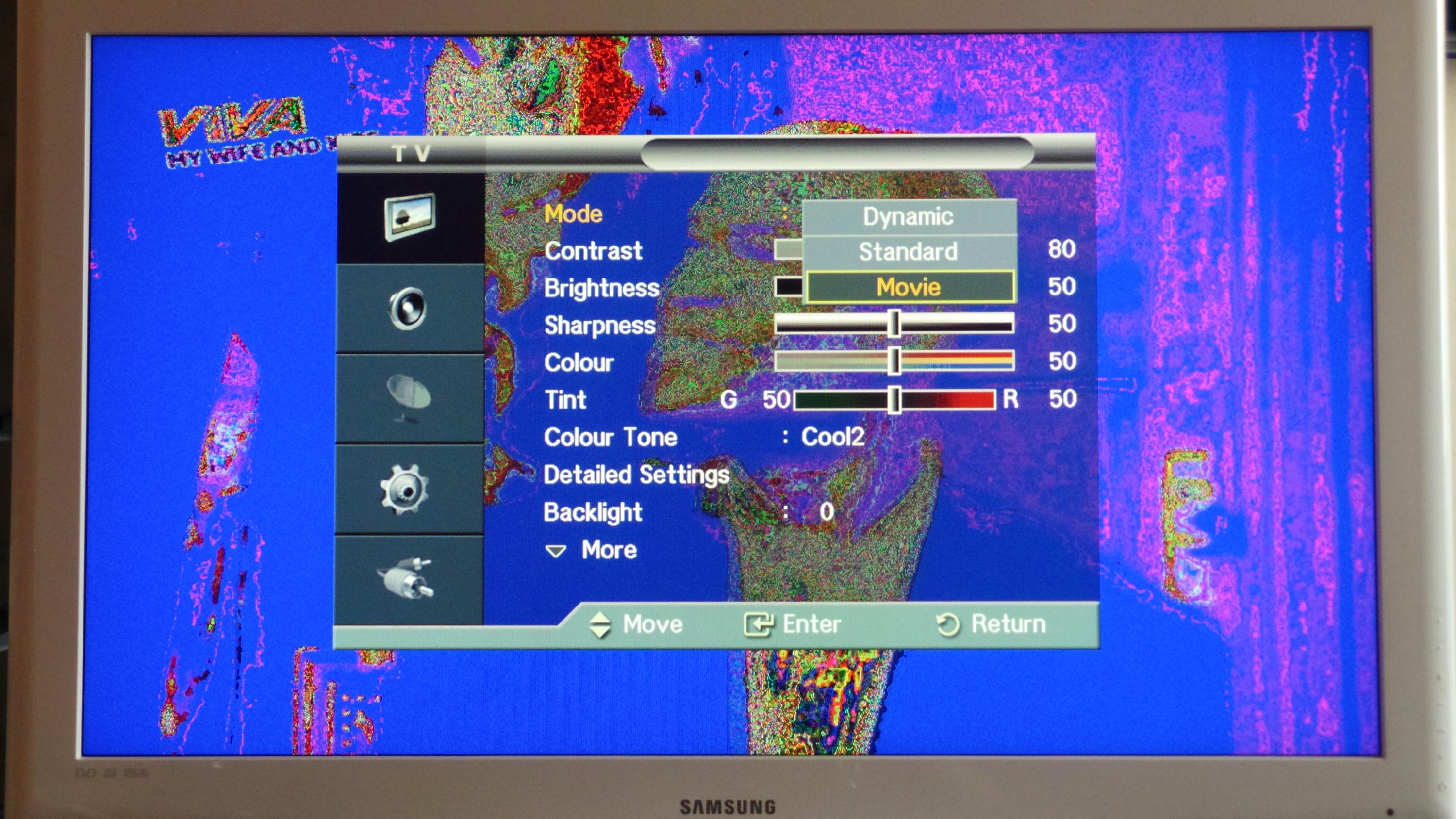

    Re: Problem with Samsung LE40R86WD
    Originally posted by tom66
    I've had this issue before. I think it's a design error, I have never figured it out. Does the Movie or Cinema mode (or any other picture mode) make the screen go green tinted too?
    standard mode seems to be only one working fine Tom, dynamic makes tv realy dull and Movie mode does whats in the picture.
      I'm not sure if this is fixable, other than leaving it in Standard. Mine had green on Movie, even after reset, yours appears blue. If you want, you can swap the main board, which should fix it, but it doesn't seem like a major issue.
