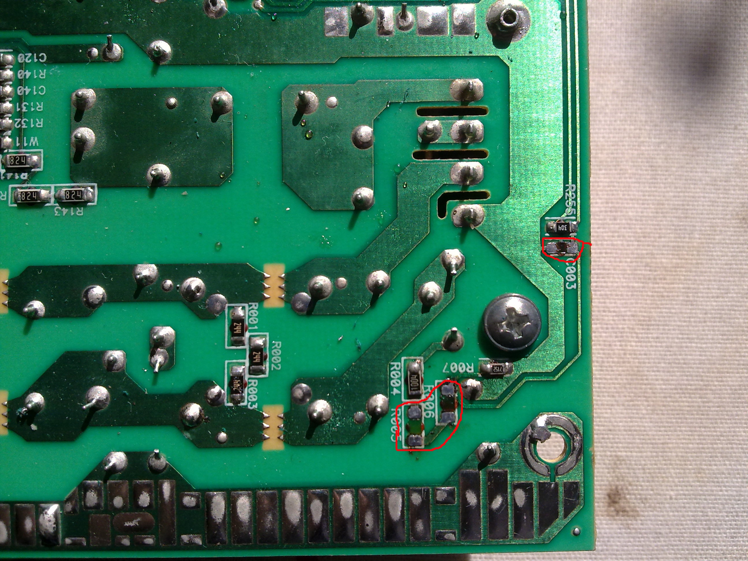

    Hi
    This is the second one in a couple of weeks I have had of this model and they suffer bad solder joints, not this ime someone has been playing and think its wise to solder across 2 x resistors and 1 x capacitor.
    The TV is dead and before I go rushing in I need to find out and fit the correct resistors and capacitor, with no service manual for the tv or schematics for the psu I am struggling.
    What would you do, how do I find the correct values with no info to go off nor no one selling the psu to ask
    The PSU is PWB1038
    I have attached a picture circling the missing components
    Thanks in advance
  • signup
    • May 2013
    • 189
    Re: Polaroid TLU-03723b SMD identification

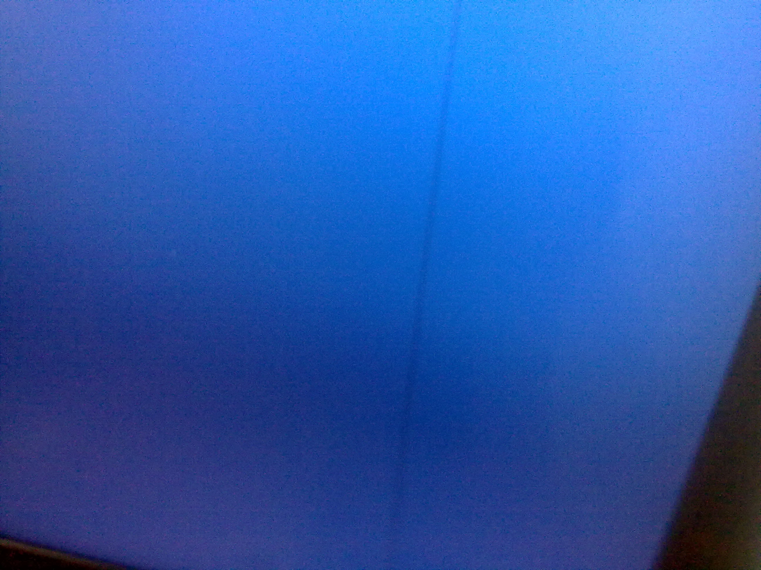

    Sorted..nothing wrong with a bit of guess work, put 2 1004's in and pulled a capacitor from another psu and it is now working...well I say fine, now the tv is working it has got a lovely green 1mm line down the left of the screen..grrr
      Is this screen or possible lvds/tcon
      The line is green under normal viewing
      Cheers
        LCD panel fault, though could be a trapped hair or other bit of dust -- hard to see?
        • signup
          • May 2013
          • 189
          Originally posted by tom66
          LCD panel fault
          Yep, changed the lvds, tcon, cleaned the flat cables and checked for tab bonding and it is still the same
          Dam thing
          Can I just add with this model if anyone is searching I have had a couple of these shutting down where cold joints are to blame namely around M200
          Also REMOVE the gunk they put around the fet legs....it is best to remove the fets and clean them as the gunk goes rock solid and is a pain to remove in situ
          why would they put that crap around the fet legs..beyond me
