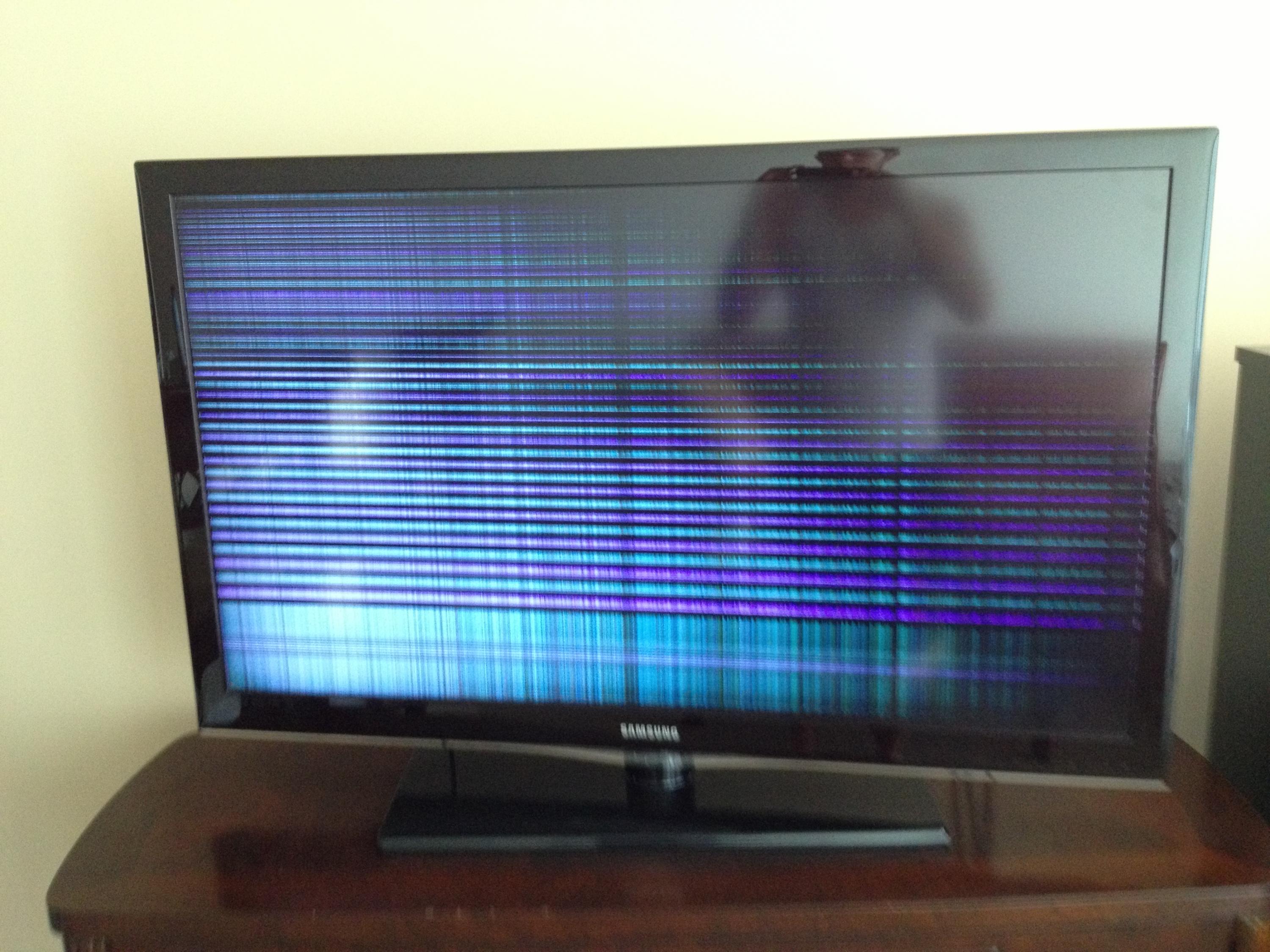

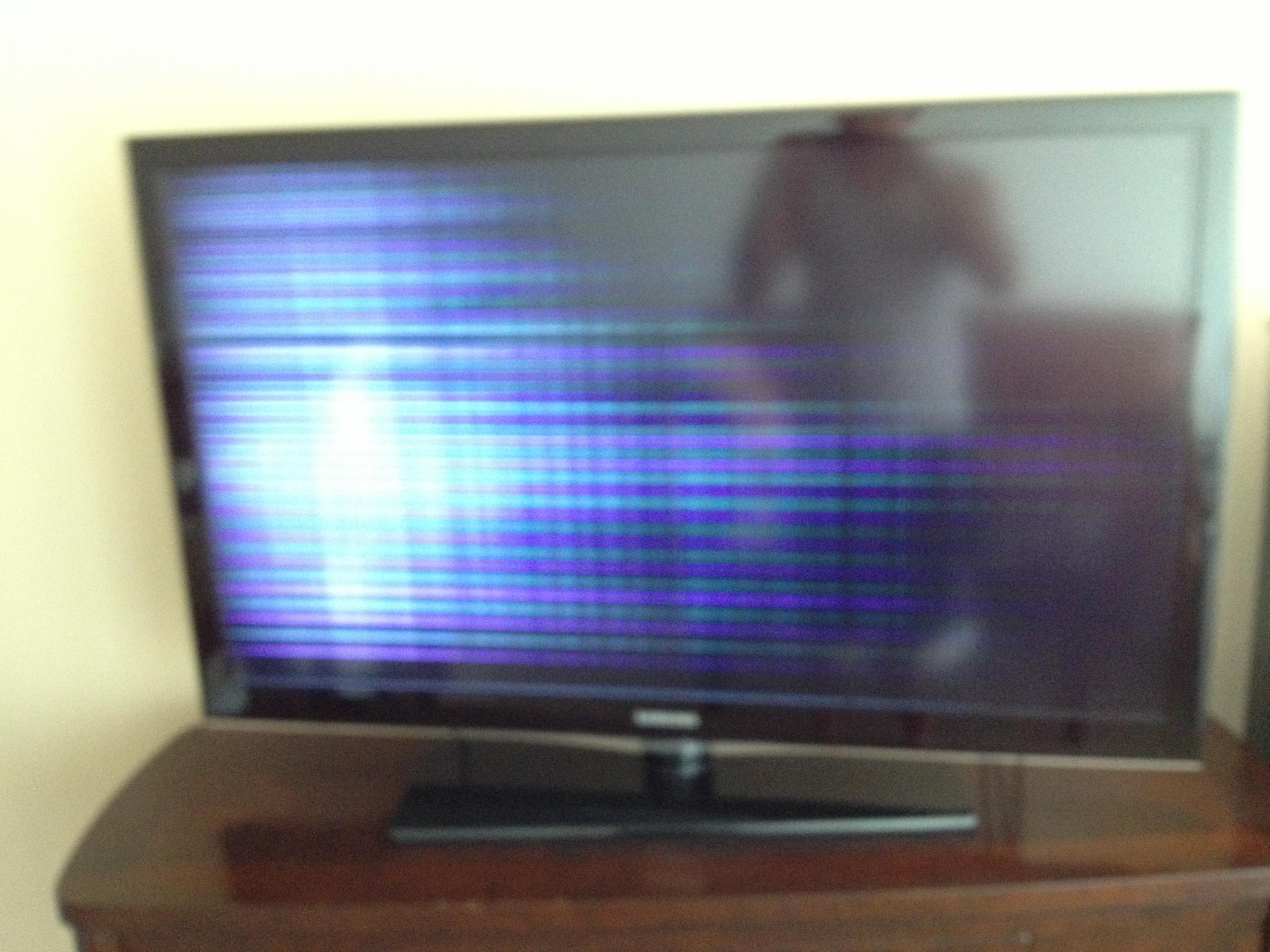

    Hey all...new to this forum and would appreciate any help. So I'm watching TV the other day and all of a sudden the screen goes black but the sound still works. I turn it off and on, unplug and plug back it, all the usuals and it still is doing the same thing. After a while, the screen start flickering "rays of light". It seems like it does it in a pretty consistent pattern every few seconds. It starts after the TV has been on for about 20-30 seconds. I've had the TV for about 2 years so it is out of warranty, but it was unplugged for about a year b/c I wasn't using it. I've attached two pictures of the "rays of light". Any help would be awesome!

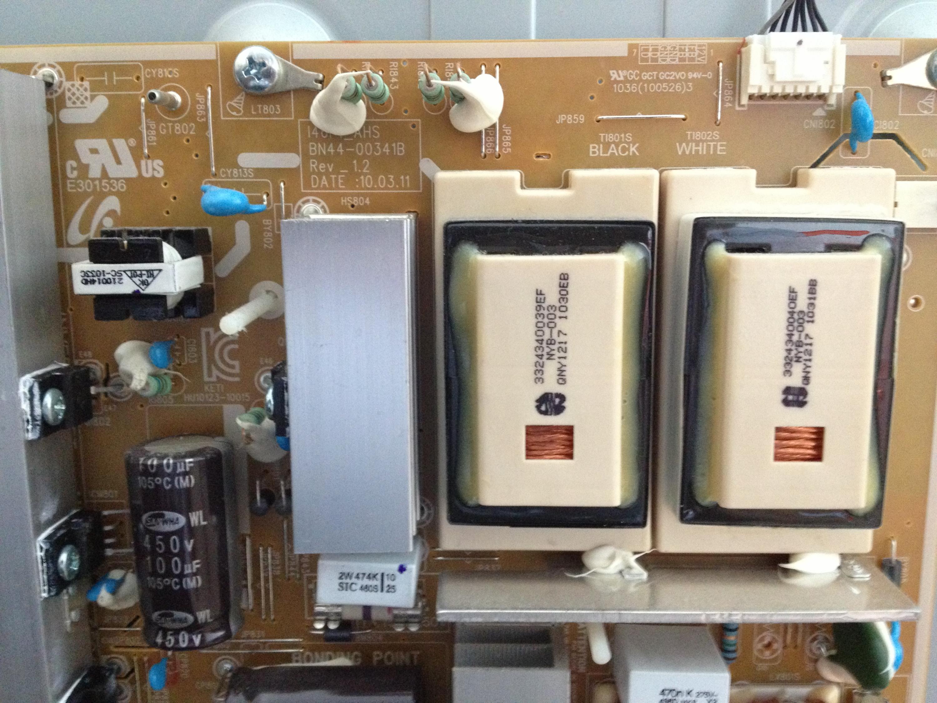

          • rba333
            • Jul 2013
            • 14
            • US

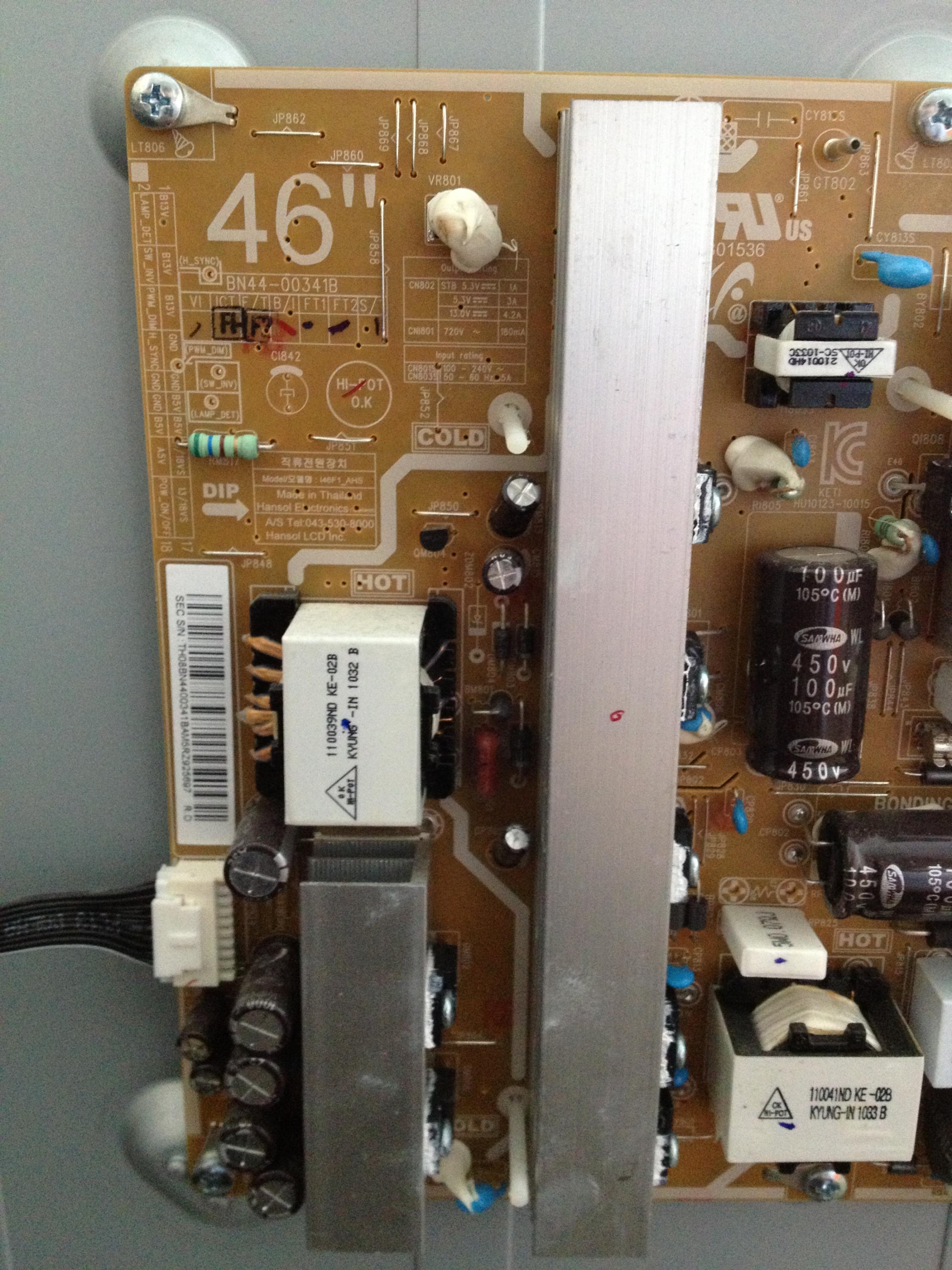

            Re: Samsung LN46C600 LCD TV - No Picture but Sound
            Pictures of the board uploaded. If anyone needs another angle/photo let me know.

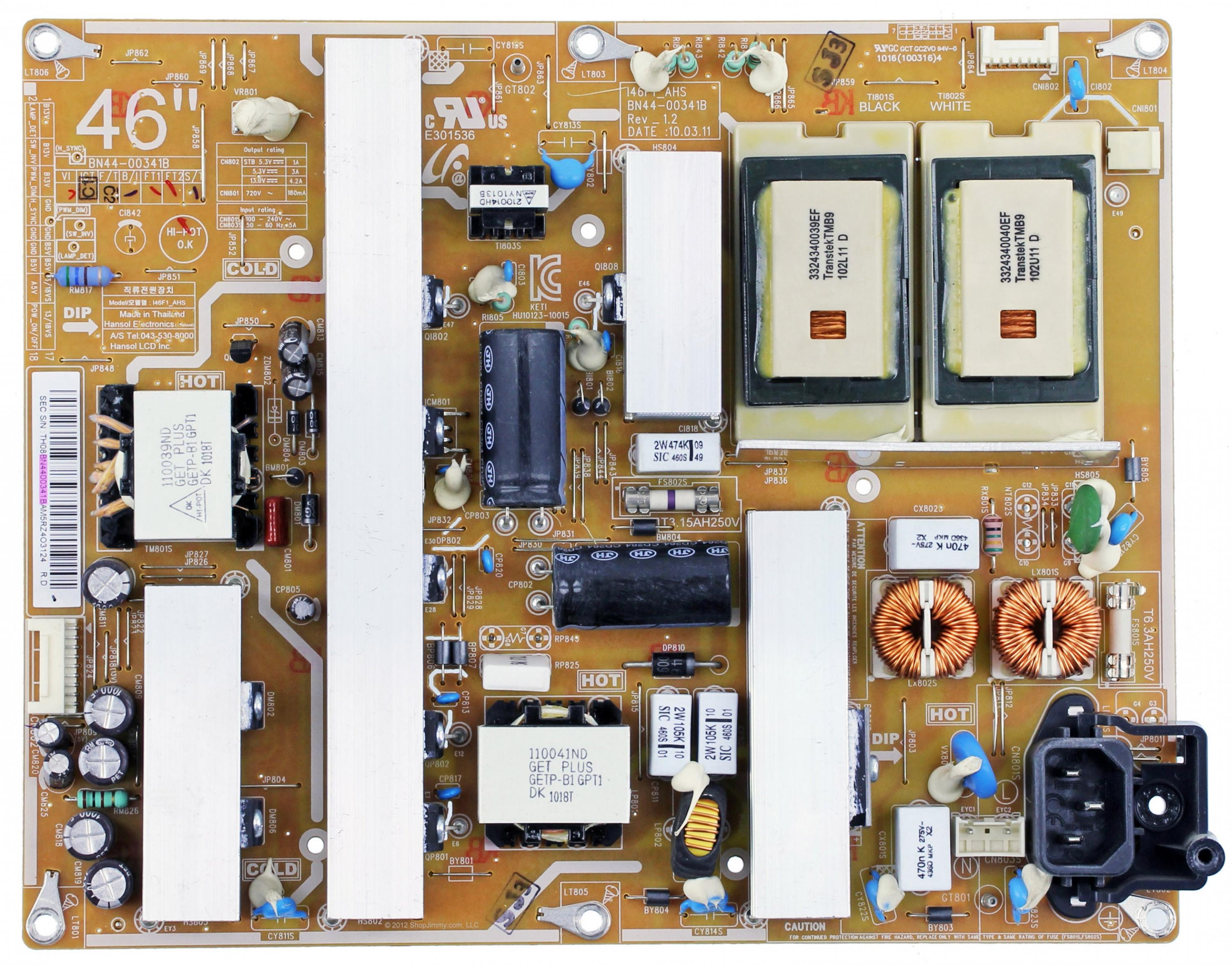

            • capkid
              • Oct 2010
              • 1339
              A pic of the whole chassis might be helpful. Here's the schematic for the power supply (PSU) if you need it:
              I'd start by checking PSU output voltages at the connectors to the main board and backlight inverter(s).

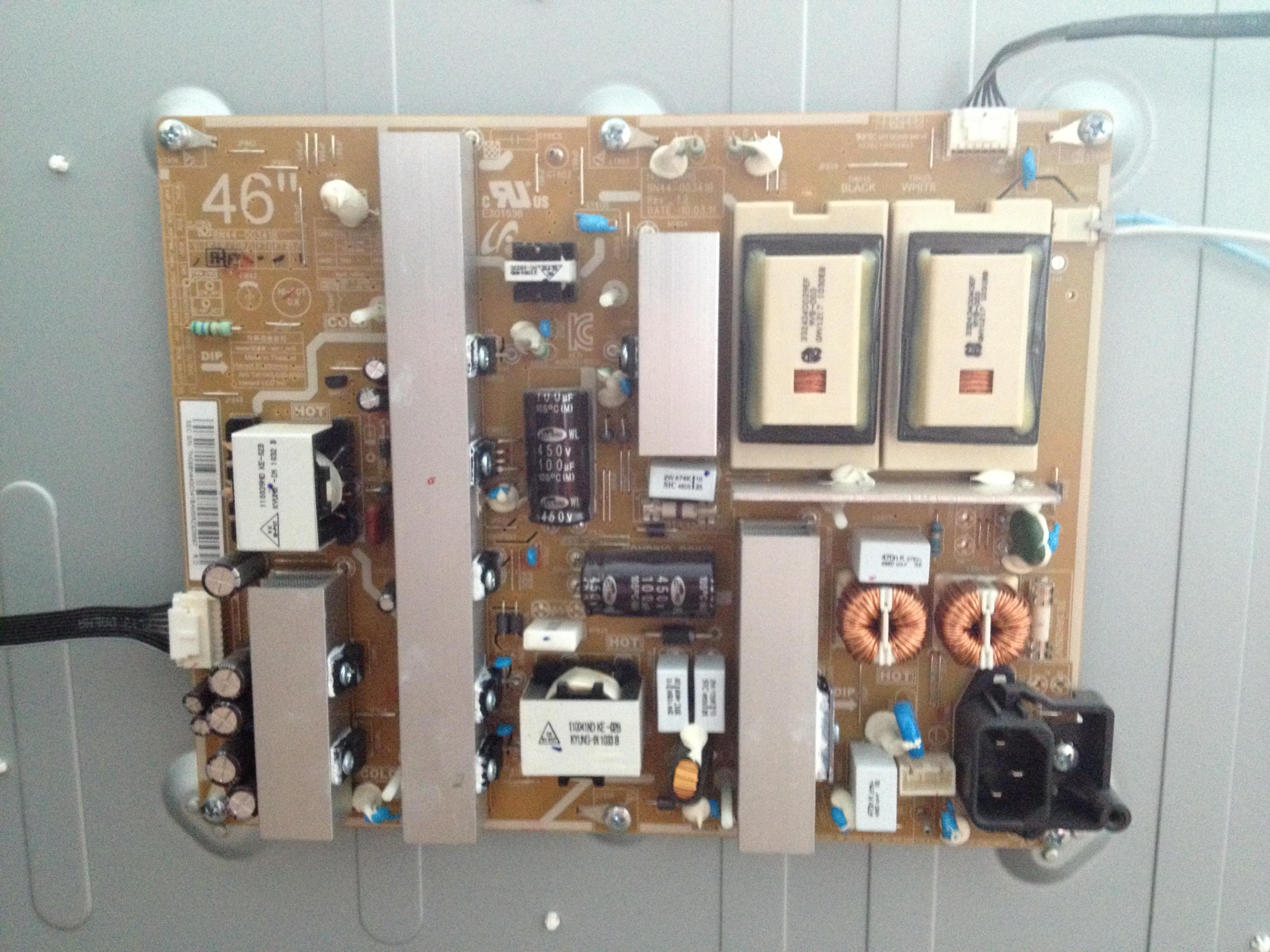

              • rba333
                • Jul 2013
                • 14
                • US

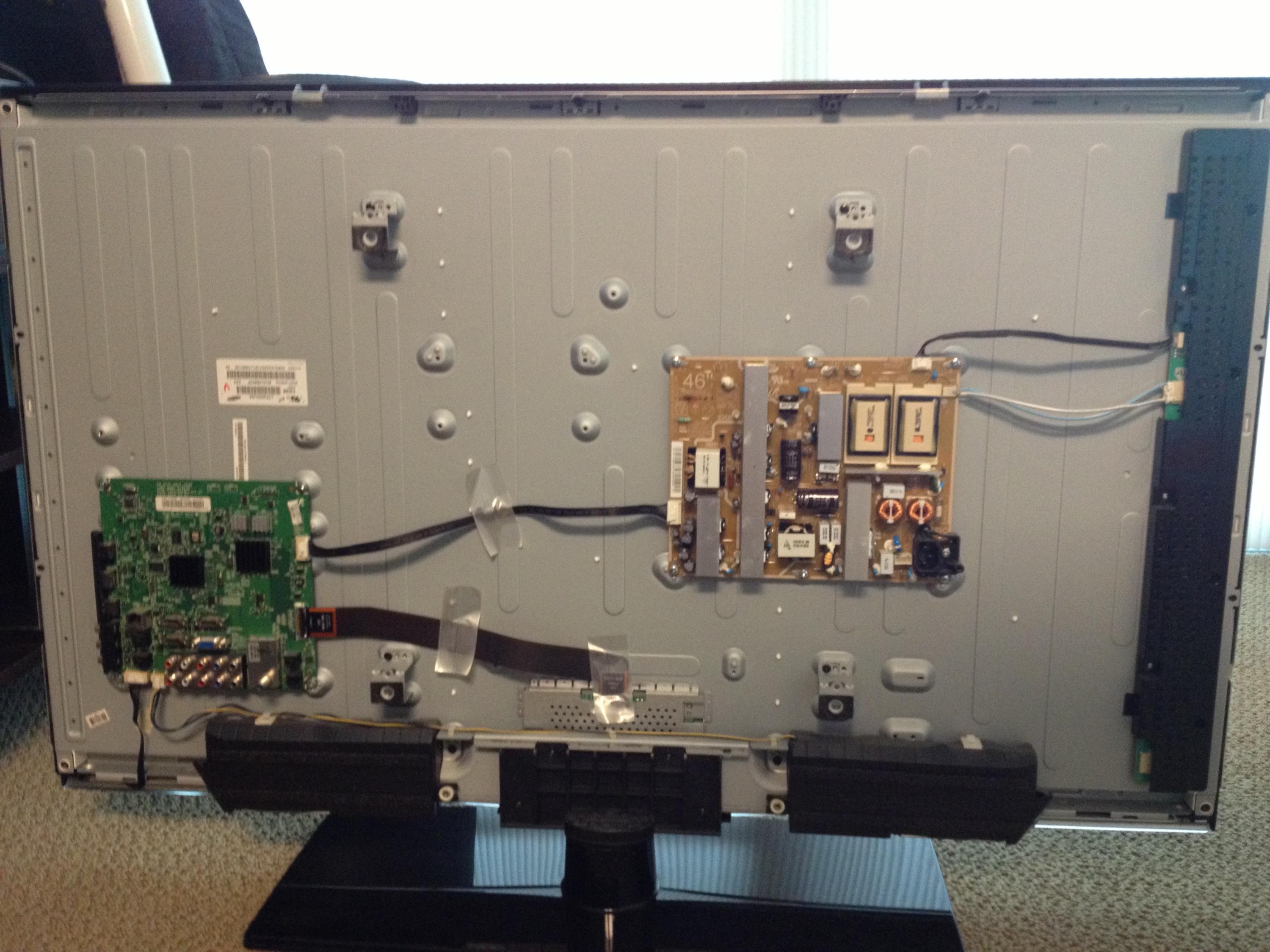

                Chassis attached
                I don't own a multimeter so this may be the end of what I can do unless someone has another idea?

                • capkid
                  • Oct 2010
                  • 1339
                  Originally posted by rba333
                  Chassis attached
                  I was referring to the whole back of the TV when I mentioned "chassis", but I'm fairly familiar with the layout. Others that wish to contribute may need a pic, though. A relatively inexpensive multimeter might suffice. Otherwise, you're left with a shotgun approach of replacing circuit boards.

                                • rba333
                                  • Jul 2013
                                  • 14
                                  • US

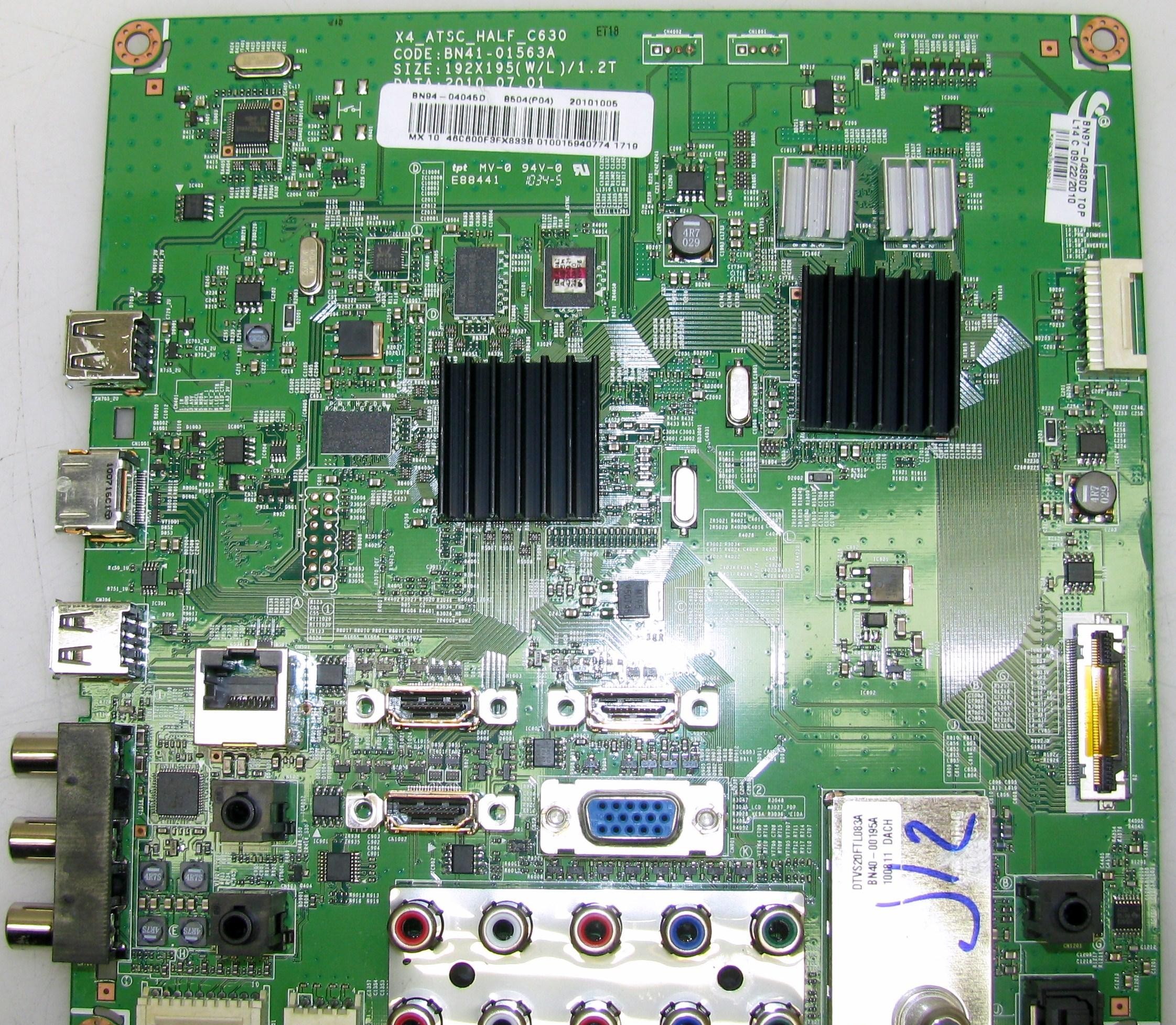

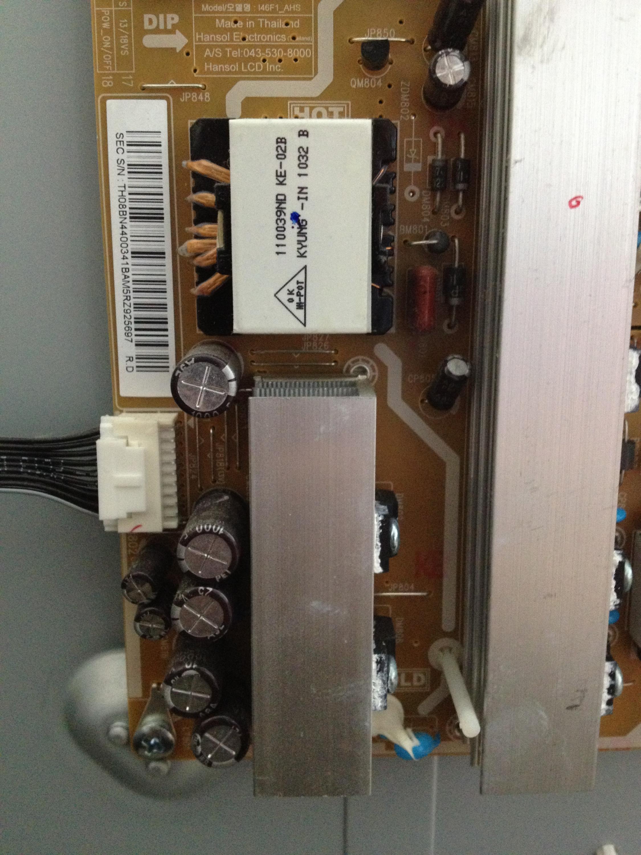

                                  Sorry for the hold up but I was able to get to the store and purchase a multimeter. Forgive me for my lack of knowledge but I have no idea where I should be looking for the connectors. I've attached a picture of the full chassis this time.

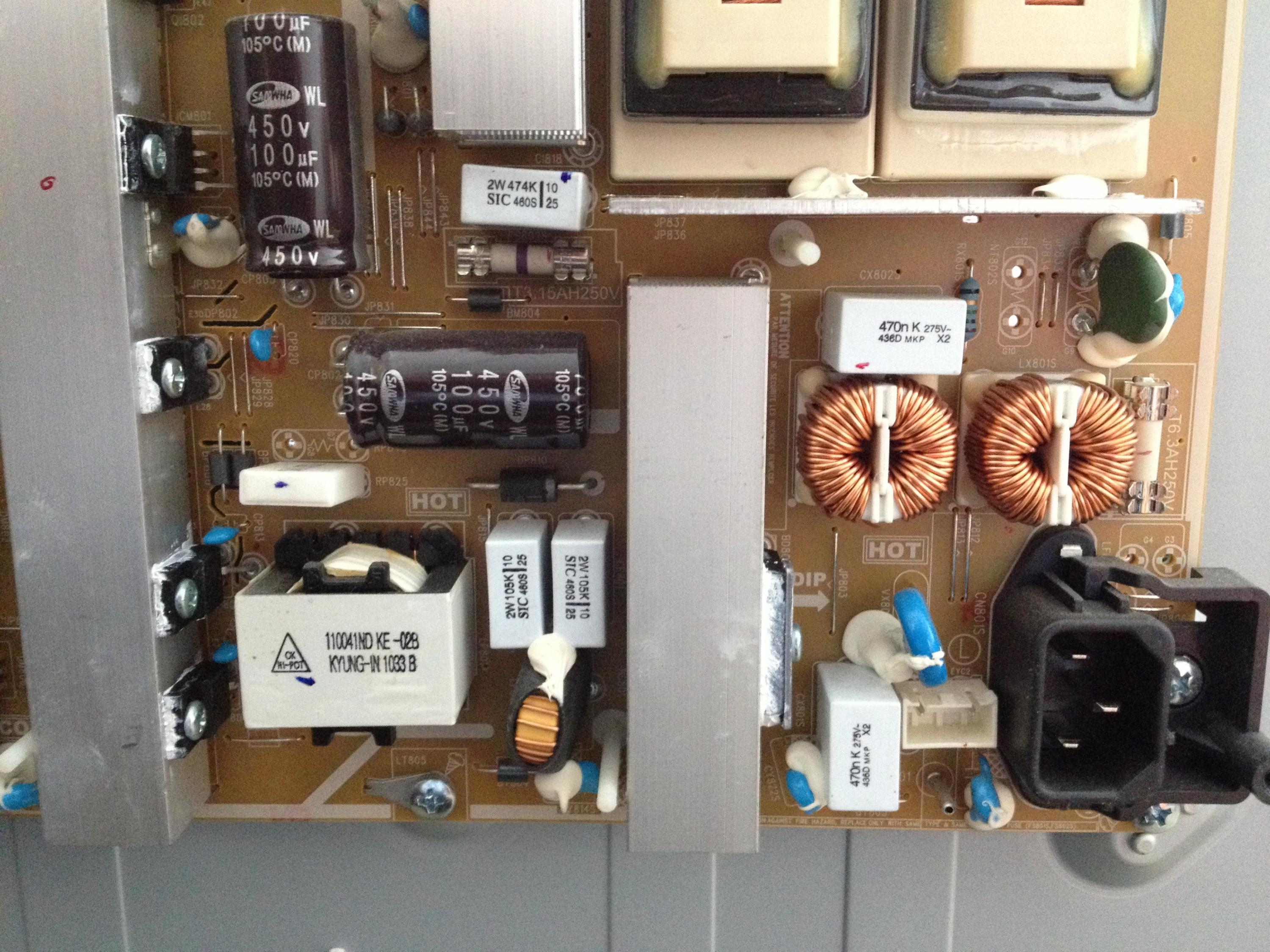

                                    We require a closer picture of the connector between the power board and main board. Also, a picture of your multimeter could be helpful, if you are new to using one.
                                    • capkid
                                      • Oct 2010
                                      • 1339
                                      Here are some pics of the boards.
