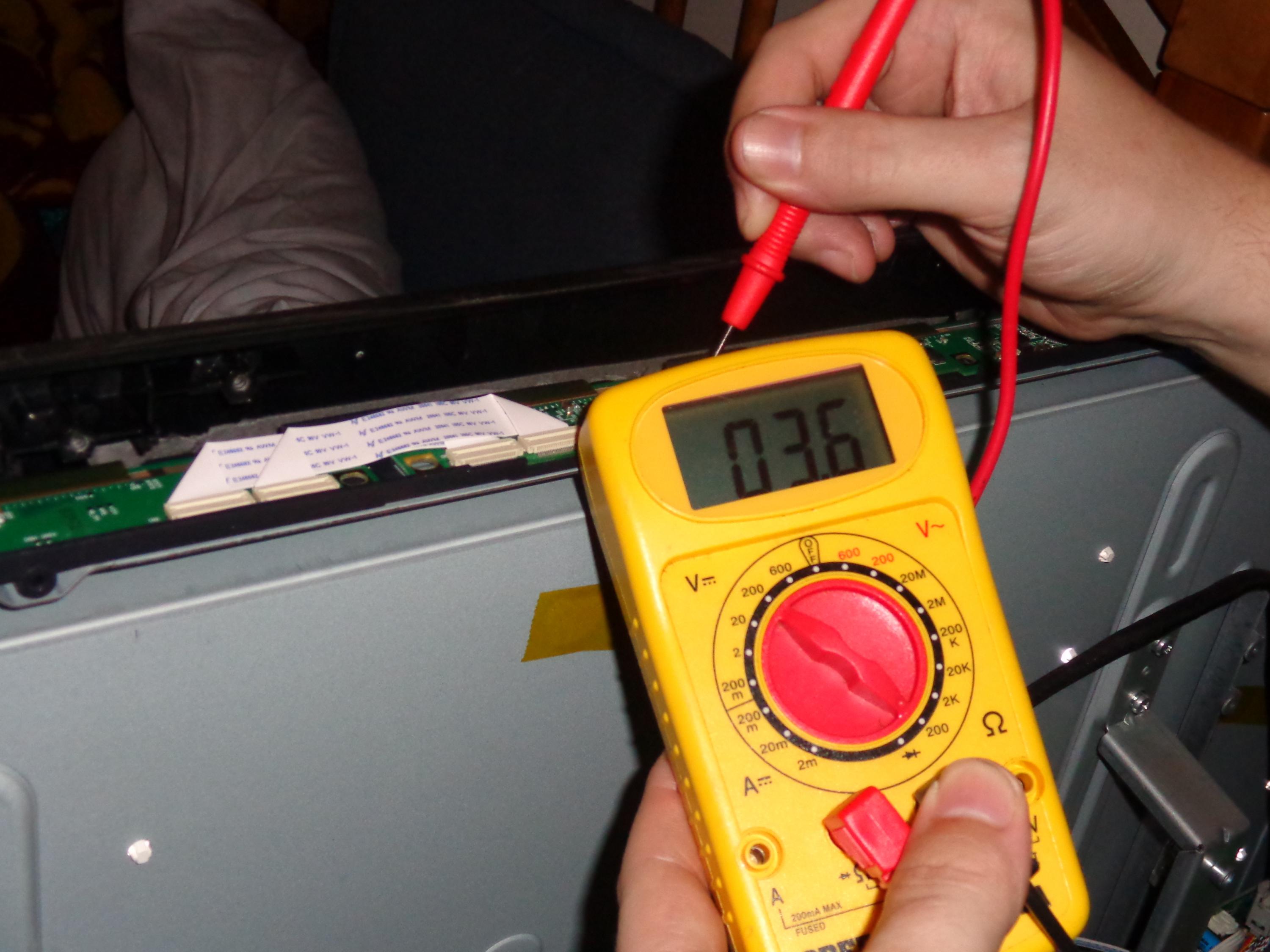

    On the other hand, I tested the FP1 with power ON screen lit up. With ohms set to 200, black on frame red at top of FP1 got 3.3.
    I also volt checked the LVDS cable and the far right cable going into this screwed up tcon reads 11.89v with volts set to 20, black on frame and red on pin.
    So maybe some hope?
    How did you get 3.3v if there is a short to ground? I'm really getting confused.

      That makes 2 of us. I did the exact same thing as previous test except power was ON for the tv.
      Multimeter set to 200 (ohm x1), black lead against the frame red lead on FP1 top. Red on FP1 bottom was no reading. Now got 3.6 steady as noted, varies with how I hold probe.

          Thats what I thought was going to happen. But I got confused, LOL.
          There definitely is a short on the tcon, since the top of FB1 to ground measures about half an ohm.

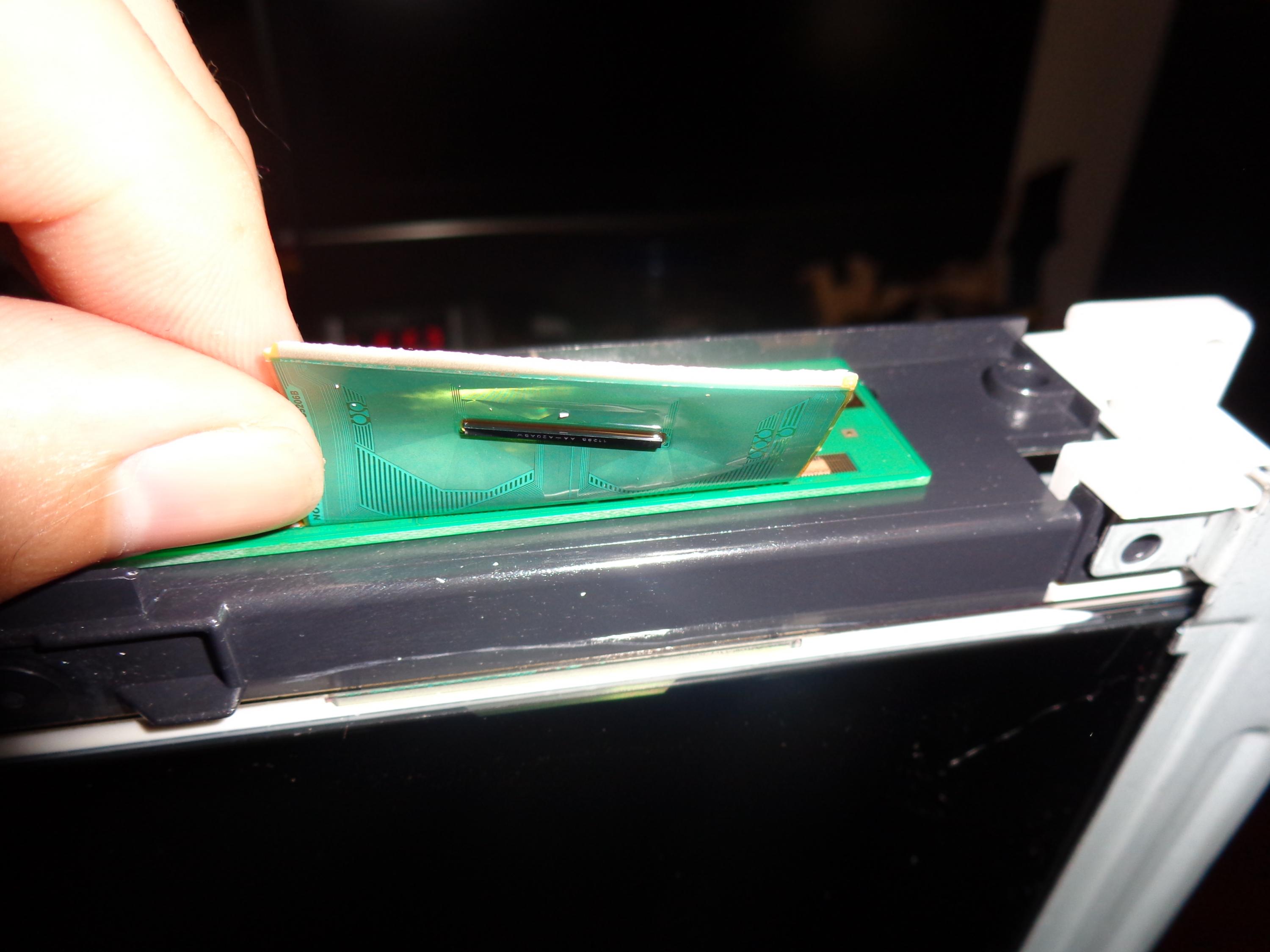

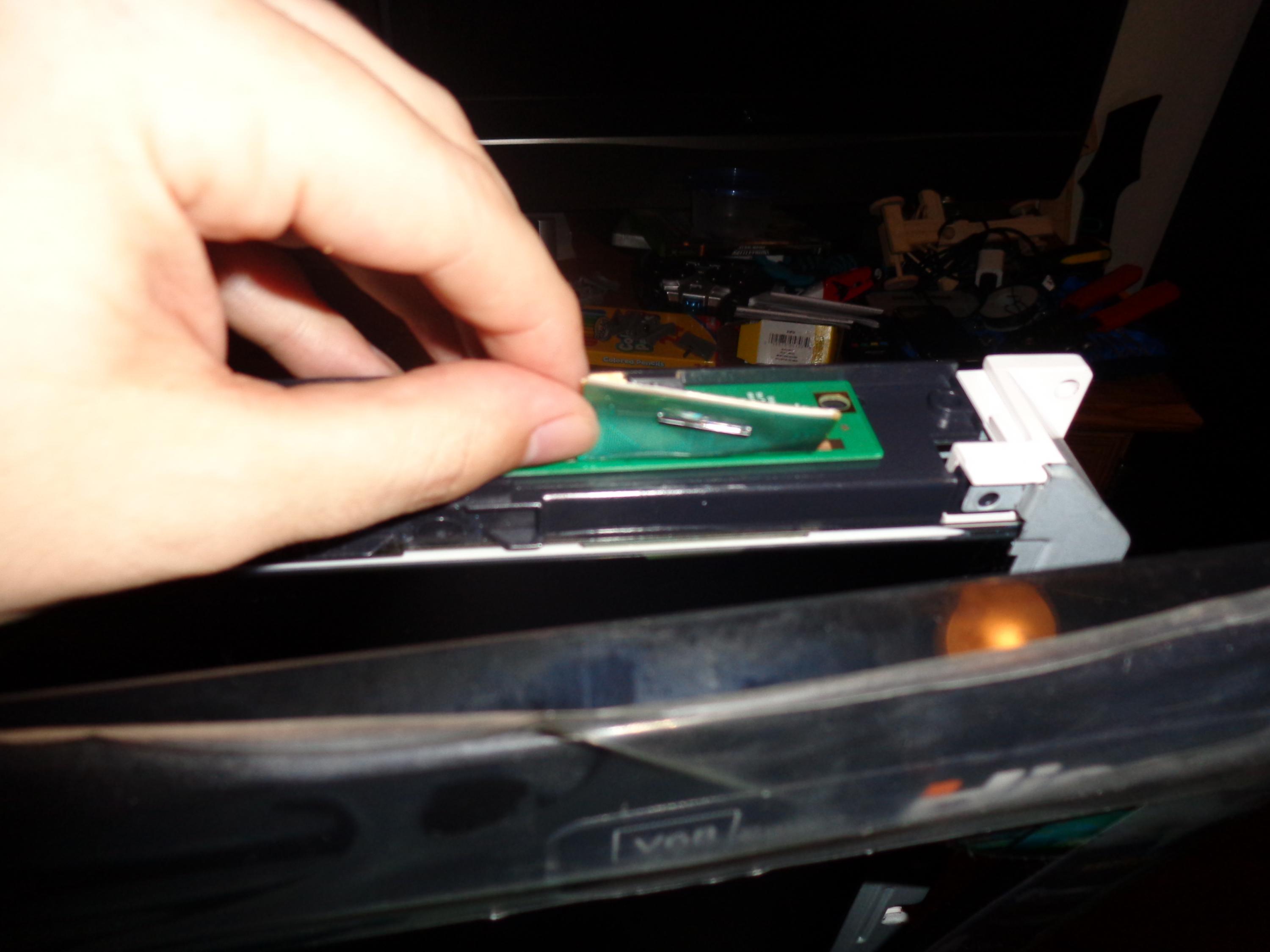

                              I heard back from a guy on ebay after a few days who is willing to carefully cut off his tcon and maybe I can splice onto my panel. But when wife got curious to what I was doing and I was showing her the issue she ripped a ffc off the panel. Is it fixable so I can try the splice, or is this panel ain't gonna work again.
                              Looks like it was held on by silicone only..... they must have saved at least $1.50 in making this thing.
                                #35
                                Re: Hisense (emerson) LTDN-42v68US no picture, yes sound
                                No, that can't be fixed unfortunately. There's something like 300 precision aligned connections on that with 0.01mm spacing or something tiny, no way you'd ever line it up again properly.
                                  thats what I was thinking
                                  thanks
                                  lesson learned, wife stays 10 feet away from all open tvs!
