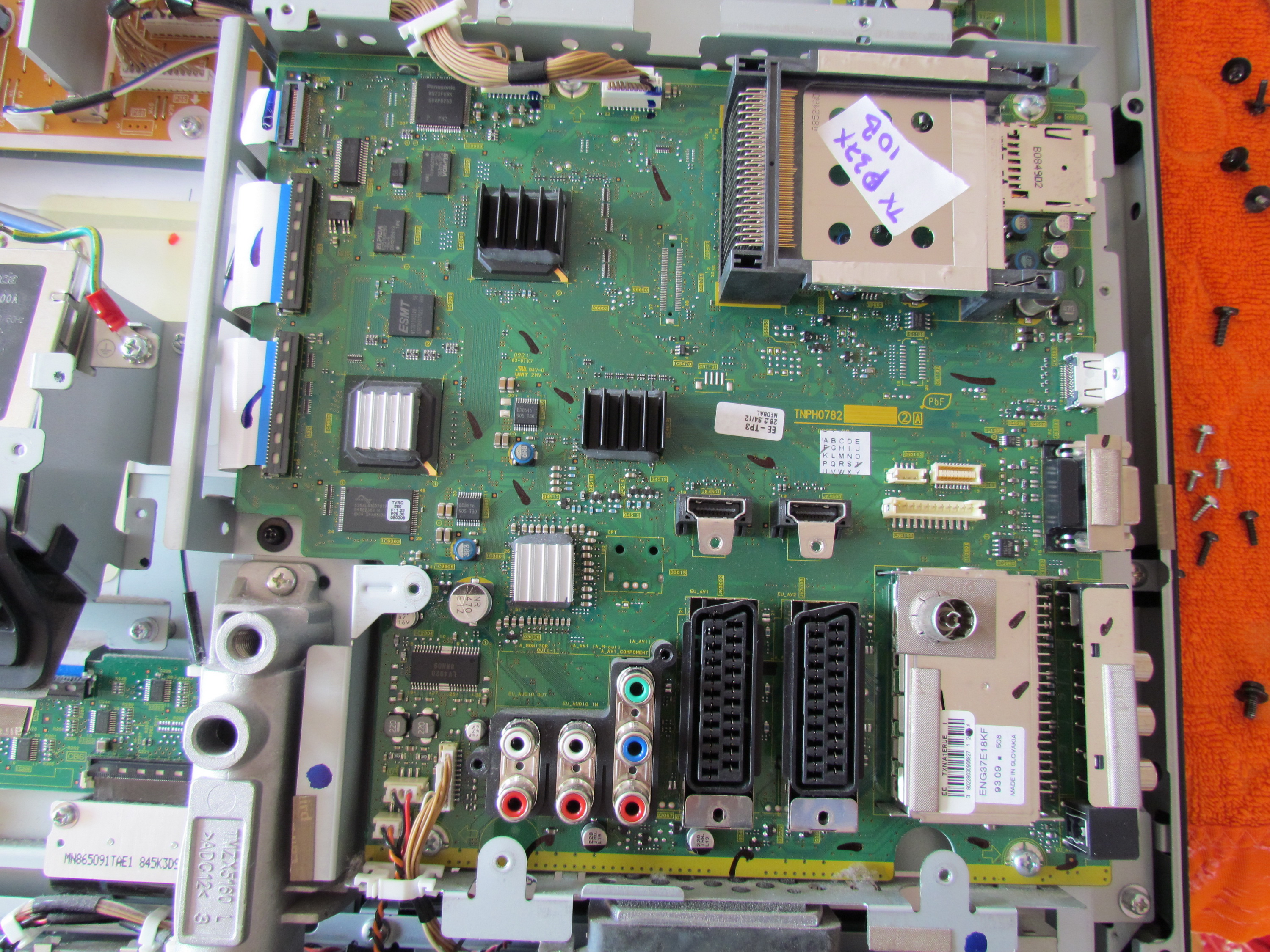

    This tv belongs to my friend.
    One day it was dead and he took it to official repair service.
    They told him that a-board is dead and asked around 300 euros for repair.
    That was too much and after that, thanks to this site i found on ebay that board for 30 euros.
    He replaced board and tv is working now, but there is a small problem.
    Since a-board is bout in UK it is set for I standard and in my country is B/G standard.
    Everything else is working except analog signal.
    It founds about 15 channels only and without signal.
    Service manual is attached.
    What can i do to solve this problem?

    Re: Panasonic TX-P37X10E problem with analog signal
    You might have to go into some service mode to change it, or get the proper firmware for the standard you need.
      Sorry i didn't reply earlier.
      I tried with some settings in service mode, opt1,2,3, but without success.
      Also tried to find software for this tv, but on Panasonic site i found only for 42" and above.
      Could i use that software?
      Is it possible to use component from old board, that contain software and witch one could be?
      Do you know where i can find software for this model?
          From what I know about these TVs the boards are locked to the suffix so you cannot alter any settings like region/PAL mode which depend on the suffix.
