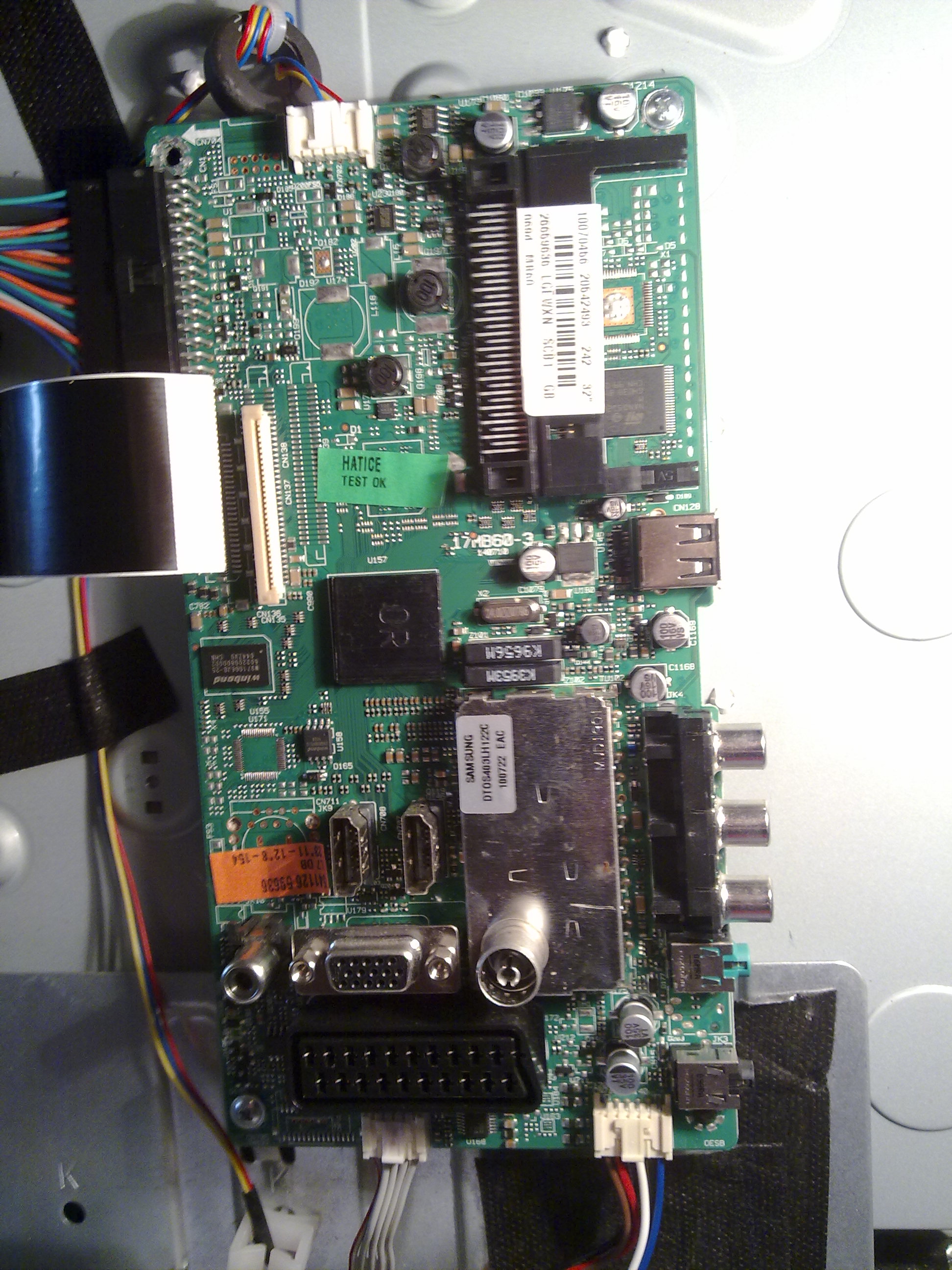

    Hi
    Got this TV and the PSU 17pw25-4 had been through a power surge and basicallydestroyed the board (It blew the tracks from the board)
    Replaced the PSU with a 17pw25-3 It has exactly the same pin out as the 4 and cheaper
    Connected it up and the tv was dead, the psu voltages were right, so I put it down to the 17mb60 4.1, my mate had a smashed screen with the same board in fitted it and now the front led is flashing and the voltages have gone a bit odd
    ie
    The 24v rail = 25.8v
    The 12v rail = 11v
    I seem to be getting 8v readings across a couple of the voltage regulators, never seen 8 volts on vestels before...is this normal
    Any help appreciated

    Front LED flashing could be problem with touch panel buttons, main board or power board... Some newer T-cons have EEPROMs on them for model number, did you match that up? 25.8V is very high for 24V. Try putting a load on it and seeing if it drops.
      SOrry my mistake if I disconnect the main from the psu it is still showing 25.8v and if I put the 10ohm 11watt resistor in it seems to lose all voltage
      I am sure I have had one of these before with same symptoms and it was one of the many diodes on the psu but they all seem to be ok
      And guess what I bought the psu off ebay grrrrrr

        Just replaced d938 and it booted straight up, must be breaking down under load as it tests ok out of board with dmm

              I take that back it must of just been luck, the psu is fine, put it in a working tv and its fine, so there is something on the main that is causing the fault, at least I have had it working once so there is hope yet

                Fixed:- 17MB60 4.1
                Replaced the 22 x 16v SMD Cap Board Position C1031, it is positioned right next to the card reader

                    If I am being totally honest a friend looked on a Database and the 17MB60-3 (the only difference is the LVDS position) had the same fault where a diode showed a short to ground and it was the cap at fault...Happy Days
                    It was a right tricky little bleeder to get out as its right next to some seriously small smd's on a delicate little vestel that will lift tracks if you sneeze :o)
