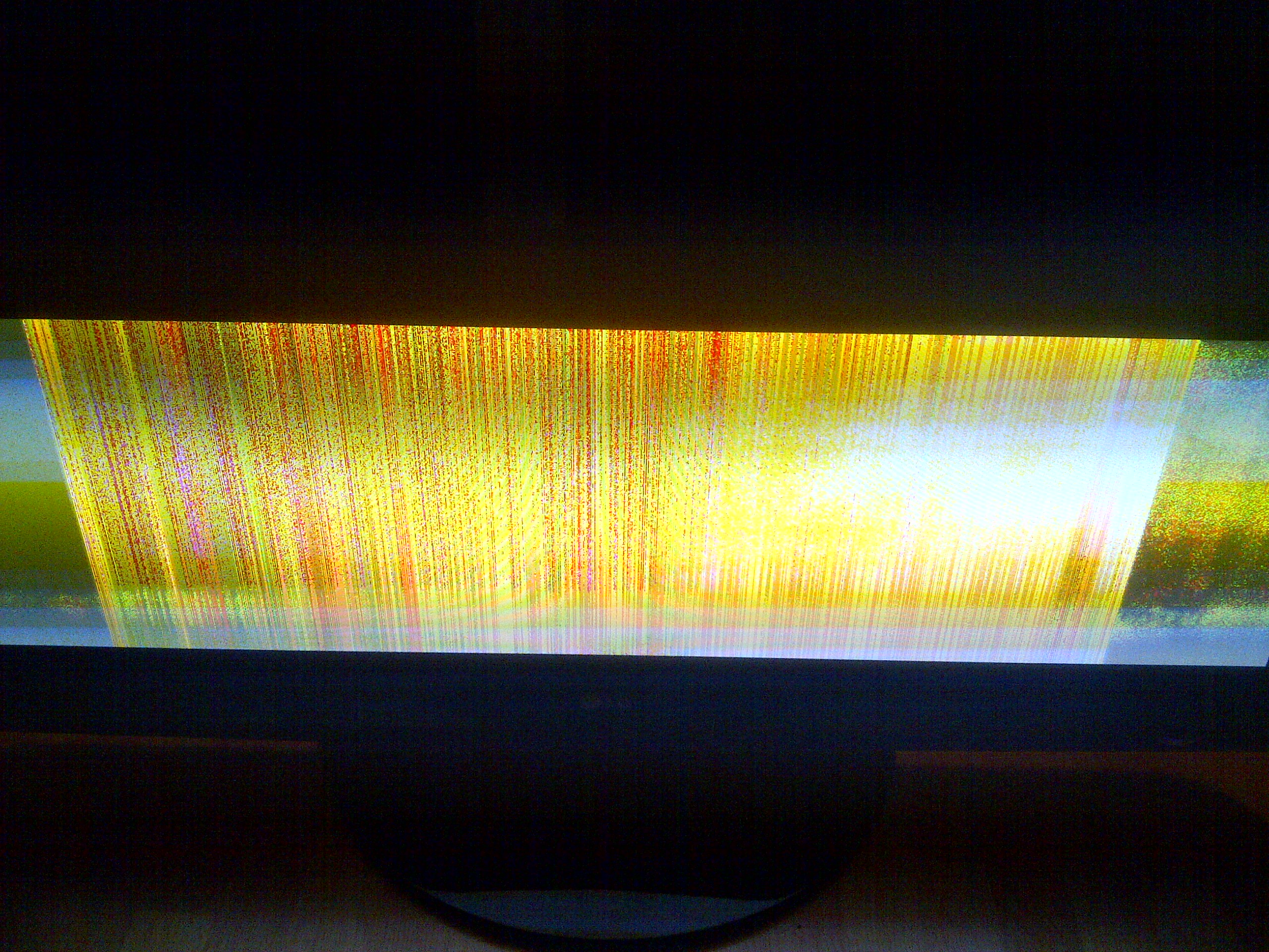

    Hello, I have a 50" Lg Plasma HD model 50PG20 the picure works fine but about the 3rd of the way down it has about a 1 inch horizontal line across the screen, I have not done anything to this tv yet what would you suggest and what is the issue?
    thanks
    Picture of the tv screen
    Bad upper y buffer board?

    Upper Y buffer would be my guess.

      is there a way to fix the buffer board, i'm use to fixing power supply's but i know these circuit board are way smaller. is there a way to check to see if its the board or the pannel?
      thanks tom66
        Re: LG 50PG20-UA HD Plasma issue...
        There is no way the panel could cause this in my opinion. Repairing buffer boards is possible, but may not be worth it depending on the price and your ability. The buffer chips require good soldering skills to replace. If you're up to replacing a 128 pin chip with 0.5mm between pins, you may be able to do it. Otherwise, swap the board.

          Alright thanks, I'm not that good at soldering lol I would cause more damage to it then I would fix it lol
          that board says,
          EBR50039007
          YDRVTP
          HS500891031
          are there any other boards with different numbers that are compatible?
          thanks for your help
            Looks to be around $63, new:
            http://www.partstore.com/Model/LG+El...R50039007.aspx
            Not bad really, used prices are around $50~60 but all seem out of stock.

                are EBR50039005 and EBR50039007 the same and interchangeable?
                thanks
                  They may be. To be sure, you will need to see if all dimensions and connectors are the same, and that it is used in the same plasma panel (not TV model, the plasma glass itself, which has a sticker on the metal plate e.g. LG Electronics PDP50G8#####)

                    Here's my panel details:
                    It's a Mexico model,
                    the sticker says:
                    Model: PDP50G10343
                    Mexico 2008.09
                    Thanks for your help
                      You need to check if those boards came from a PDP50G1 panel but they'll probably work.

                            Thanks for the help, I just tried turning my tv on today, the back has been off it for months, now i get sound but no picture (i haven't changed the y buffer board yet) i noticed the back of it is fairly dusty and the power supply makes a hum when on. i think i have a bigger issue? i should also add i removed the heatsinks from the top y buffer board and the glue around the chips on the top y buffer board
                            thanks
                              Yeah, the glue around the buffer chips is vital (high voltage insulation), the buffer is probably fried now... hope the Y-sus is still OK.
                              Try with top buffer unplugged.

                                with the top buffer removed i get picture on the bottom half only its distortedi'm assuming thats because to work properly it needs both buffers?
                                thanks for helping me with my stupidity
                                  Yes that indicates your Y-sus is OK and your bottom buffer is most likely OK. Both buffers are required for a good image.
