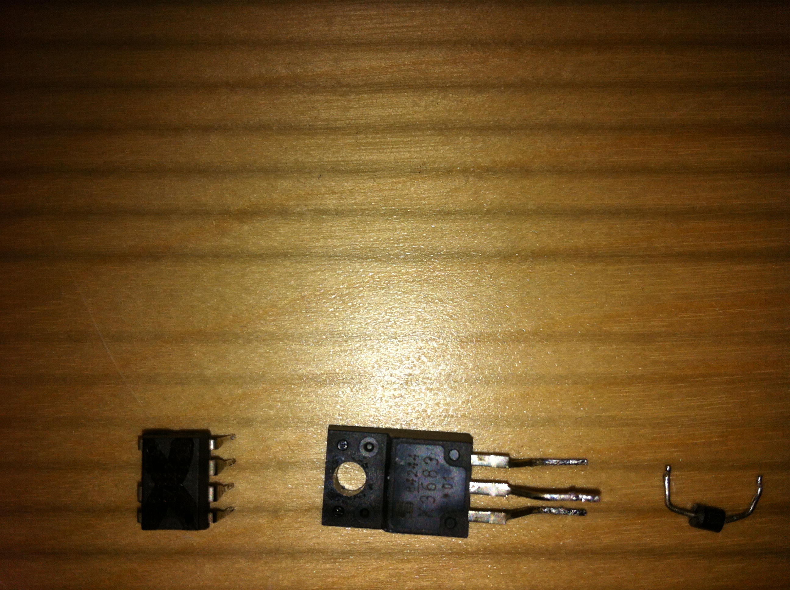

    hi
    can anyone help please looking for the following components to fix a power board
    cant seem to find online
    the one on the left says a6159 sk832 11aa
    the middle one says 64244 k3683
    the right one says t-10
    Re: Panasonic tx-37lzd80
    First one STR-A6159
    Middle one 2SK3683
    Those two took me about 30 seconds to Google, it's not hard. Learn to use it.
    Last one unsure, but probably conventional high speed diode 2A or 3A 1kV, maybe UF5408.
