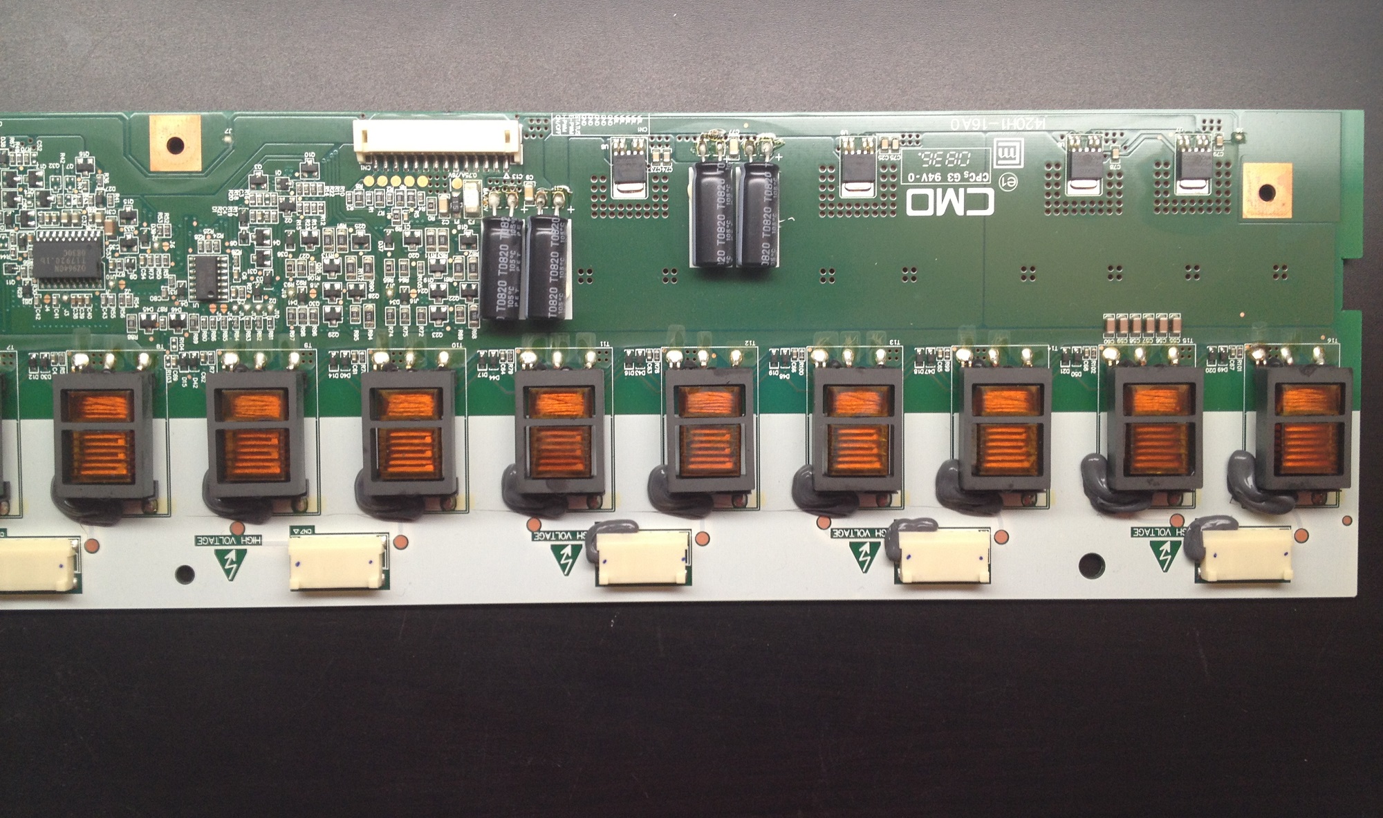

    Hey I just got myself this Sharp LCD TV! Model Number: lc42d65u
    It had the blinking green LED problem when turned on. I did the PSU forcing on by holding Channel + and Volume - and plugged in the power cable. Then Once I press the power button the green LED turns on solid (no flickers on the screen), I used a flashlight and I can see the picture on the screen just there no backlight..
    I also noticed that if I hook on HDMI, I notice the picture but there doesn't seem to be any sound either.
    Measuring the fuse on the inverter board I'm getting 23.7V on both ends of the fuse. Is still an inverter problem?

    You have CMO inverter board; check the 0.75A/76V fuse as it is a very common failure.

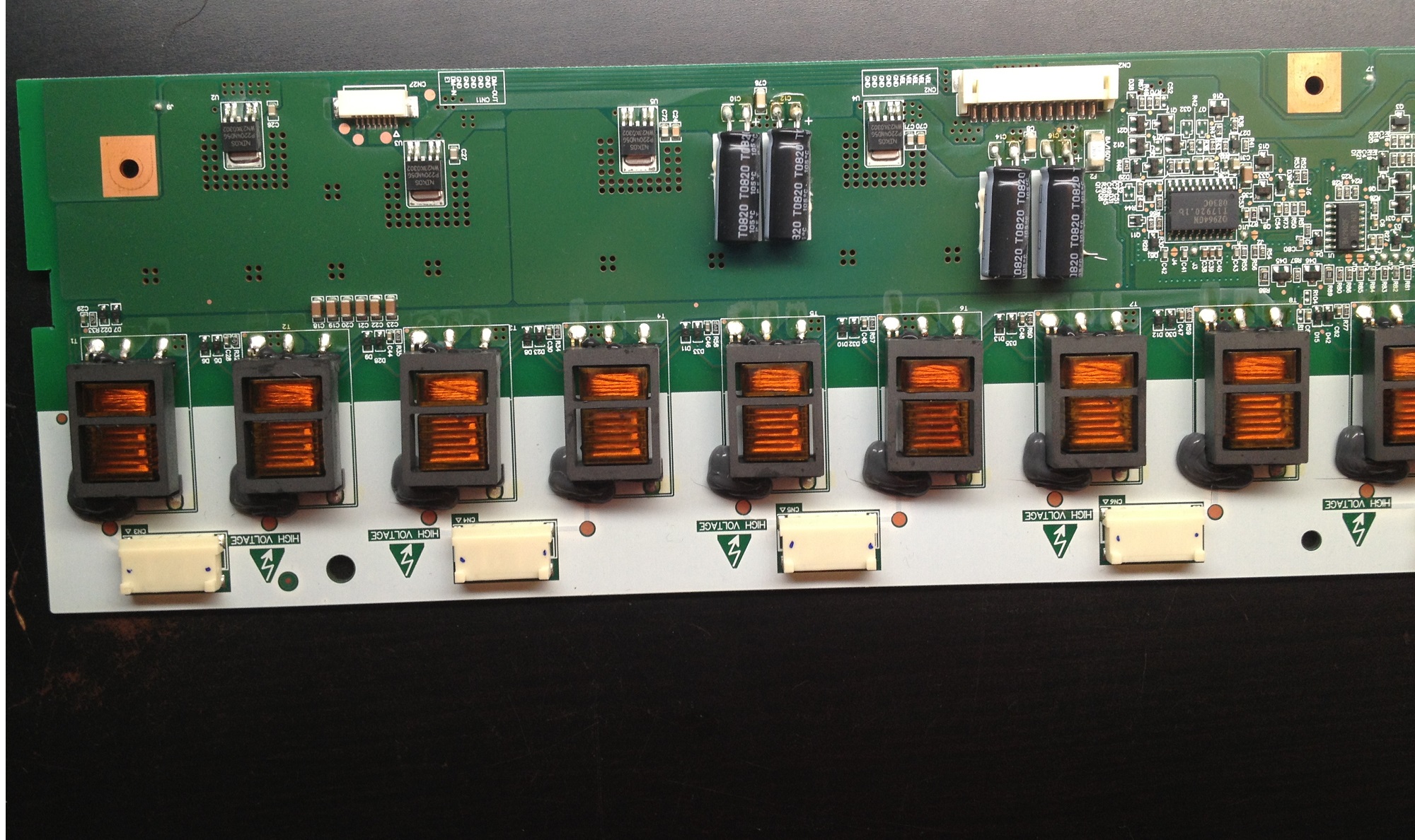

      Measure the resistances of all the inverter transformer high voltage windings. Do this with the Tv off, and/or inverter board unplugged!
      Any transformer that reads much different from the others is bad. If you arenot sure about the resistance measurments you got, just list them in a post on here.

        Ah you're right tom, I didn't even notice the smaller black F1 fuse on the board. I'm getting no continuity through the fuse so I guess its bad.
        Where can I get another one of these fuses?

          Upgrade 0.75A to 2A to reduce failure rate; 63V rating is suitable for 24V inverter.

            Another CMO with bad fuse for the PWM IC.

                I think the fuse they are using is a little is under rated, the inrush current I measure with my FLUKE set to peak detection readout to be about 1.5~2A range. I fixed so many CMO boards with the same blown fuse, I use 2A PICO II fuse and none (>10 units) have come back yet.

                          That did it! Replaced the little fuse and the set came back to life! Thanks guys!!
