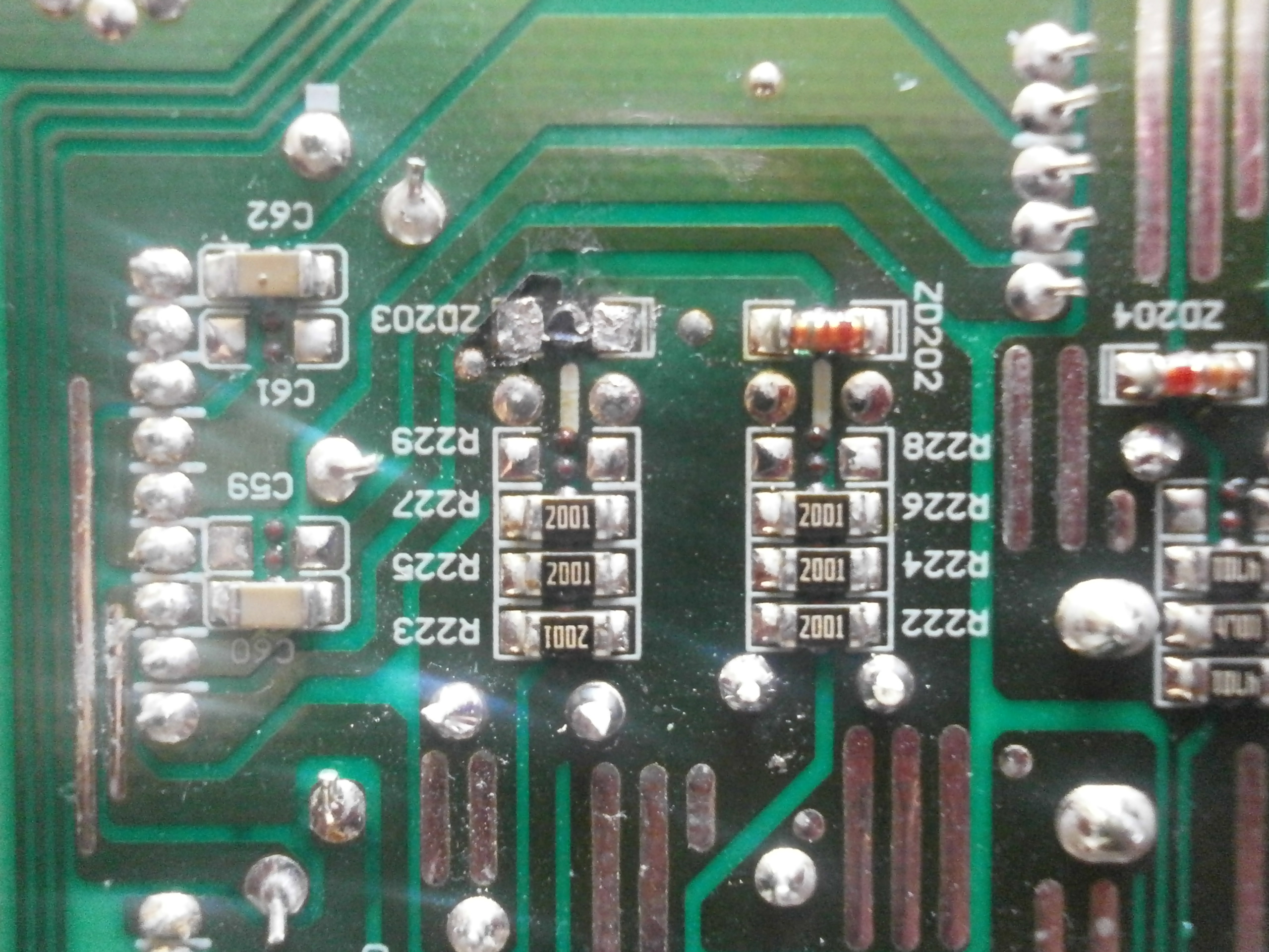

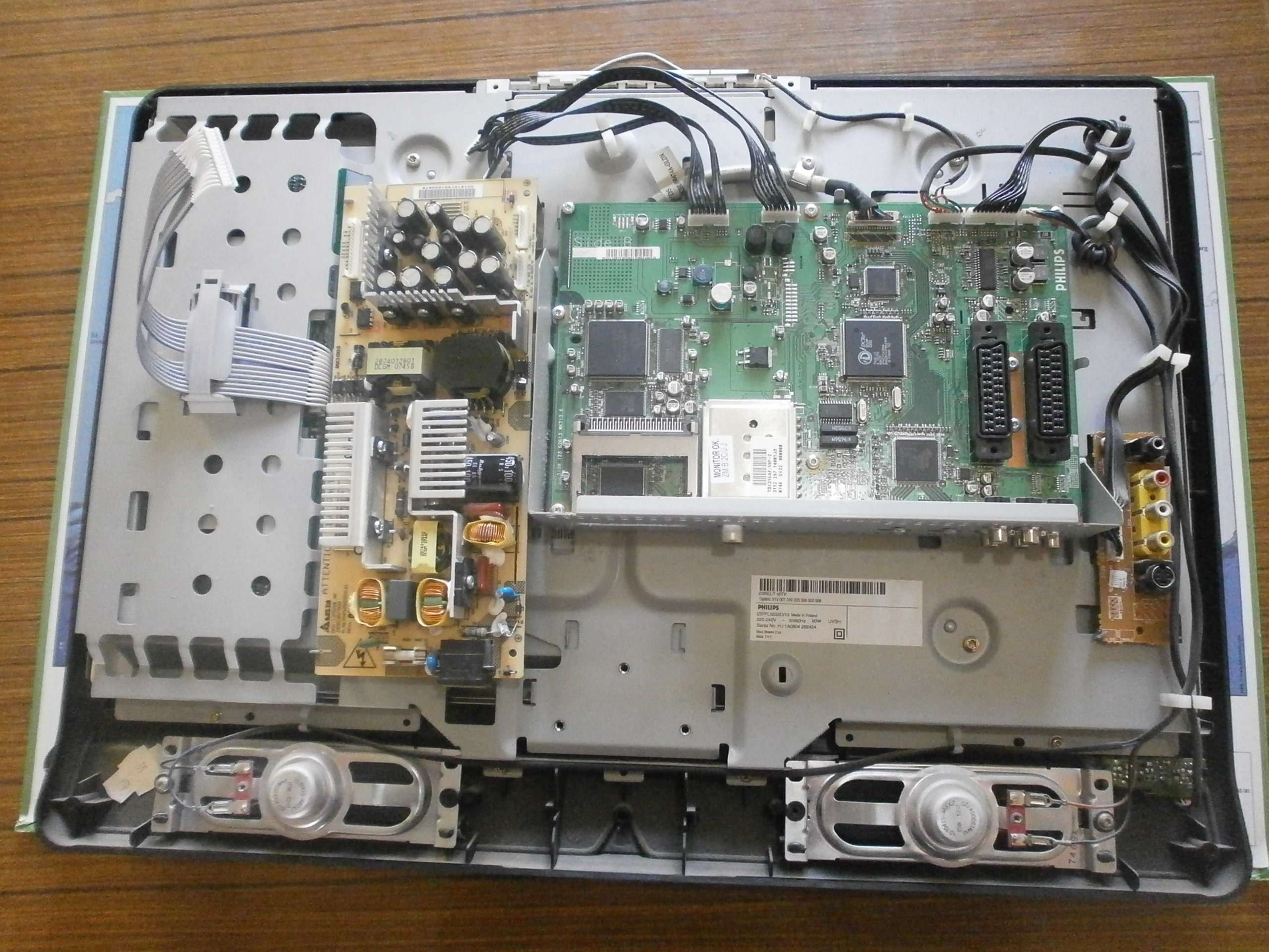

    Hi there,
    My Philips TV (23PFL5522D/12, chassis LC7.2E LB) has just packed in again. PSU makes a ticking noise even standalone outside ot the TV. It's my own fault - although I ordered a full set of caps (or almost), I decided that the less soldering I did, the less chance there was of messing things up. BAD DECISION! OK, this time I've changed the rest in the bad-boys corner, but noticed that one of the SMD zeners was fried. I've desoldered it, but don't know what it's value was. I checked the SM I got from Elektrotanya for this chassis, but the PSU doesn't match. Photos of my kit below. My questions:
    1. What is the value of zener ZD203? and can I use a radial one for easier soldering?

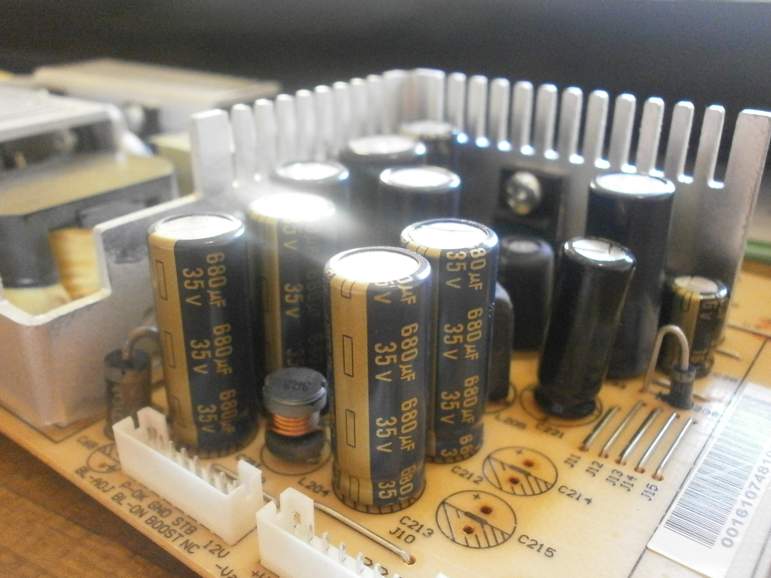

    2. The original caps were CapXon GF and GL series which I replaced with Panasonic FM/FK series. Is this OK?
    3. I've only replaced the caps on the far right of the photo (surrounded by a heat sink. I guess I should change the others too (excepting the large Rubycon), but one of them was siliconed to the board and its value unreadable. It's at the top, more or less in the middle in the photo (and looking a bit of a mess where I've tried to scrape away the silicone), is a 50V and labelled C23 on the board. Anyone know what its value is? I could desolder it and measure the capacitance, but that would assume it's OK.
    Thanks for any help you can give me!

    Hello again,
    I've still not got managed to sort things out, but have a couple of ideas:
    - Not sure about my FK series Panasonic caps. Are these ESR, or should I replace them with FM or FR series?
    - The zener has a wide red band, a narrow red band and a narrow green band. Looking it up on the web suggests 15V, but it's on the end of the 5v supply circuit. What appears to be an identical circuit next to it gives 5.80 -5.92V when powered up ... so it must be ~5.8V zener, right?
    Can anyone help me out?

        Re: Philips 23PFL5522D/12 PSU problems
        Thanks for your quick reply!
        Yep, that's it, but there's something odd with the measured voltages.
        - The dead zener was between "Gnd-audio" and "-Vaudio", but I get a constant 0V across it.
        - The other (still ok?) zener is between "Gnd-audio" and "+Vaudio", and here the voltage switches between 0V and about 5.8V with every ticking noise. What might be causing this? Could it be the FK series caps aren't low ESR? Or something's toast further upstream?
        -- Mike
          A bit more info - I think audio voltages should probably be + and - 12V, so I don't know why I'm only getting 5.8V.

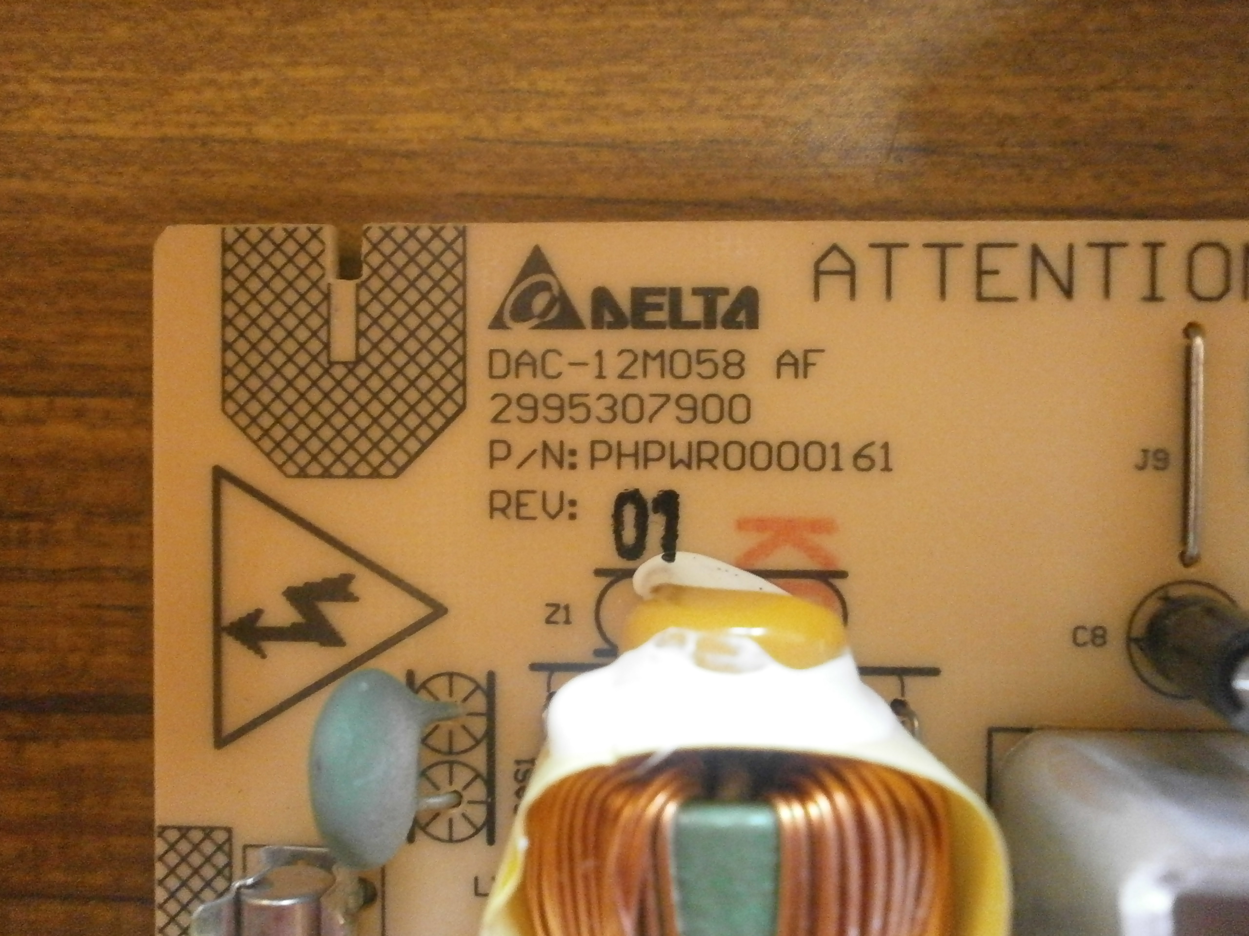

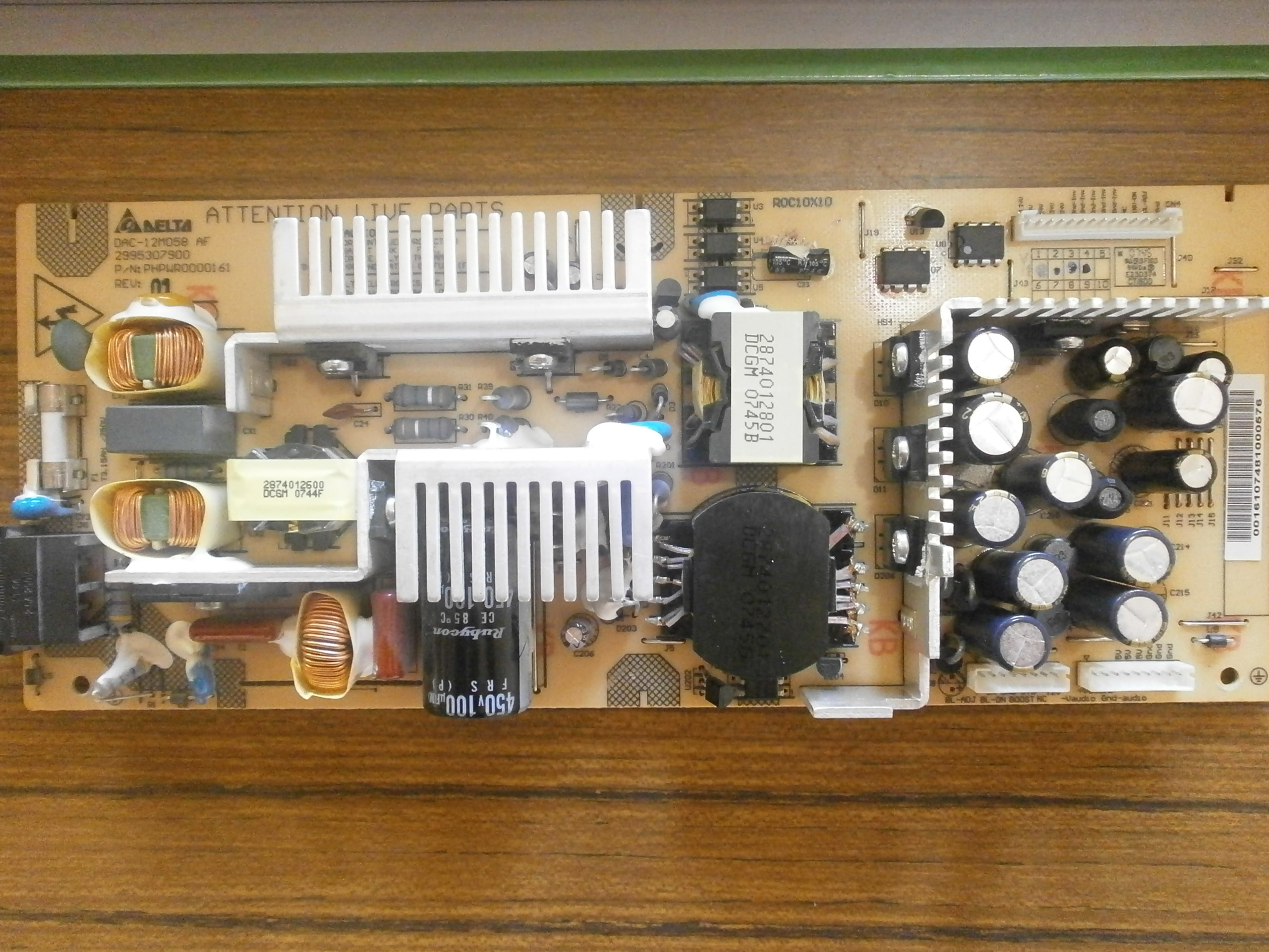

              Hmmm, got the service manual from ElektroTanya, but the 2 versions of PSU are _nothing_ like mine, so it's pretty unusable. I tried Philips and Delta, but both were (as expected) unhelpful. I'll see if I can guess what the PSU gives by looking at what the other boards use...
                i think zd203 and zd202 same diode.
                      so you can measure +-12volts on zd202 and zd203.???
                        Can't measure much yet : zd203 is dead and has been removed, and as I said earlier I only get up to about 5.9V on zd202 before the PSU shuts off and retries. I'll retest and report on my findings when recapped and (hopefully) working.
                                  then recap with PANASONIC .and use 12volt zener for zd203.
                                    Can anyone tell me if the Panasonic FK caps are likely to be causing me problems (related to ESR)? I can try replacing them again with FM or FR series, but it would be nice to know if it's worth trying. And for the smaller caps that don't exist in FM/FR (eg 1uF) what should I use? FC?
                                      FK should be fine.1uf does not have to be low ESR, but should be 105C rating.
