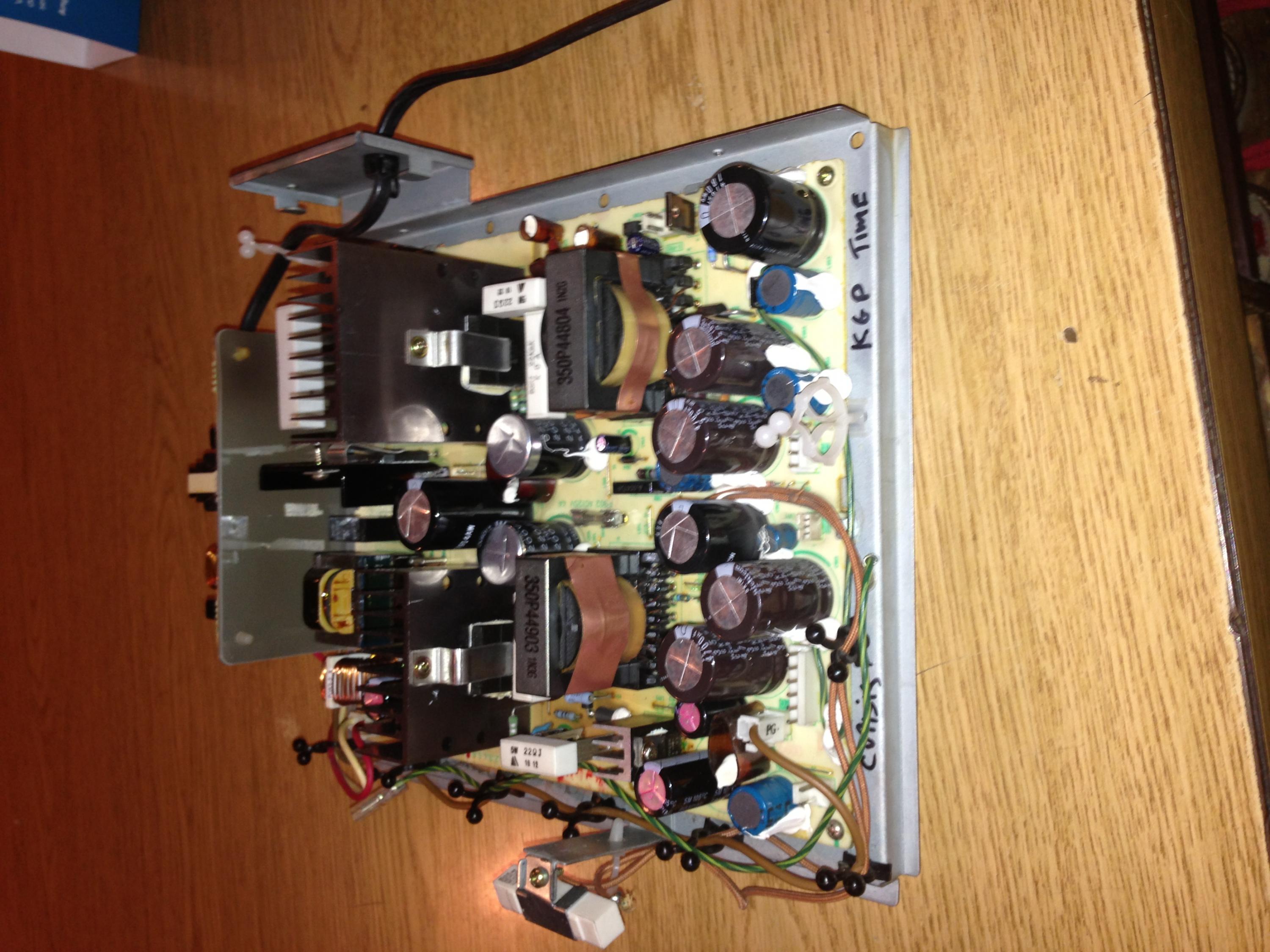

    Ok I know this is an old one, but it is for a large arcade machine, and such must be fixed
    I am looking for a schematic, or if anyone know what resistor goes on the board
    Power Supply Board
    Model: 935C31801 and it is R913 that I cannot read .
    any help is much appreciated
    Ken

    Can you post some pictures of it?

      Re: mitsubishi vs7004r - Power supply
      Here are the pics

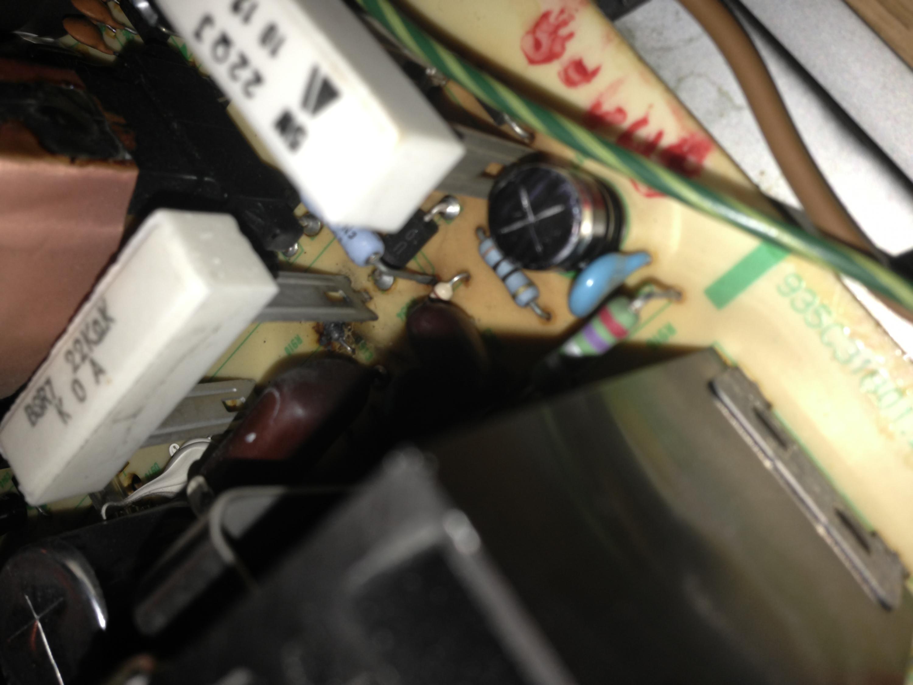

        Looking for r913 and r934 values .

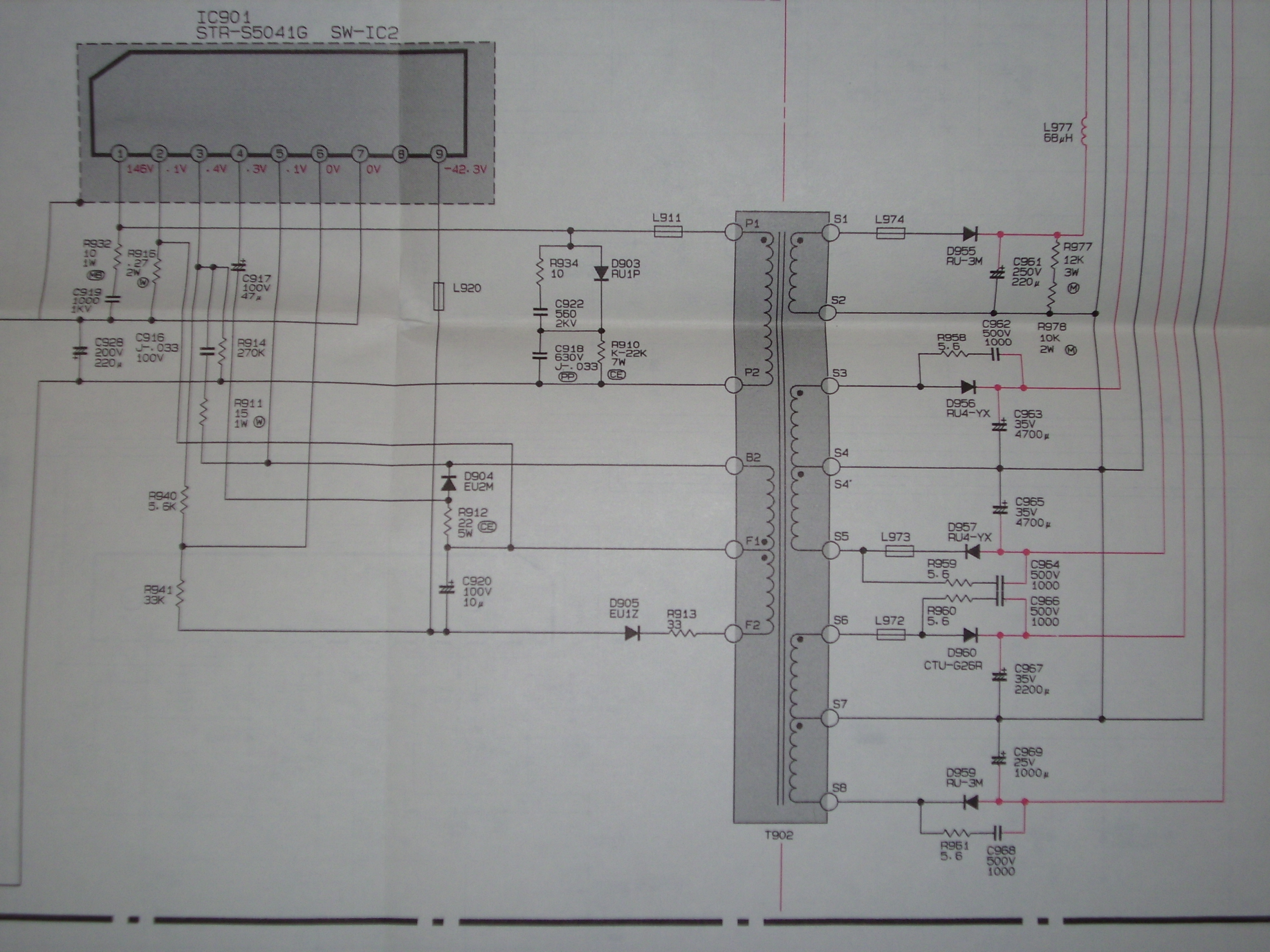

          It might be best to get a schematic for this!
            pcb-power schematic shows R913 (33 ohm) & R934 (10 ohm) this service manual was printed in 1991 for this set,manual# VS-013 for VS-7004 (V11 chassis)
              I'm thinking your IC901 could be burnt out too.
              Check diodes D903, D904, and D905 please! Also check C918.
