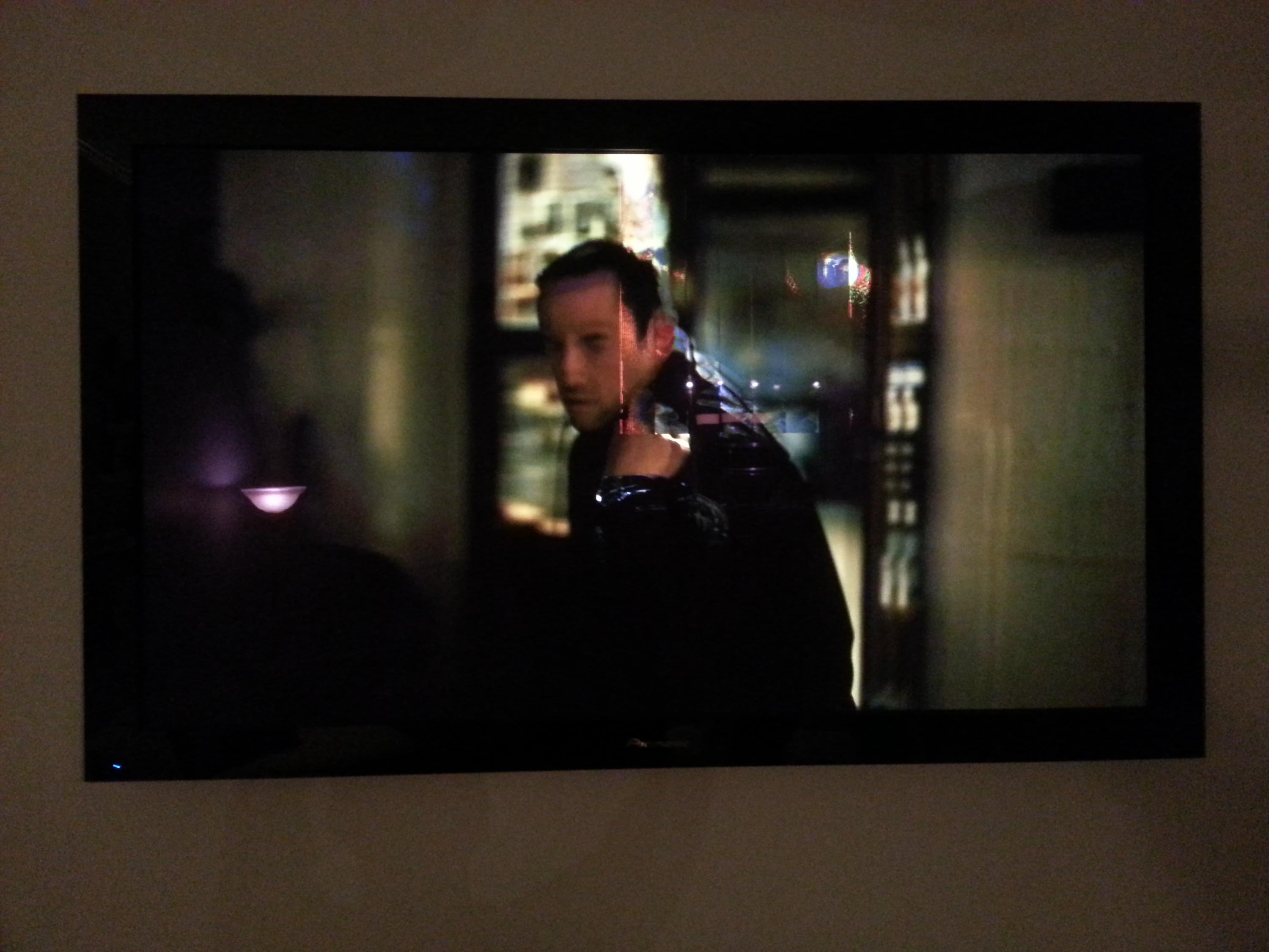

    I have a Pioneer 60" plasma (KRP600M) that for the last several months has had an issue pop up intermittently. Basically, I get vertical distortion in the top middle section of the screen. Always in the same place (if you divided the screen up into eight square segments, it would be the third from the left at the top). See the pics attached.
    Like I said, it comes and goes. It can disappear for weeks at a time, or linger for weeks. It seems to be around more often than not these days though.
    Any thoughts?

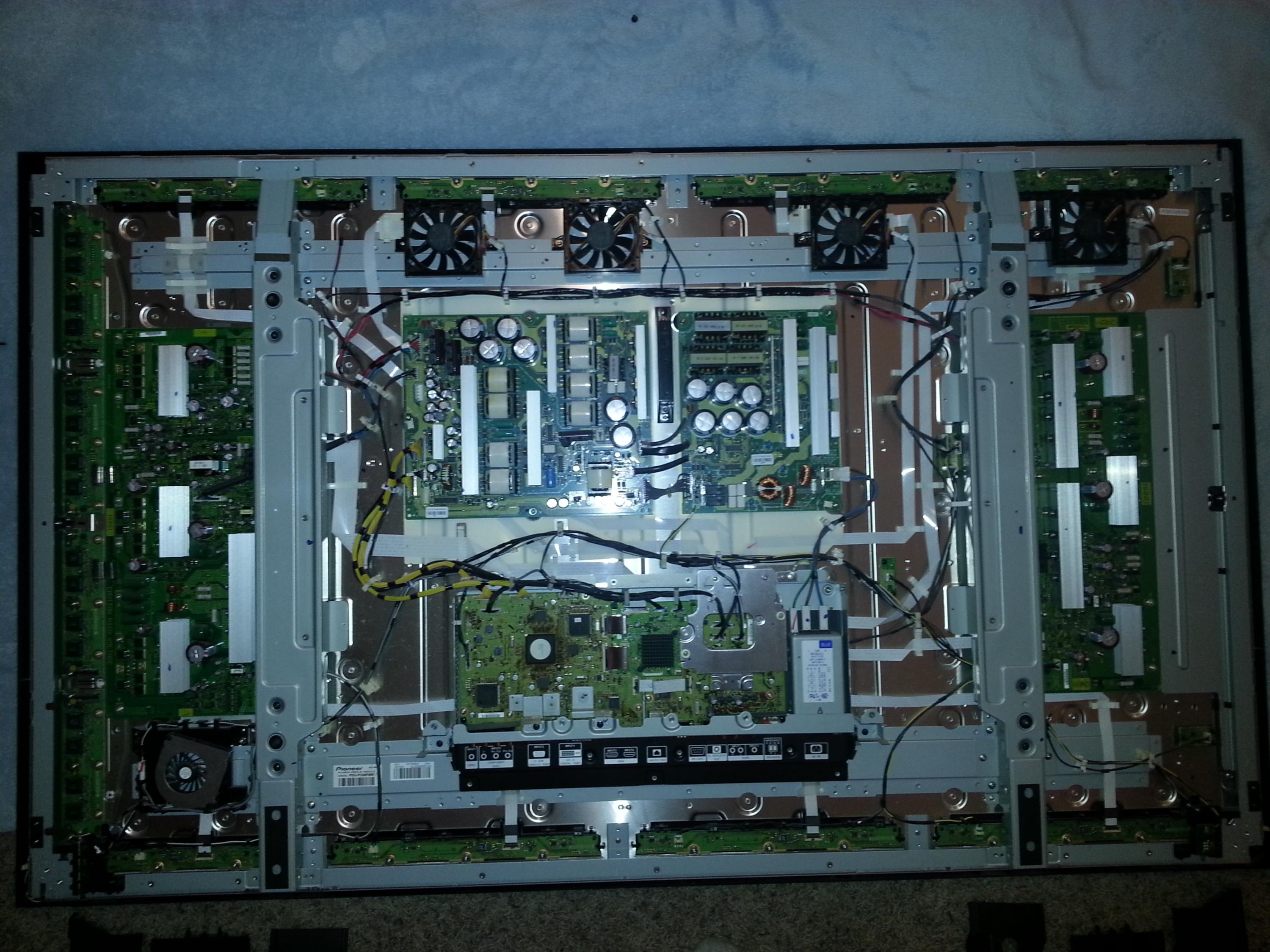

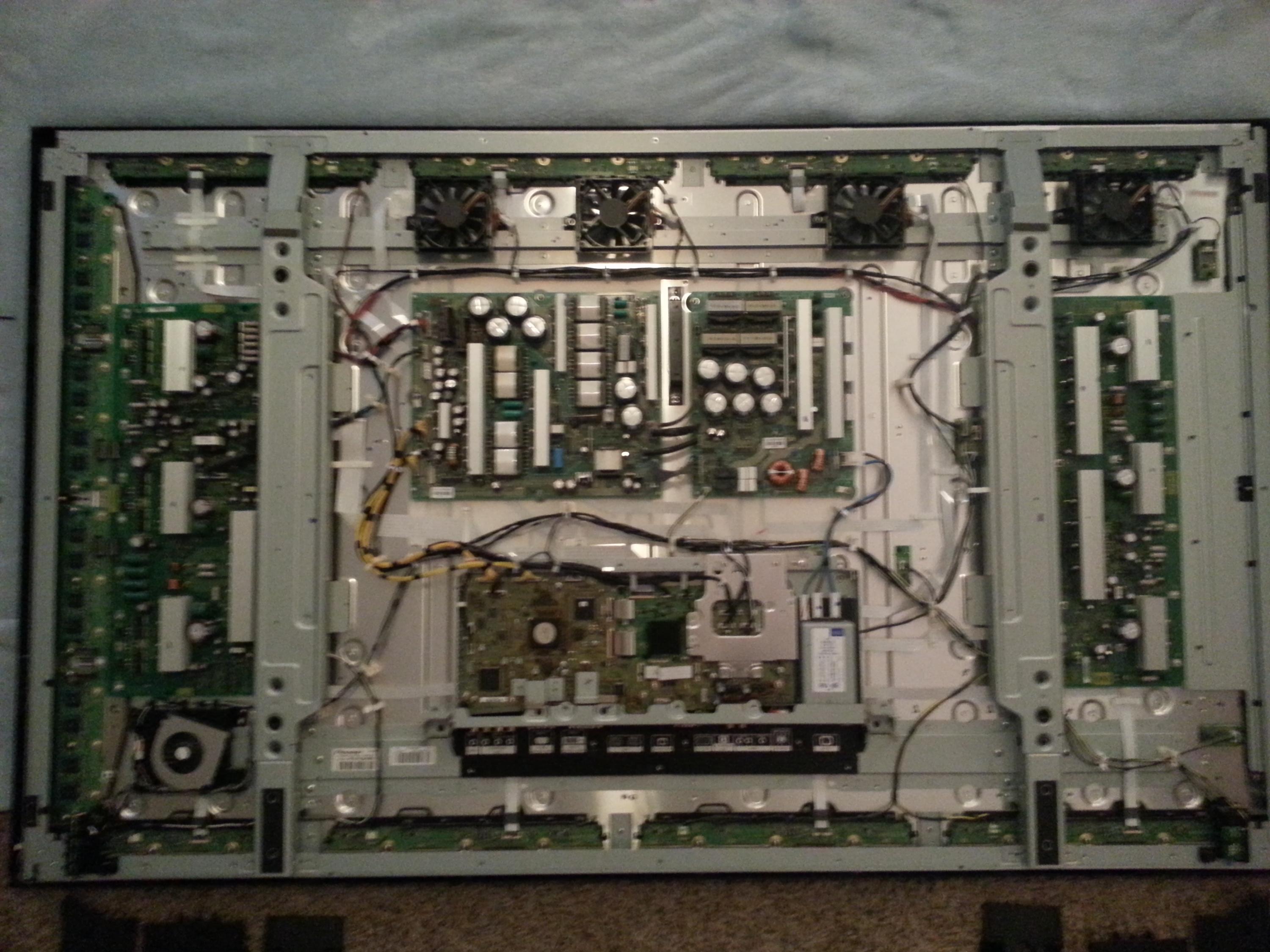

          Cover is off. Here are the innards. Looking for loose connections or a button that says "push this to fix problem".

            I have gone over it in detail and there are no loose connections at all. I checked all connections anyway and reassembled and the distortion is still there just like before (I figured this was a shot in the dark anyway).
            Based on the position of the glitch, I looked very closely at the top address buffer board second from the left (as you look at it from the back) and traced it to the logic board making sure that connection was sound. It was solid all the way. No obvious issues with the flat wire, the connection, or any of the board components.
            One question is, if this is a buffer board issue, are all the address buffer boards the same or is each one a particular part number? Some of them appear to be identical. Can a buffer board even be replaced on a Pioneer or is it essentially permanently connected to the pdp? I have seen videos of people disconnecting buffer boards (usually ones that are attached to the Y-sus board) from the pdp, but mine appear to be connected via adhesive or something (I am obviously not an expert here).
            I am thinking this may be beyond my abilities and I will have to fork over the hundreds of dollars just to get a tech out to look at it and see if it is even repairable. It kills me, because this is such an awesome TV, to have something annoying like this pop up and have so few resources for Pioneers is frustrating.
            I took more pictures that I can post if anyone would like to see them.

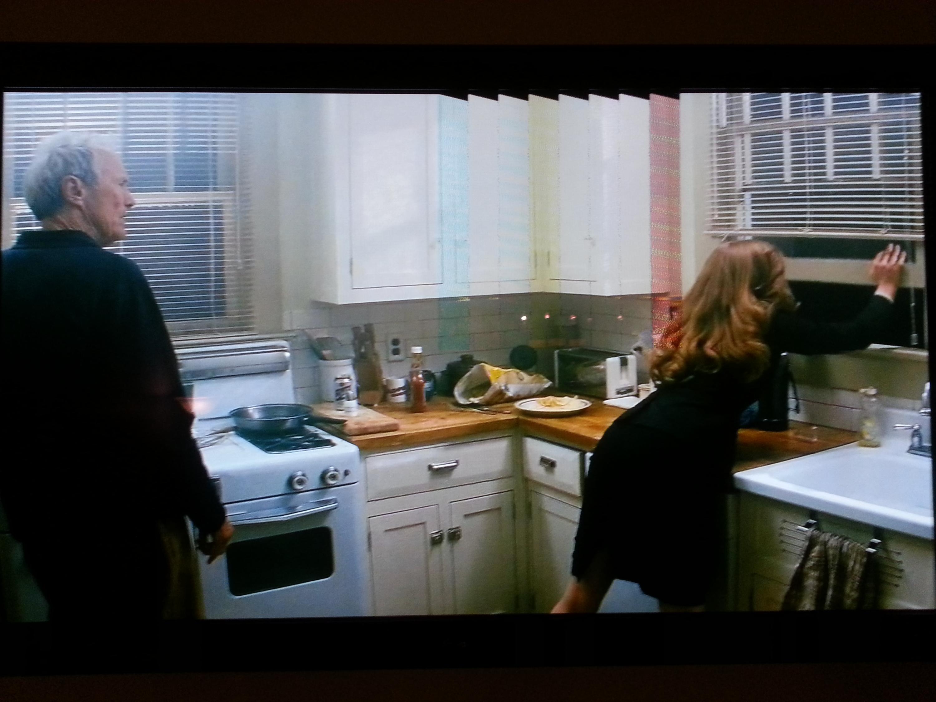

                            ***UPDATE***
                            Just in case anyone else might have been interested in my KURO issues...
                            I finally got around to replacing the digital assy in my KURO to see if that was what was causing the distortion issue (thanks a million to Tom for pointing me in the right direction)...long story short, my picture is back to crystal clear. Problem solved. Again, can't thank Tom enough for the assist!
                            For those that want to know the process:
                            I found a service manual for my KURO online, which was a huge assist for disassembly and having confidence in identifying the various assemblies. For example, my digital assy is positioned underneath a couple other boards in my TV, and if left to my own devices I may have attempted to remove those boards to get to it. It would have been a nightmare. Luckily, the manual was actually very clear, and I was able to lift out both boards right on the bracket they are attached to just by undoing four screws.
                            Anyway, the removal and replacement process was very simple (like my previous post said, I had gotten the replacement part from ShopJimmy...great experience with them). Aside from a stupid snafu with not realizing that I had knocked the main power switch off and having a few minutes of terror when I could get the set to power on, it was very straightforward.
                            I also had to find a way to get into the factory menu, which was sort of difficult. The only way to do it is with a pioneer service remote, which I do not possess. I was able to dig around on the net and find the hex code for the command and manually load it onto my harmony remote. Not at all straightforward, but pulled it off eventually. As a bonus, I got to see that I only have 13000 hours on the set. Lots of life left.
                            I am really happy to have it back working, and for $25 at that. Thanks again for the help everyone!
