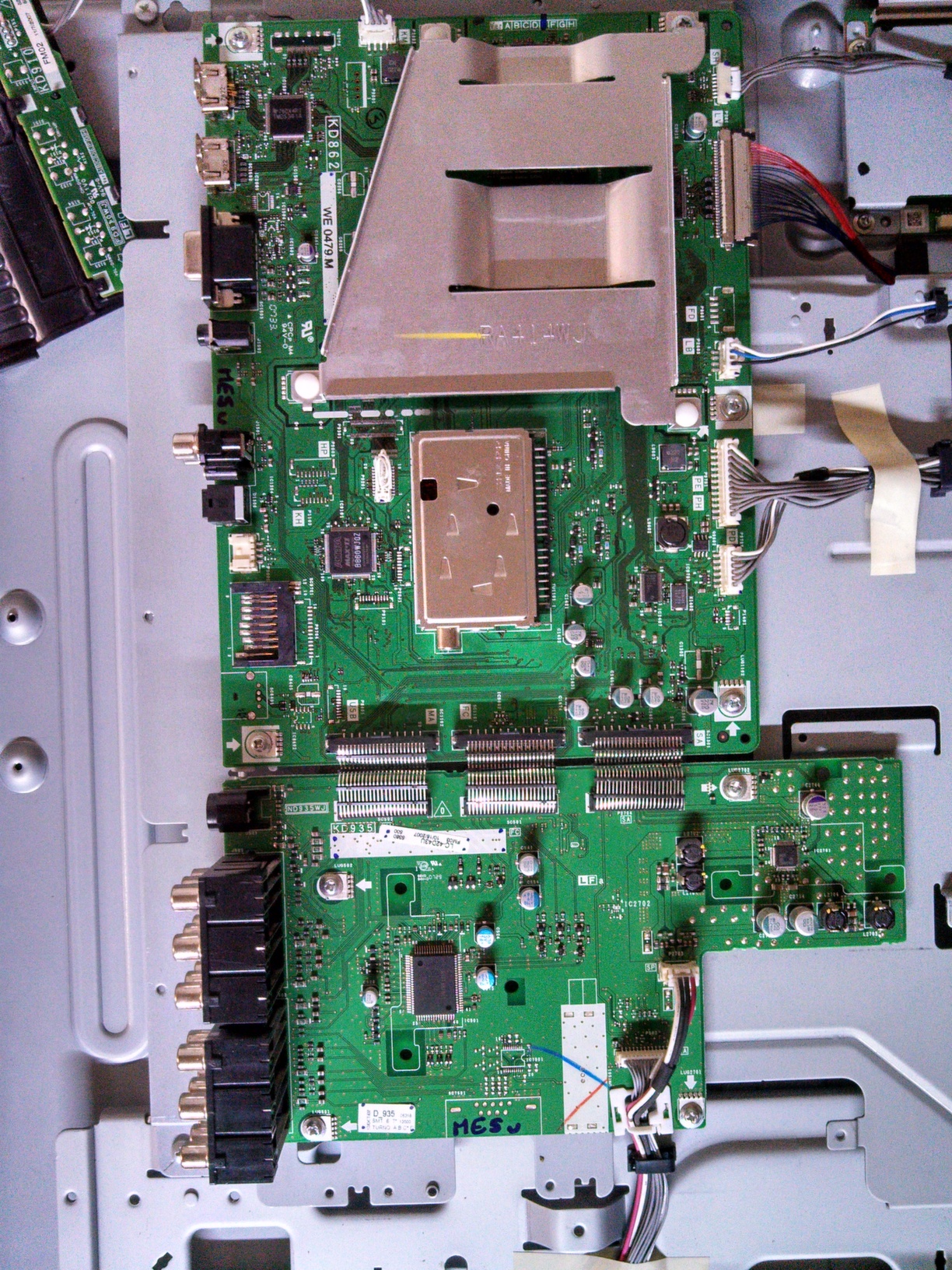

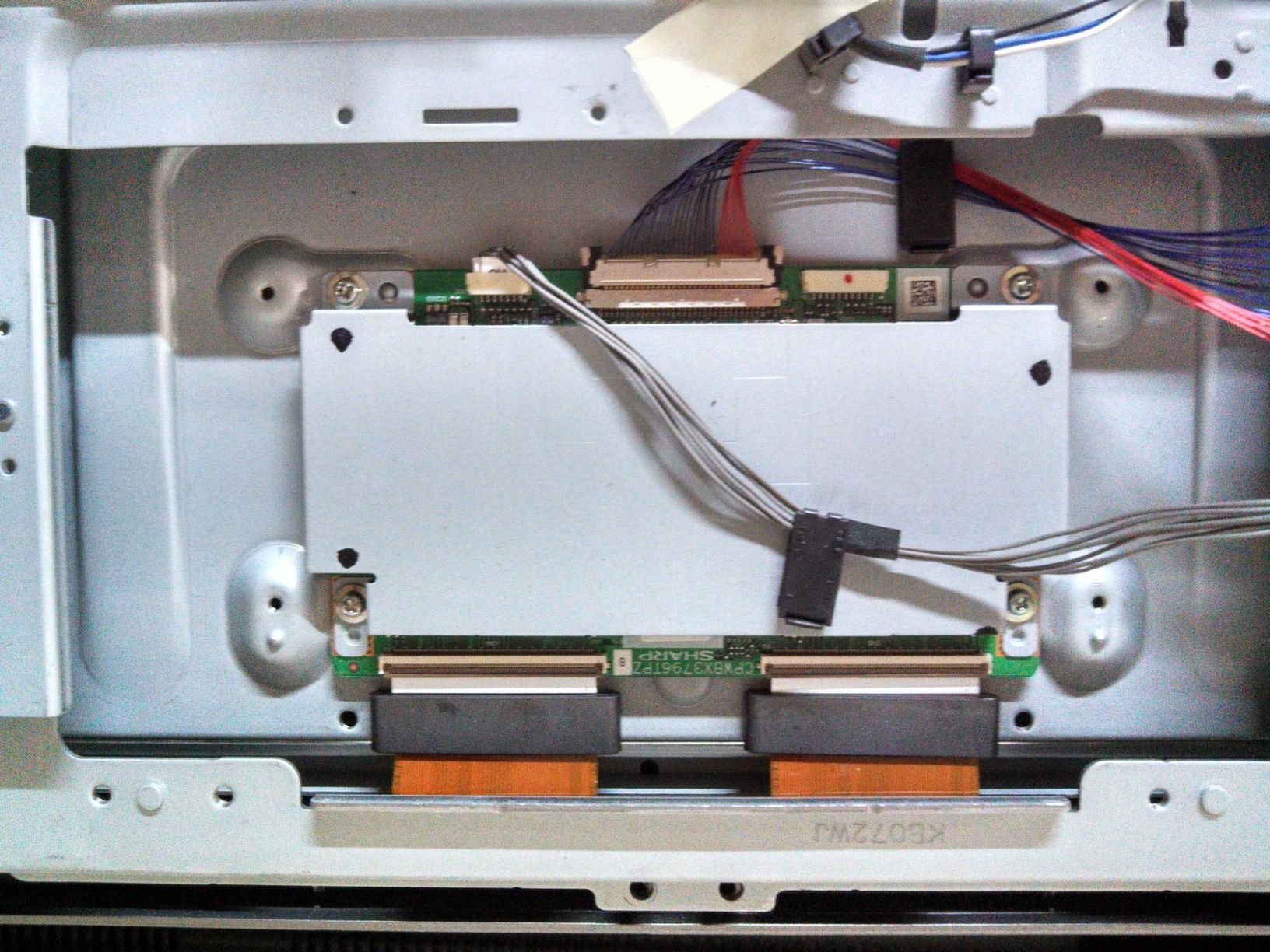

    I have a Sharp LC42D43U-42, that has no picture but has sound. Read somewhere that it may be the main board so we switched it out, now the tv comes on, blank screen, green power light and green opc. We read that maybe we need to upload the software for the new main board, but can't find anywhere to download the software so that we can perform the upload to the new main board. Does anyone know where we could find that? Also what is the thought that the main board was not the problem, and that it was the backlight inverter? Prior to changing the main board the tv would come on gray and fade to black, no picture what so ever. Any help or suggestions are appreciated. Thanks.

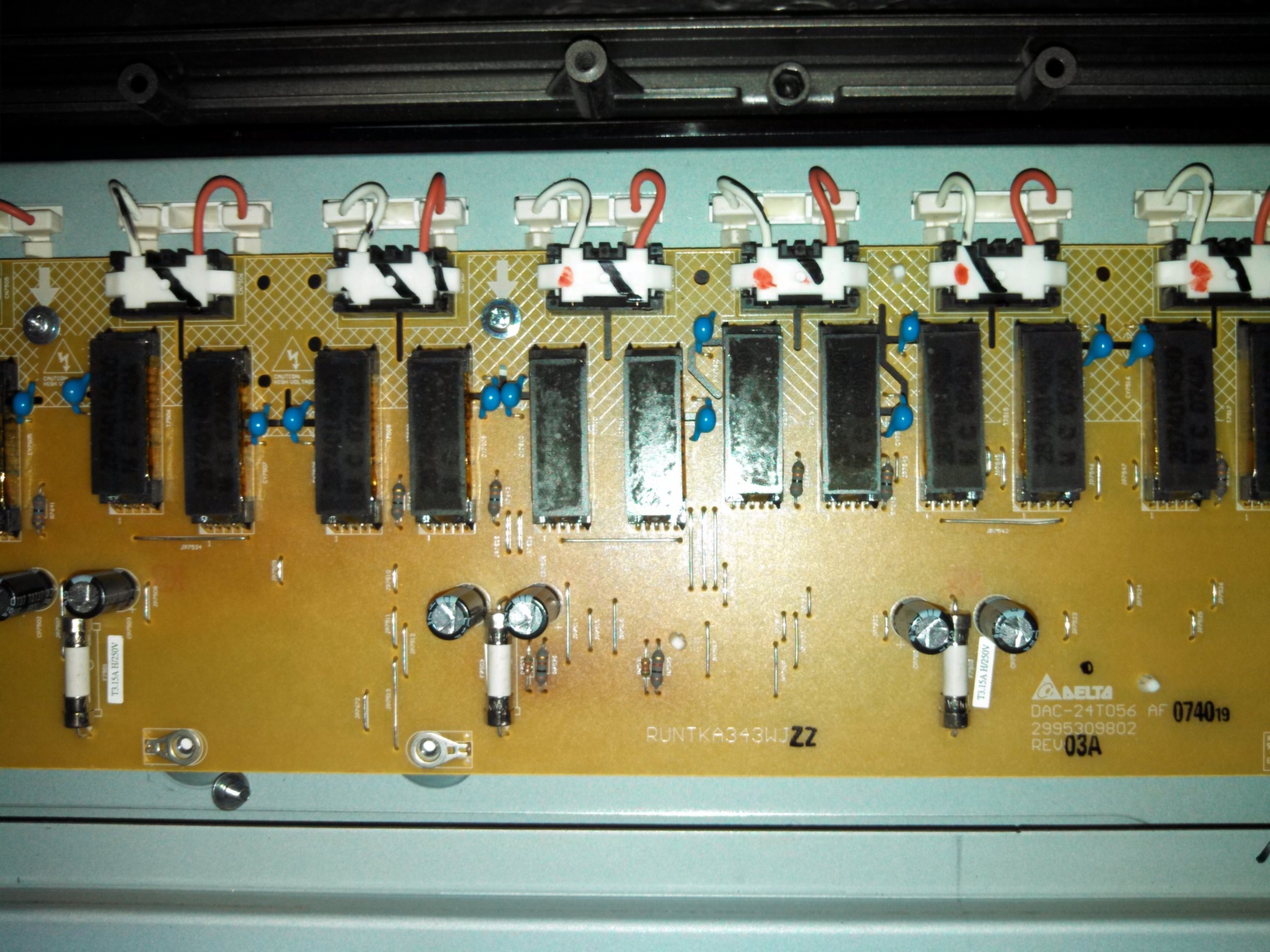

      Thanks for the quick reply. The picture before the main board was changed was gray fading to black. Now with the new main board, the screen stays lit, more of a dark blue than gray or black, but still no picture. We did switch the inverter, but switched it back, as the one we received we got off ebay and it looked burnt.
        Re: Sharp Aquos LC42D43U-42 Has Sound but No Picture
        Sounds like a t-con or panel issue. Can you post pictures of inside your TV?

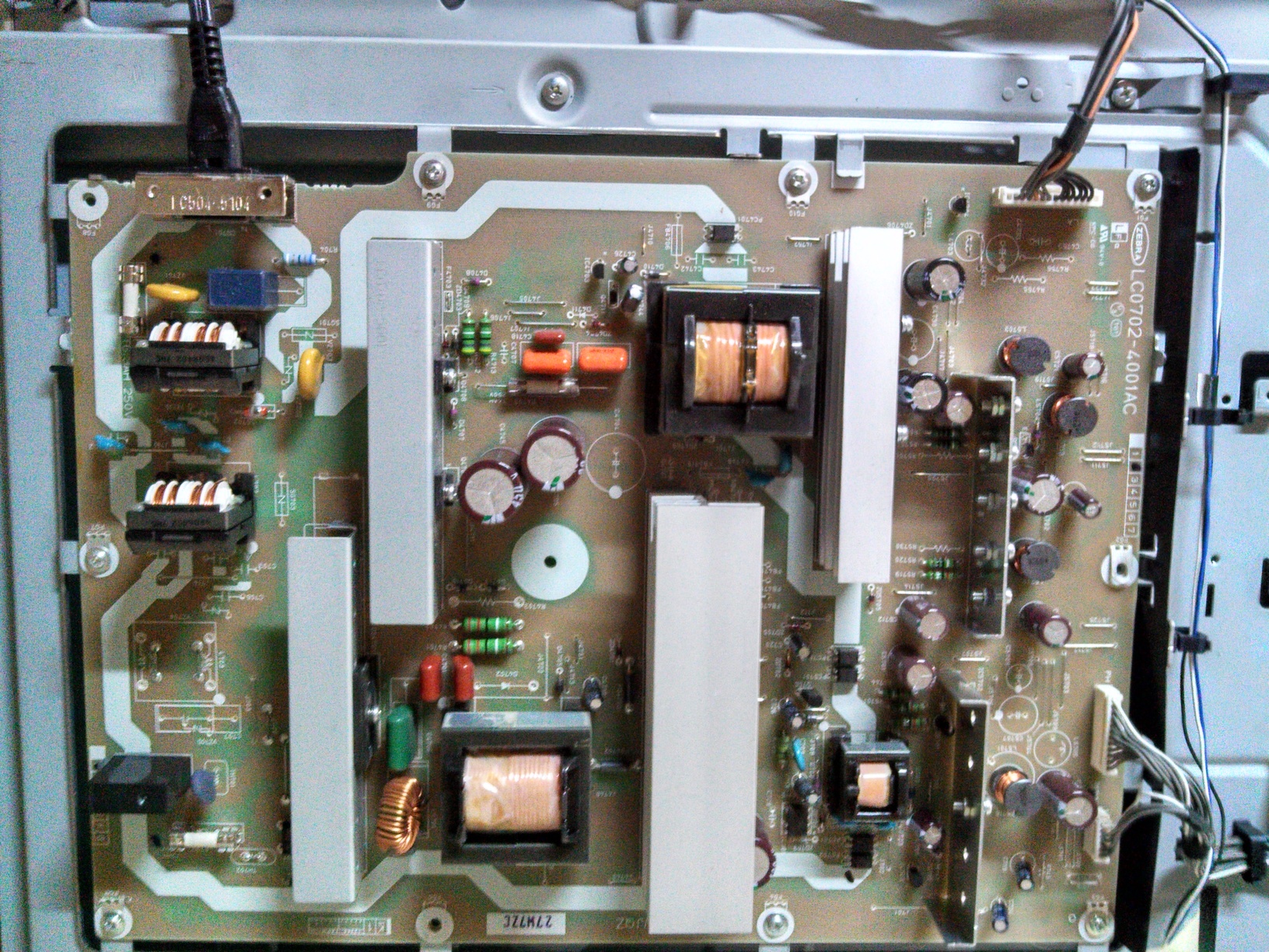

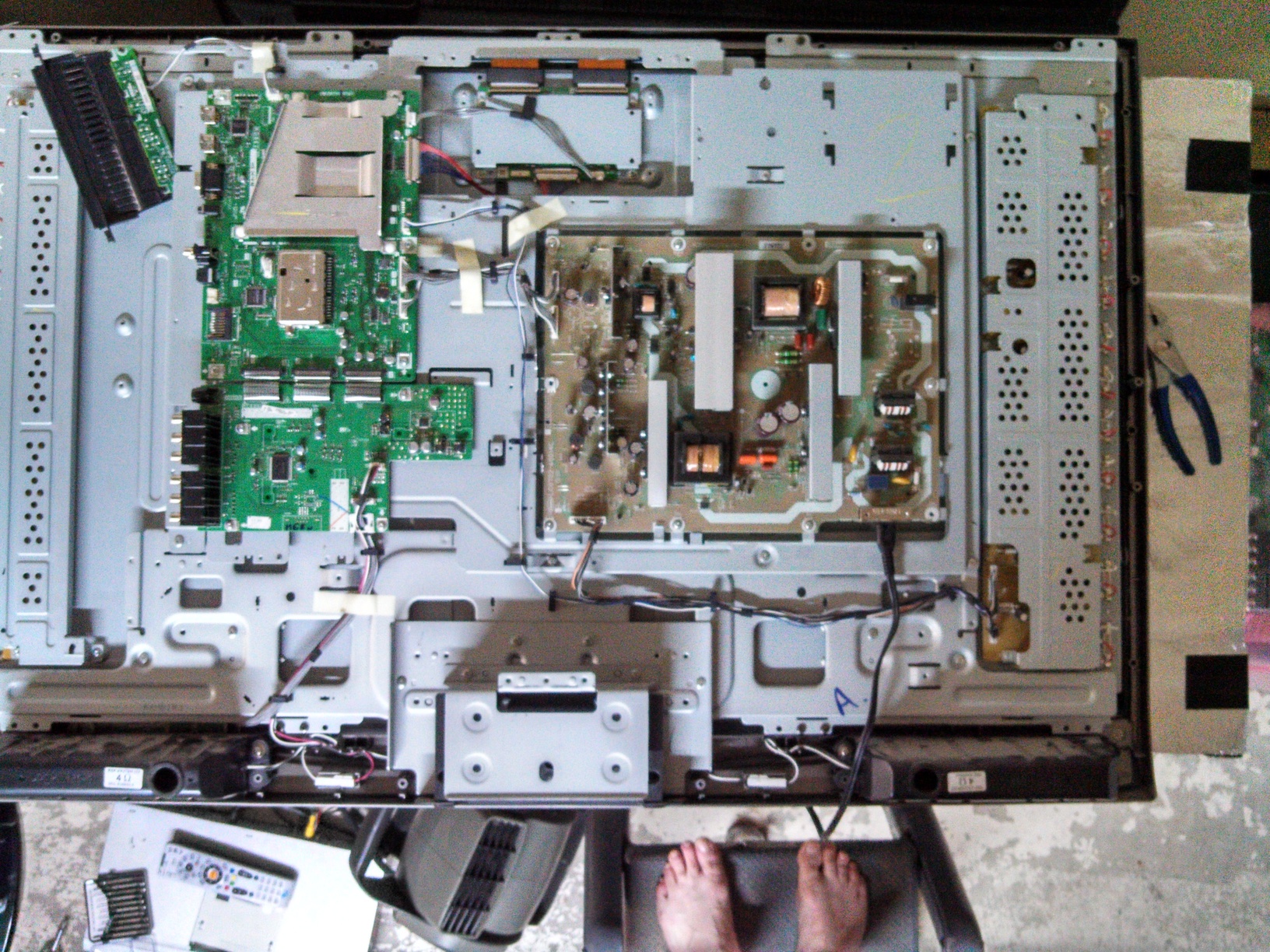

          I have attached a few pics.

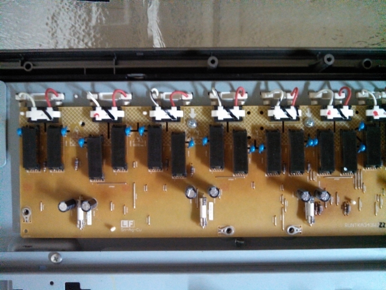

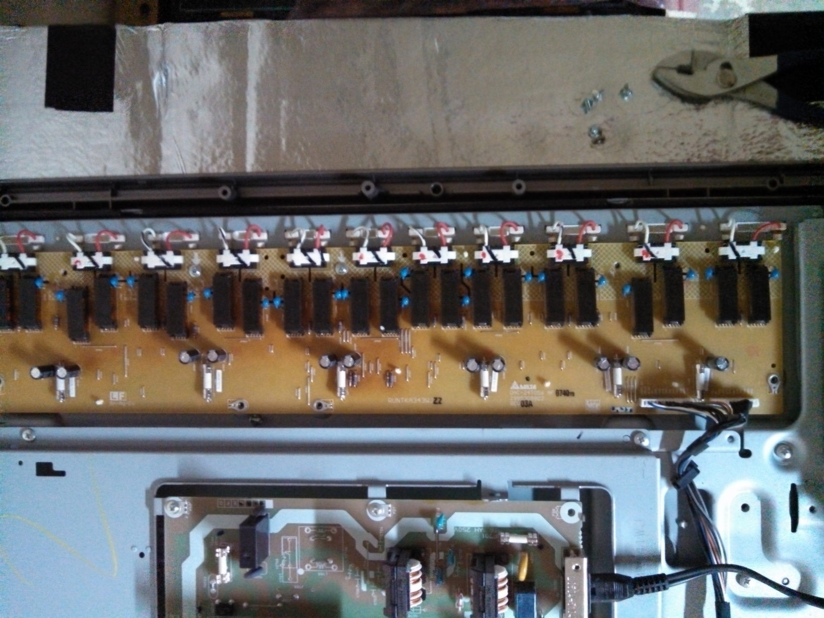

            A couple more of the backlight inverter...
              I have one like that. Problem is panel , Try to play with scan board on top of tv.
              Right side of tv look from front.

                Scan board? Sorry just learning this stuff and not sure what that is. Is that the board that the tabs are attached to? Should I remove the the outside frame to check this?

                  It takes more work to remove the outside frame . Just cut the black plastic cover
                  the board then hair dryer to the board . It makes some affect the tab bond ribbon to see any change on screen. Then you know what is the culprit.

                    I am guessing you are saying it may be a bonding issue? Not a board issue?

                        I have a 26" Sanyo (rebadge) using a Chimei panel, which has tab bond issues. Sometimes all you will get is a dark (no image), lit up screen, with a dark blue tint. Other times you'll get a faded light grey screen which slowly changes colour.
                        Different fault. Same cause and fix:
                        https://www.youtube.com/watch?v=purk_SyiT44

                            It would be one thing to check, as the symptoms are similar to other tab bond faults. Sharp panels (like in your Sharp TV) rarely have tab bond faults though. Not unheard of, but rare. Since the swap of the main board changed the symptoms, I would not rule out a main board fault. Possibly the replacement main board is bad too, given they are usually pulls from scrapped TVs.
