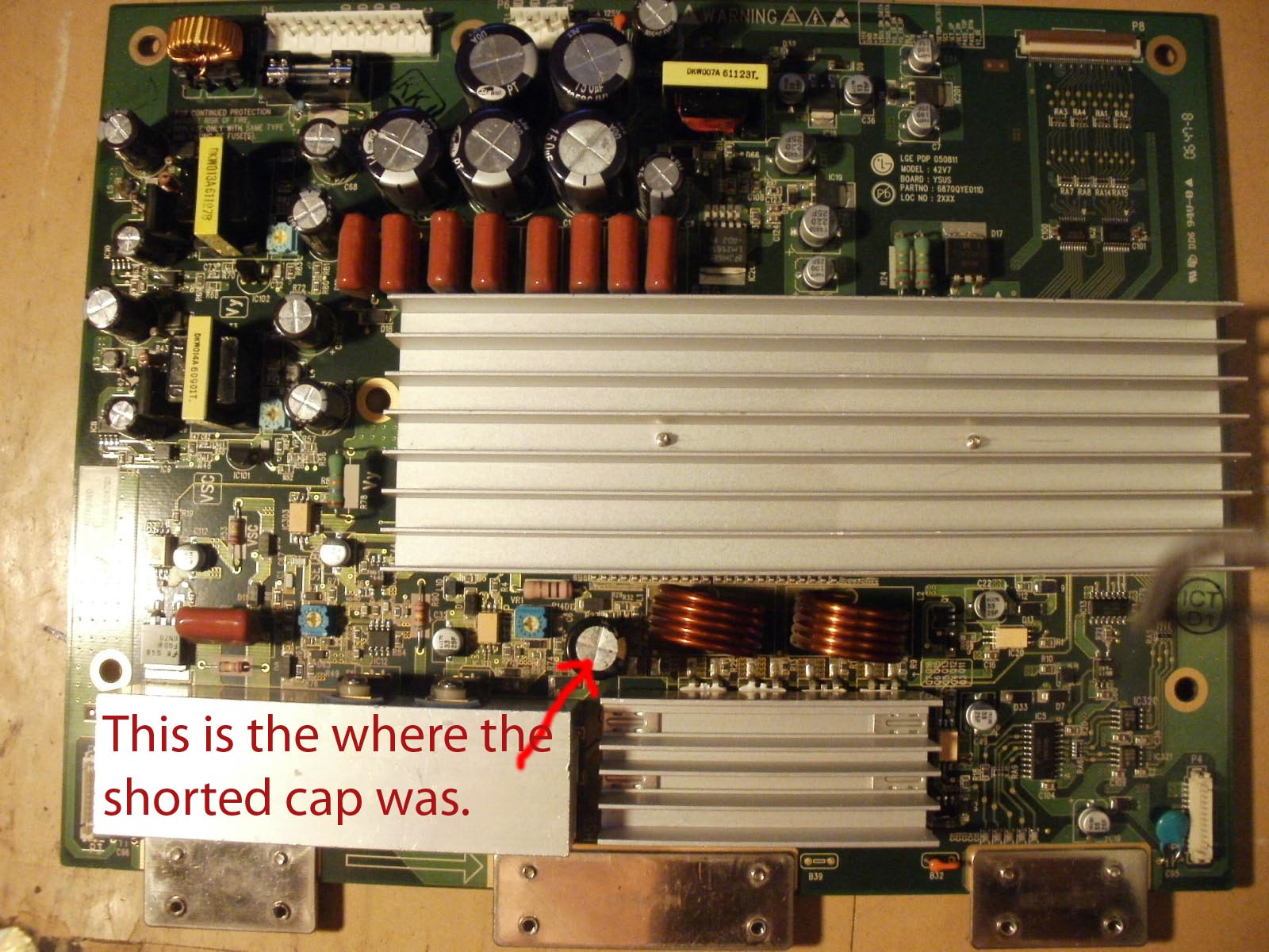

    I have been given a faulty 42v7 plasma tv and i was hoping i could repair it with minimal cash spent as I'm a bit poor at the moment
    the cause of the fault is the owner tried to adjust the set up /set dwn whilst the cover was still on he said there was a spark and it switched off.
    i took the cover of to find that he had shorted a cap to the case
    as there was large mark on the cap.
    so i replaced the cap and the blown fuse on the ysus board
    and the tv will switch on then off after a couple of seconds
    I disconnected the ysus board and the tv will switch on,
    so i don't think anything other than the ysus board is damaged
    i don't have the funds to buy a new board so would prefer to replace components.
    please could some one direct me on how to find the faulty components
    Kind regards
    Mike.

    There is a chance the module under the heatsink is bad. This is the IPM. Replacement is difficult, so if it is at fault then a new board may be the only option.
    First, can you check the resistance, in ohms, between VS and GND, on the Y-sus?

      i just checked it shows 1 ohms on my cheap dmm.
      so does this mean the chip is fried?
        Re: help with 42v7 plasma tv
        It is very likely. While other faults are possible, the IPM is the most common.
        If you visit the local dump often, broken (smashed) 42V5~42V8 based plasmas are dumped almost every day. You may be able to harvest the board from that.
        The IPM is around £20~£30, replacement requires a high power soldering iron though.

            It is really not practical without a desoldering gun which will cost you more than one Y-sustain board.

                I have managed to de-solder the IPM.
                so i will order a new one sometime next week
                hopefully it will solve my problem.
                  Match the model # on IPM when ordering.
                  Before you order, re-measure the VS to GND resistance and check that it is now open.

                    VS to GND is now open
                    my IPM is STK795-811a 6IBLN
                    but i can only find the STK795-811a 6IBDK
                    would it be ok to use this one?
                    or do i have to have exact match?
                      That should be fine as a replacement goes. You will also need fresh thermal paste.
