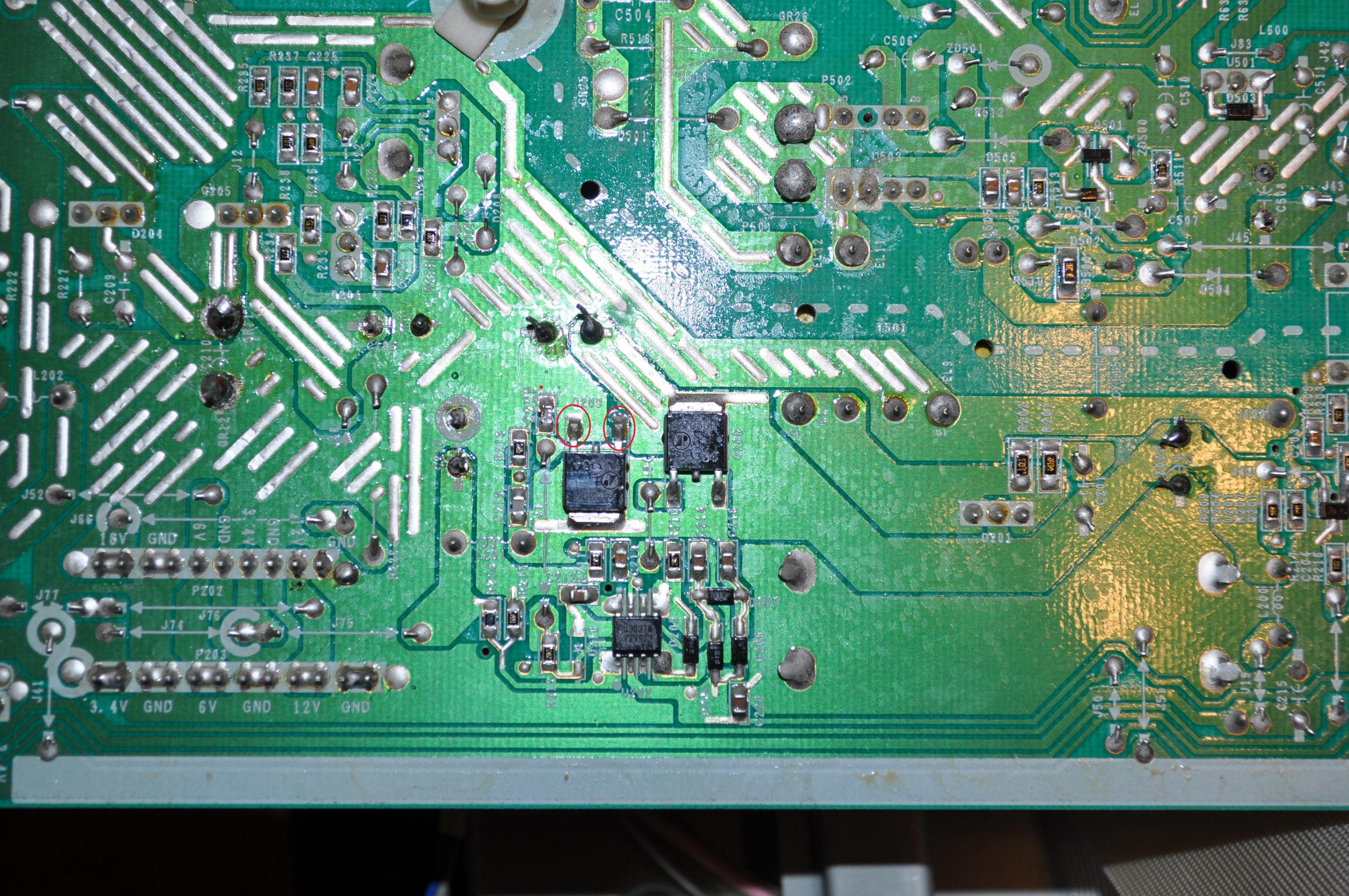

I picked up a LG 37LC7d that wont turn on green light just blinks. Doing a little preliminary testing I do not think I am getting the 3.3 voltage feed. The pin designated as 3.3 is testing 0 vdc. On the bottom of the PS Board I found a Mosfet that both leads circled test 0 ohms to ground. Is this a normal situation?

Remove the MOSFET to confirm it is shorted. Upper one may need replacement too if it is open.Please do not PM me with questions! Questions via PM will not be answered. Post on the forums instead!

What year is this TV? If it's 2007, check out the attached PDF. It actually helped me repair a 42LC7D and I'm fairly sure it would aply to yours if it's 2007.Attached Filesif you find these attachements useful please consider making a small donation to the site
Re: Need Help with a LG 37LC7D
Yes, on the main board. On mine, there were a few near the connector from the PSU and there were more near the HDMI I believe. For me, it was the ones near the connector that fixed the problem.
It's a tricky little job, at least it was for me! I had one jumper shorted out and had almost given up then saw it and corrected it and boom, TV working perfect. Ended up giving it to my mother.Comment
