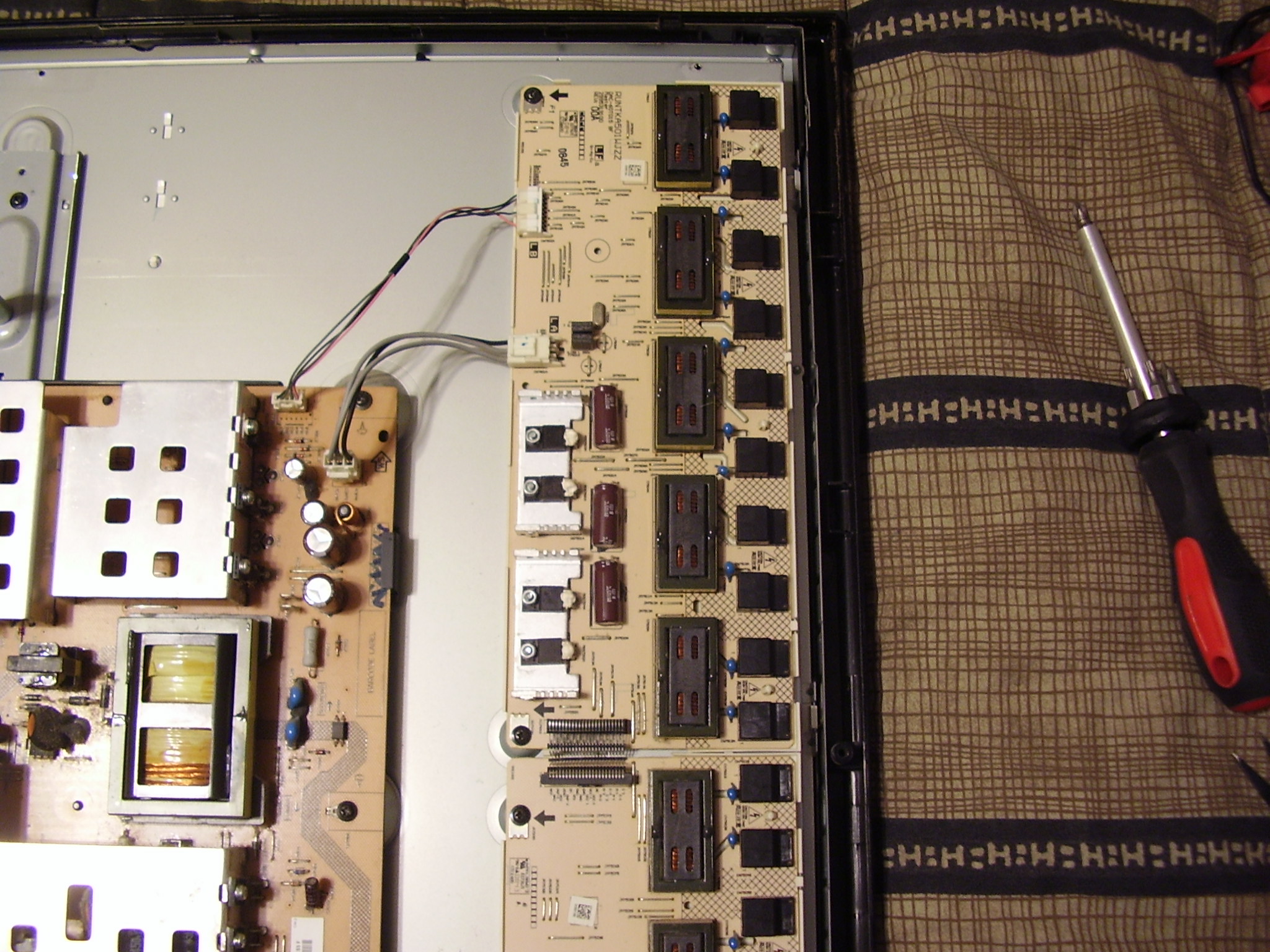

    Hi everyone, I'm hoping someone can give me some help on this. I picked up this tv with the green light blinking so after holdiing down the channel down and the volume up i now got it to display for 1-2 seconds and then black screen. The sound works and i can change channels and i can see the image on the screen. If i unplug then replug the 4 wire connector that runs from the power supply to the inverters the backlights will come on again for 2 seconds then off again and i can do that repeatedly but the lights just wont stay on. I have tryed tightening the inverter screws but no change. Does anyone have any ideas on which way to go on this? inverters? backlights?power supply?

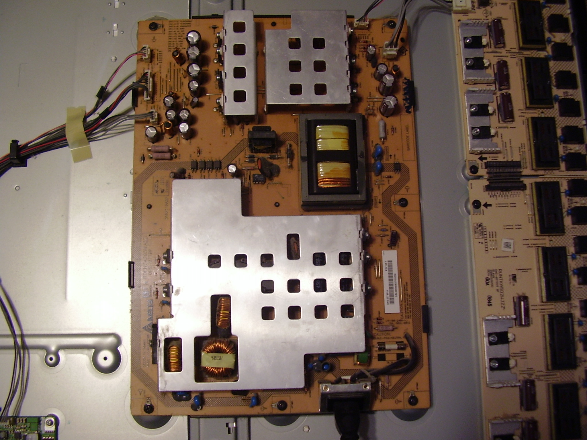

            I also checked the voltages and i get the same readings from the 4 wire connector that runs from the power supply to the inverters and the 4 wire connector going from power supply to main board and are labeled Inverter 1,2,3,4,5 with nothing in Inverter 3 hole so the readings are Inverter1=0 and this is the 1-SGND , inverter2=3.24v with lights off and slightly higher when lights on and this is 2-STB at the inverter, Inverter4=.415v w/lights off and 3.17 w/lights on and this is 5-ERR at the inverter, Inverter5=2.17v and this is 8-BRT at the inverter. Also on the power supply is a 3 wire connector going to the inverters and the Inverter12V reads 11.85, then SGND, Inverter60V reads 62.2V.
            There is an 11 wire connector running from power supply to the main and the 13.5signal=12.89v, 13.5audio=12.81v there are 2 of these wires,then there are 3 that are not labeled at the power supply and they have no readings, the next 3 wires are not labeled at the power supply but have readings of 3.0v,3.04v,3.22v. The next wire is not labeled and has no reading and the last wire being BU5V=4.98.
            There is a 4 wire connector going from power supply to t-conn board with 2 wire labeled PNL12v and these read 12.07v, and the other 2 being SGND.

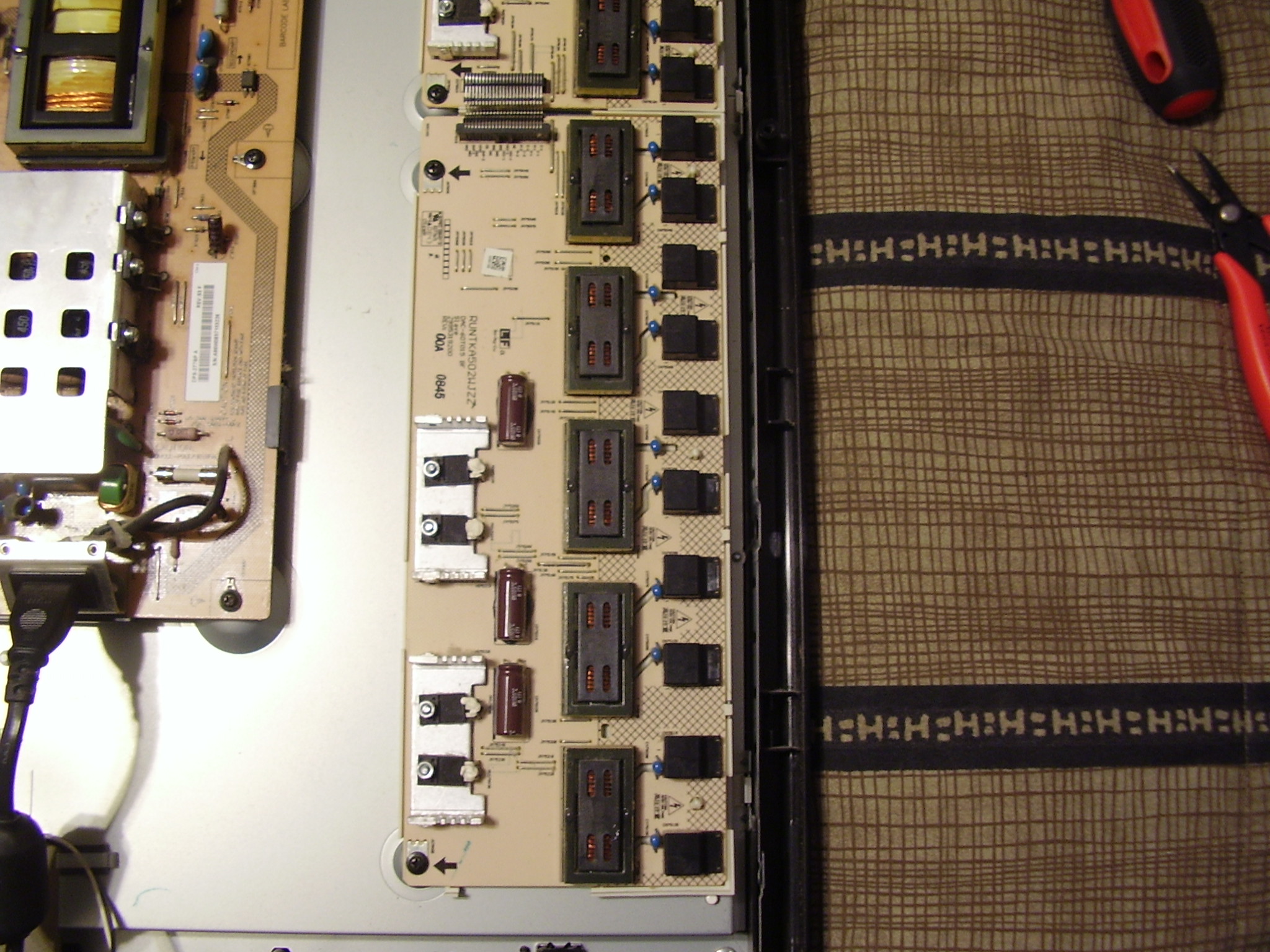

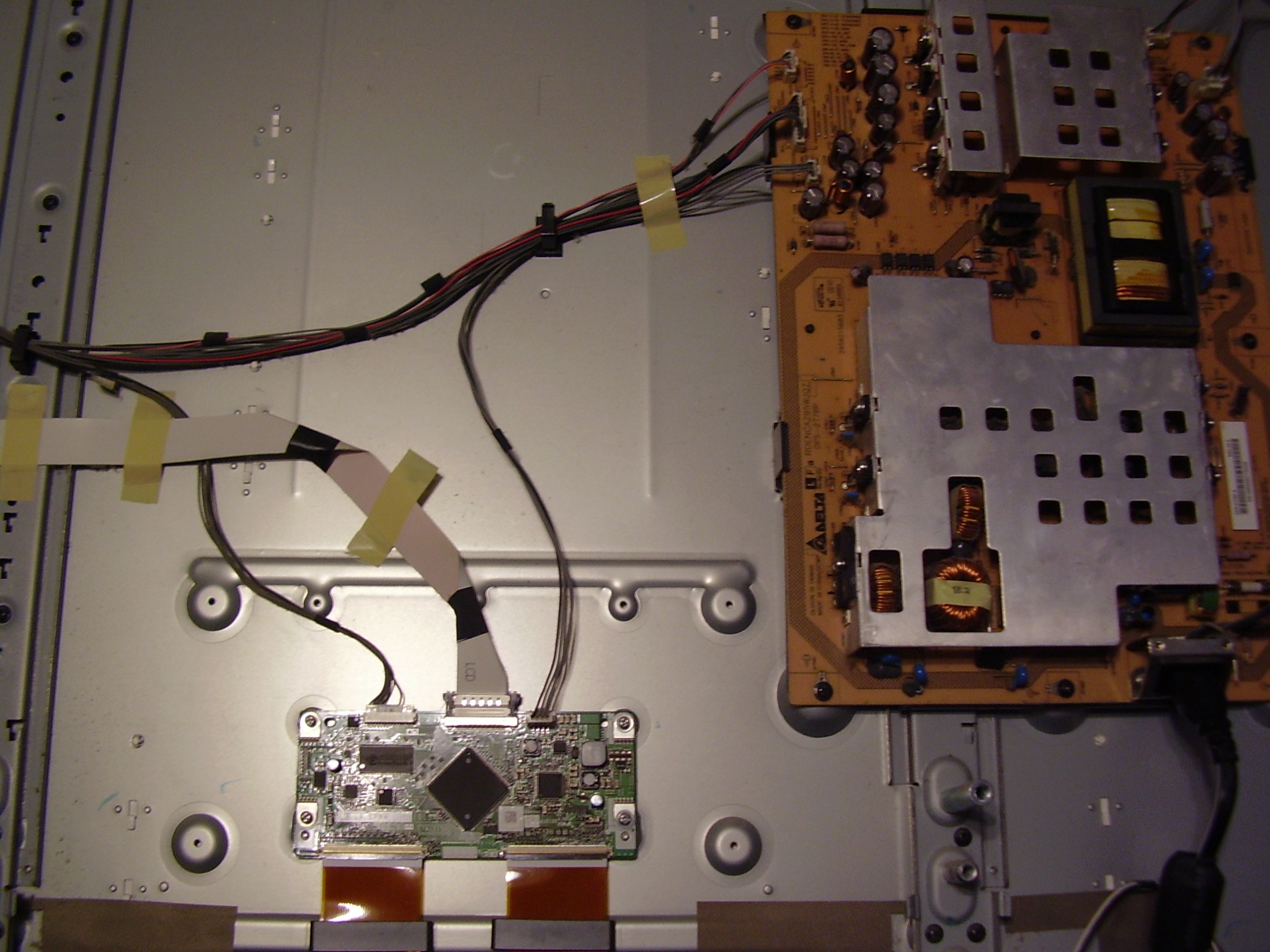

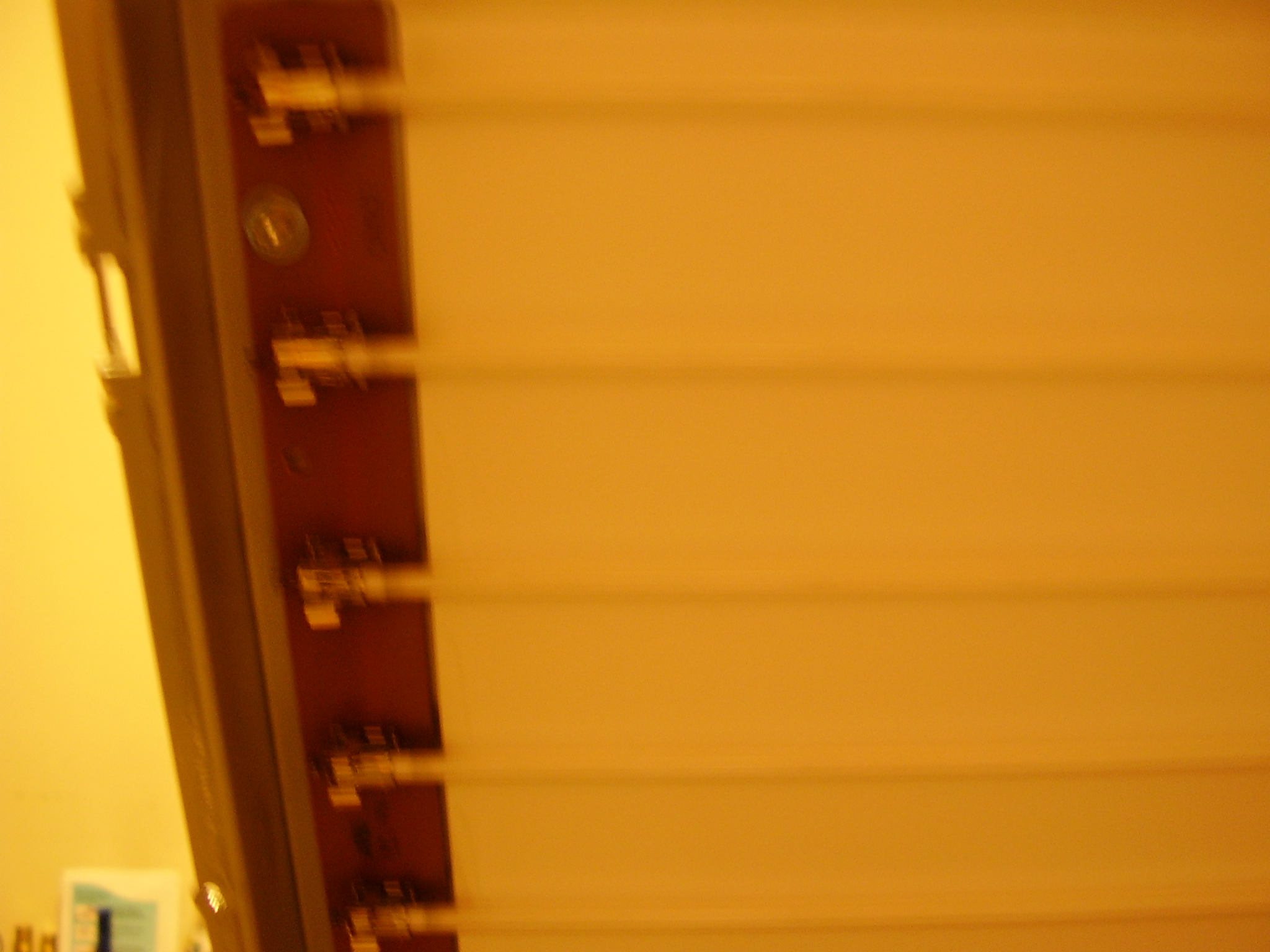

                          Ok i took this thing apart to check the bulbs and it turns out that every other set of bulbs are out, 2 on,2 off,2 on,2 off,2 on,2 off,2 on,2 off,2 on,2 off.
                          So its safe to say that the bulbs are more than likely to be ok and it in the inverter? What do you guys make of this?
                            Re: Sharp aquos lc c4655u

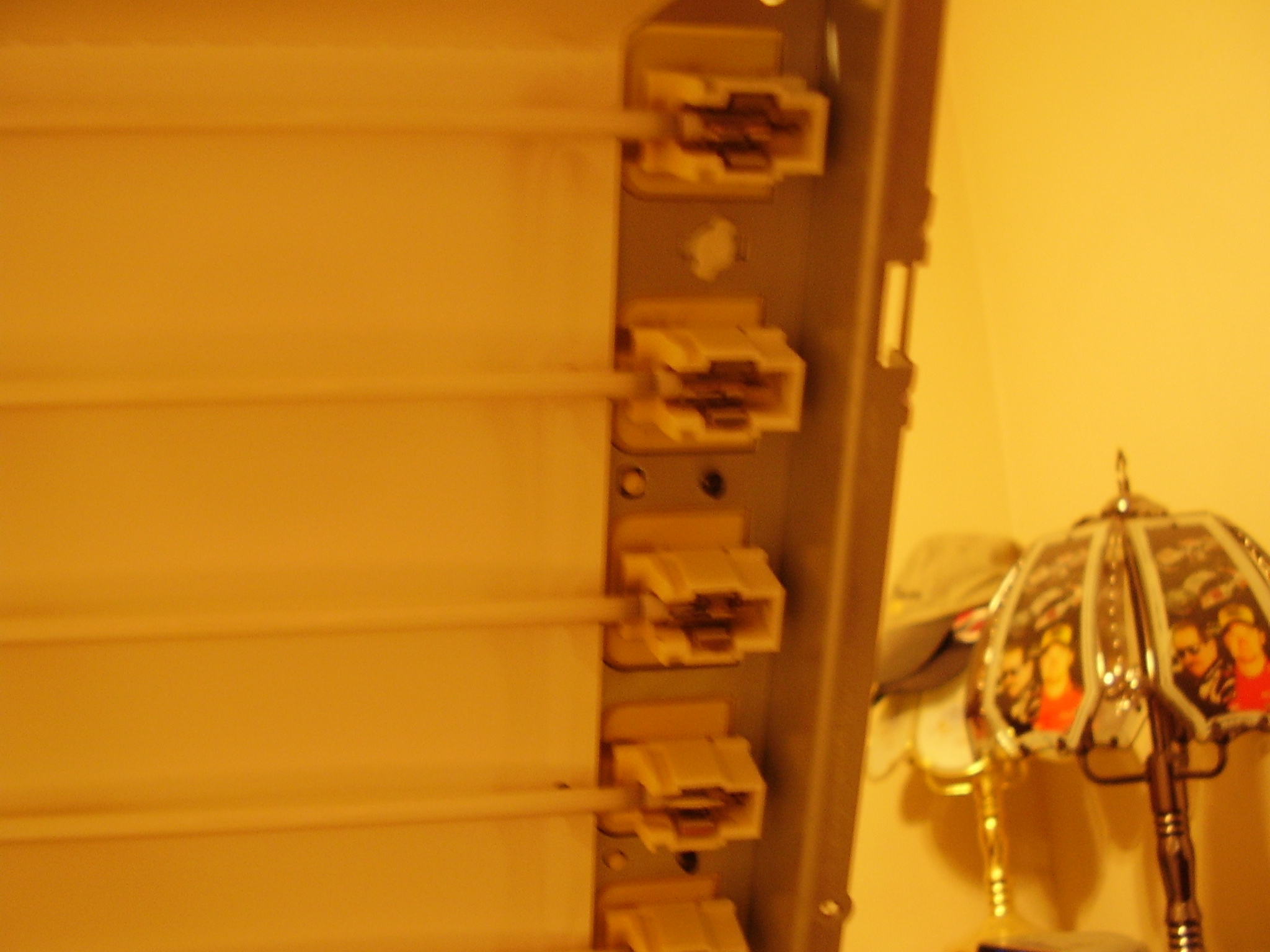

                            Are they all connected in parallel without any ballast caps for each lamps? Are they also socketed in place?

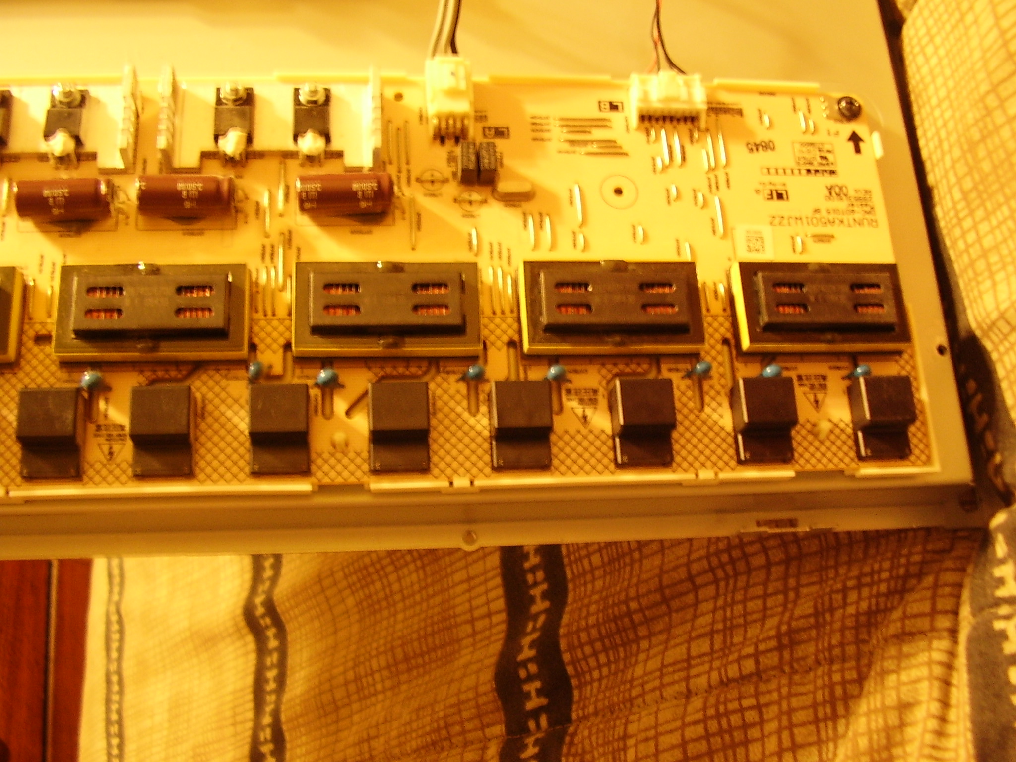

                              Here are some pics of how they are connected, not sure what you mean by ballast caps and socketed in place so hope these pics help answer that.
                              Pic 1 is of the inverter side, pic 2 is the other side and pic 3 is the inverters.

                                If the bulbs are out like that, you're probably right that it's the inverters. You can swap the bulbs to confirm it.
                                  Well i really dont want to touch the bulbs cause they are so fragile and dont want to risk breaking one so tomorrow i will remove the inverters and clean the contacts maybe with some emery cloth and see what happens.
                                    Odd, I cant figure out how the bulbs are connected on the side that doesn't have an inverter. You would expect pairs of 2 bulbs to be connected on that end
                                    edit: looks like the end with just the metal sockets is on a beige circuit board, you would possibly have to pop out that circuit board to really see the traces and how the bulbs are paired off.
                                    Although I agree its not bulbs the problem seems pretty bizzare for every other pair to be out, considering theres like 12 transformers in this set and the change of every other one going out is very unlikely... So I would assume the transformers are fine, but there might be separate fets / 24v traces on the inverter for every other transformer, and that may be why your problem only occurs on every other transformer / bulb pair.

                                      Well i cleaned the contacts of the inverter and still the same results, There are 10 transformers and 20 bulbs on this set.
                                      Do you think i should get new inverters and give that a shot? Anyone else have an opinion on this issue?
                                        Update: I installed new inverters and the tv now works like it should. Thanks to the help i got from the very knowledgable people on this forum we have saved another one. Thanks guys!
